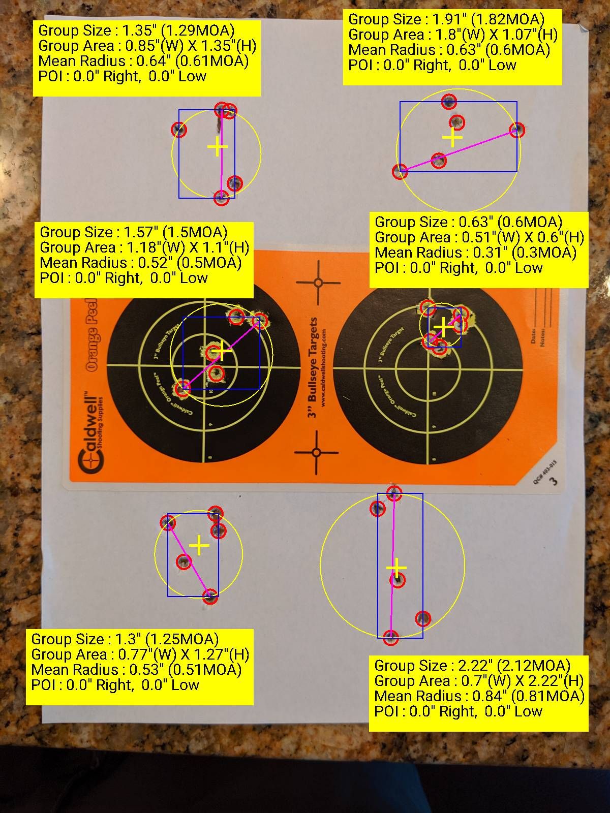

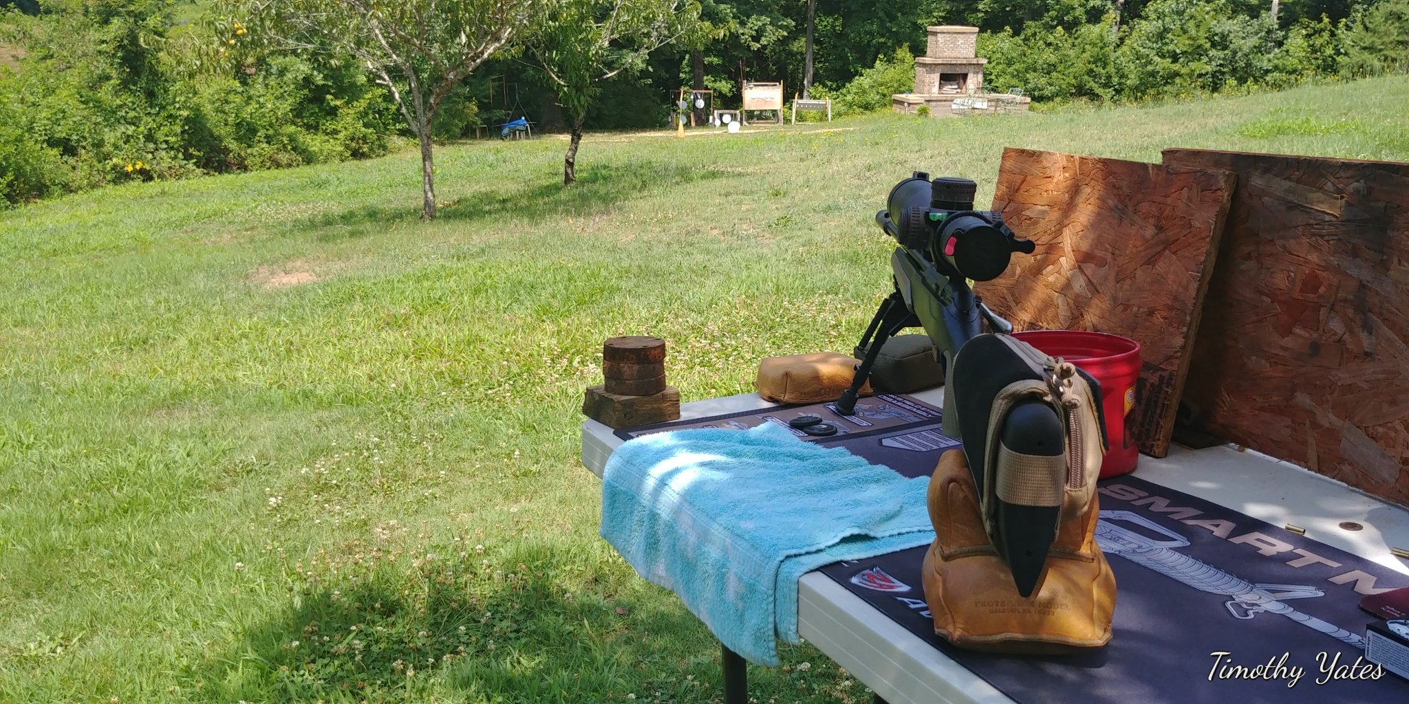

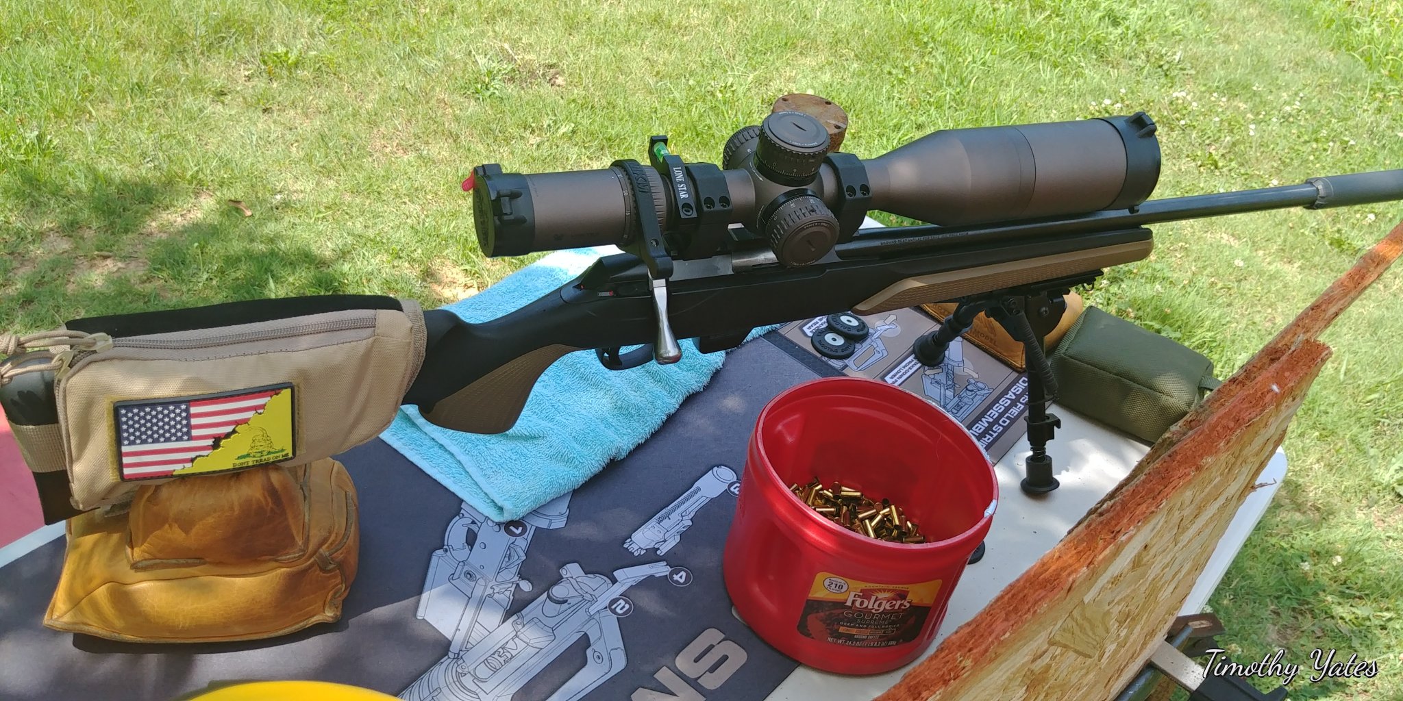

I got my T1X out for the first time yesterday and ran 100 rounds of CCI Suppressor through it. No FTFs and no FTEs. I was surprised at how softly it ejected the spent casings though. My RAR flings them about 3x as far.
I have 3 more mags in the mail and various types of ammo (SK, Wolf, Lapua, etc) to test next week.

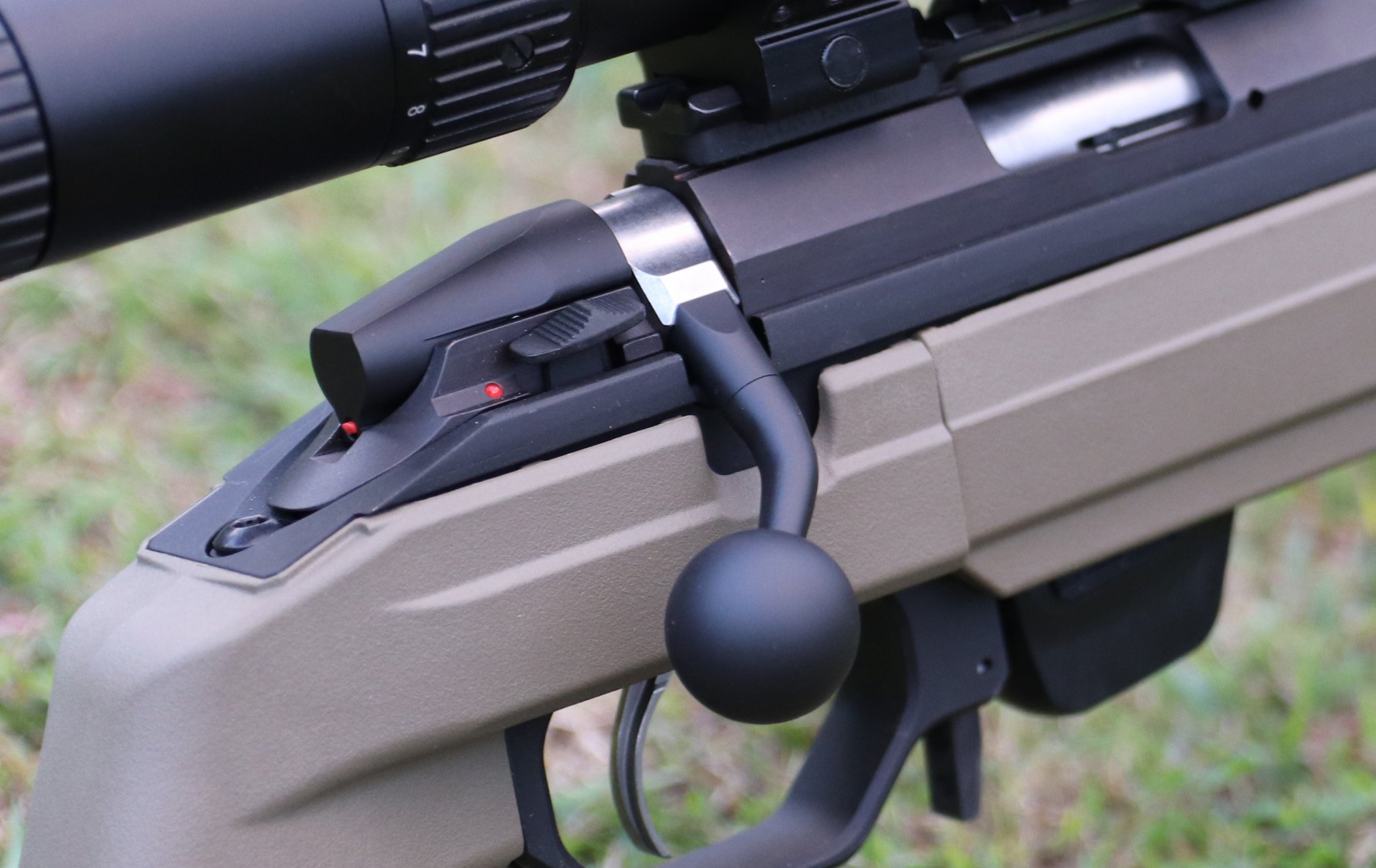

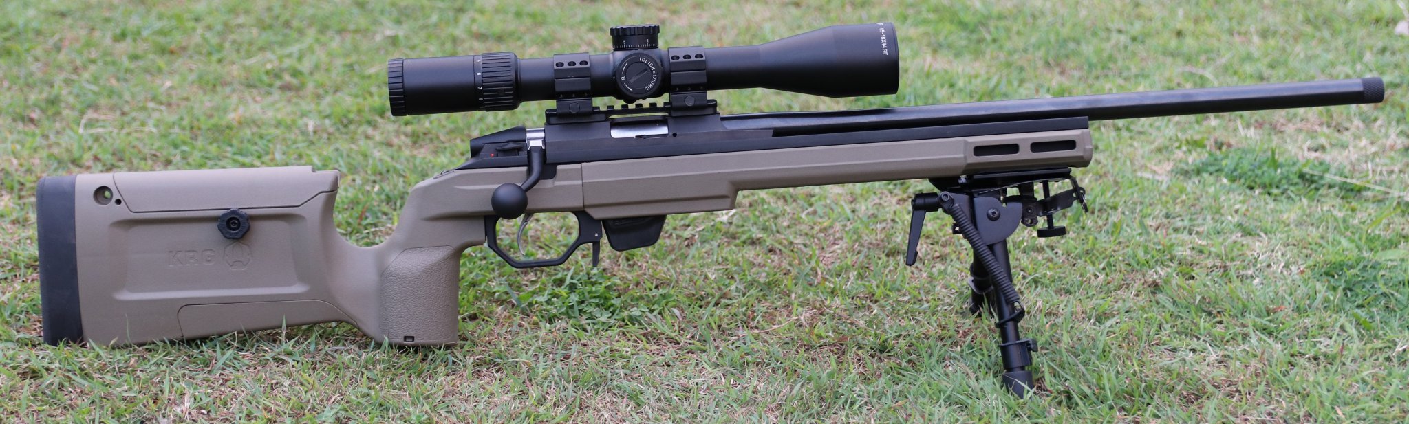

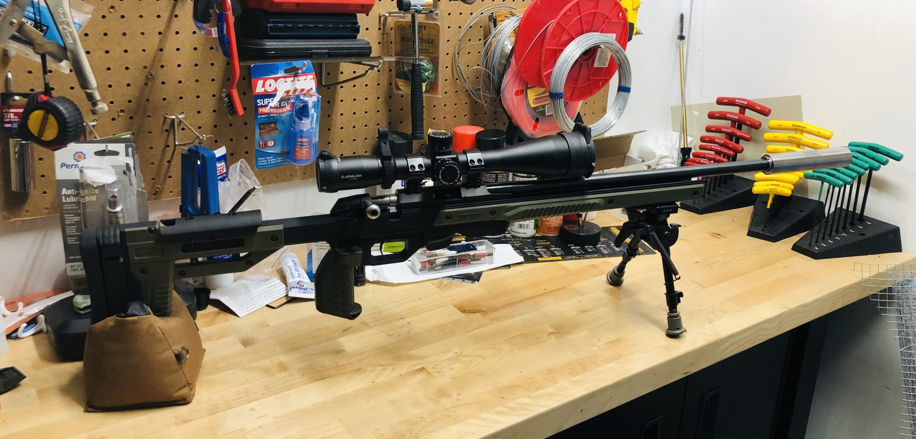

Oryx chassis, Harris SBRM w/ RRS Clamp, Athlon Ares BTR 4.5-27 in some cheapo rings, Form 1 can. Swapped the grip out for an Anarchy Outdoors penguin, but not sure if it'll stay or not.
Waiting on Area419 30 MOA base, Sterk swept bolt handle, Sterk bolt shroud, and yodave spring.

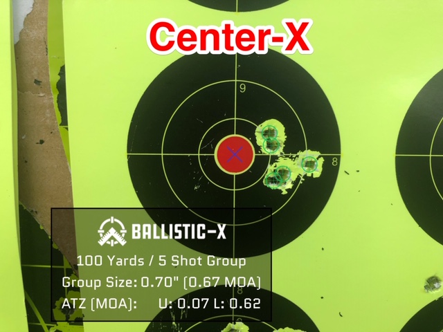

Got my 30MOA base and Vortex rings installed last week. Ammo order came in the mail today, so I took the T1X out to see how it would group. Tested SK Rifle Match, Wolf MT, and Lapua Center-X.

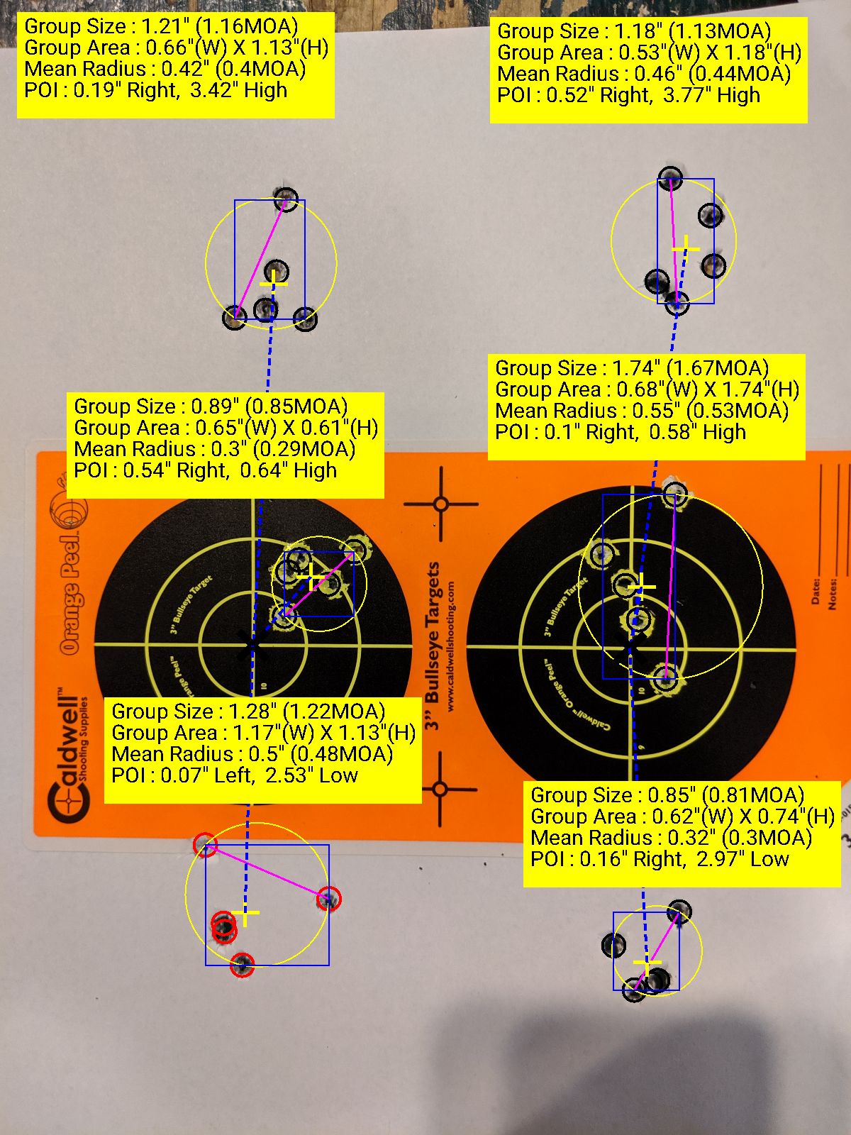

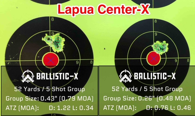

As a whole, it seemed to like Center-X the most, but Wolf MT had some great groups as well. Maybe just as good. At 11 cpr, it will probably be my go to ammo.
I didn't get to shoot much at 100 yds but did get one decent group with Center-X.
The trigger pull was bothering me; I'm confident I can tighten these up with a lighter spring, which should be here this week. I'll try to shoot some 6x5s after I get it installed. Need to get my RAR out as well and see how it compares.
Oh, and no FTEs or FTFs today. Bolt is really smooth now too after only a couple hundred rounds.

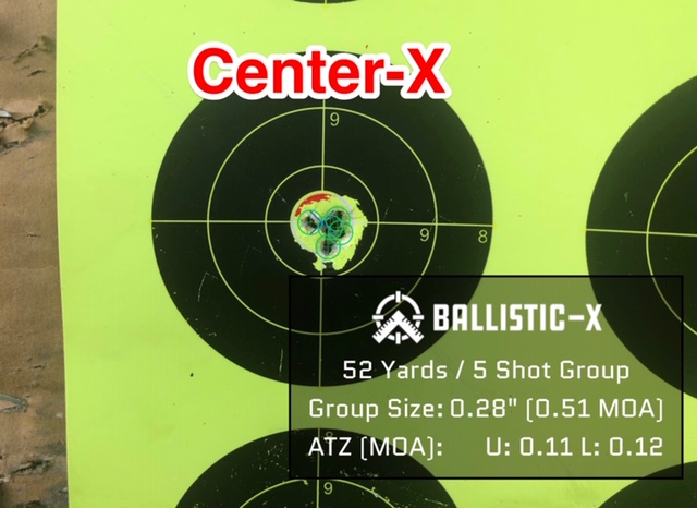

So I made it out to my local benchrest match on Sunday and man do I love the Oryx chassis.
Unfortunately after modifying my ejection spring I may have created a new issue, definitely my fault. I am getting consistent ejections, but now it’s hard to feed and will sometimes deform the rounds.
Accuracy has only improved since installing the Oryx, but do to sometimes deforming a round, I will have a flier. Anyone know of any aftermarket ejecting springs or if Beretta will mail out a replacement?

I shot 5 -5 shot groups toady with CCI standard that averaged .339 @50y.
Tomorrow I have Lapua center x Sk rifle match and federal match to see what it can do. I have doing the 5x6 with them and then 3-5 shots @100
I'm curious how your results are! Make sure to foul the barrel with the new round with 10-20 shots before doing your groups. Right now my best 6x5 average for SK Standard Plus is around 1.1" @ 100 yards. Eley Match is .86", and CCI SV is around 1.4". If you have a good lot of CCI SV, with small variation in velocity I think it would group well. Ignoring my top right group, most of the groups were more vertical stringing, then random.

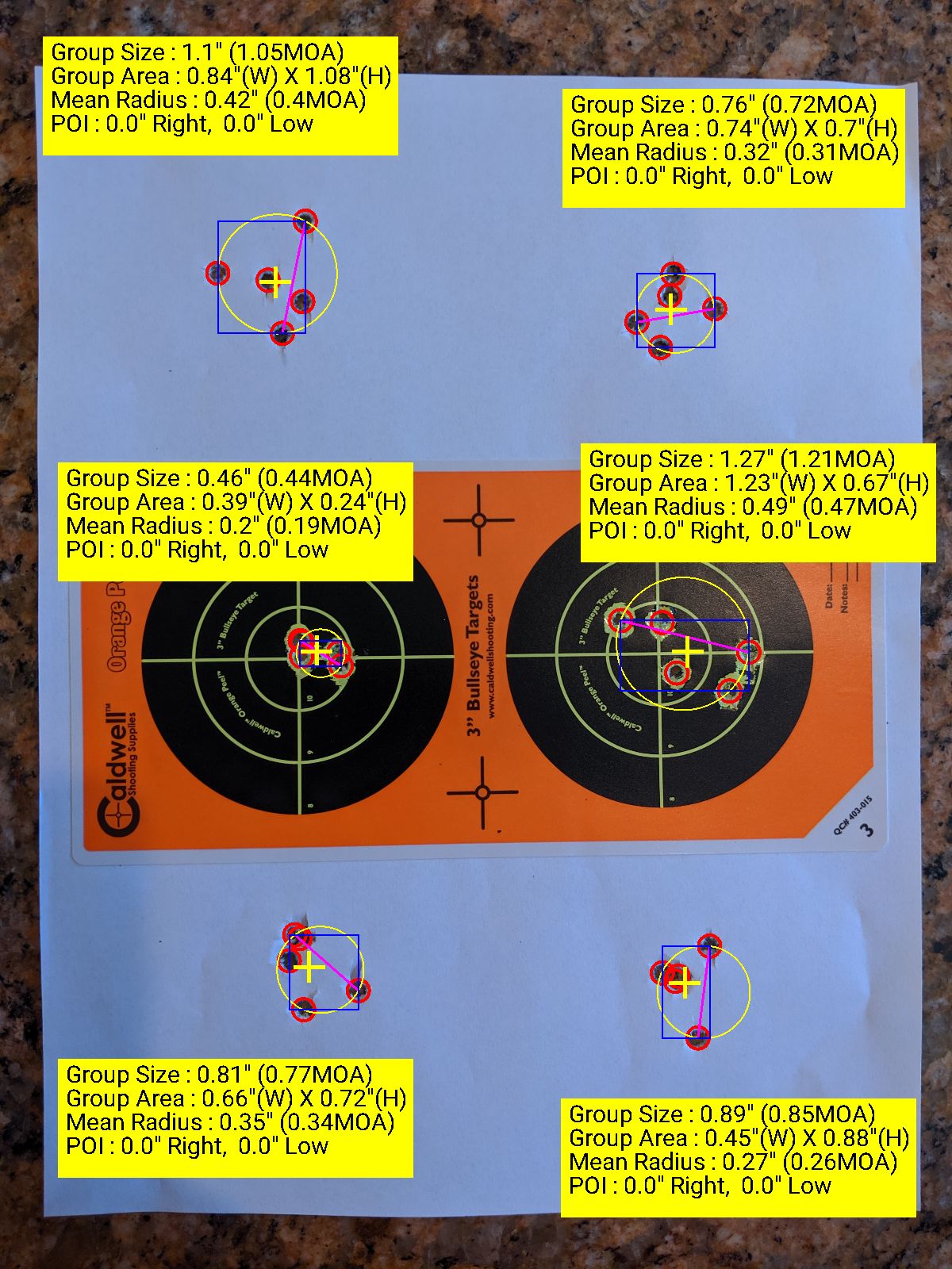

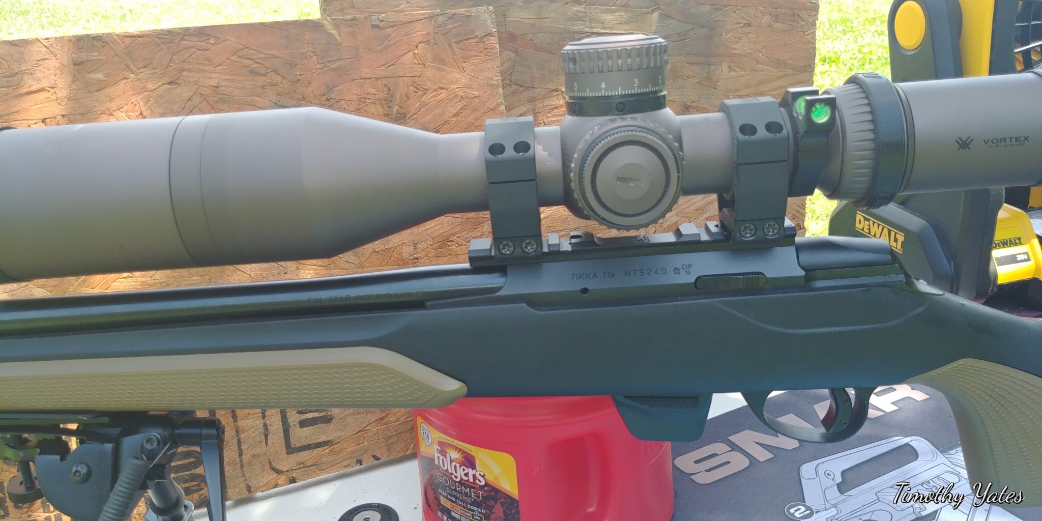

So I went out today and shot the 50 yards 6x5 @50yards and did a 3x5 @102 yards. I used Sk rifle match, Laupua center x, and Federal match.
As you can see from the last picture, I forgot my front rest and had to improvise with sandbags stacked on each other. The gun had approximately 300 rounds of CCI Standard through it without cleaning it. I ran the Federal Match, the SK Rifle, and Lapua in that order. 50 Yards first and then at 100. The gun was never cleaned. I did not use fouling rounds in between sets. I just shot the gun, The suppressor has had about 2k of rounds without cleaning it. They say guns are more accurate without a suppressor. For the $430 non-heavy barrel 22lr these things flat out shoot. I have Anschutz, CZ453 and 455 and savages. This is by far my favorite rimfire.
results
50 yards
SK Rifle match .339
Federal Match .585
Lapua center x .535
Best at 50 was Laupua with a .168 and SK @.18
102 yards
SK Rifle Match .912 I had a group really open up due to me using the two groups it was .683
Federal Match 1.466
Lapua Center X 1.20
best 100-yard group .556 with SK Rifle Match
