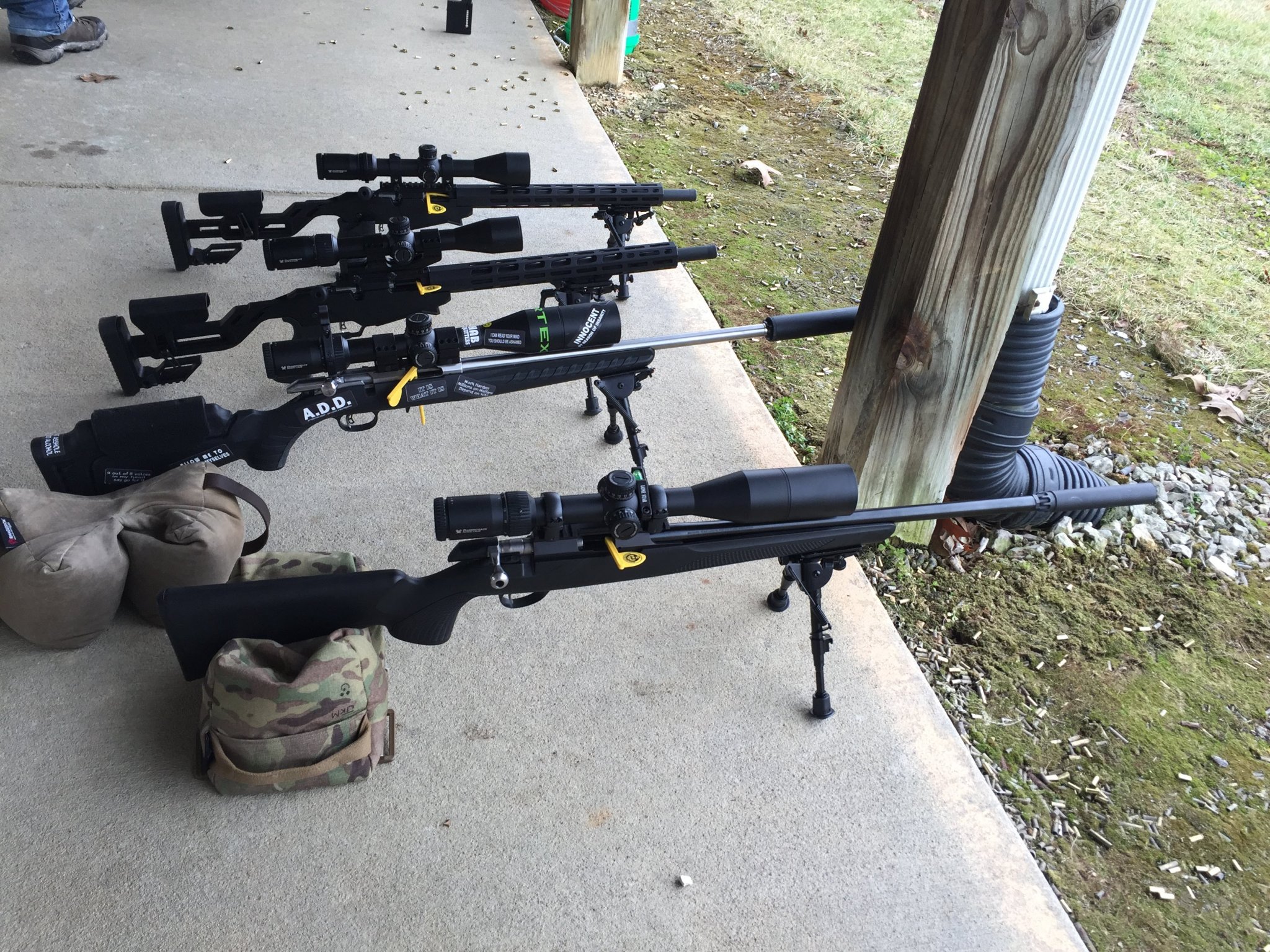

Today, I finally got out to perform a meaningful ammo testing with My T1x. We hit the range at 9:00 a.m. before the wind picked up and had a good hour of shooting in zero to very mild conditions. Scope was an SWFA SS 12x42.
The rifle is glass bedded into a GRS Sporter stock, and has a MT bolt handle, and an Area 419 30MOA rail. Otherwise it is stock.
I shot off a concrete bench from a Harris bipod and a rear sandbag. 50 yards, no wind flags, or meter. Ammo tested was Prime Semi-auto, CCS SV, Aguila SV (Aguila Prime), & Aguila Subsonic (Eley Prime). All three shot well. Averaging .5xx across 5-6 5-shot groups with each ammo. There were a few .3xx groups and one very round .2xx group shot with Aguila subsonic. I shot a few .8xx groups but nothing as large as an inch. After testing at 50 we moved to the high power silhouette range and sniped the 200-meter chickens for a couple hours. The T1x and my friend’s Anschutz 64 MPR, were both deadly on the chickens. Mild but Shifting winds made it fun. We soft set them and were able to easily knock them over with one hit. Tons of fun!

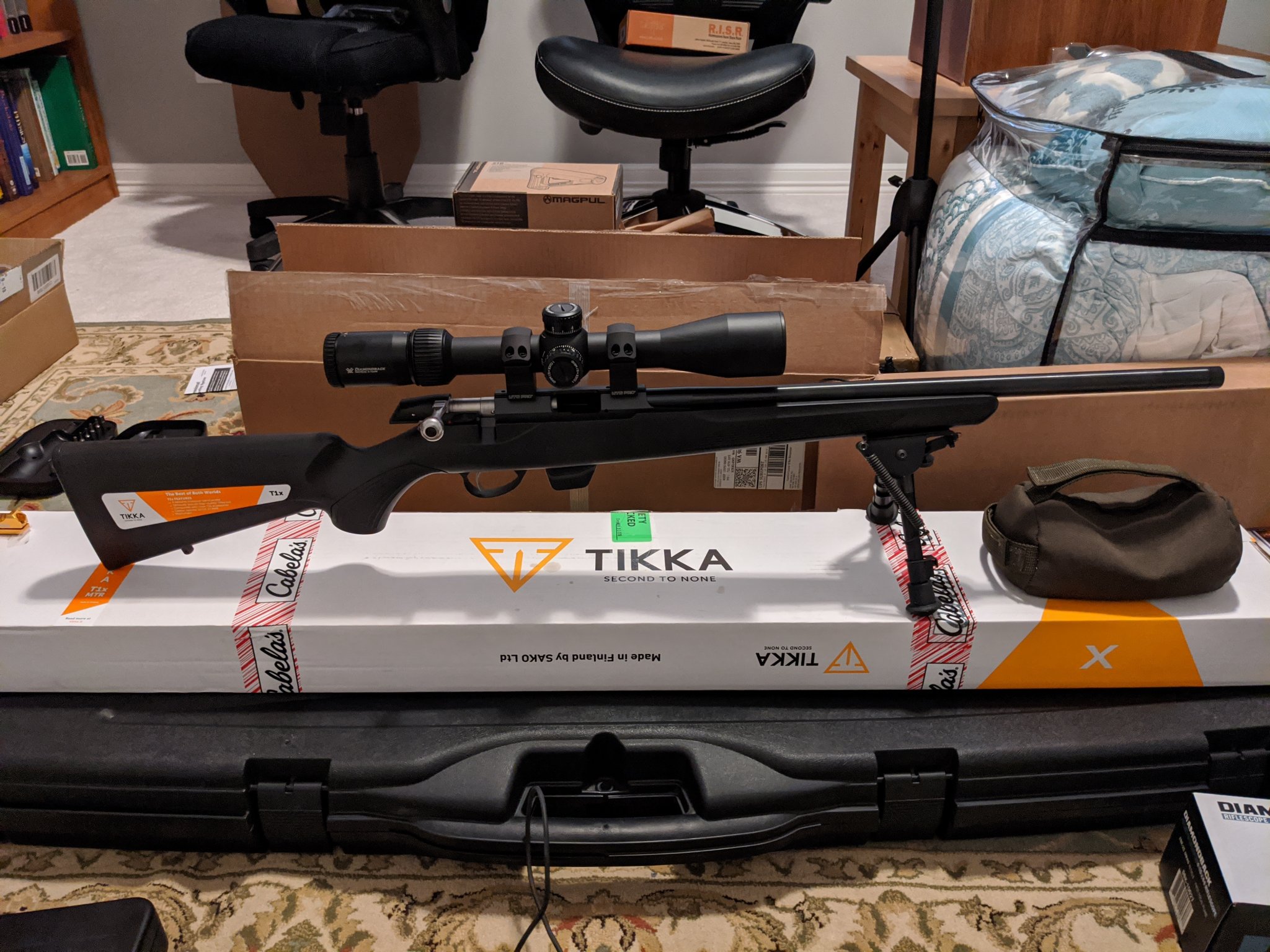

Well I just got a Tikka T1x from the LGS in order to get into NRL22 base class. Shot a match with a friend's rifle last year and, while it took awhile, the bug is back. Now saving for a scope.
Trying to keep this cheap and not spend on gear before skill warrants it. Planning on the Talley unitized Tikka T1x rings. Adding a cheap Caldwell bipod, Triad Tactical cheek bag/pack, and an M1903 sling that I already have. Hoping CCI SV performs well but I'll of course test other brands as funds allow. Trying to keep expenses down at this point.
My friend was running a Primary Arms 4-14x40 with the R-Grid reticle. Really like the reticle and it performed well for me. But I'm also intrigued by the Athlon Argos BTR 6-24x50 since I can get it on Amazon for a few bucks more. I don't like the Argos reticle as much as the Primary Arms, but all the other features seem to compete well.
Which would you all prefer, and am I doing anything wrong with my setup?
Can’t speak to many of your questions, but regarding optics, you may want to take a look at the Vortex Diamondback Tactical 6-24x50. You can get them on B&H Photo for $299 right now. I’ve got one on my T1x and absolutely love it. Just my 2 cents.

Just shot my first ever NRL22 match with this T1X yesterday and it did pretty well. Got 2nd out of 8 base class shooters and like 7th overall out of 43. It helped that I was able to practice at the same range the day before using some of the barricade setups but not exact courses of fire to kinda see what shooting positions to expect. The gun did all the work. Sighting in at 50 it was grouping about 3/4" with 10 shots when I was doing my part just using CCI SV that I bought earlier that day from Wal-Mart. Shot so well, I went back and bought all they had. At 100, after figuring out my wind call, most were within 1-1.25". Good enough for NRL22 it seems as the only targets less than 1" seem to be 50 yds or closer.
Gun has less than 400 rnds through it and I've only shot Federal GMM, CCI SV and Bulk from Win/Federal. I'm pretty happy with the performance of the CCI SV, but I'll get a few boxes of some higher end ammo. Someone gave me a box of SK Standard Plus to try out (they were also shooting a T1X in a KRG Bravo). For the money, CCI SV seems to be doing the trick. Nice to be able to shoot the whole match for less than $7 worth of ammo.
My setup for NRL22 Base class was a stock T1X (added T3 vert grip), DIP 25 MOA Rail, Burris Signature rings, Vortex Diamondback Tactical 6-24, LoneStar Scope Level, a cheap Caldwell bipod and a SilenerCo Spectre II. It seems running with the silencer helped groups at 100yds a little bit and helped mitigate the already unsubstantial recoil. Only major issues were getting a good sight picture quickly. I need some sort of cheek riser to be able to just lay my head on the rifle and get a sight picture. Other thing that may have helped was having a slightly longer LOP. I'll probably get the T3 buttpad from Beretta. Debating if I should get the stock spacers from Beretta as well. Anyone order those? How thick are the spacers? Anyone that's used the beaver-tail fore-end have any issues fitting bipod with that or have it help in a match? May pick one of those up as well.
Also, for anyone interested, I got to put a few rounds through a B-14R someone had there. It's a very nice action, good weight, good feel and is just like my full sized HMR. I only shot a few rounds, and I'm not sure what ammo was being used, but the Tikka seemed to do just as well at 50 yds. Hard to make a call of which is better in 5 shots, but as for the feel of it, it'll likely be my next 22lr as my skills progress.
