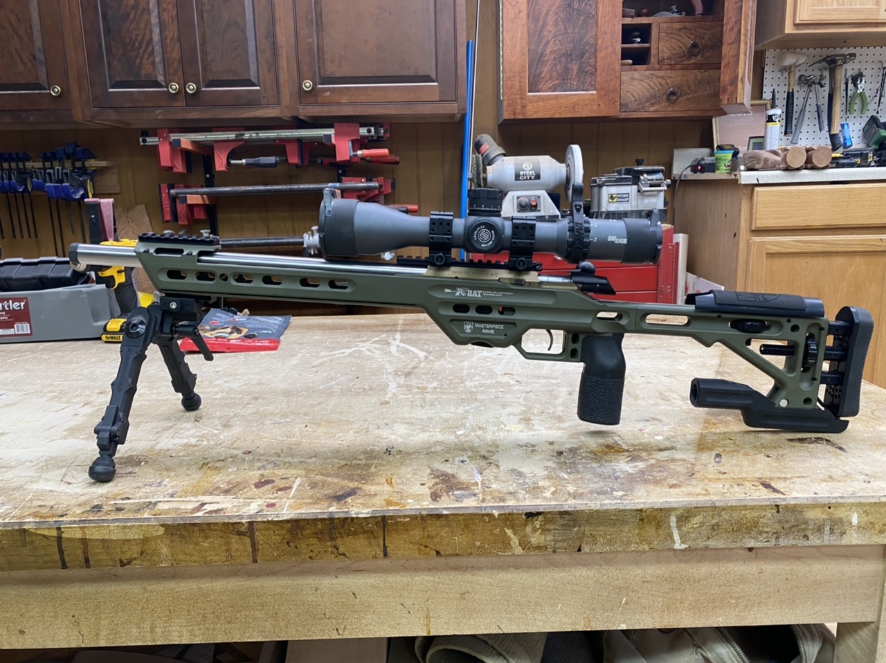

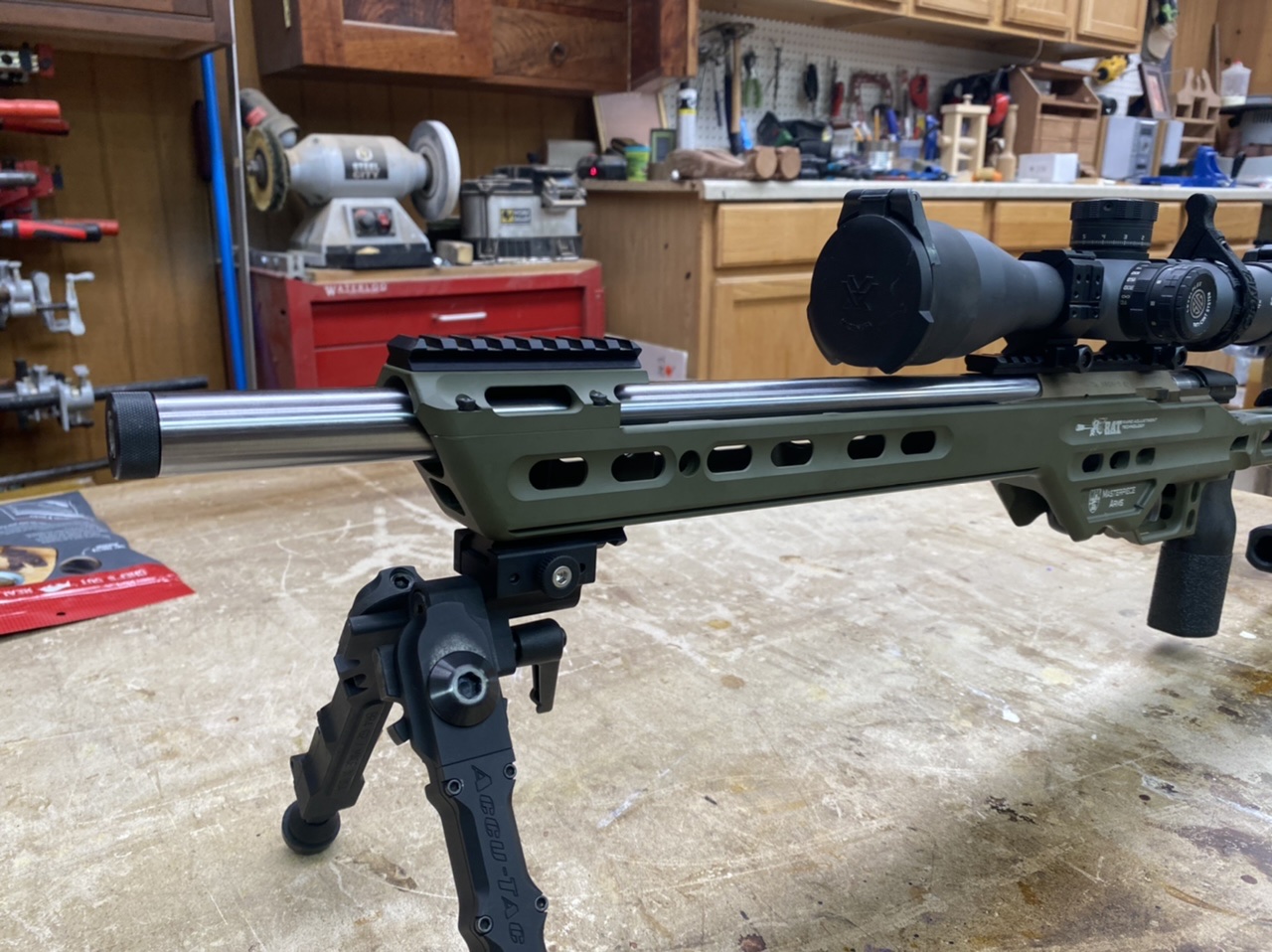

Shout out to MDT --
I ordered a "factory second" ACC stock from MDT on Black Friday for $400 off. I think they were a bit overwhelmed by the responses they received. I called at the end of December, and they said they were trying to catch up on the order as fast as they could. Well, I got my stock last week, and it's a work of art. If it's a factory second, I can't tell anywhere! Fit and finish are outstanding (I got the FDE), and the T1X bolts right in (after I removed the factory magazine catch). Range trips to date have been very, very encouraging. I'm still working through the ammo to see what works best (so far, Lapua Center-X and SK Pistol Match -- big surprise, right?). After seeing and using this stock, I would probably buy another at retail if I ever had to.
I ordered a lighter trigger spring (best $10 I ever spent), and a cheekpiece pad from HopticsUSA. It has a Vortex Diamondback (soon to be replaced with a bit higher model), a Thunderbeast L-1 suppressor, and an Atlas bipod. I've been trying to find a Sterk bolt handle, but to no avail just yet.
So again, a shout out to MDT.

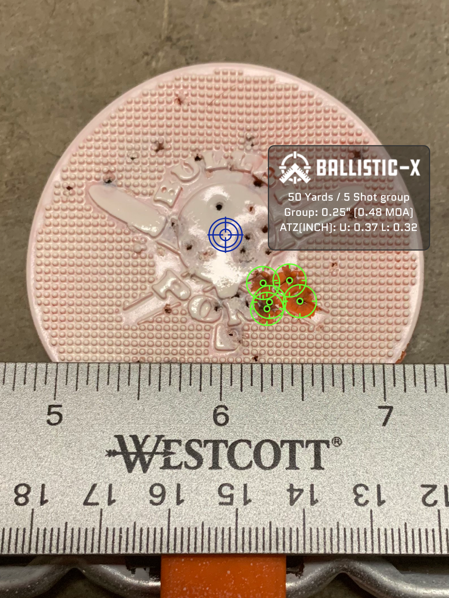

I was just plinking with my T1x over the weekend with some CCI SV when I noticed that it was putting together some tight groups. So I sprayed the spinner white and shot 5 rounds to see what it was really doing. Needless to say I am pleased.
