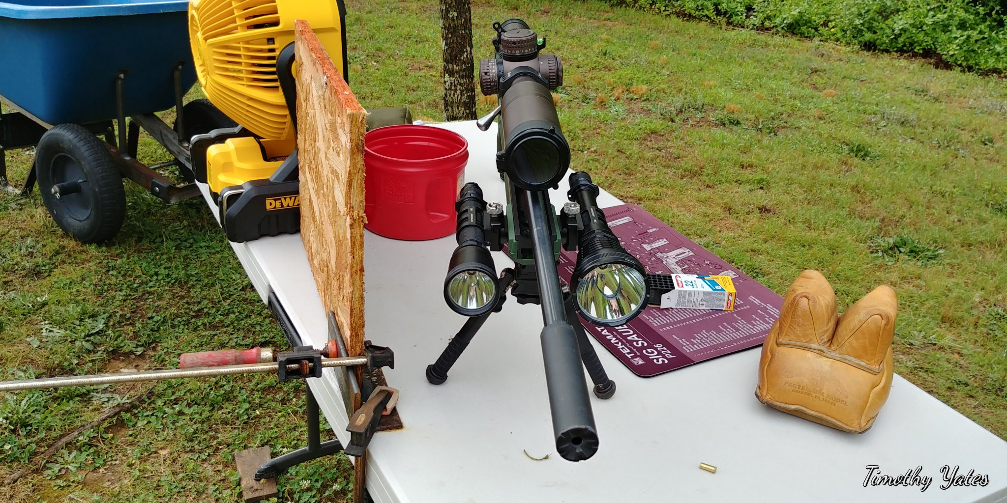

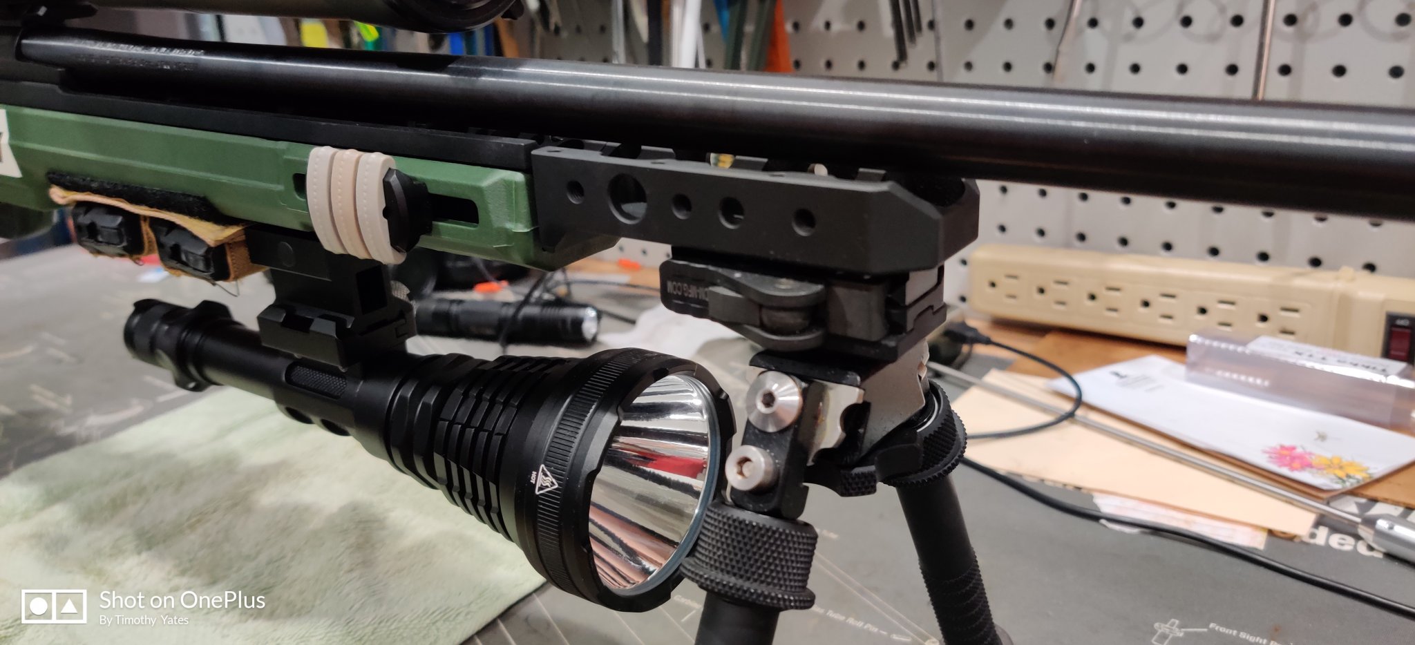

OK gang, I have a Tikka in a grey KRG Bravo, I also have an Area 419 ARCA 14" rail on it, which is supported by the KRG spigot and a custom spacer block. I can get a few pictures to everyone if that doesnt make sense.

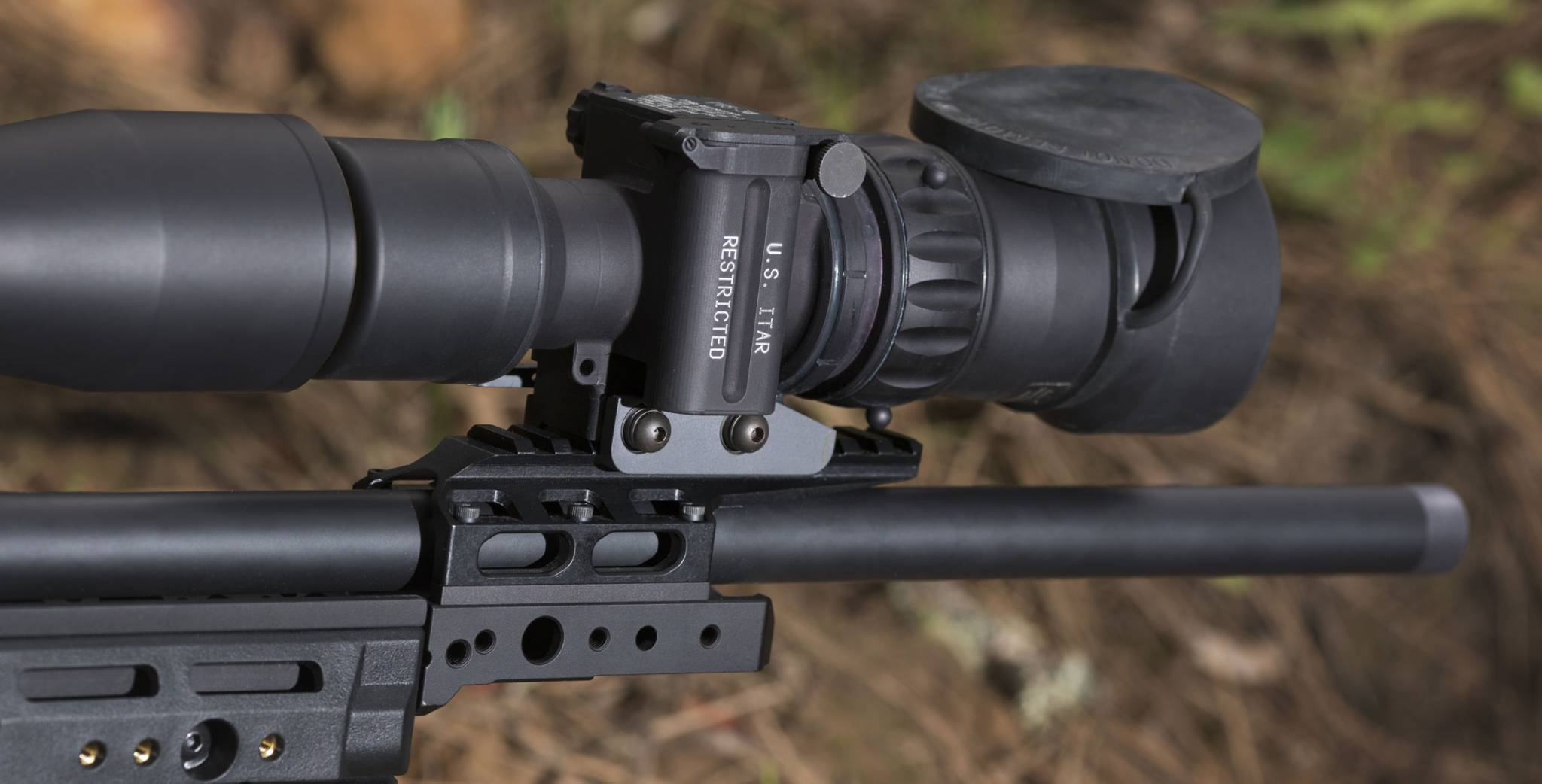

I have a question about the KRG nightvision cap options. Either the backbone mounted one (since my T1X backbone has the new hole pattern on top) or the spigot mounted one. Which is better, and why?
I often end up with my hand near the barrel, and think the protection would be good. It adds a little weight at the right point, since my rifle is still tail heavy, which is not typically how I like my match guns to balance (i dont want to add too much more weight with the KRG weight kit, for offhand, I think this can help). How much will this impact the balance of my rifle?
My other logic is that I can mount an offset flashlight to it with minimal barrel shadow for when i am hunting squirrels at night.
Does this make sense? What would you do, and why?

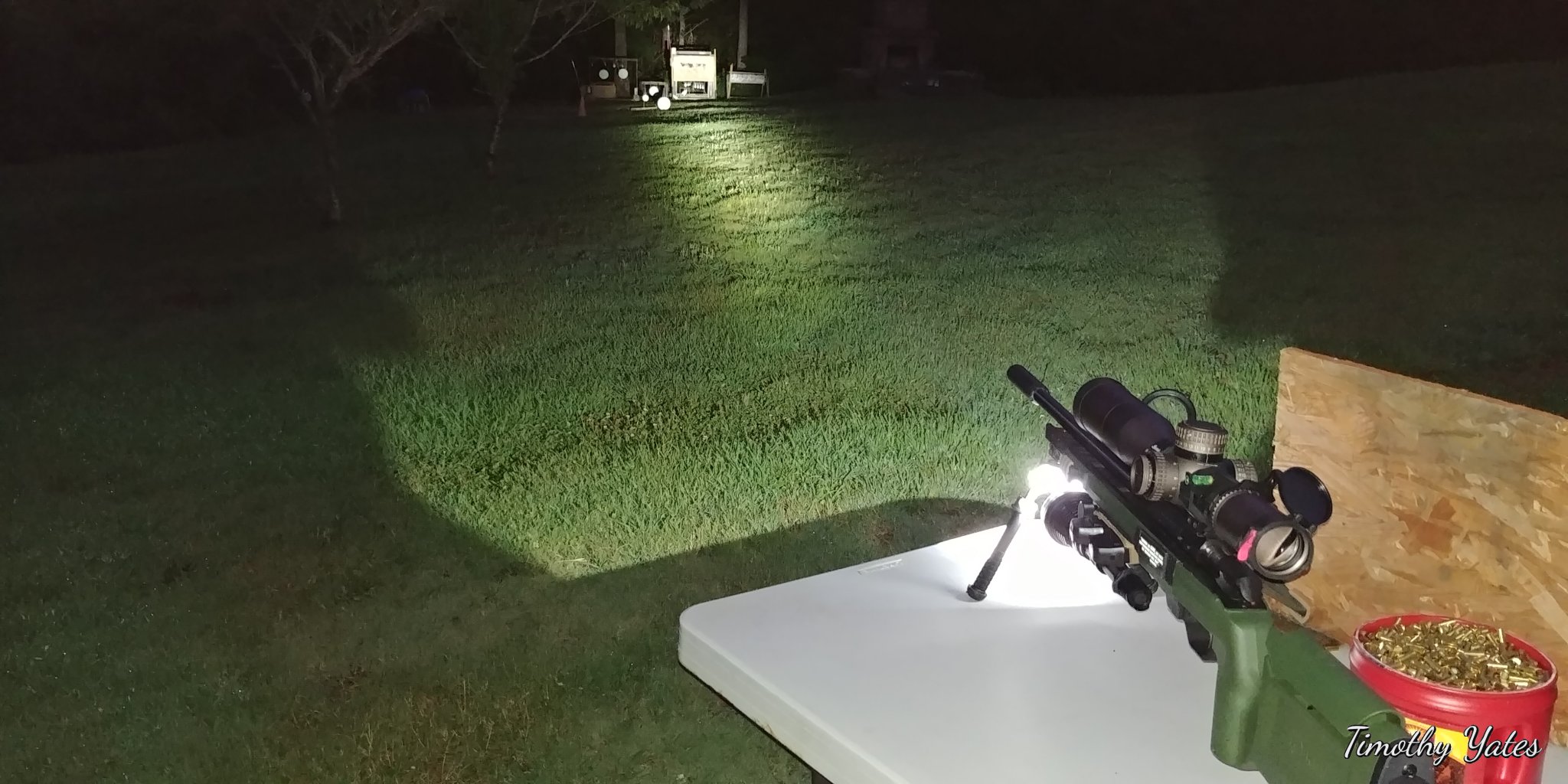

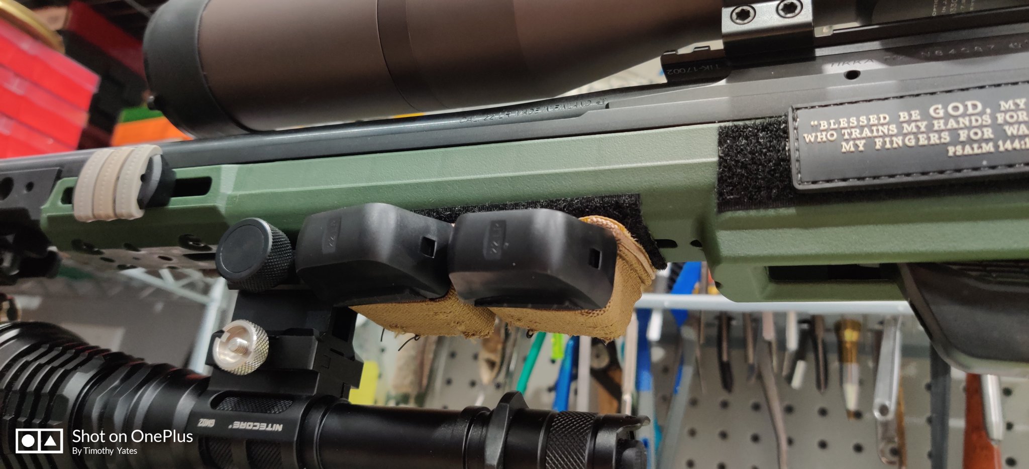

Let me introduce you to the Night Stalker. It works really well for shooting at night. No obstruction, isn't in the way when carrying by hand, easy on easy off both the light beam and the flashlight itself. Pretty happy with how it sits. The KRG Spigot mount is needed if you want to use the light underneath and use a bipod. Even with this setup you could easily get your hand out front on the stock and the flashlight wouldn't interfere with your grip. Also, you don't have to use a big flashlight but once you get used to the output it's hard to put a smaller one back on. The mag holder is just there to.....hold mags lol. I mean, if I was hunting I wouldn't put mags in mine because the fit is not tight enough. When I go to the bench I get tired of rounding up mags so that's why mine is there.
Another thing about the spigot mount is you can buy a night vision mount cap kit that would allow you to mount a clip on night vision device. You could actually do that without the spigot mount with the newer Bravo stock.

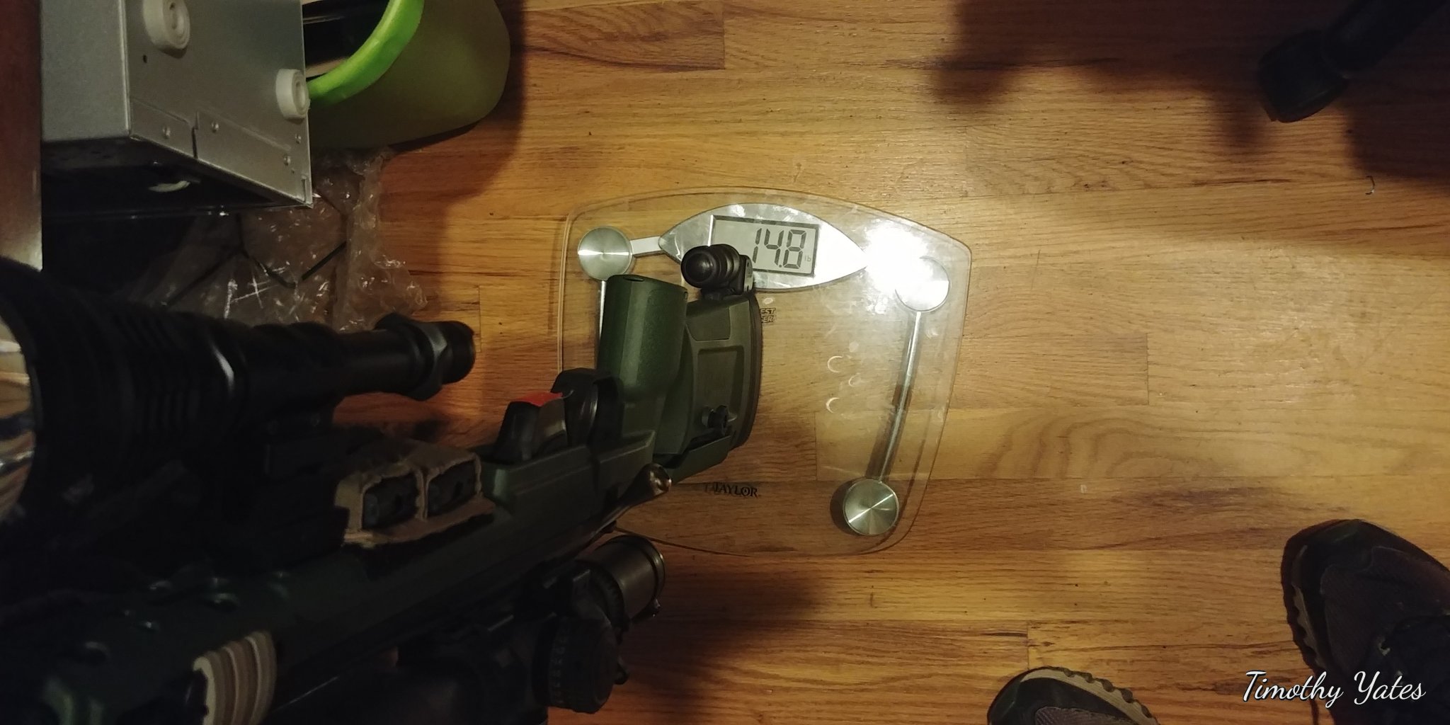

Rifle weight as shown. Can be a lot lighter with the removal of that scope. Scope weighs 46.5 oz according to Vortex's website.
Dual light setup. Wasn't effective because the larger light overpowered the smaller one. Two of the same size would work IMO.
I can give that a shot. I'm down to 20# as it is now, but I am in the factory stock instead of a chassis, if that world make any difference or not.

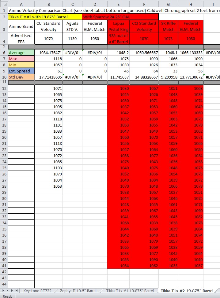

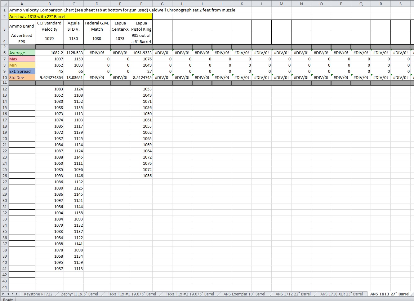

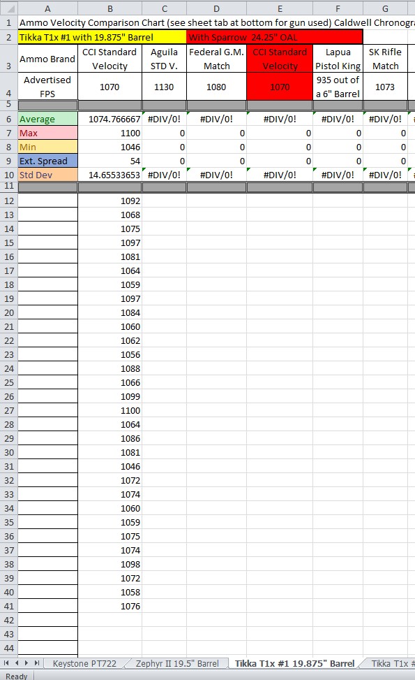

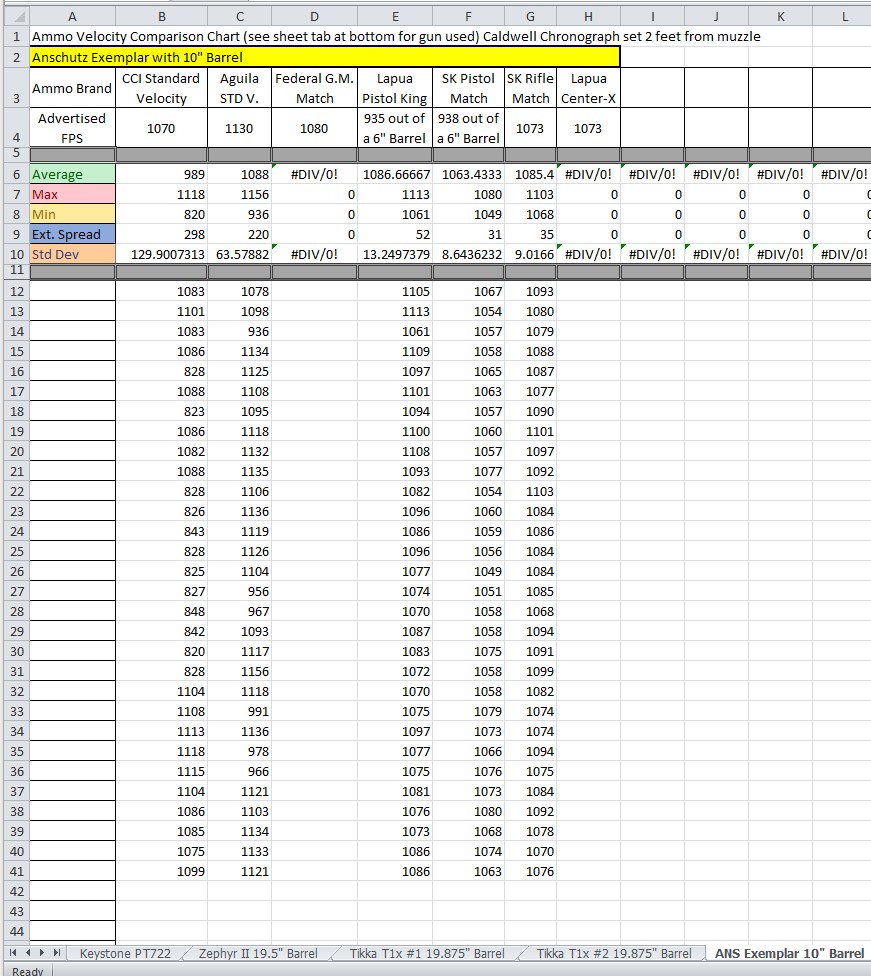

I also got a chrono out today and measured some stuff.
Factory T1X
Eley Contact
1050fps avg
SD 8
SK Standard Plus
1035 avg
SD 8
Out of my match barrel IBI Win52D Tikka
SK Standard Plus
1071 avg
SD 8
SK Pistol Match Special
1110 avg
SD 7
Lapua Center X
1078 avg
SD 10
I forgot to jot down the ES's, oops.
Would love to know for CCI SV
CCI SV with a variety of rifles. I rarely ever chrono test, have plenty of opportunity. I guess I don't put much credit into the FPS ES and SD. I mean, if it consistently shoots good for me at 55 yards I could care less about any of the other stuff. I mainly started doing this to check the difference in barrel length and what the optimum length "velocity wise" was for SV ammo. All CCI SV from the data shown is from the same lot number. More than likely shot on the same day.
