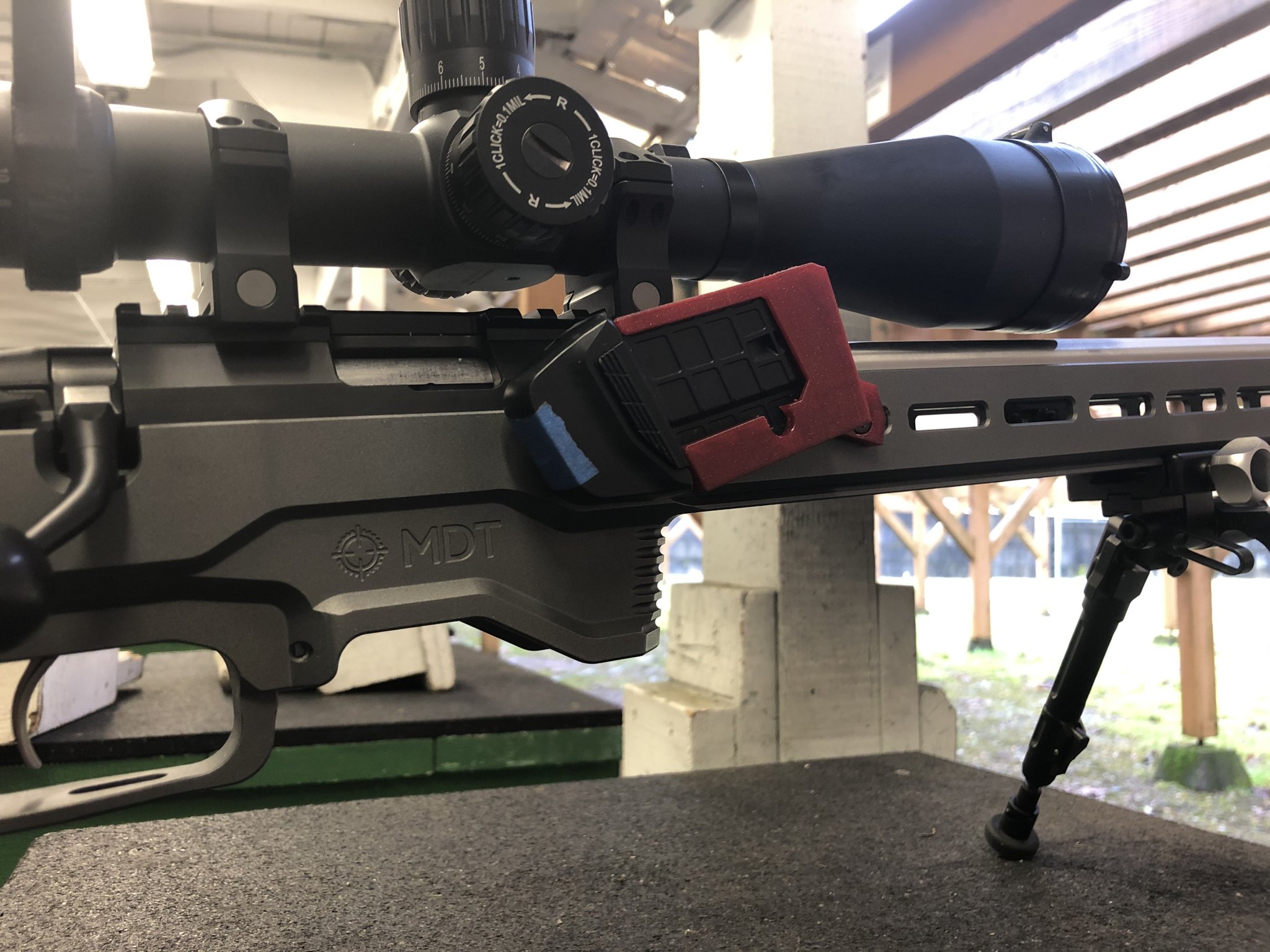

Your gun with a stock barrel sounds almost like my build. Thanks for the reply I will have to try out some tenex.
This was mine -
