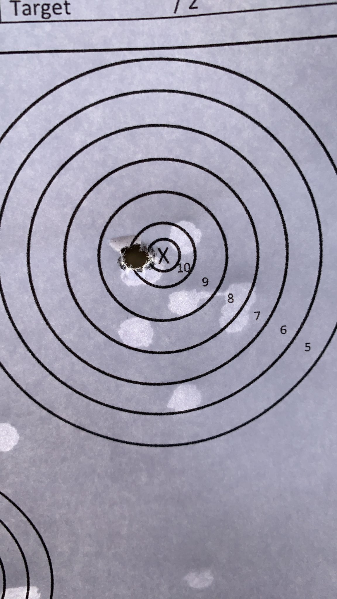

SKRM shoots best in my sons gun at 15”#, sub MOA, and only at that setting, anything above that and it averages MOA+. All the Eley we have shot, Club, Edge, Contact, Force as well as Wolf MT shoot tighter at higher settings. Edge and WMT like 40-43”#. MDT LSS chassis. YMMV
Any tests i should run before range day to I sure safety? I haven't backed the screw out all the way but quite a ways. I dropped the rifle but first on the bench 3 times and it didn't ignite. It's an NRL rig so live bolt open mag out...
Got to practice some today, needless to say I was impressed, best shooting I’ve done with the gun to date (federal match .22 902a I think?)
Not sure what I did to two of them but I’ll take it... I’m sure it was me... anywho playing with this rifle has convinced me to sell my savage and get a t3x ctr to match my .22, absolutely in love with this little guy
that was a 2 shot I was playing with match targets to see if I even stood a chance at trying to compete... super excited to see that pair but the other 3 left some to be desired... eh, nothing beats trigger time right?

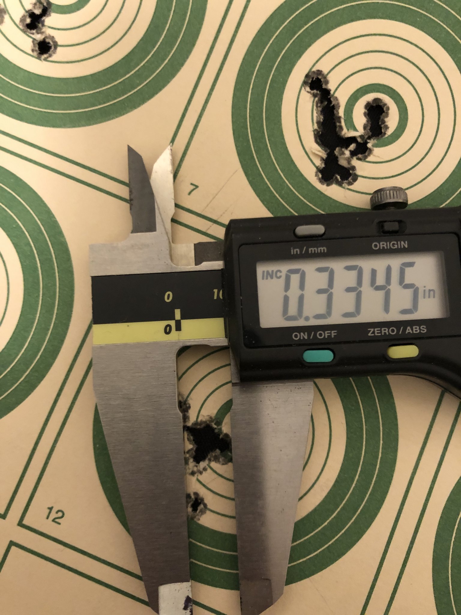

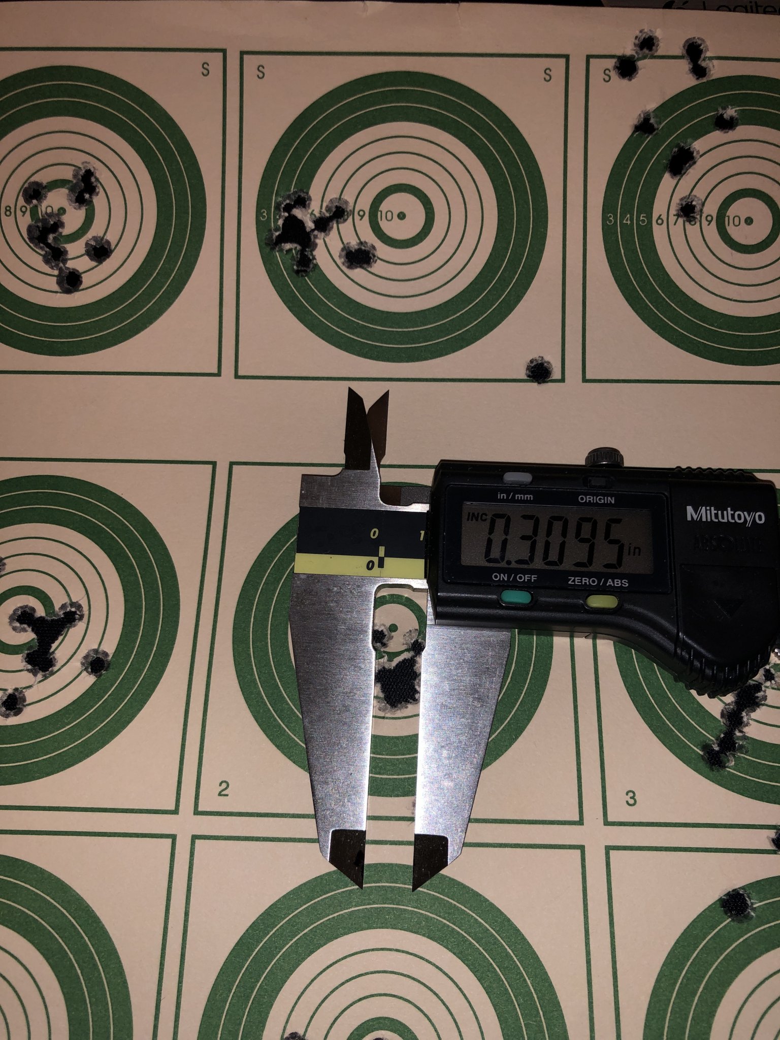

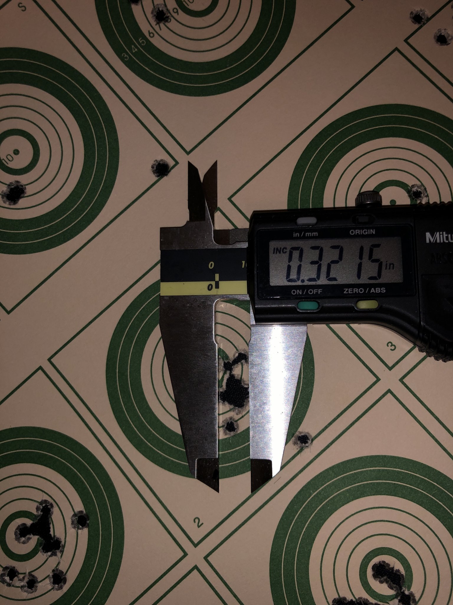

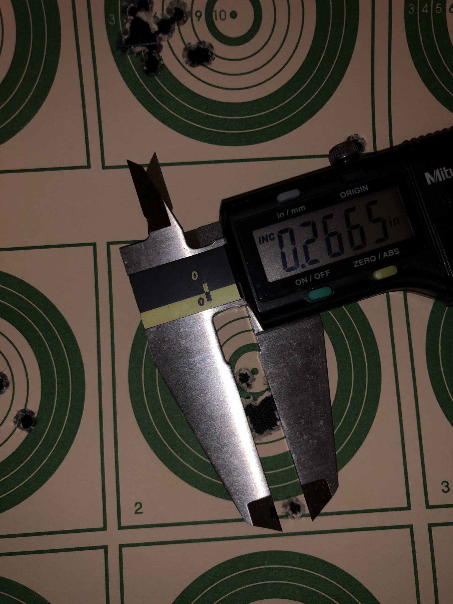

Lothar Walter barrel first spin:
I took the rifle out today, and it shot well. I, on the other hand, was having a very difficult time with the scope and it's eye relief (maybe I should have used the S&B Ultra Short).
The following ammo grouped very well at 25 yards:
- SK Standard Plus
- Lapua Biathlon Xtreme
- RWS Rifle Match
- CCI Green Tag
Unfortunately, it did not seem to like CCI polyimer coats HV ammo
I used two suppressors as well, and I found a minimal shift in POI:
- Sinlencer Co 22 Sparrow SS
- YHM Mite Stainless (with Sound Tech baffle system)
Subsonic rounds:
- American Eagle (OK)
- RWS Subsonic HP ( Grouped with bullet holes touching)
I'm going to need to run this again, as I was having a very difficult time with the eye-relief on the scope, and that was causing issues...
Ammo tried today:
- SK Standard Plus
- RWS Rifle Match
- CCI Green Tag
- American Eagle 22 Suppressor
- RWS Subsonic HP
- Prime 22LR (for Semis)
- RWS Target Pistol
- Lapua Center-X
- Federal HV Match
- CCI Clean-22 HV [polymer coated]
1) Supressor subsonic: AE (Left) RWS (Right)
2) SK Std Plus
3) Green Tag
4) Gold Medal HV
5) RWS Rifle Match
6) Lapua Biathlon Xtreme
....no, I'm not a 22 god.
9 shot groups as the mags were not taking 10 rounds... and I wanted to see actual groups.

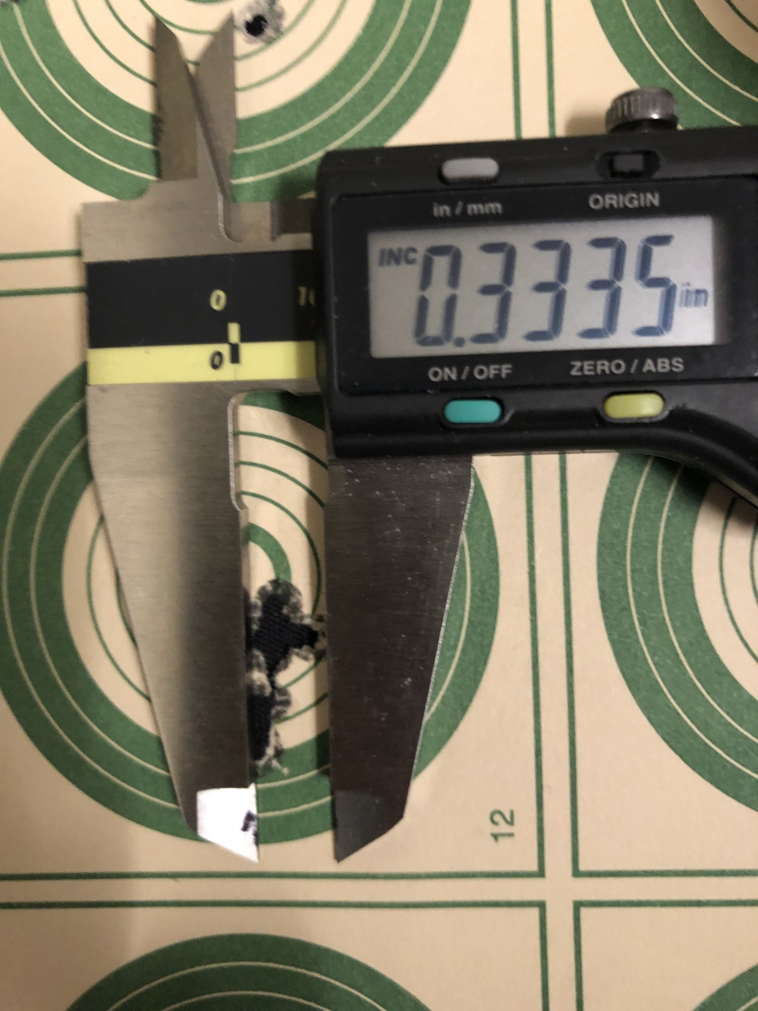

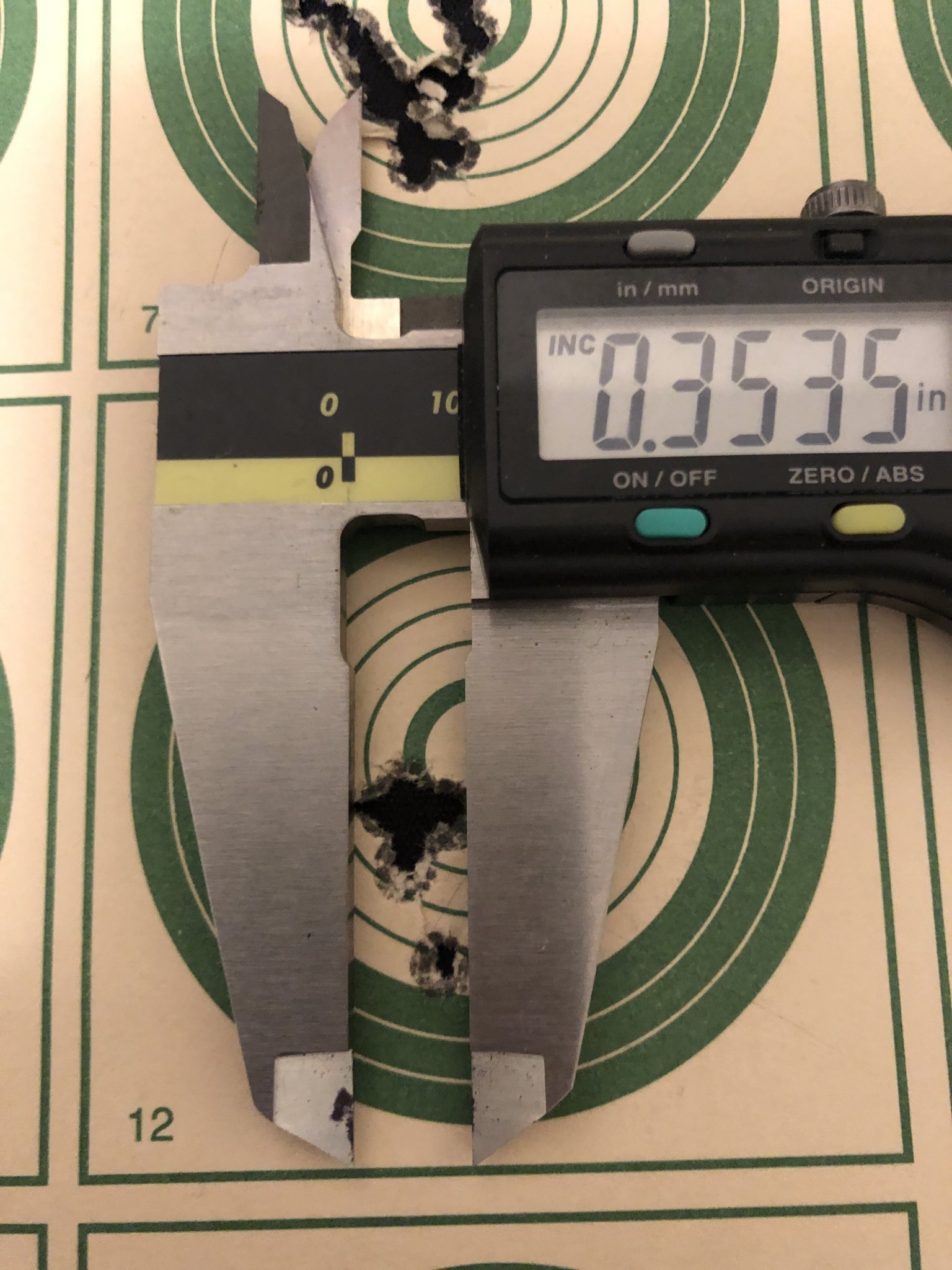

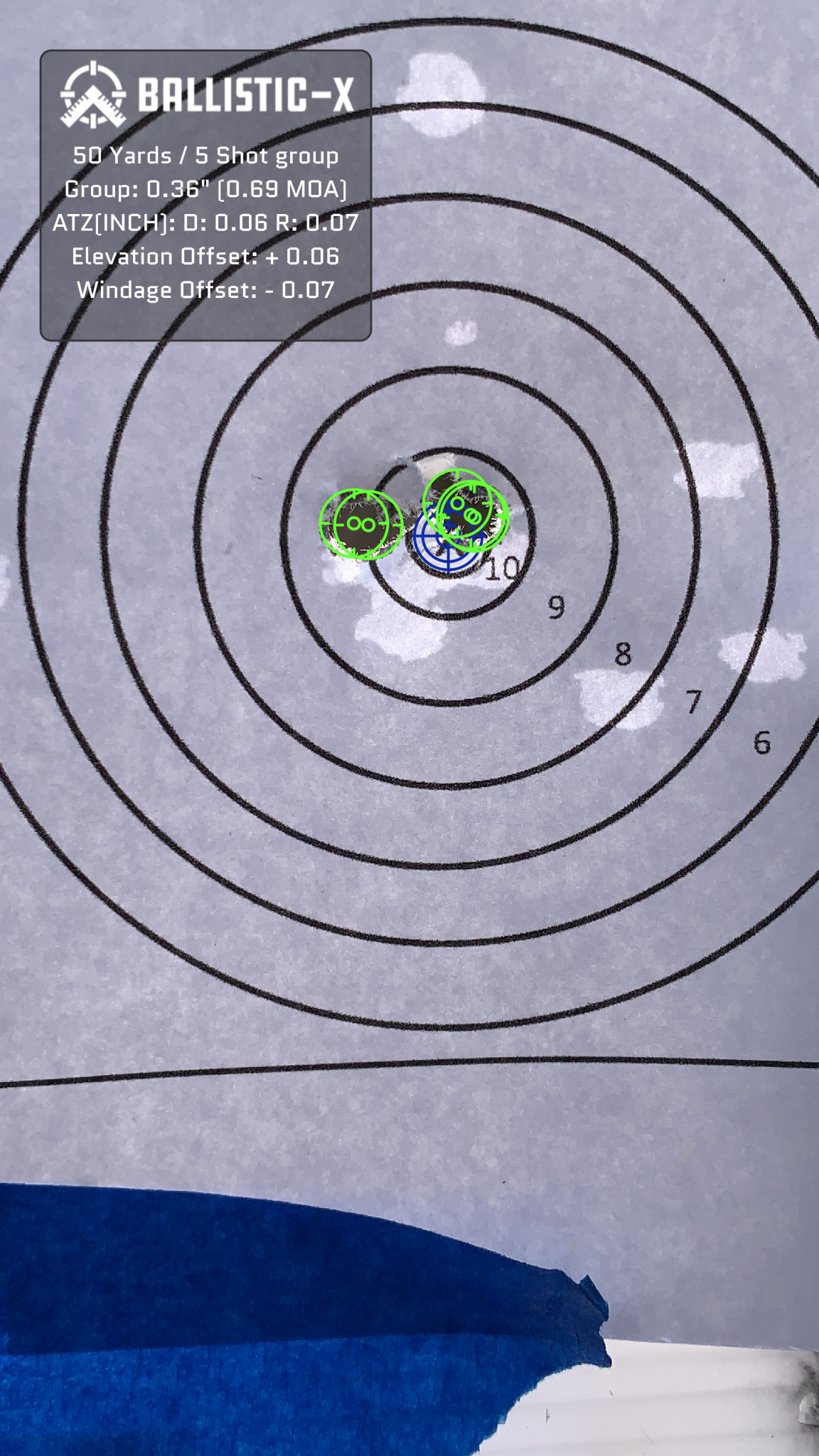

Lothar Walther Barrel (Remember, I suck at 22lr...) @ 25 yards...
Taget 2 is the Lapua Biathlon Xtreme with 5 shots in the group...
Target 12 is 6 shots of SK Standard Plus:
It also shot CCI Green Tag really well...
...and it also liked the CCI Polymer Sub-Sonic... which is really standard velocity
