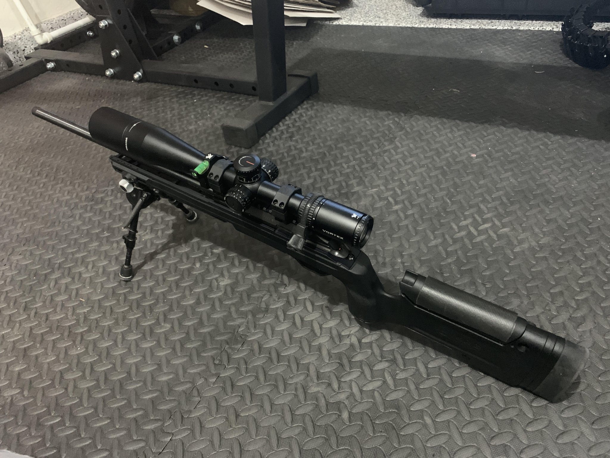

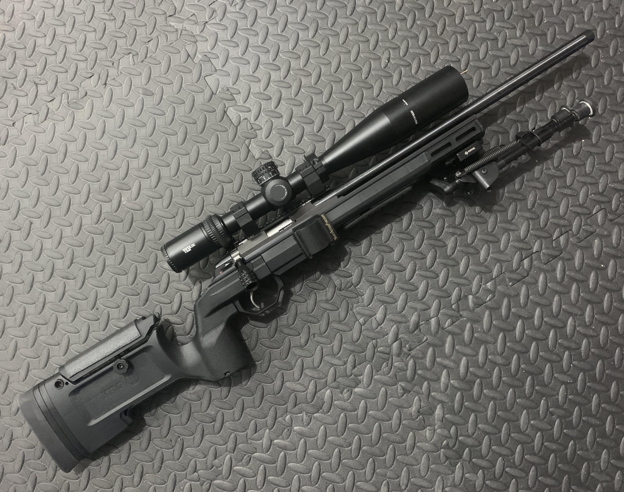

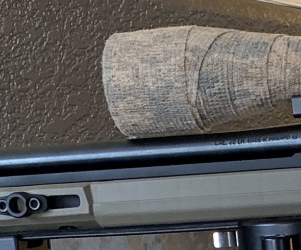

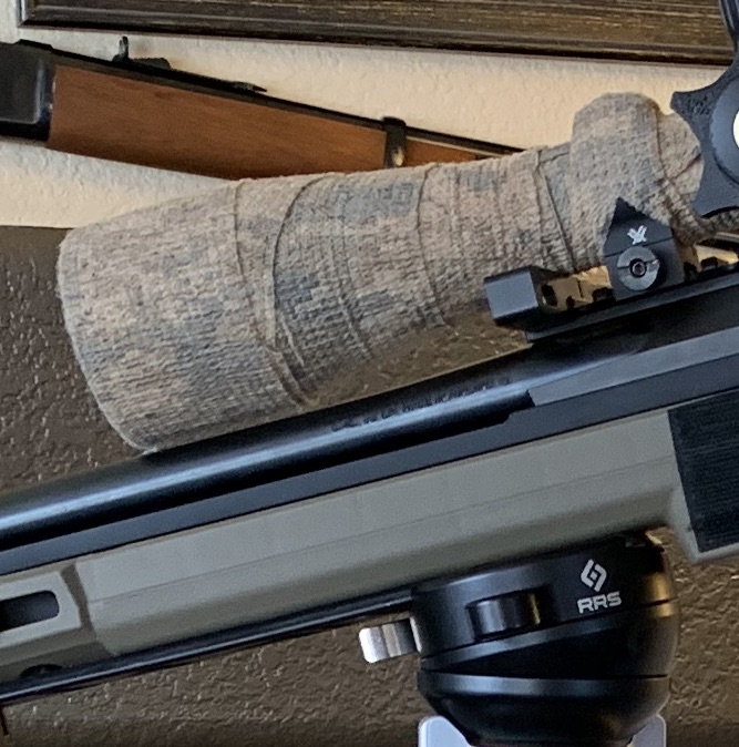

Here's a couple of my T1x. Specs as follows:
  • Stock barrel and trigger
  • KRG Bravo for T1x
  • Area 419 30 MOA rail
  • Vortex Viper PST Gen II 5-25 EBR-2D FFP MRAD
  • Vortex Precision Matched Rings 0.97"
  • Vortex bubble level
  • Optic throw lever from Amazon ("breakaway nylon coaster")
  • Sterk pineapple bolt handle
  • Harris 6-9" bipod (w/ KNW pod-lock, Really Right Stuff Arca/Picatinny adapter)
  • Short Action Precision extra magazine holder
  • Anti-slip cheekrest pad from Home Depot
Rifle is zeroed at 25 yards, with sub-MOA groups using SK Standard+ at ~1069 fps, MOA-groups with CCI SV @ ~1050 fps. Using Strelok Pro for my ballistics calculator, although the Hornady 4DOF app also gives really similar charts.

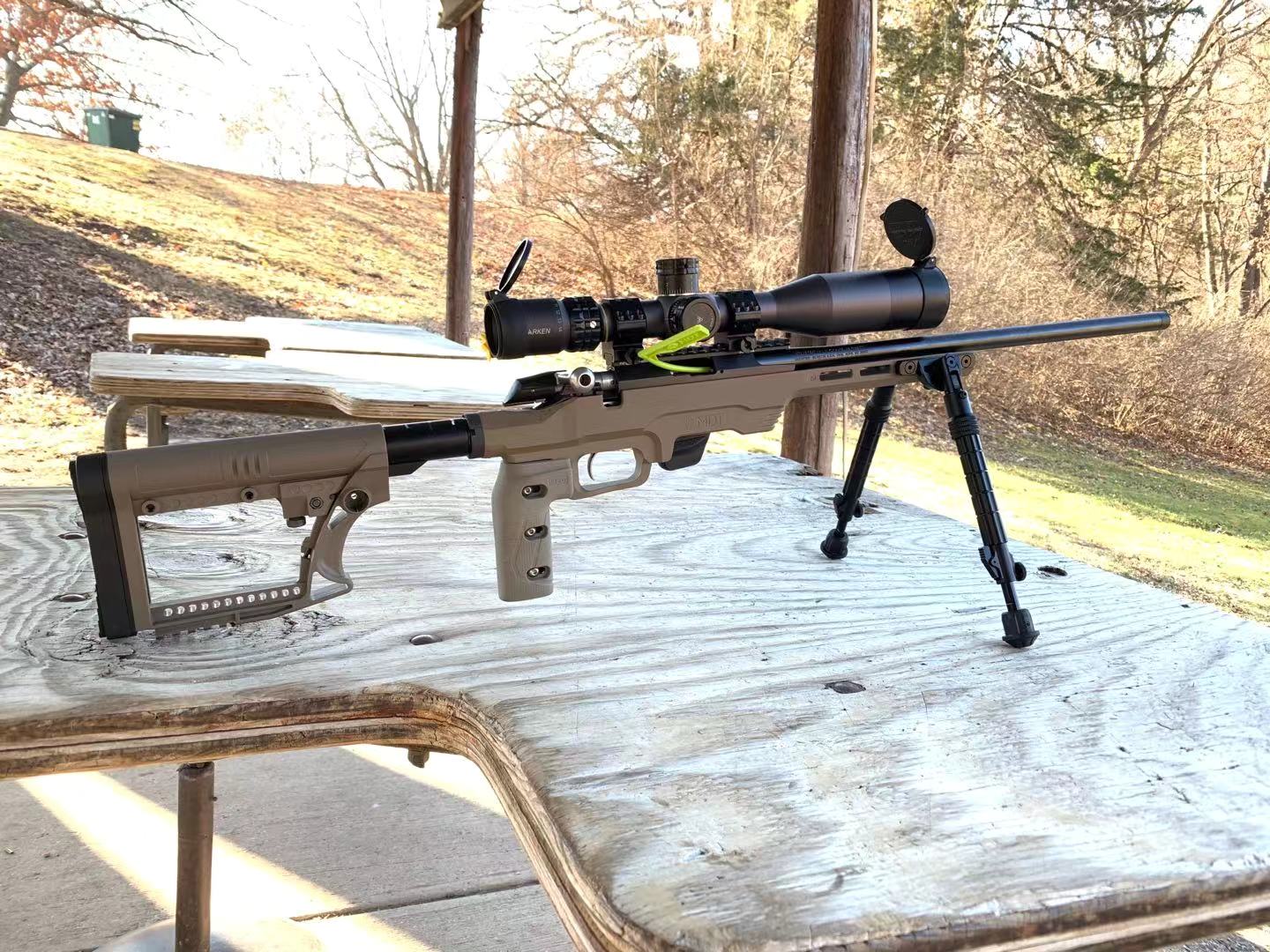

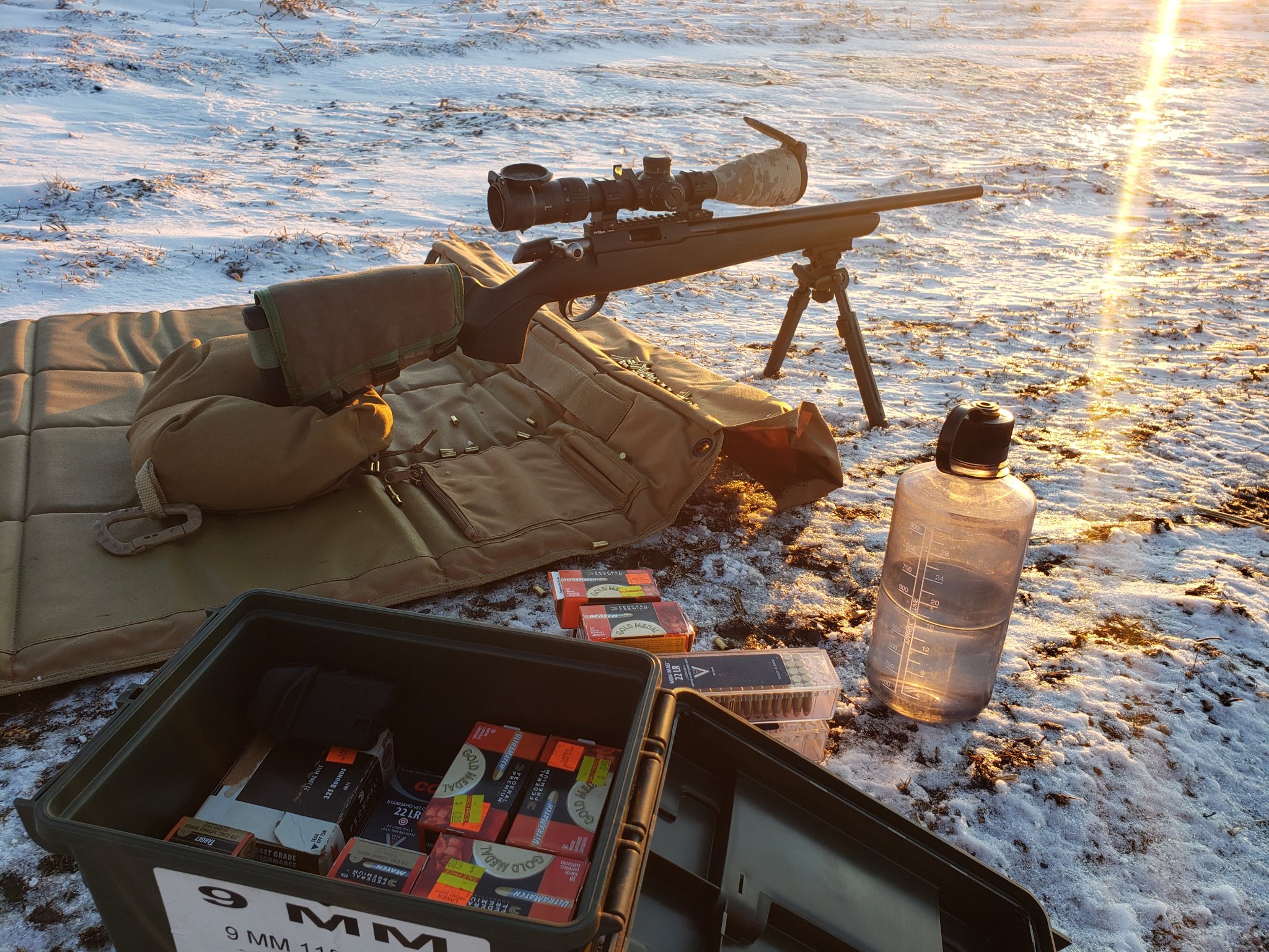

Finally got a chance to get this thing out to get ready for NRL22 base class. Vortex Diamondback Tactical 6-24 scope, Area 419 15 MOA rail, Triad Tactical thing and magpul bipod. 19 degrees, about 3 mph wind left to right. Overall fairly promising on groups at 50 yards. Lapua and Federal Match looked the best. A few good groups with CCI greendot too. SK rifle match looked good right away but opened up as I shot it more. Really nothing shot really bad. Ejection right away was pretty embarrassing. Bent the ejector paper clip out a little more and it improved. Seems like a pretty shit design right there. Did they run out of time before release for production or what? Next is to move it out to 100 see what ammo performs.

Just sayin....great looking rig!

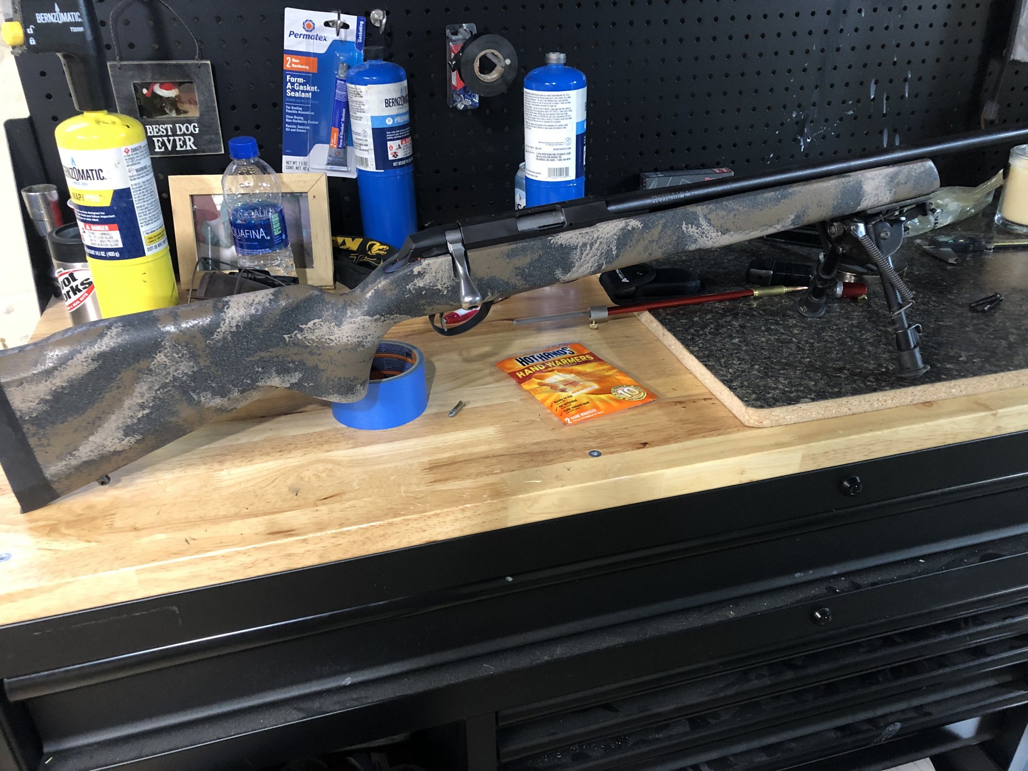

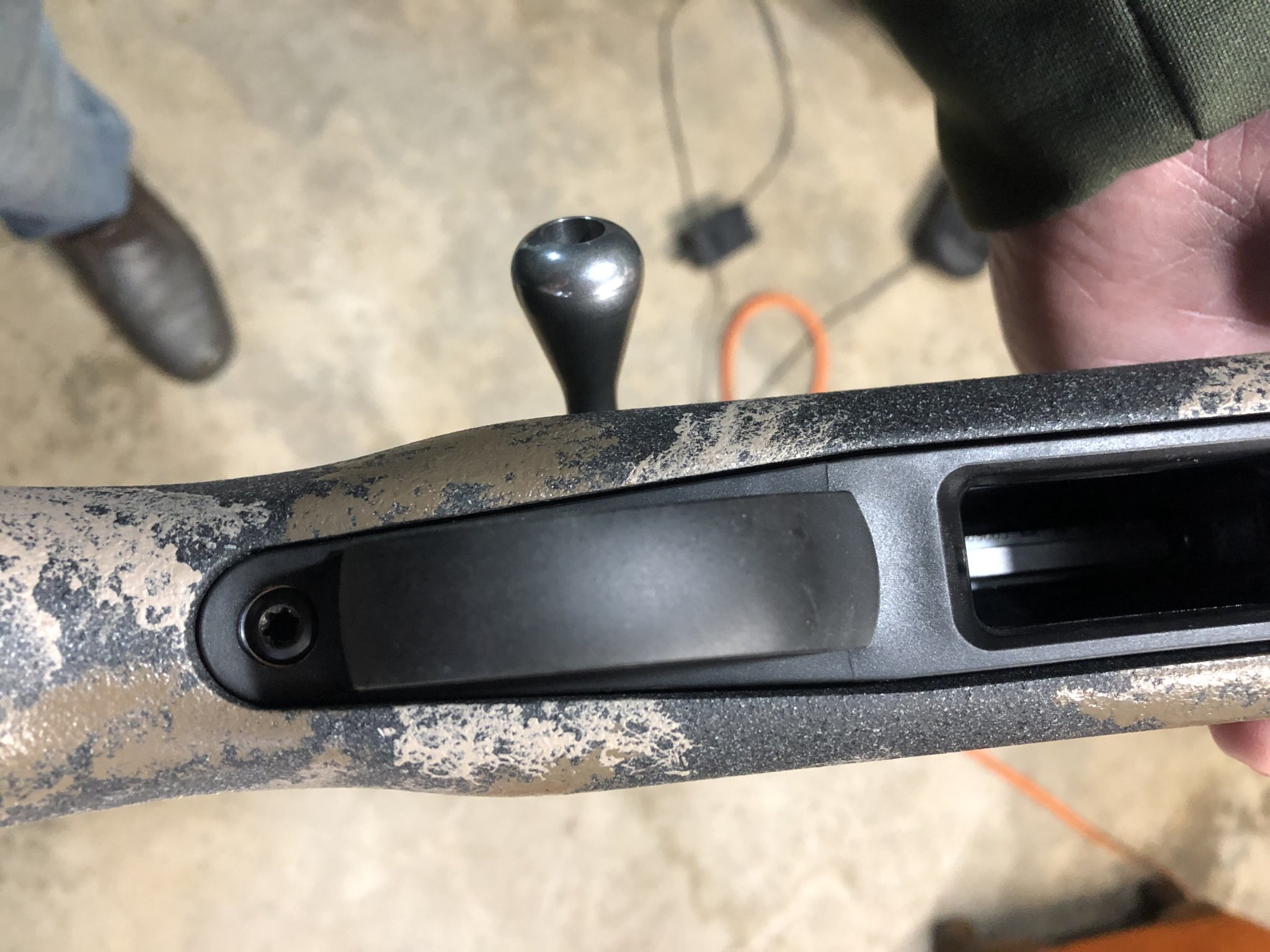

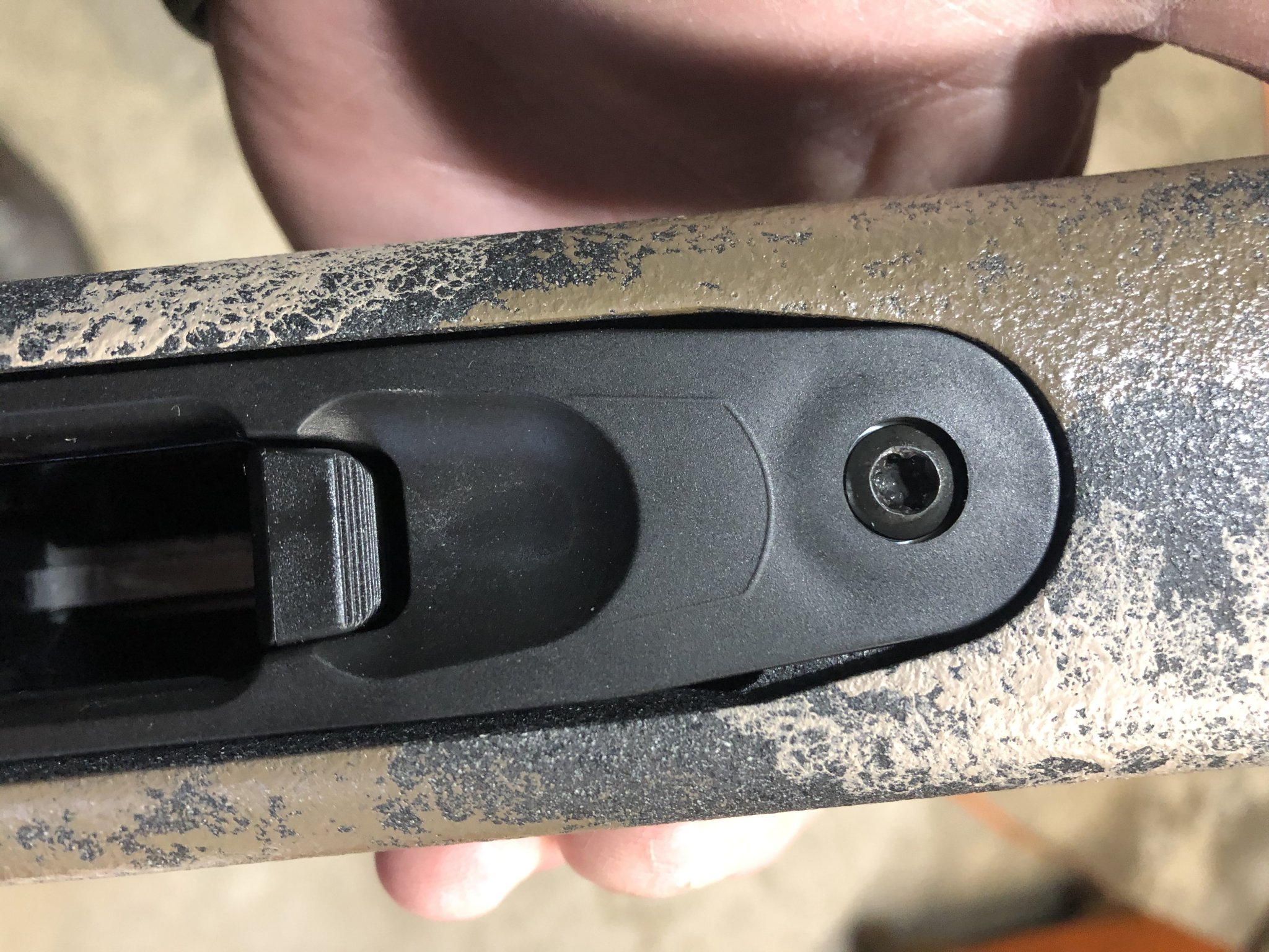

Any reason I can’t run the T1x factory bottom metal in a cdi inlet stock? Fit isn’t perfect but seems to feed fine.
