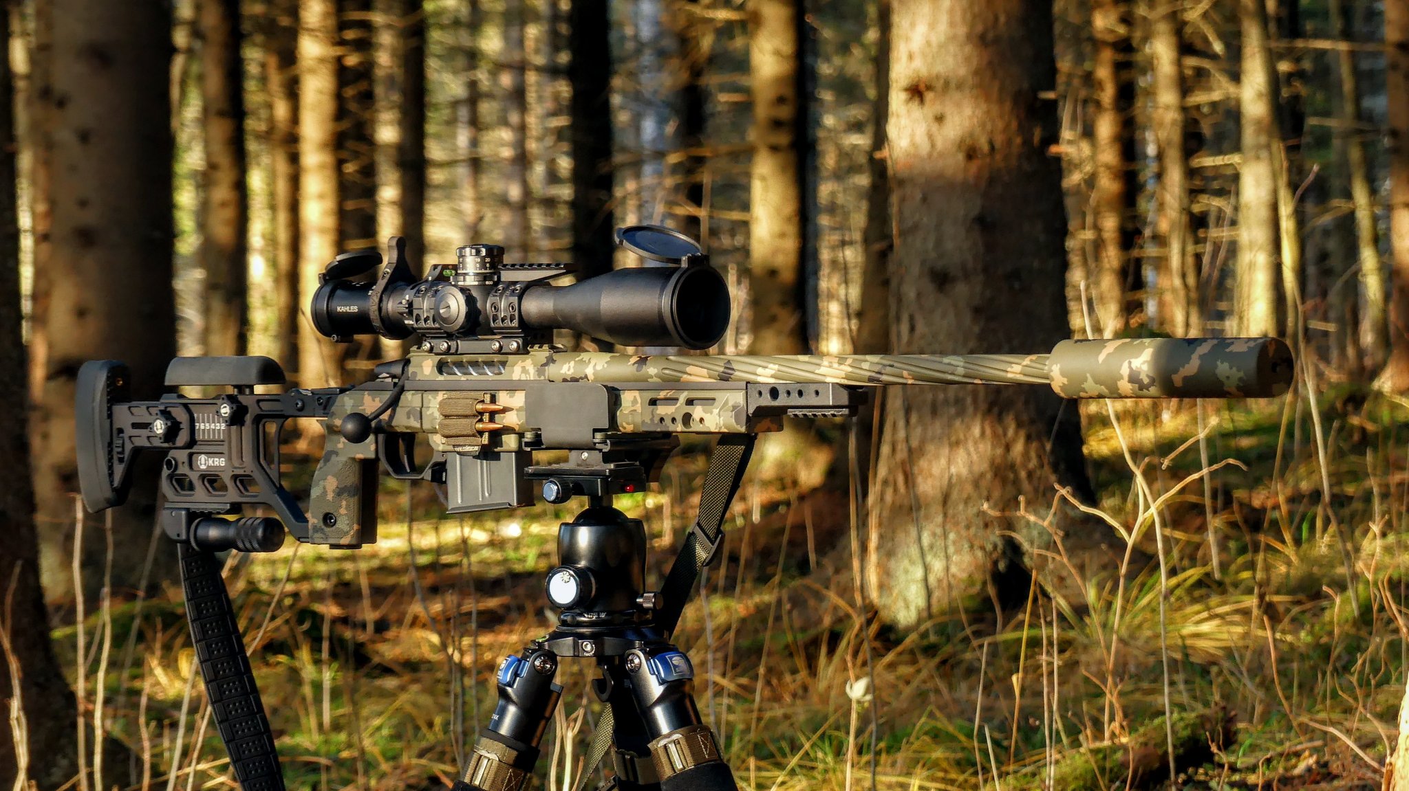

Today i was testing first time my new customized T3X.
I had ladder test with Lapua Scenar 123gr, loaded in Lapua brass and Vihtavuori N150 powder.
By far the best was 39,8gr load, i have not even go for the landings, and brass was full sized.
Krieger barrel seems to like 123gr Scenar, 0,34MOA 5 shots at 100-meter, other load was also unDer 1/2 MOA.
Next to get the bullet close to landings, and see if it shoots even tighter.
Also tested new JAKI titanium super suppressors.

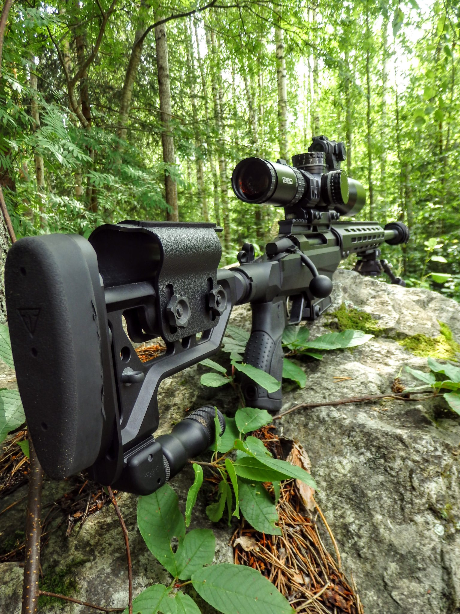

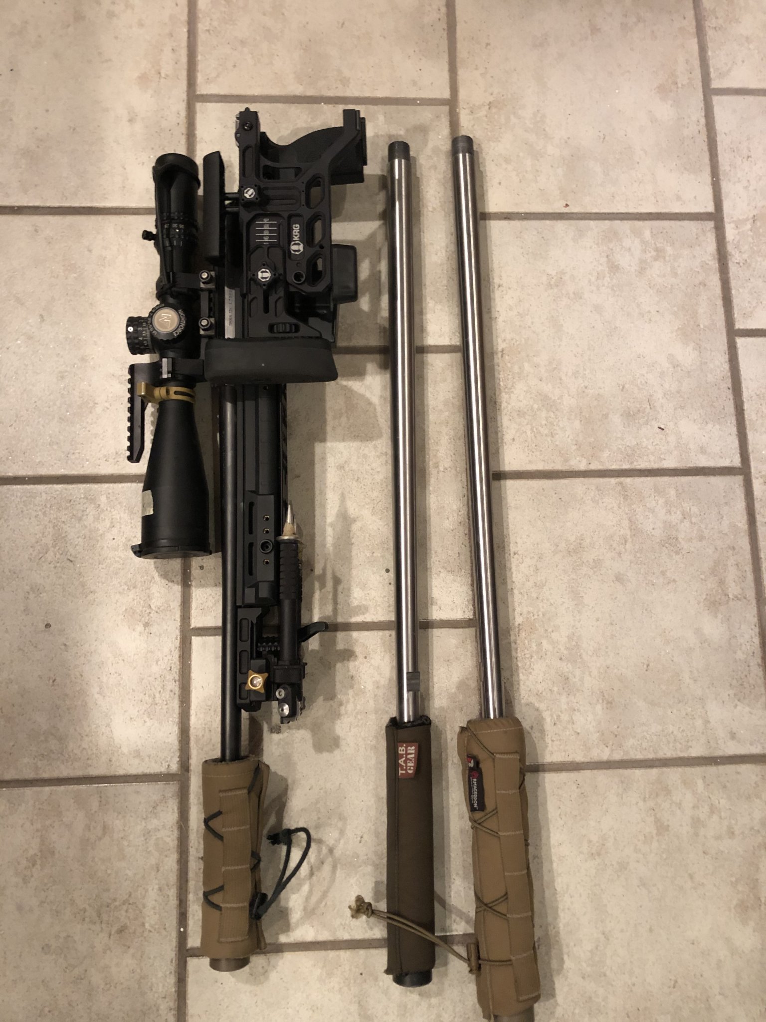

Thanks - yes it is tac a1 as yours and the scope I have is vortex pst gen2 5-25x50, so the same setup.
if you raise the cheek rest. Does the height of these rings still let you properly look through the scope?
Thanks again!
that first picture is from before I had adjusted anything, and just mounted the scope.
This is how it sits today, and the cheek rest is about right for me at this height. Also, in this pic you can see the gap between the scope and rail a little better from this angle.
