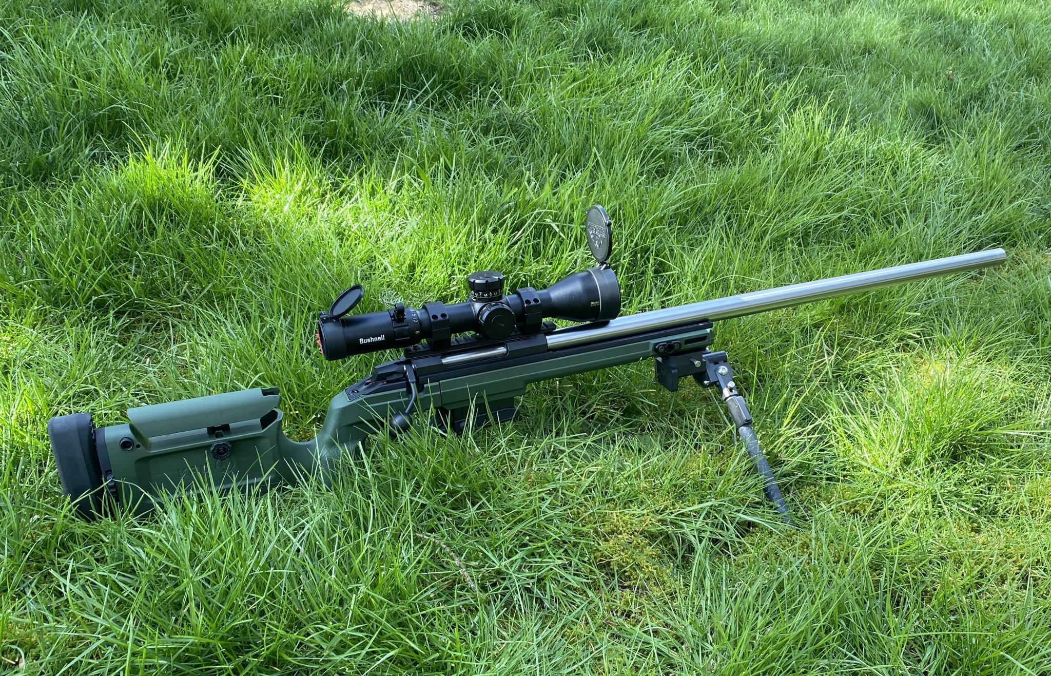

As the standard barrel is not the thickest one, I guess accuracy would either get better than worse.
I´ve shot the StGw90 out to 600 meters as well, prone unsuported with iron sights.
Worked pretty well also.
I dont think that 3000 fp/s is not bad for 55gr bullet, sure it might be more drop on 77gr, but it´s not an issue for me.
Most cases barrel shortening will increase it stiffnes, so it might be even more accurate as it was in 24".
But will see, this was interesting test, that´s why i choose it to go on 18", since we use suppressors, that 2" did make it
quite compact package.
And that this 223rem Bravo chassis rifle is my son, so i believe we can make it shoot and handle better than it was with longer barrel ;)

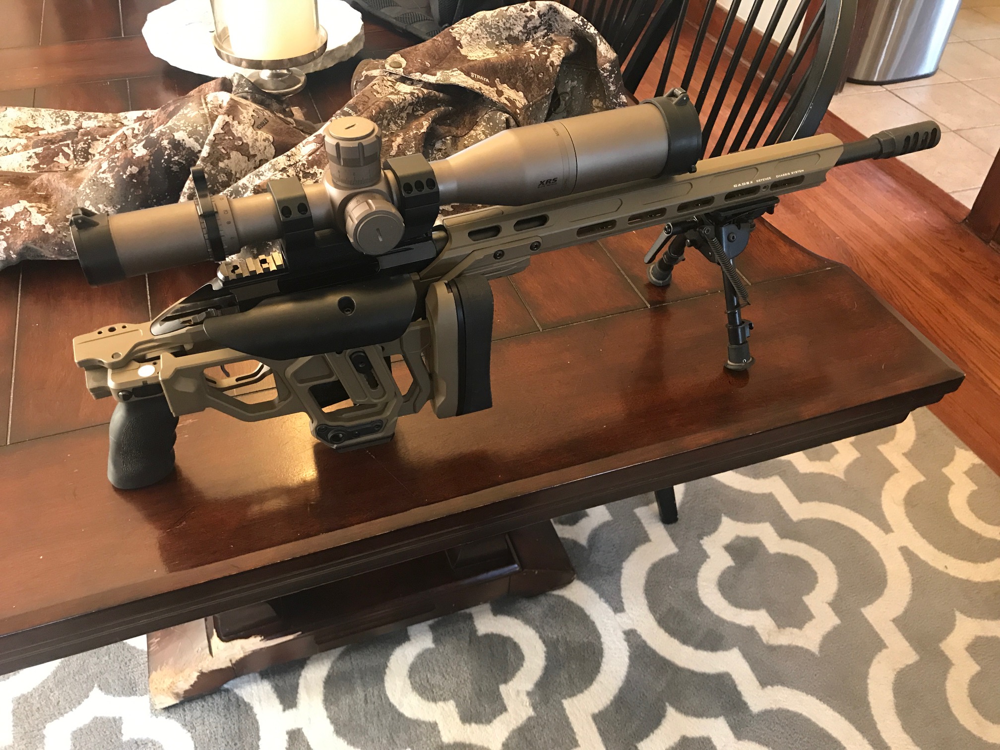

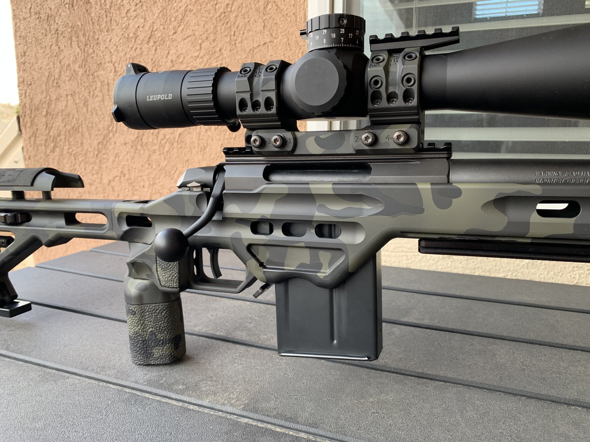

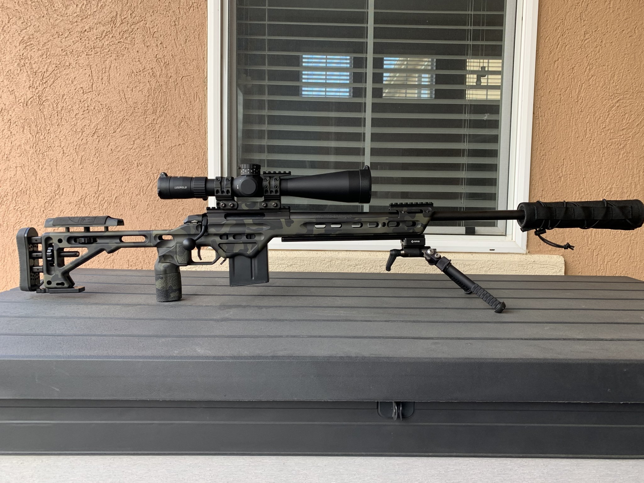

Finally got this one together. T3 in .260 with TBAC Ultra 9 and Mk5 7-35 CCH in Spuhr 5002. Thanks to Branden at Custom Gun Coatings for the paint job.
EDIT: Forgot about the Sterk handle and shroud, KRG Midas Trigger, Atlas CAL w/RRSS BTC-Pro Mount.

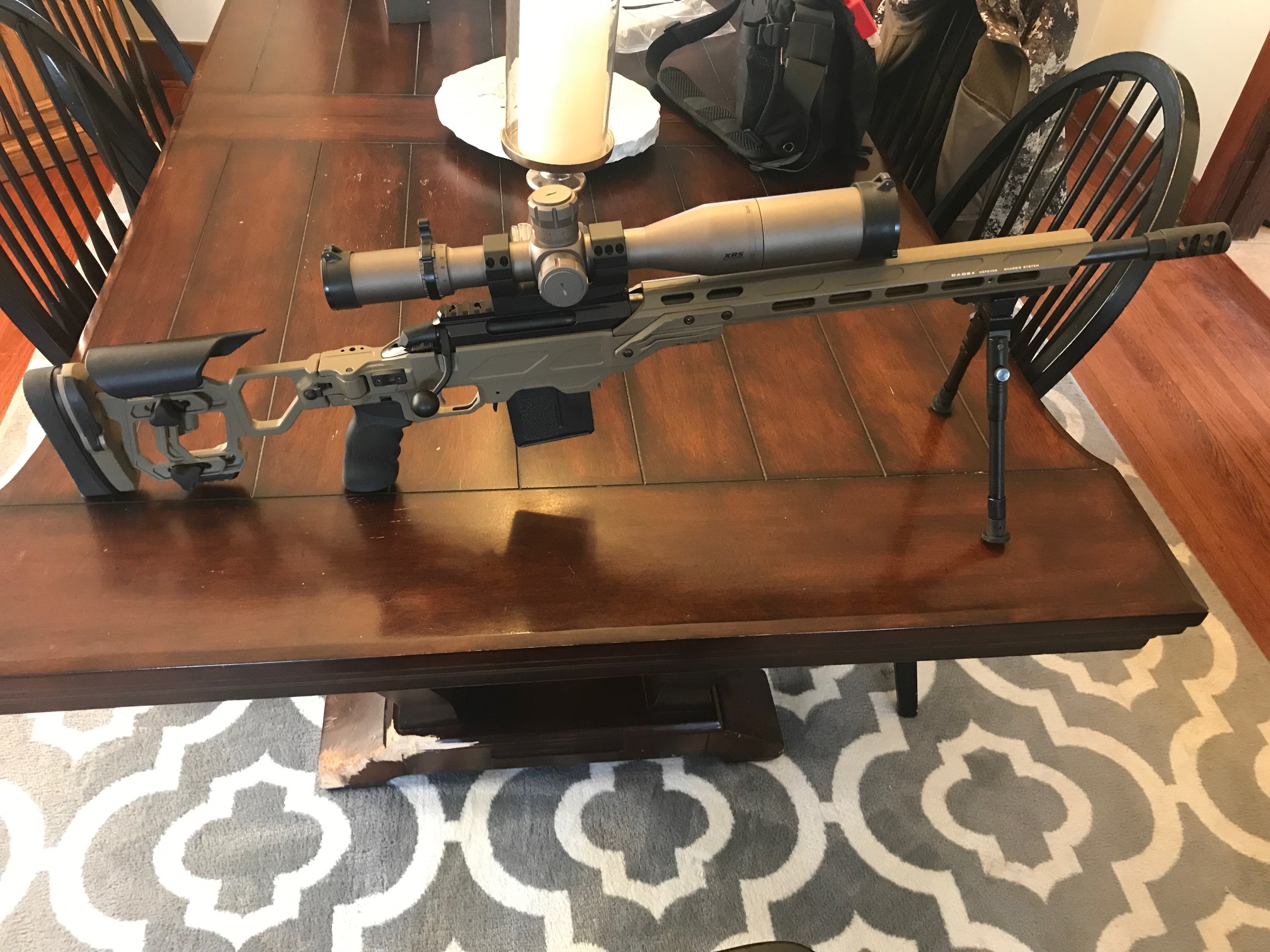

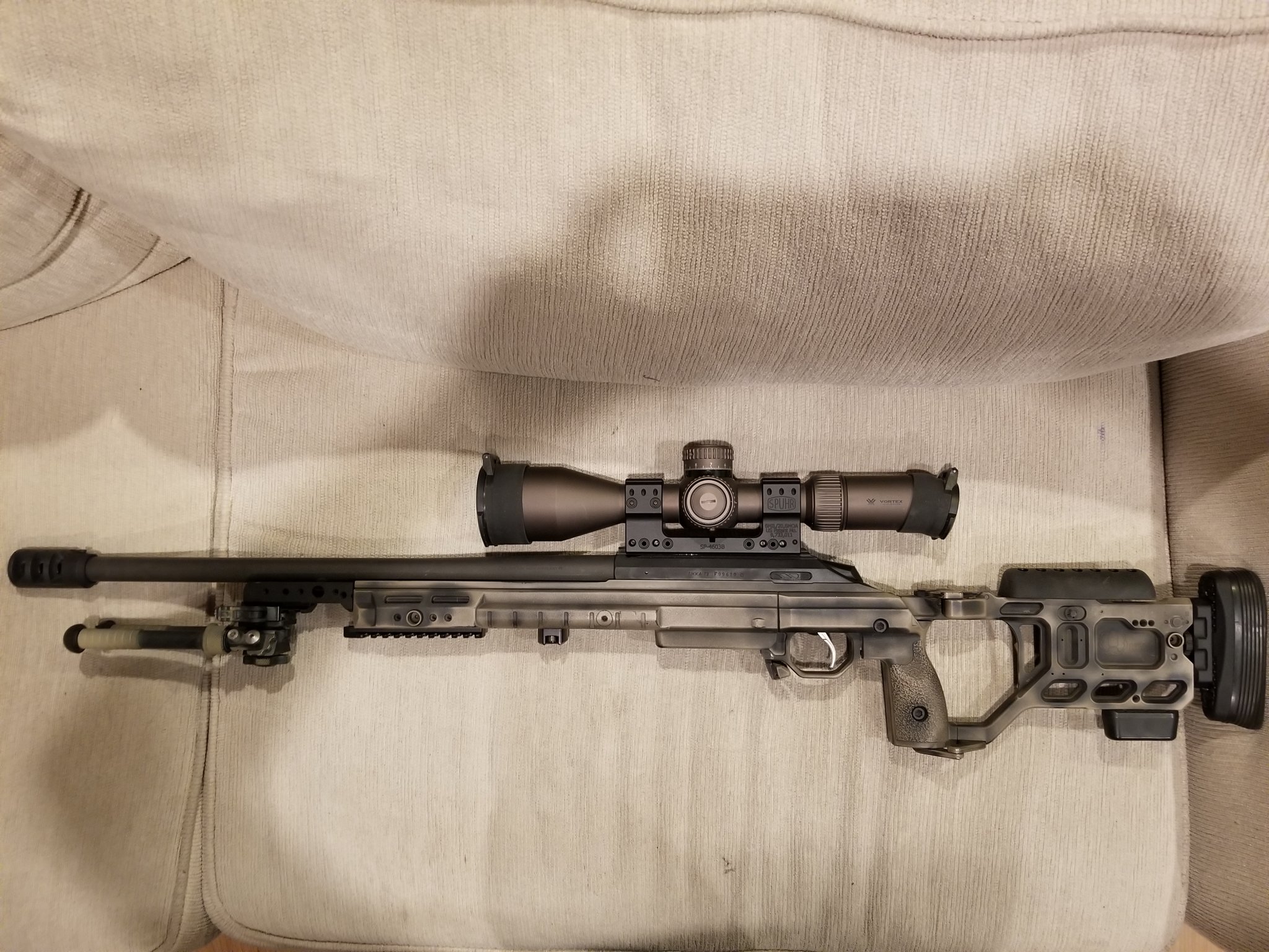

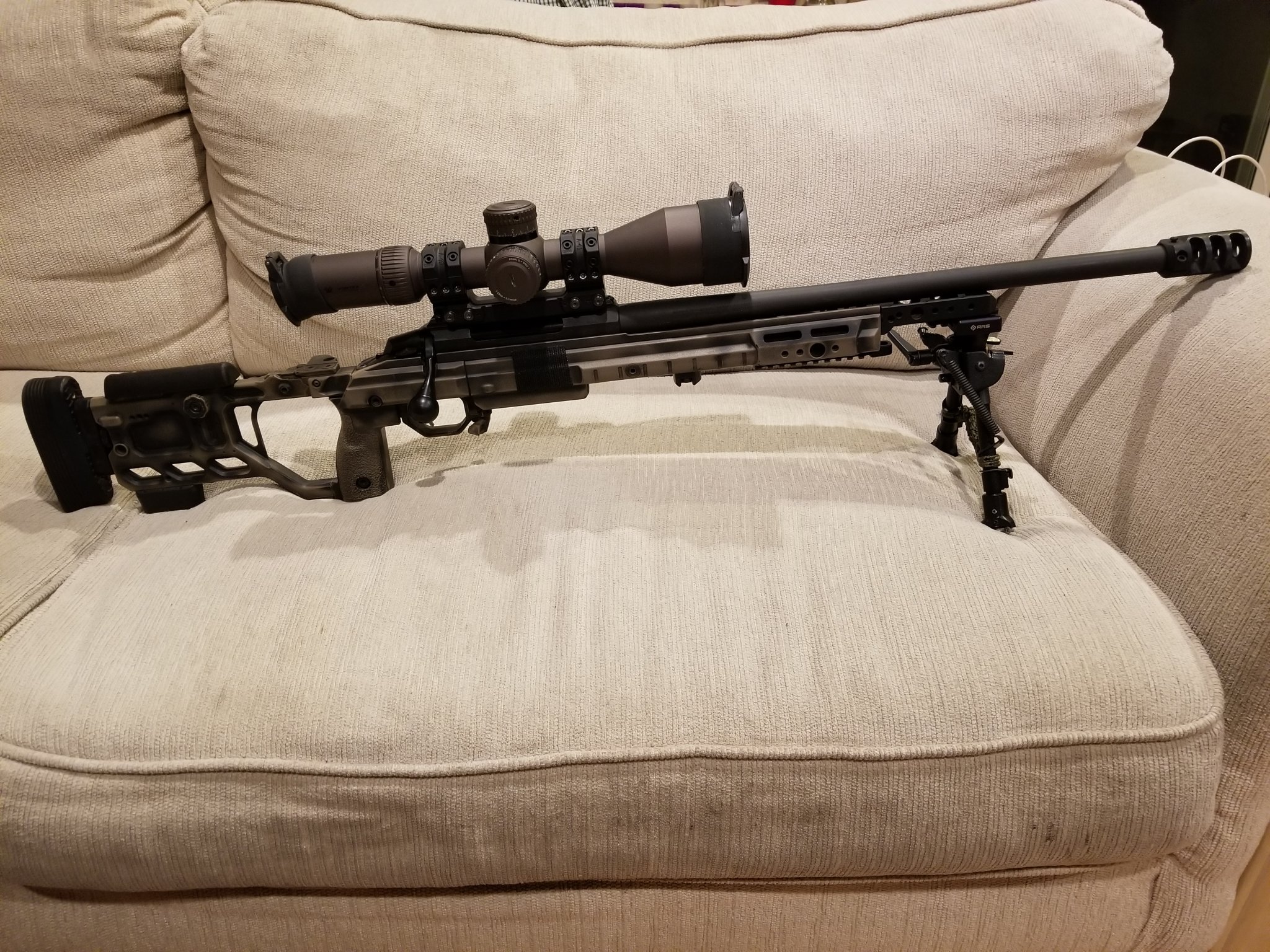

what is the opinion about changing the stock tac a1 chassis for a krg bravo ....?
do or don't ...?
thnxs
chris
I would rate the TAC A1 the "better" stock.
More options and settings.
The only advantage I see in the Bravo is the weight though, if that any matters.
If not, stay with the TAC A1.
Just my 2cents.
On the other hand:
You can have my Bravo for the A1 ...
:cool:
do or don't ...?
thnxs
chris
Well I moved to a GRS Bifrost to save about 3lbs. I like my new setup and it appears just as accurate. At 61 years old, I will appreciate the weight savings as I age. If I was 10 years younger, I would say "no". (By the way I am limited to stocks because I am right minded.)

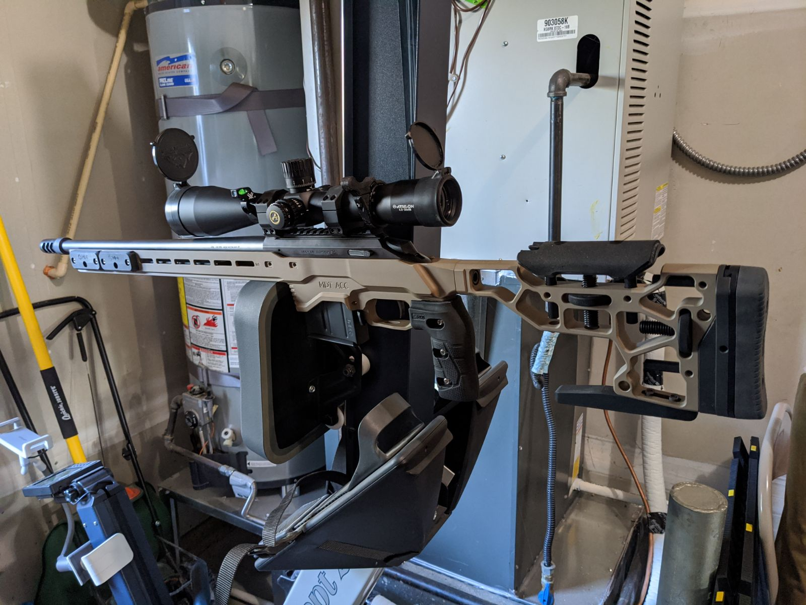

Factory CTR in the MDT chassis was super butt heavy... had to end up adding 4 internal weights, and 4 external weights to get it to balance in front of the mag well. I could probably add 1 more internal weight to get it a bit steadier, but I wanted to save 1 weight for the Vudoo. Looks like I'll need to buy a few more weights, or I guess when the suppressor comes in that'll help.

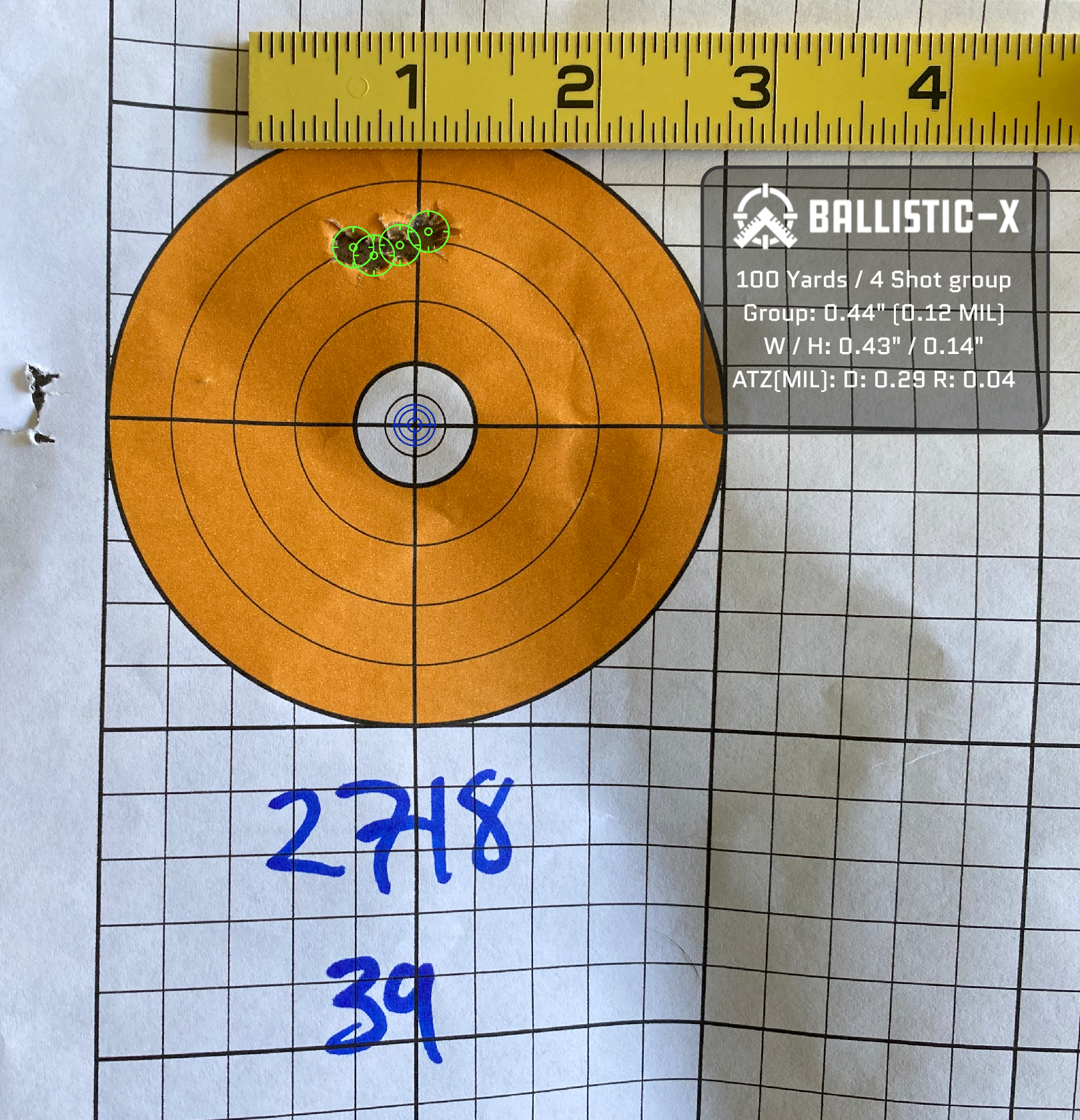

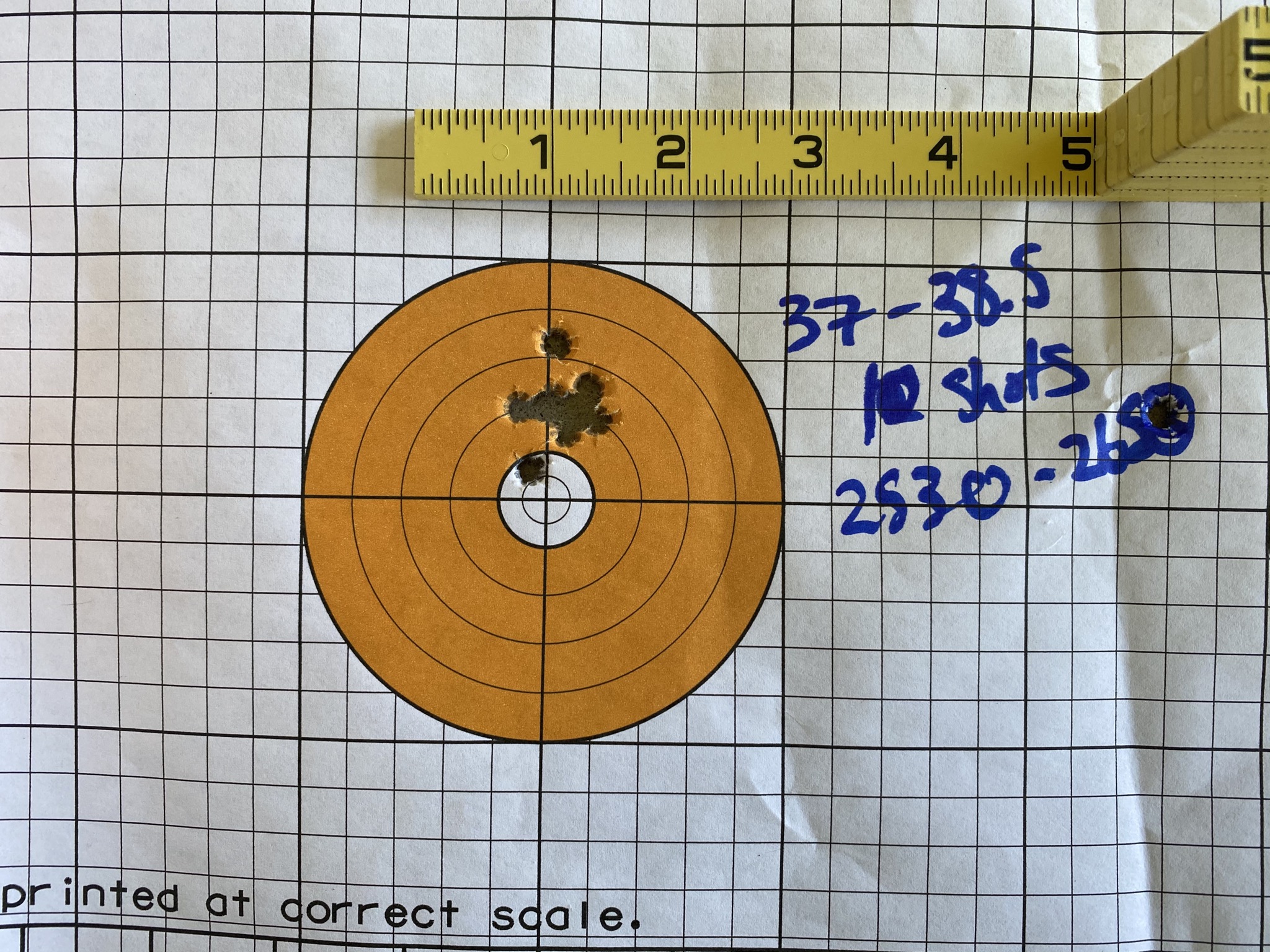

Starting load for the 25x47. I shot 4 each 39, 39.5, 40, 40.5, 41gr of H4350. All printed .3 high from my boresight. I’m going to load up a pile of 41gr loads. velocities We’re going up every string. Hopefully I can get another 100fps as the barrel speeds up And I find the next node up. 39-40 was a velocity node. 40.5 went up 50, 41 went up another 50 FPS To around 2850. 41.5 didn’t show any pressure signs. Gonna try 41.5, 42, 42.5 next time.
My sighters/warm up/safety check loads all went into basically 1 hole.
