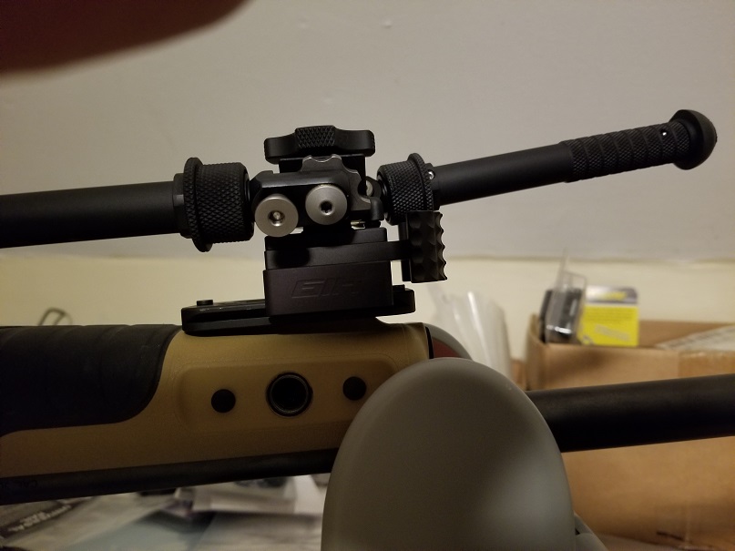

I will use 2 screws in the holes provided. I will use a 3rd in the hole for the removed sling stud, since it is available.
Ideally, it looks like GRS wants using (their) bipod spigot mounted under the barrel. But that is pricier and not as much fun.
It should be fine for bipod usage, but I wouldn't want to be regularly using it against barricades with a heavy hand.
This should suffice. If not, one could always drill a couple more holes and run more screws.
Good thing I ordered the 419 clamp with barricade stop integrated, LOL.

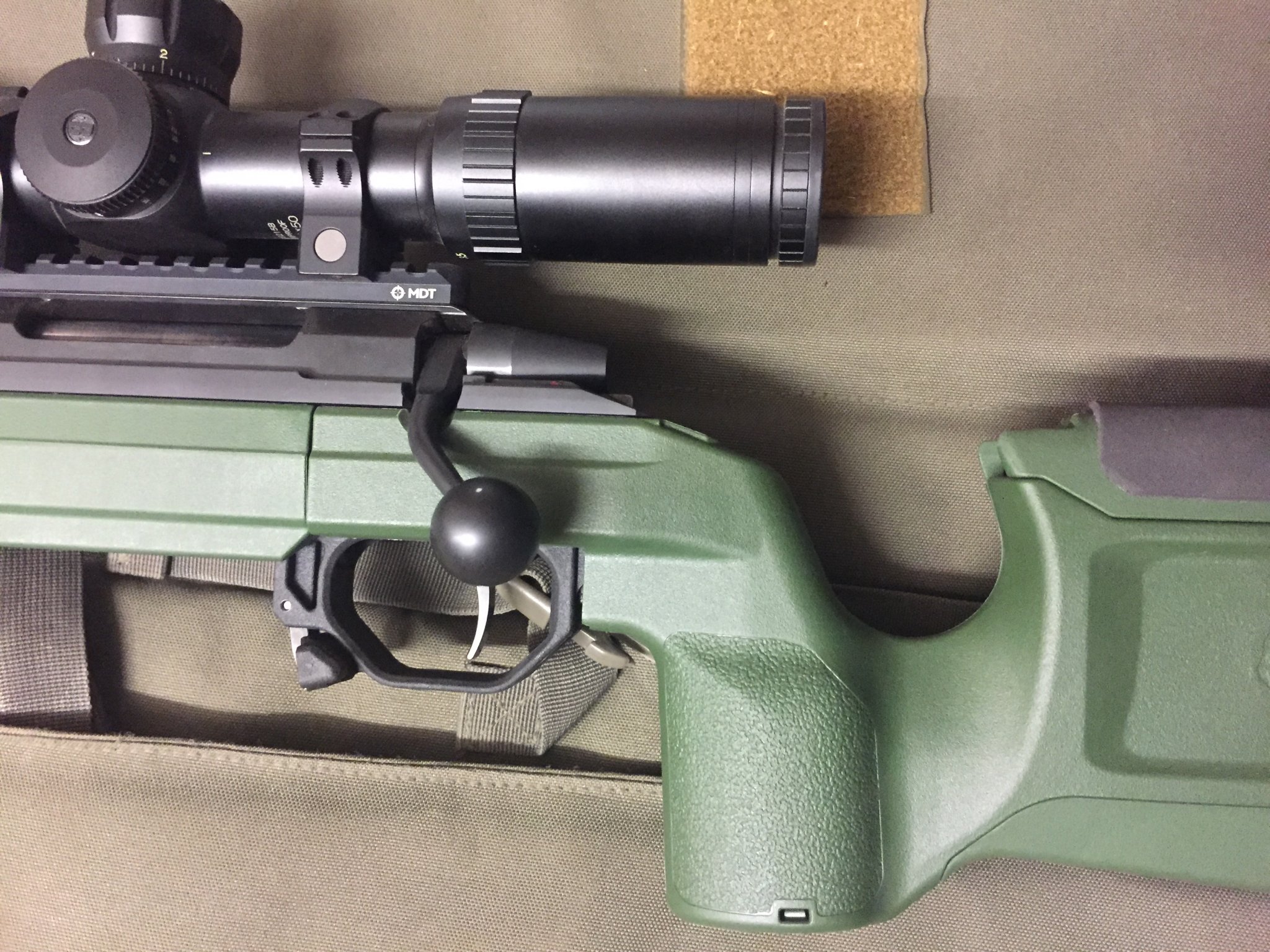

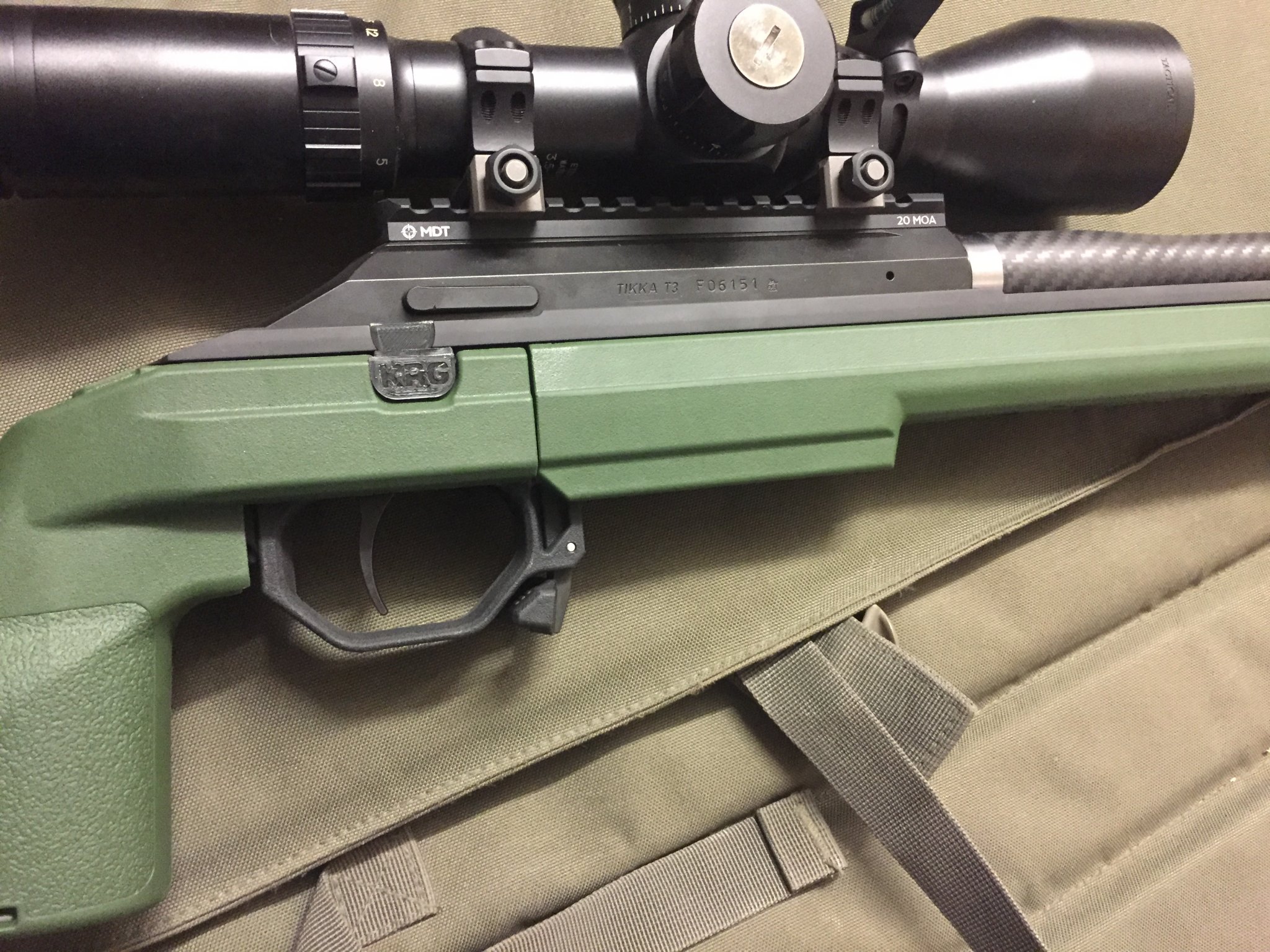

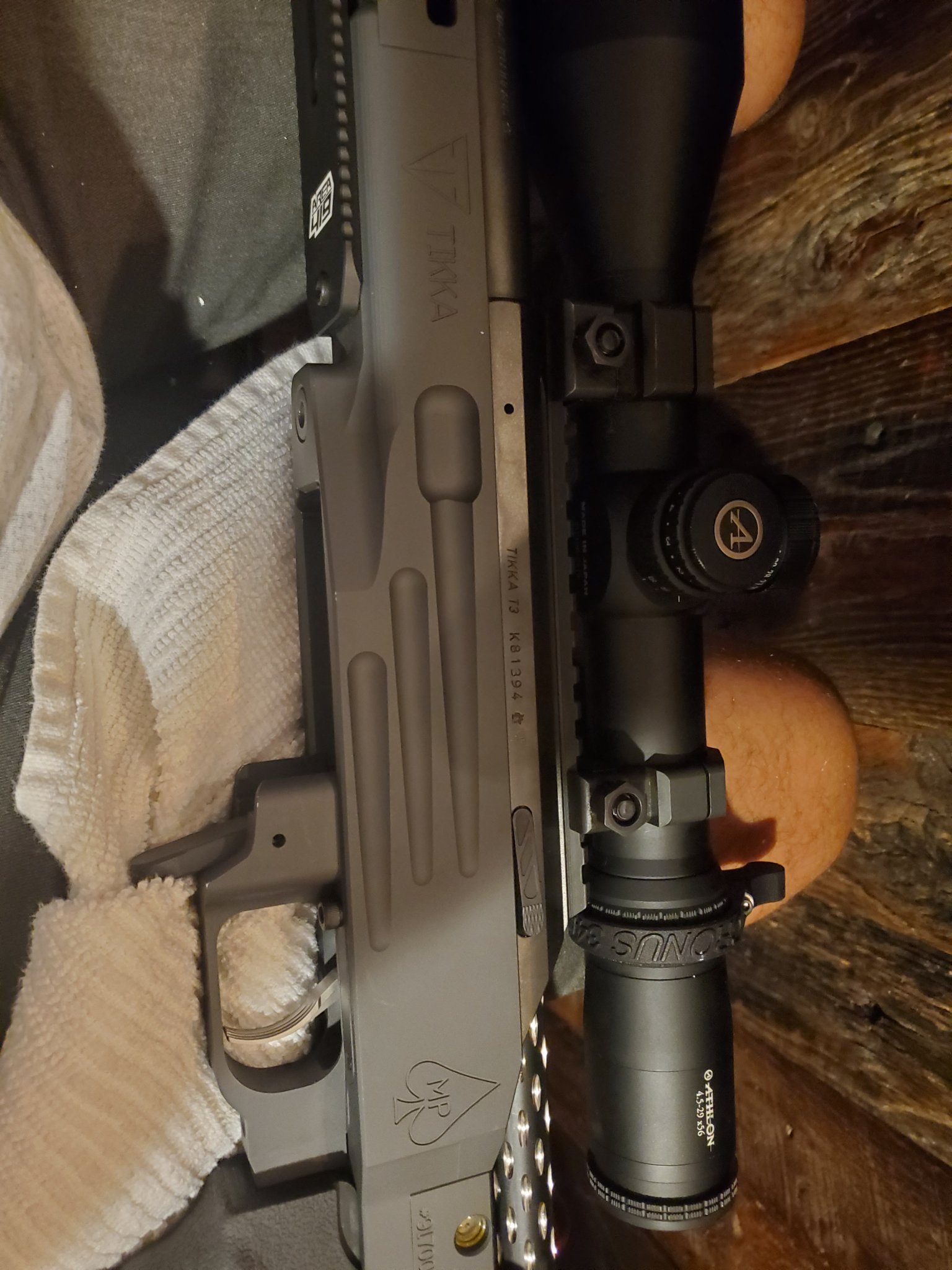

My first bolt action. Just finished assembly a little while ago. I am excited to share the outcome:
Does that look like a CTR Mag?
Super Varmint
5+1 or 6+1
CTR
CTR is 10+1

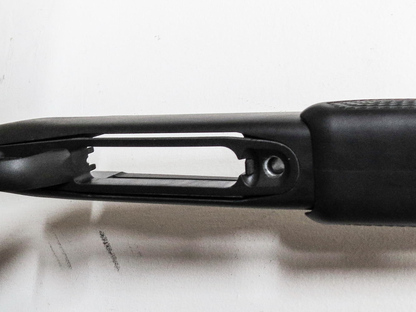

You are asking 3 questions at once.
Will the barreled action fit? Yes. Hence viking78's response above.
Will the ctr magazine fit into the bottom metal of the super varmint? No. Pic is lite bottom metal in a ctr stock.
Can you feed the ctr barreled action with the super varmint bottom metal and 308 magazine? Yes.
Now you have info so you can make your own decision.
I mounted the rail with the screws that came with the Chassis kit and I am not satisfied. The (metric) M5 screws that GRS provided with 1 picc rail seat much more firmly. I am going to look for some other screws.

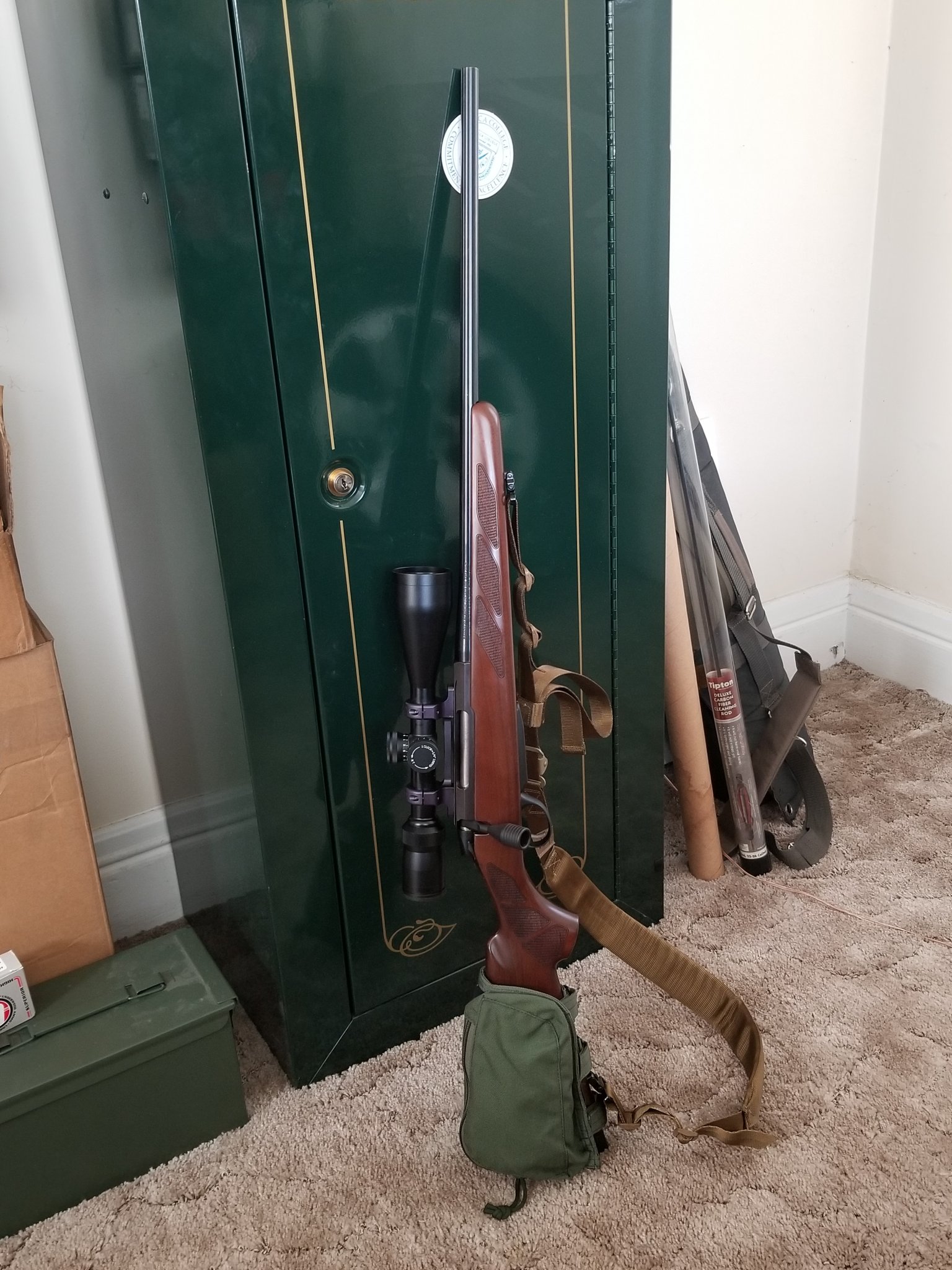

I picked up a new Tikka T3 in .22-250 yesterday.
What would you recommend for a scope base and rings?
I am leaning towards a Picatinny rail base for a couple of reasons:
1. For daytime shooting, I can just borrow a scope and mount off of one of my flattop AR’s (mainly to test my handloads/reloads… but eventually for prarie dogs next year)
2. Most likely this fall and winter it will be wearing a Trijicon thermal for coyotes

I have been using the Mountain Tactical picatinny rail.
It comes in a couple lengths with varying MOA choices.
My ring preference is Aadland, then Seekins, then Talley.
I ended up ordering some Talleys for a 34mm scope, mostly because of availability. Aadland doesn't make 34mm, Seekins weren't in stock at my preferred vendor in the height I wanted. Also after listening to DLO, I decided not to overspend and see if the Talley's would do the job at a lower cost.
Edit (5/25/22) My preferred rings are now ARC. I sold the Talleys and have 3 sets of ARC and one ARC mount.
I won't sell the Aadland(s).

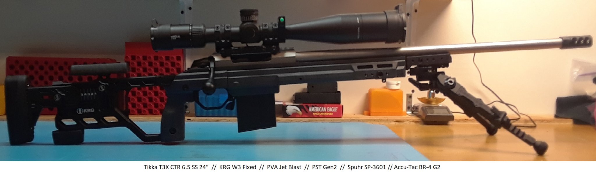

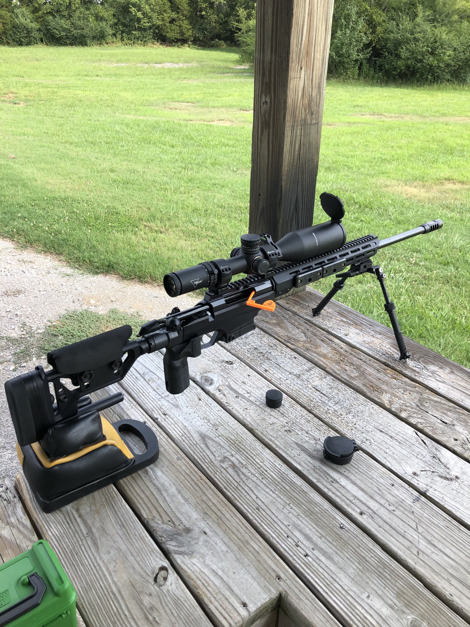

Got this in a form that I really enjoy shooting. EC Precision Tuner Brake, weight kit, and MPA grip has made this a joy to shoot. Just past the 2300 shot mark. Here is how it’s shooting at a 1000 yards.

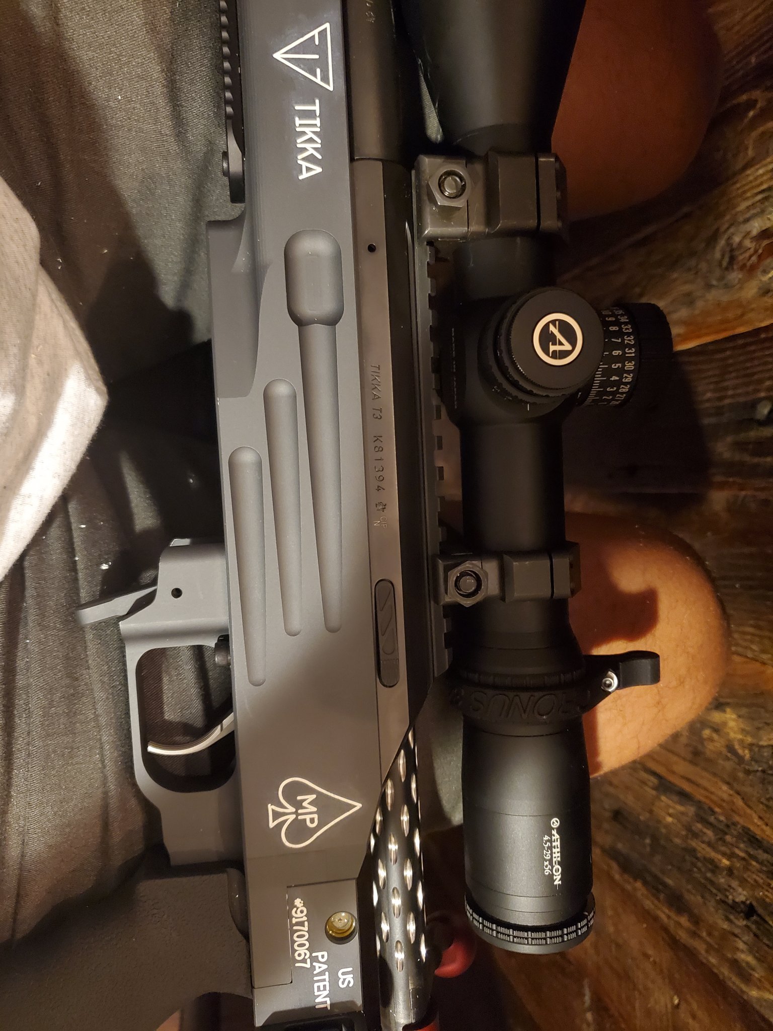

I picked up my t3x a1 a couple of months ago, haven’t shot it yet. I grew up hunting in Washington state and always shot right handed bolt guns and I shoot right handed. The tikka I decided to get a left hand bolt because I’m using it for long range shots only on a bench. I’ve always felt comfortable shooting left handed or right, but I got the left hand bolt to shoot right handed and operate the bolt with my left hand. It feels very comfortable for me operating the bolt with my left hand. I was curious if anyone out there is shooting the same way.

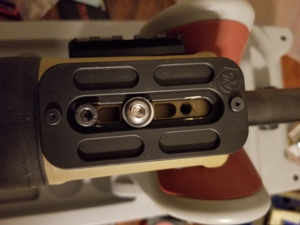

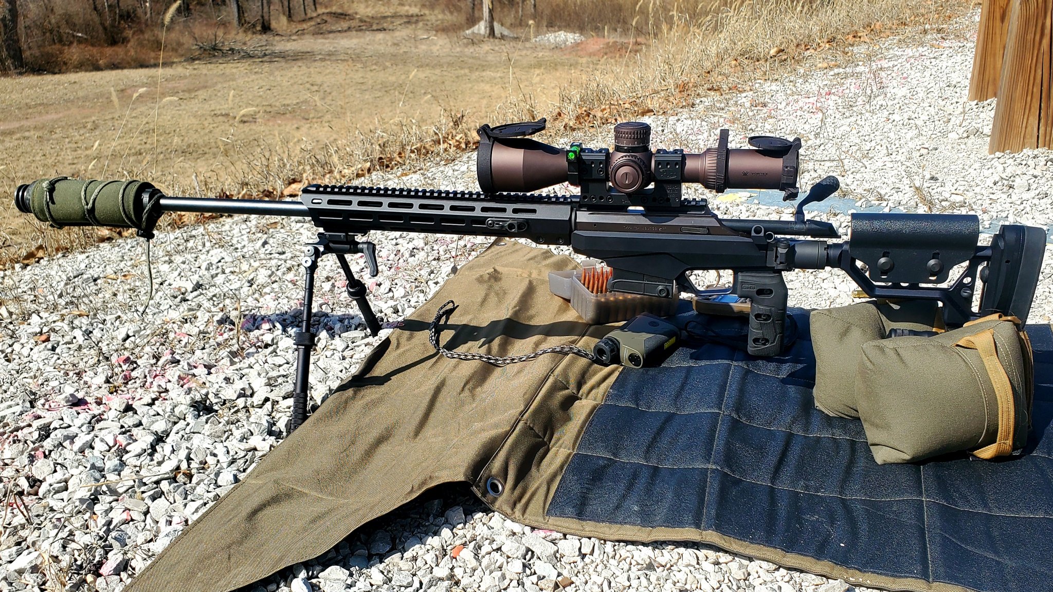

So here is the 3" ARCA bolted into the Bifrost.
The black screw is a M5-0.8x12mm which can be found at Home Depot in the drawers of special hardware. If I put a thin brass washer under it then the cap head is too high and wont allow traversal of the bipod on the rail.
The middle screw is a M6-1x12mm, which was something I had floating around. This fits securely where the sling stud was mounted. It has a washer to center it in the rail.
Yes, I can put another M5 in the front there. I will see if I think it is necessary. As it is, the M5s aren't biting enough rail. In this configuration above, I moved the rail all the way forward so the end of the screw cap is clamping down on the leftmost end of the rail slot. Clearly that won't be possible with the other end slot, and since I can't use a washer to get more force, why bother.
The screws in the chassis kit I ordered with the rail I don't like, when they bottomed out, I easily started to strip them, at levels much lower than these are torqued down with.
So, of course, if I use the barricade accessory, then the bipod legs won't go fully forward.

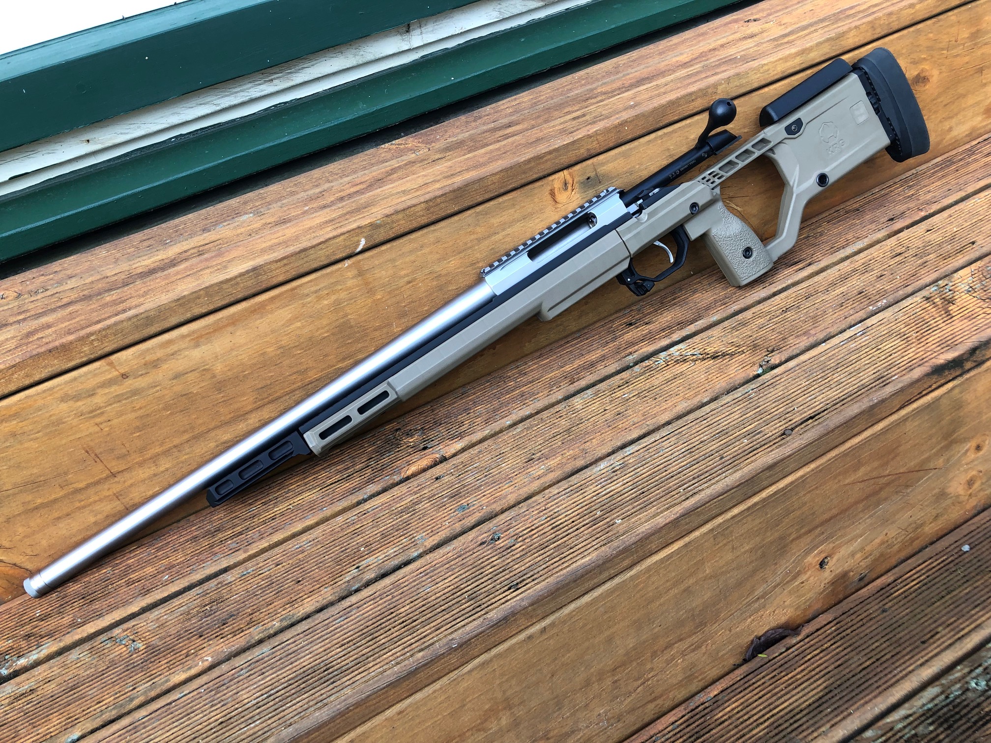

Tikka folks, does anyone know of something like the KRG bravo or MDT XRS that will work for a left-handed Tikka T3X short action? I am trying to set up my t3x 6.5cm as a hybrid target / occasional hunting rig but nobody seems to make this (even Tikka's UPR is righty-only). I could just buy a Bergara but I love my Tikkas and want to stay with them if I can. TIA.
You can file a notch into the bravo for the bolt. Not sure on the details, but several people around here have done so
Reactions: Fanon
Those who need a lefty Bravo just modify it themselves.
Reactions: Fanon

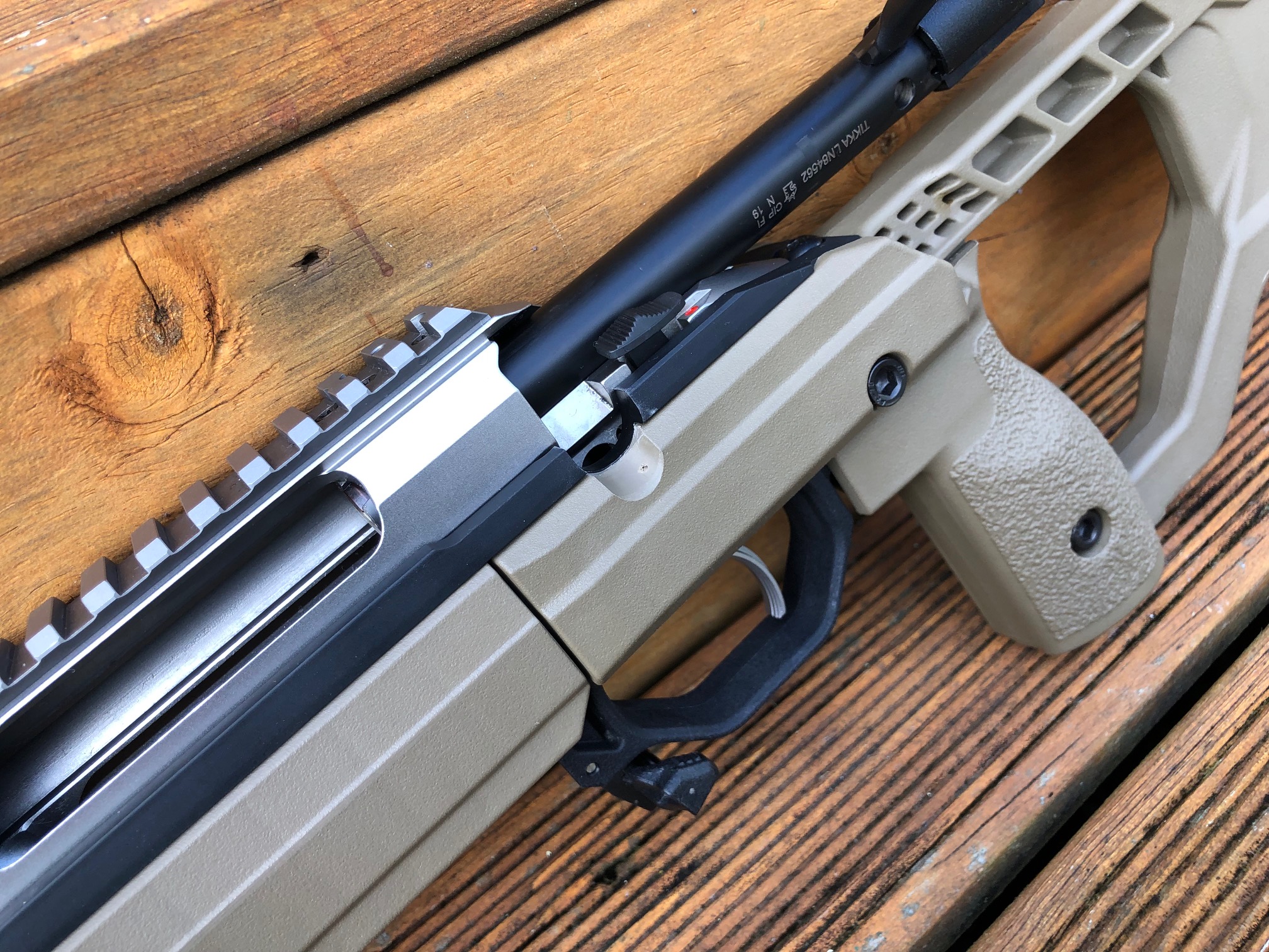

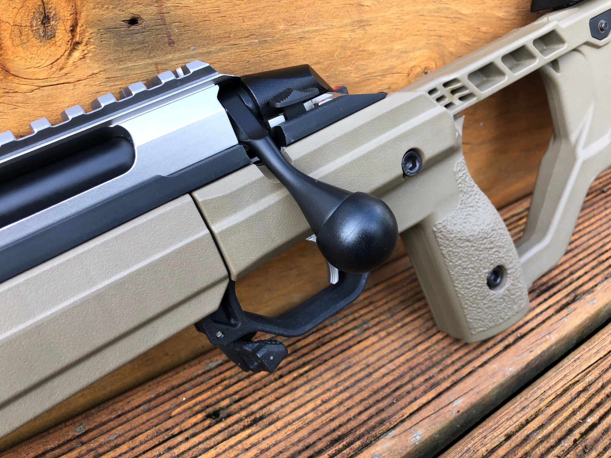

Gotcha, thanks. I guess I'll do that if there are no factory options. I considered doing just this initially, but was a bit worried that the riser adjustment knob might be in the way for a lefty shooter.
Yep, I just had a gunsmith do my X-Ray. Just be aware that you need to cut away both the outer plastic as well as some of the metal frame. On mine, there was a small air bubble in the plastic (or possibly the relief cut slightly through the plastic, although this seems unlikely, as we used a steeper angle than the factory/RHS cut):
But no-one's going to notice when the bolt's closed, of course:
And, overall she looks purty good:
The adjustment knob under your chin is a PITA; on mine, the knob and its retaining/'filler' plate comes out easily, but not the one on the opposite side ... not sure if it's meant to, but I might contact KRG and ask them, as it would be good to swap it if possible ...
I converted mine. The cheek riser knob didn't get in the way but I modified it to fit from the opposite side so it looked right. It wasn't a big job but it was over a year ago so I don't recall the exact method. I can snap some photos if you like. I also made a filler block for the original RH bolt cutout, I think it looks tidier even with the rough 3d printing job.

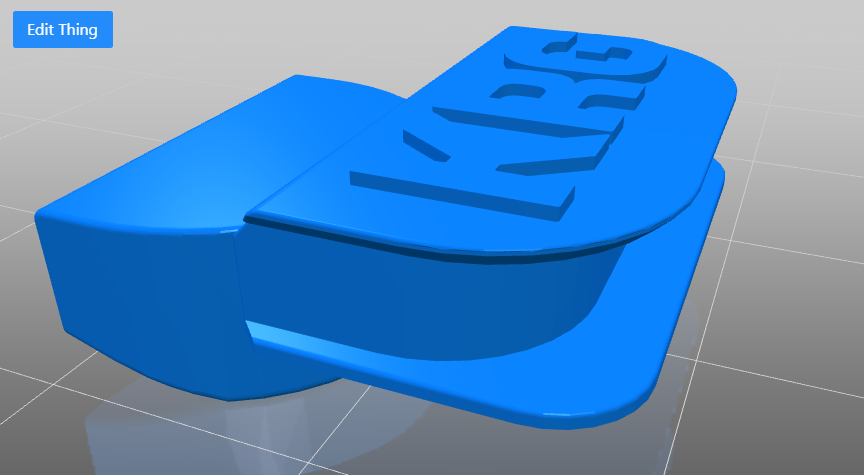

Awesome - thanks for confirming this. I don't have access to a mill so hopefully I can get this looking decent with a dremel, files, and some JB weld to fill (unless Gtar wants to sell me a 3d-printed one...). We'll see!
I'm in Australia so probably not worth the postage for you. I have uploaded it to thingiverse so you can download the file and have someone local 3d print it for you: https://www.thingiverse.com/thing:4739508
