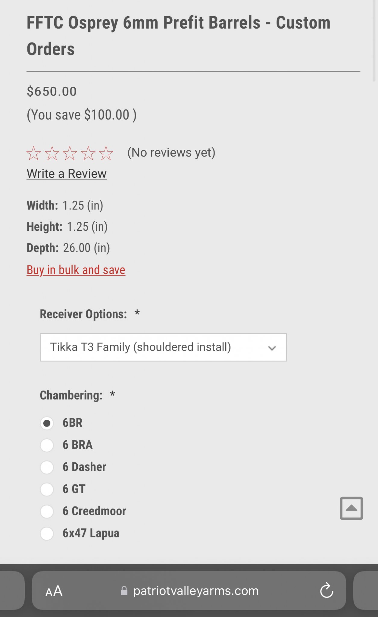

I was shooting factory 140s from my tikka t3x w a 20” at around .5 MOA easily. They’ll do great. I also had them out to a 1000 so much trouble too. You should do great with them. Like I said, they won’t be as fast but they be accurate! Good luck! And if you ever want to go longer check out Patriot Valley Arms for prefit rebarrels! Spin the old 20” off (with some work) and throw on a 26” pre fit at home! Then ya got a hunting barrel and a long range steel ringer :)

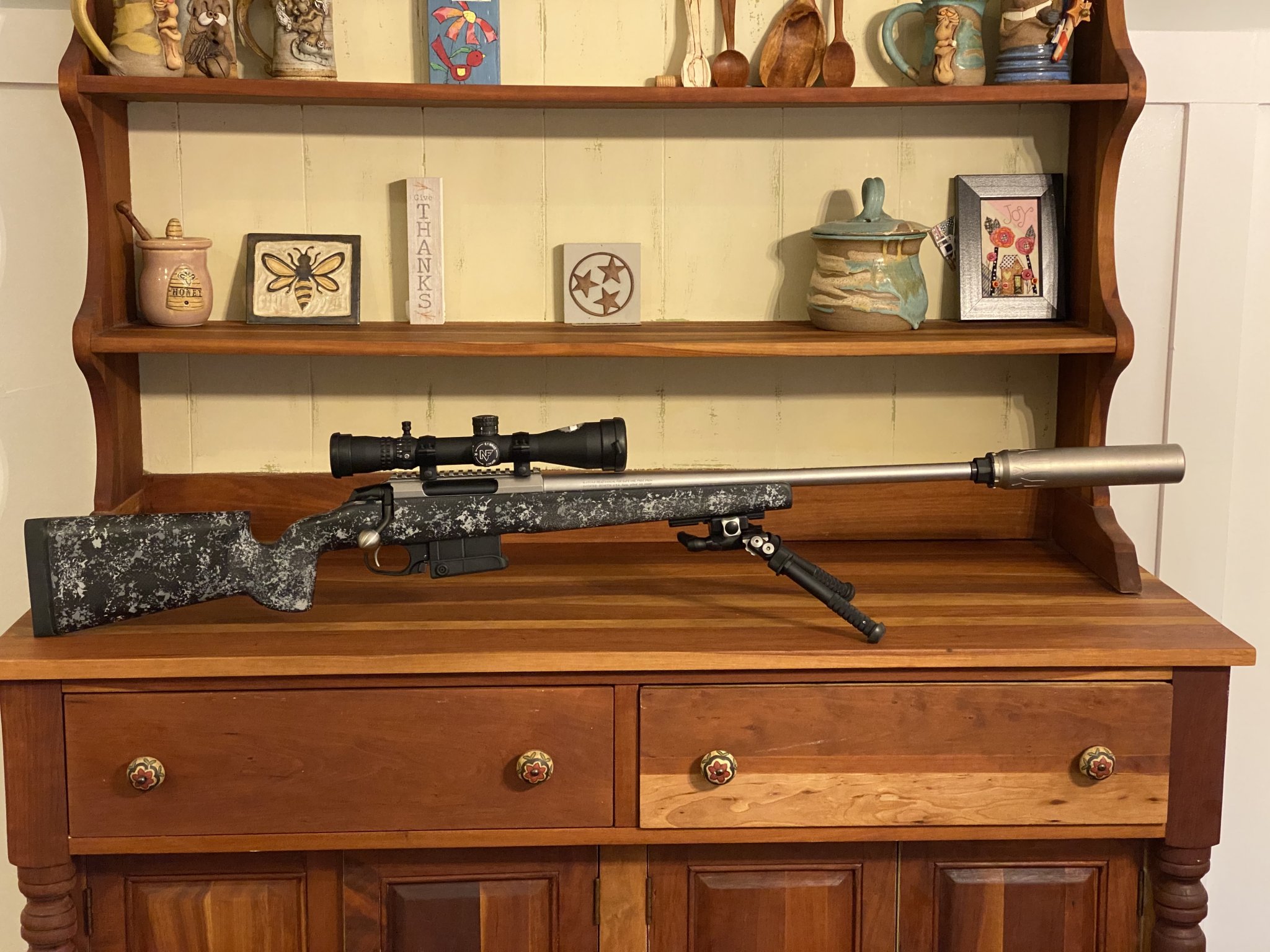

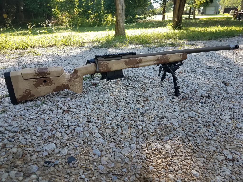

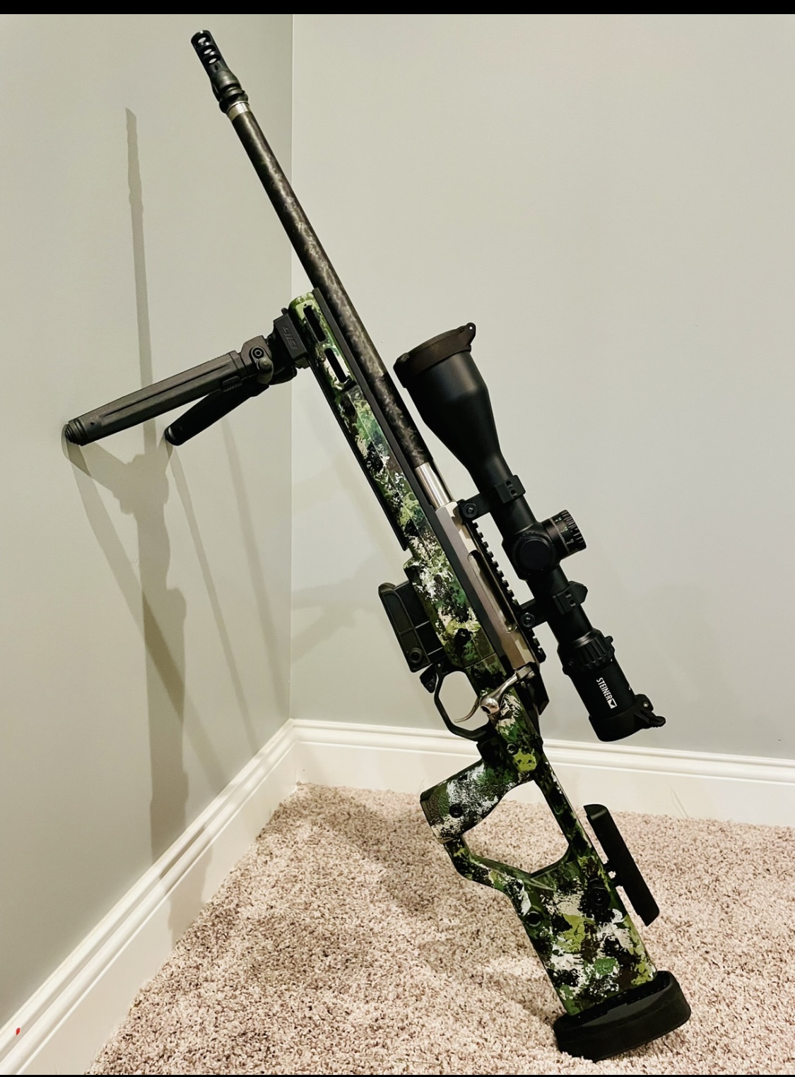

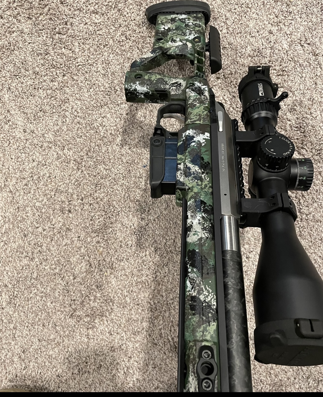

A refresh on my shorty Tikka….
T3 action with 17.5” Carbon Six barrel in 6.5CM, in a KRG Bravo with XRay rear end. Steiner 4-16x. Sponge camo, pretty happy the way it turned out. Usually wears a Sandman-S too.
Haven’t had the stones to paint my Tac A1 😂

Pretty good I’d say, but I haven’t really gotten this one to longer ranges yet. 0.5 - 0.75 MOA depending on my part at 100-200 yards so far. So hard to say definitely.
My Tac A1 on the other hand, is a hammer and I’ve taken it out to 1,000.

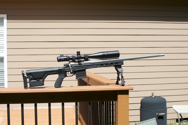

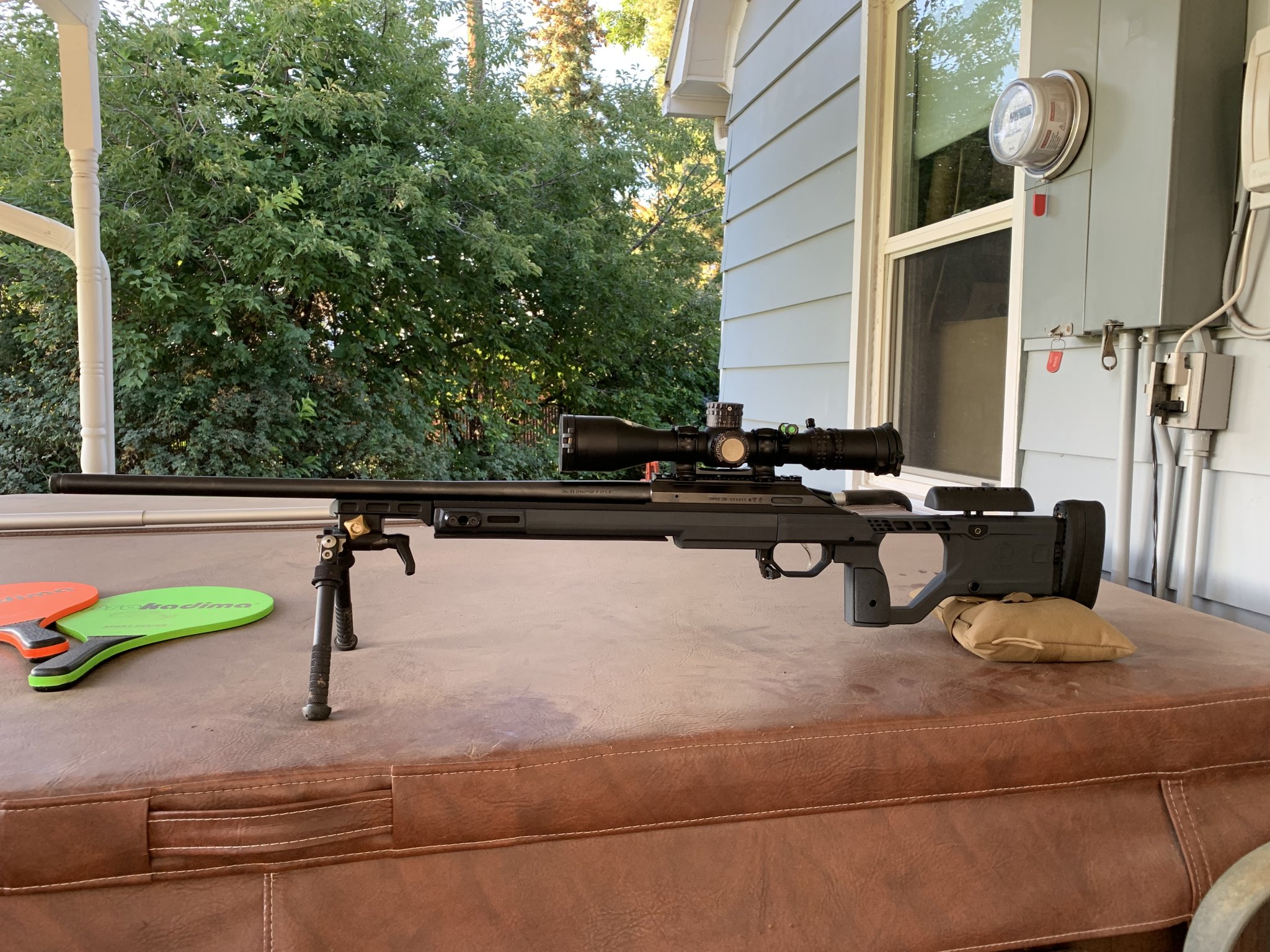

I got my new Tikka CTR build out today for the first time. 20 inch stainless 308 CTR, McMillan A3 Carbon Edge stock, Warne Mountain Tech rings, NF NXS 2.5-10x42, and a DA Nomad LT can. I tried a ballpark load with some Varget, 168 Amax in new Lapua brass. This is one of the first groups with less than 20 rounds down the pipe.
Another Tikka satisfies the less than 1 moa guarantee... again.

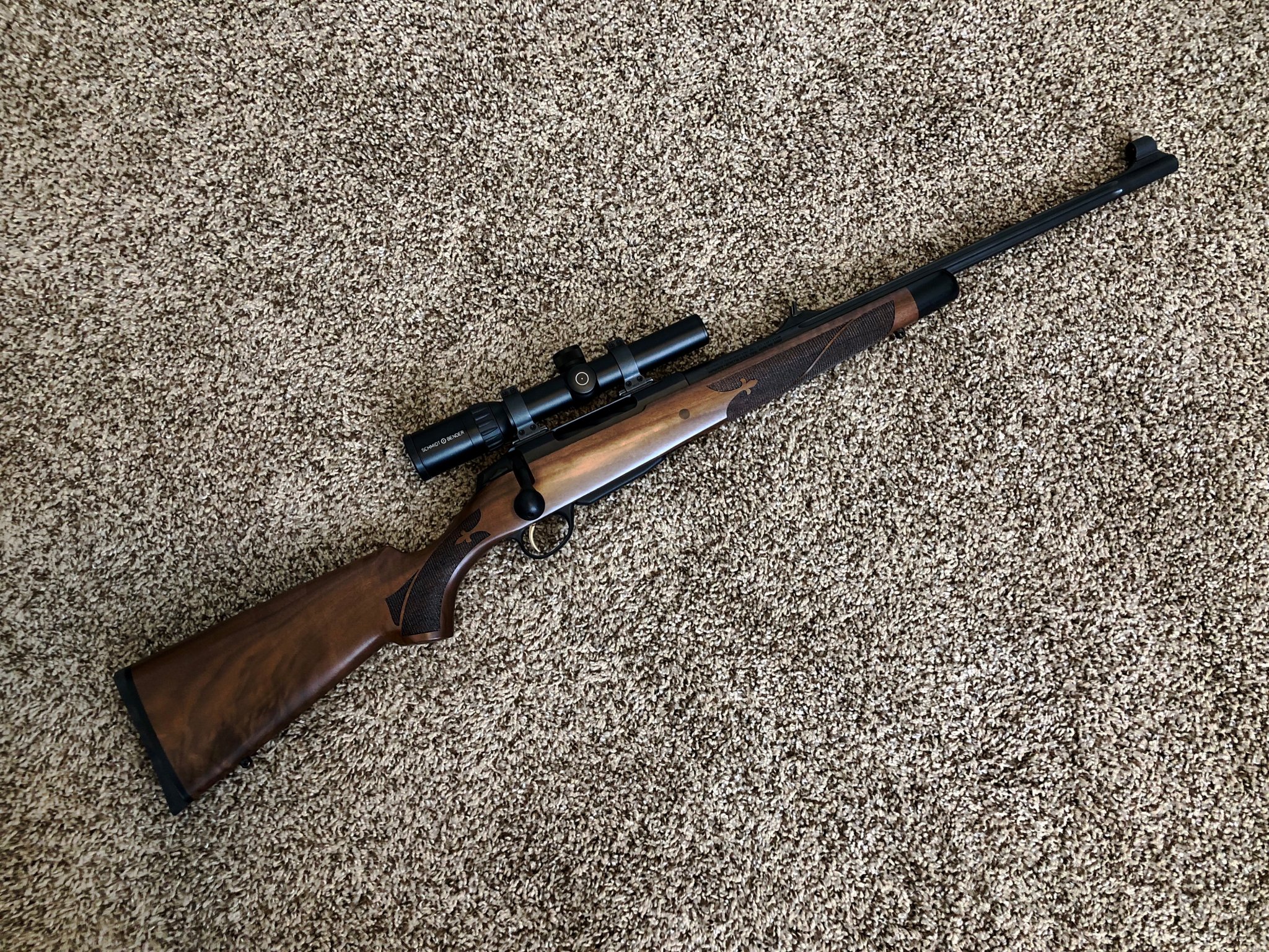

My lil Thumper, started life as a Tikka T3 Boar Cabelas exclusive. Replaced the front bead with the Tikka Battue fiber and placed it in a Boyds Walnut Platinum stock. Simple and clean. 300WM 8lbs 5 oz with scope, 6 lbs 15 oz with irons only. Kinda my own Tikka version of the Sako Grizzly.
I just ordered this same stock and then found this post. I ordered the same thing down to the recoil pad. I hope my wood is as beautiful as yours.

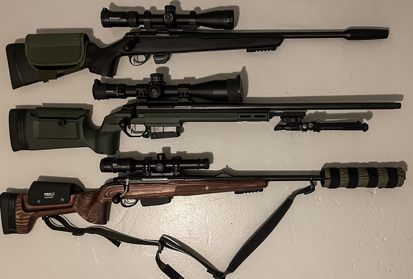

The Tikka sisters zeroed in and ready for the hunting season.
.22LR T1x shooting SK Rifle Match, for now. Will try SK Long Range Match if I can ever get my hands on some.
6.5 Creedmoor T3x CTR shooting 143 gr ELD-X still, planning on moving on to 120 gr Sako Blade.
9.3x62 T3 will continue delivering 220 grain Naturalis LR monolithics.
All have the swept Sterk bolt handles from @cannoncrossfire
Sorry for the extremely poor lighting.

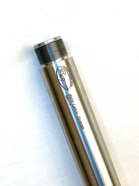

Just wanted to give a plug here for PVA prefit shouldered tikka barrels here. @bohem has done an insane job at offering a killer screw on at home barrel for the Tikka actions.

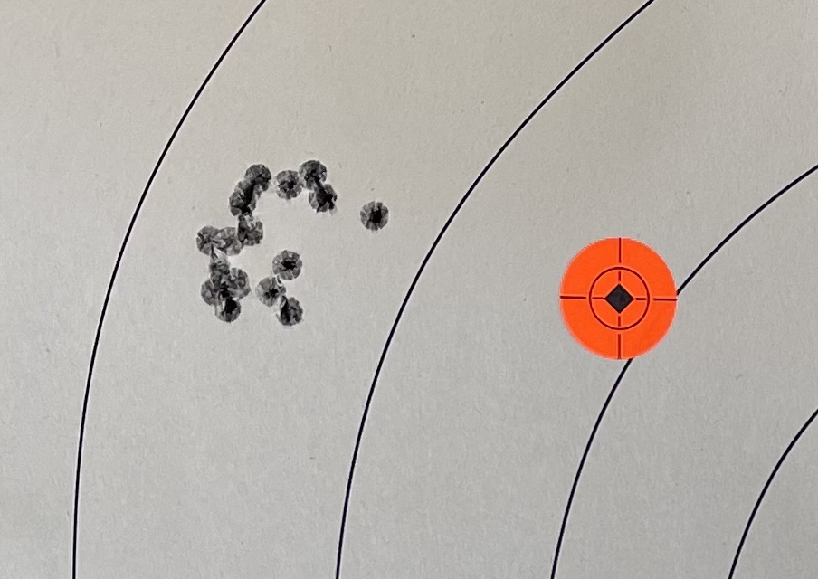

The fist pic is of my “break in” rounds. 20 shot group w shitty factory ammo, not trying to hold a tight group but she did anyway. 5 shots, clean, repeat 4x. Also gained about 50fps over my 20” w the new 26” barrel.

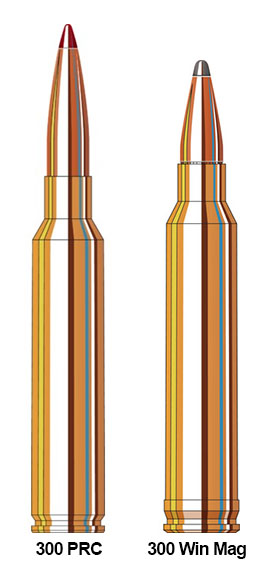

300 PRC COAL is too long for the action and the stock mags.
Love my Tikkas... But they are best as XM or short action.
Reactions: 260284
Tikka makes a 300 WM. The only difference bw the short and long action on the Tikka is the bolt stop and bolt face.
Good luck getting heavy bullets in the factory magazine in 300 mag, or 7 mag. Can't seat them very close to the lands. The 300 WSM, 7 SAUM, or 7 PRC are better choices for a Tikka action.

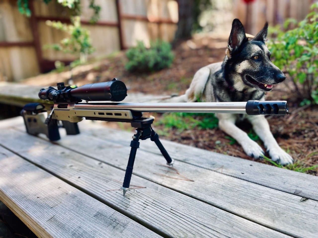

OK, an update from prefit hell (not really). Spoke with Proof, since it was below SAAMI max they didn't see a huge issue with it, provided it was performing. So I shot it today, 60 rounds. No issues w accuracy, 5 round groups yielding a 0.48 average so I'm happy for now. It did seem to group really well for 3-4 rounds (0.25-0.3MOA) and have one flyer, but I'll put that on me. Going to chrono around 100 rounds, apparently these barrels speed up around there and may see some accuracy improvements. Hoping for 2700-2750fps out of my 22" barrel.

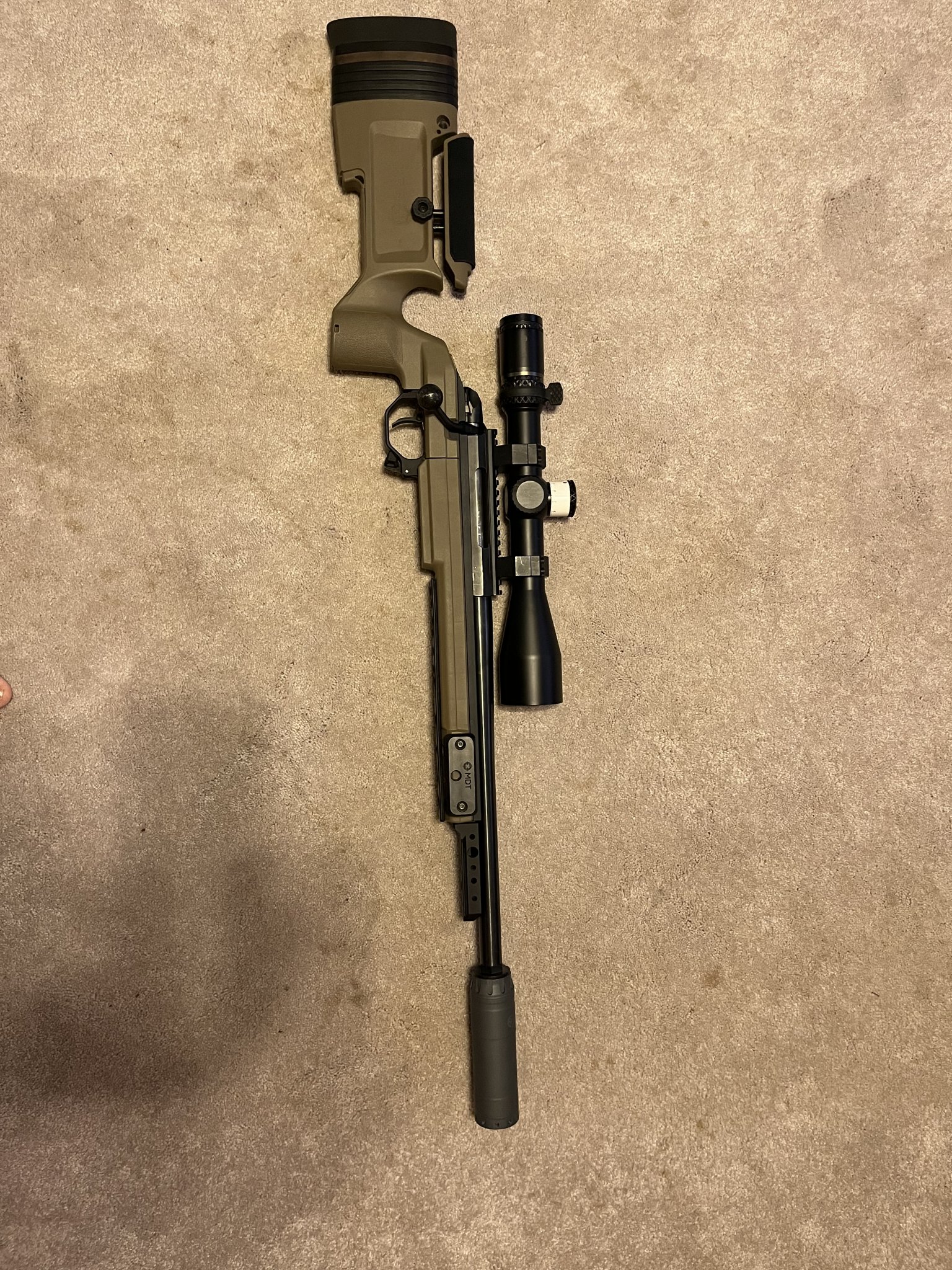

With the Proof barrel in the Spuhr chassis, she's sitting at 14.8# loaded with 12 rounds as pictured here. Definitely happy with where things shook out overall with my first deep dive into bolt guns.
Exactly. 👍
Mine are setup for a lighter weight mtn rifle, a 6 CM and a 6.5 CM / 7SAUM switch barrel.
300 PRC is in a real long action. It's not worth messing with the Tikka for those length cartridges IMPO.
