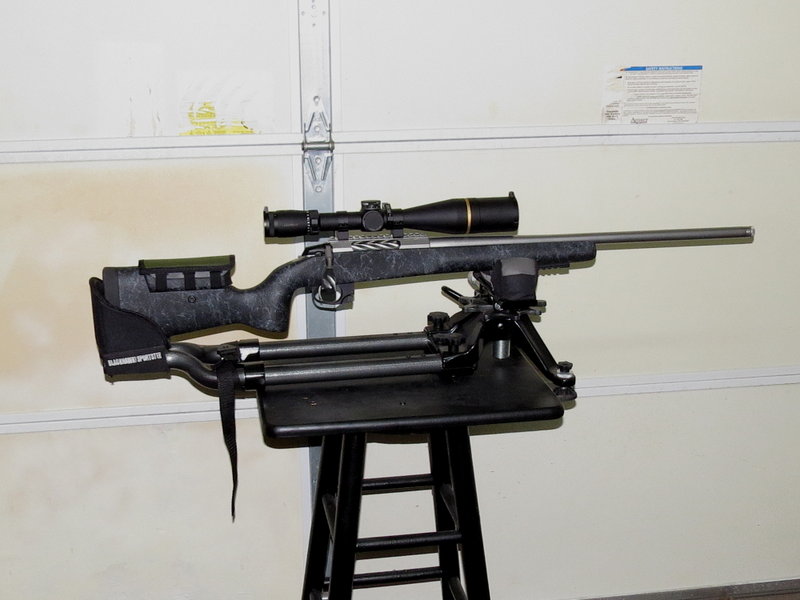

Here is the almost-unrecognizable T3 in all her glory. I forgot to mention the tacticool bolt knob. It's snazzy. Ultimately, I will paint the whole thing to match my Sako duty rifle. Now retired... like me.

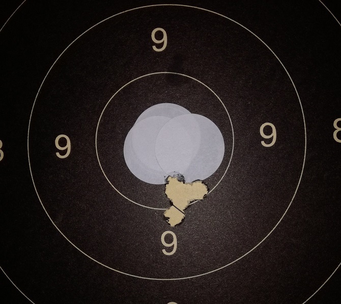

Finally got the .14 out to the range.
Considering the brass is not fire-formed yet, this is not bad. This is after about 20 fouling shots. Four shots. 90 yards. Dead calm. 40 degrees. Prone with sock bag and Atlas bipod..
Happy!

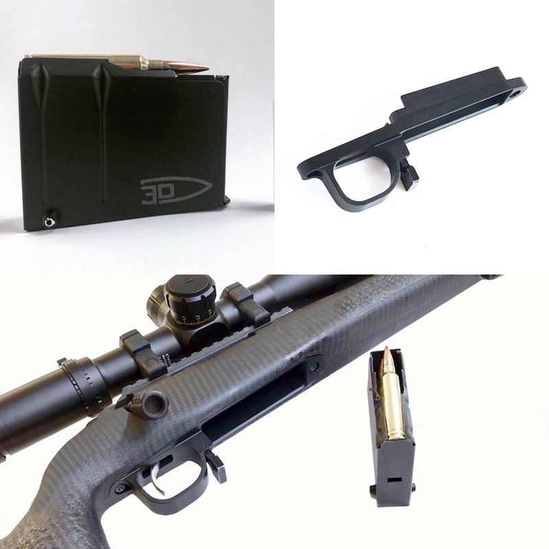

So I am thinking about moving my Tac A1 into a traditional type stock (McMillan A5). I want to continue to use the CTR magazines. Does anyone know of a good quality bottom metal that uses a CTR foot print and takes the CTR mags? Can I just get and use a factory Tikka bottom metal? The McMillan has the inlet for the CTR factory bottom metal, so I would need something that matches up.
any help would be great. Has anyone done this swap?

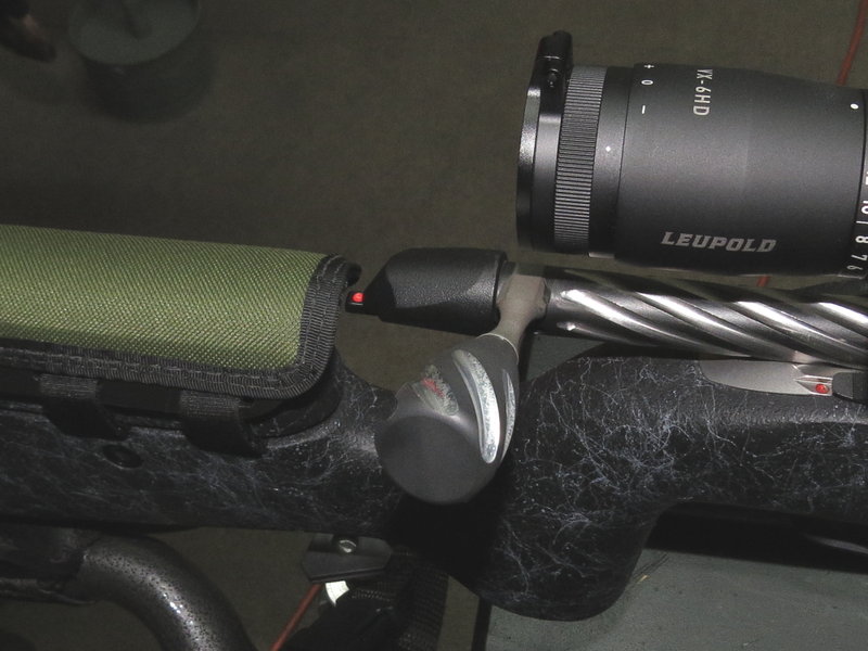

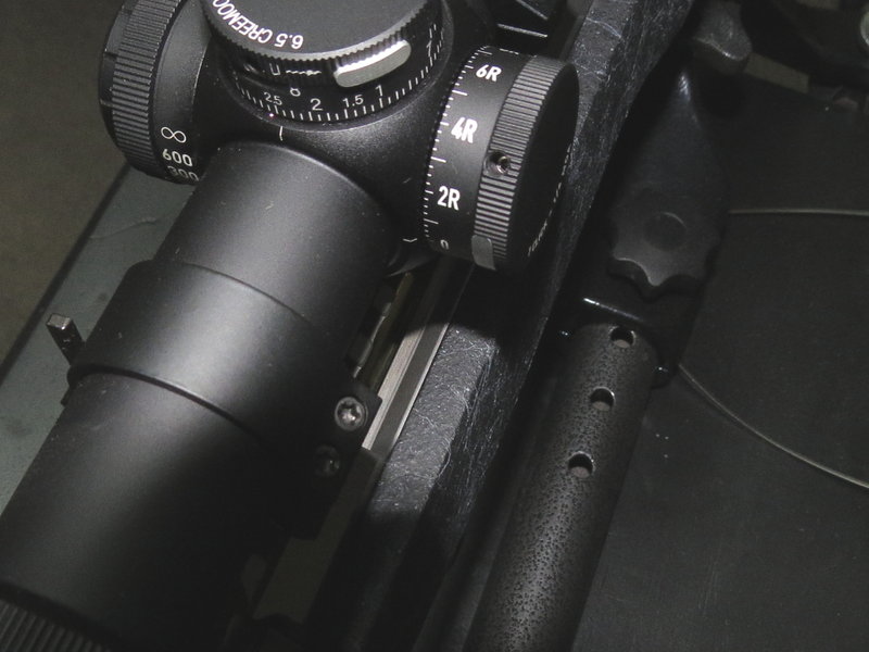

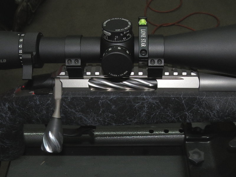

Ran across your post and thought I would sign up.
I put one on my T3x CTR 24" and it fit great,no cutting or grinding.
Hard to tell from the pics but the bottom edge of the port runs flush with the stock so there was nothing to remove.
I've ran about 150 rounds through the gun with no ejection problems at all.
Plenty of bolt clearance at the comb.
Looks awesome! Welcome to the thread!
You won't be disappointed. My buddy got his zero'd in a few shots then shot 5 rounds of Hornady American gunner 140's into a solid 1/2 moa hole. This is his first 6.5CM and Tikka... He said he is selling his 308's
