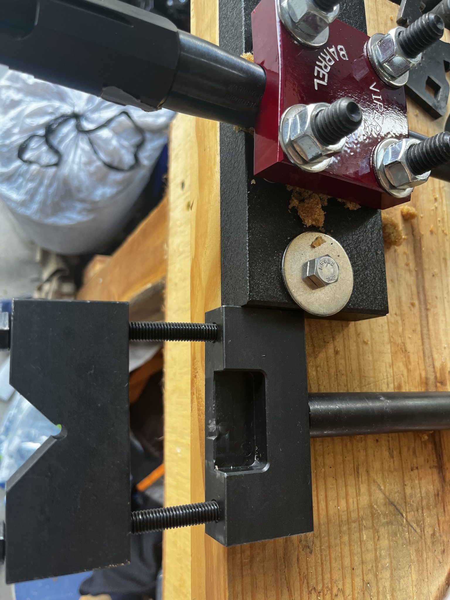

How long have you let it soak with Kroil / PBlaster, etc. ?
Heat Cycles ?
Heat the receiver right at the threads, preload the cheater pipe on the action wrench and bump the end of the wrench with a heavy hammer.
That's how the last on came off.
I’m trying to avoid heat cycling the action, that may be dumb but I just don’t like the idea of putting a torch on it. If I have to I will.
I might can find a Chester, I’m using the hammer to bump already. I think my main issue is getting the barrel tight enough right now. I may switch from hose to duct tape. I saw hose suggested previously and it seemed like a decent start.
Would really like to be able to sell the barrel
I have that same barrel vise and I'm thinking a cutting up a couple of strips of old belt leather or a couple of layers of shoe box type card board with brown sugar or rosin would do the trick - I've scarred up the bluing on every barrel I have removed so far, so I'm still looking for a perfect solution.
Reactions: DangerRanger
Try loosening your action wrench bolts.
If you have too much pressure on them all you are doing is locking the threads into each other.
Add just enough pressure to keep the action from moving between the jaws to prevent marring.
Yep been trying to do that, enough it was twisting a little on action at first when I hit it
There is QD cup all ready on the rear stock.

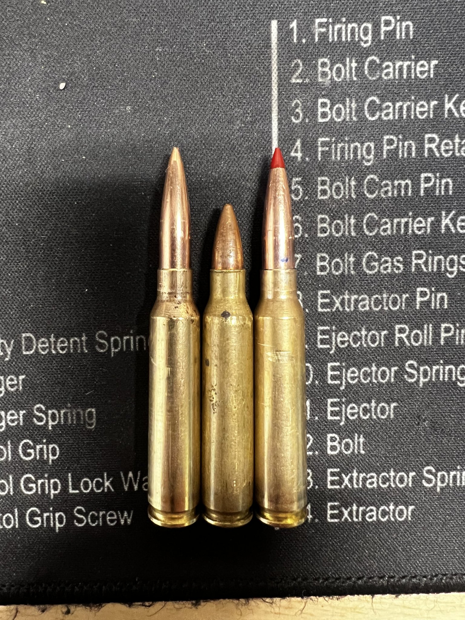

Which barrel profile/length is that? Looking at doing a tikka/whiskey 3 buikd.
26” Rem Varmint profile
Load that I used for break-in was 23.4gr 8208 with a 77 seated to ~2.360” OAL.
8208 definitely seems to be in a sweet spot with 75/77s and a longer barrel. I have a 26", I have gone as high as 24.5gr of 8208 with 75gr ELDs, 1.9520 CBTO. 75s seems to build pressure a little slower than the 77s, 77s shoot a little better IMO.
Reactions: just browsing
Yeah it’s a good combination for sure.
My barrel has a super long freebore so I just broke it in with that load… going to experiment with Varget and the heavier stuff going forward since I can seat so long.
This is a 90SMK and a 75ELD seated to touching the lands, and then a factory 77gr IMI round for reference.
Do you know which reamer it is or what the freebore is? I bought mine used but I think it is .169 freebore but not sure. Might be a little shorter than yours. I have shot 88s but no 90s. Looking at the Berger 85.5s. The 88s are crazy long. I mostly shoot 75/77s but also have been trying some 80s.
.169 is super long. Probably almost too long to load to modified Accurate-mag length and still be in the lands.
Mine is a .155 which puts me just short of modified mag length (with reliable feeding) and just into the lands.

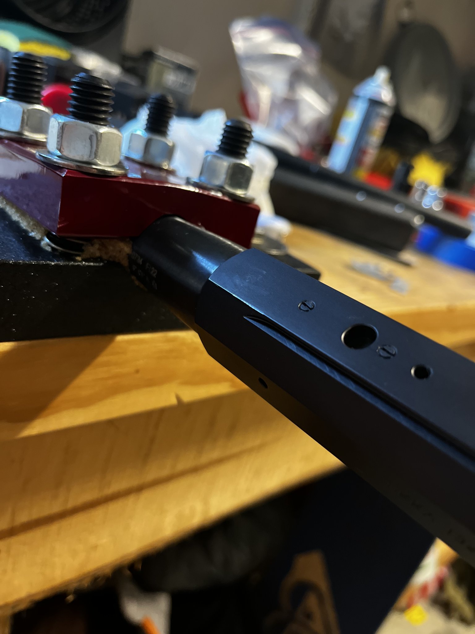

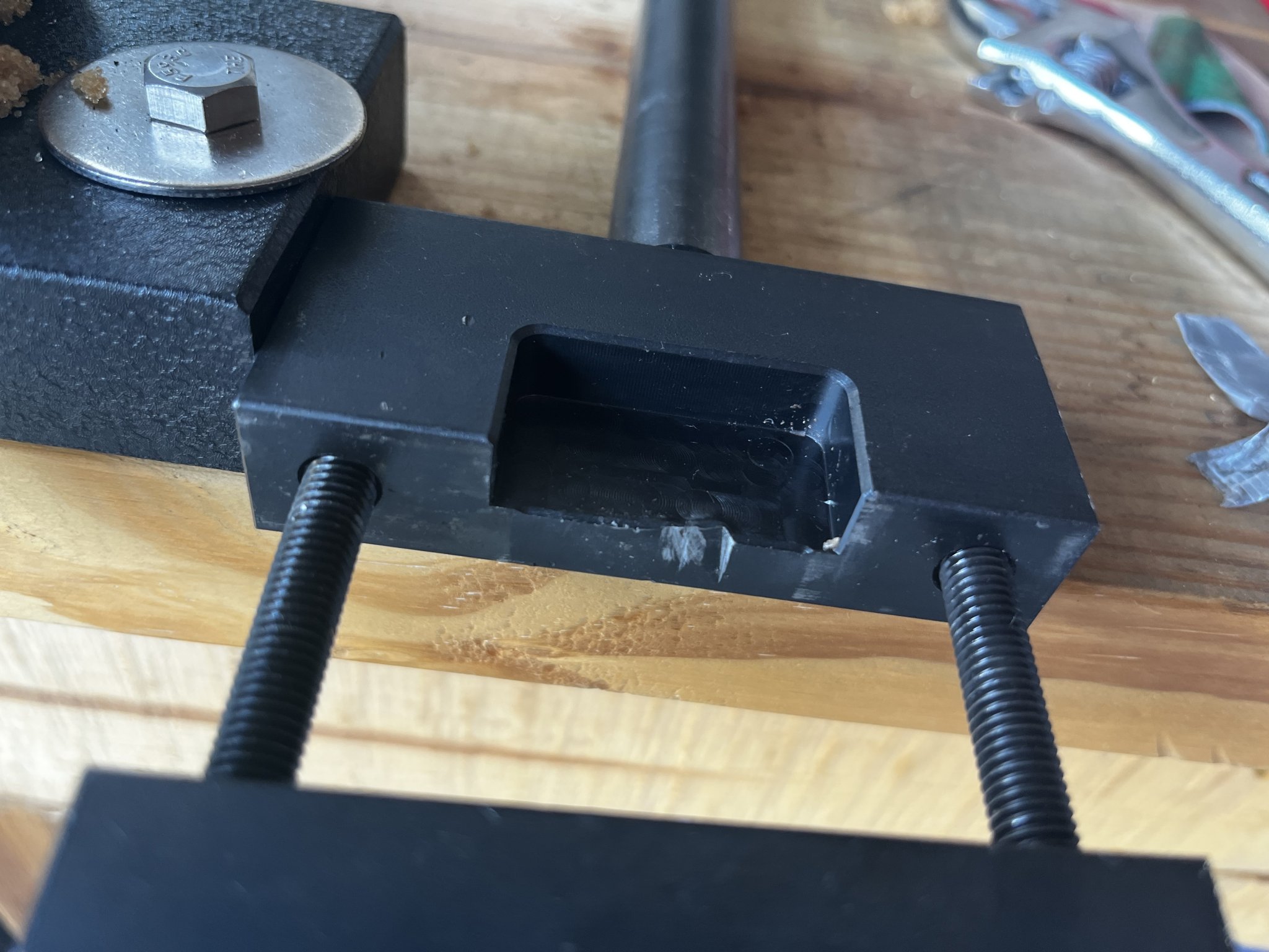

Tikka still undefeated, Amazon action wrench has fallen View attachment 8081931View attachment 8081932
Try the rear entry wrench from PVA. The external ones are goofy anyway.
Weird, I’ve always heard to never use a rear entry to remove a tikka barrel
Rolled the edge over on the action dovetail. Think I’m gone gonna send it to my smith
The rear entry wrench as mentioned is the way to go. I used the PVA on multiple Tikkas. They are tight as fuck, I still had to heat them up too.
Those external wrenches are putting pressure on the threads that you’re trying to loosen when you crank them down.
supposedly, cutting relief cuts in the barrel really helps. mine came off after some serious whacks using a setup like yours (exterior action wrench). i had soaked it overnite in kroil. so i didn't get to the relief cut part, and i never got clear where/what direction the relief cuts were to be. and i will say that just buying the action makes it WAYYYY easier, and cheaper also if you're just buying a complete rifle as a host.

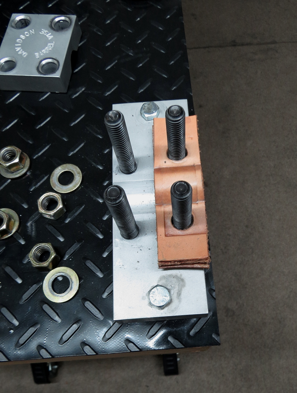

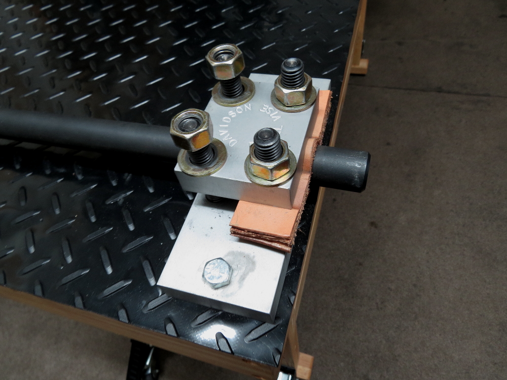

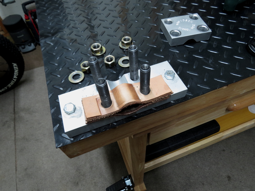

Is that viper barrel vice any good, just bought one, but have not tested it yet.
¯\_(ツ)_/¯ seems good. I couldn’t get the barrel tight enough at first but I was trying to protect it with garden hose wrapped around. That didn’t work.
I switched to using brown sugar around the barrel to act like rosin and then torqued the nuts to 65 ft lbs and the barrel didn’t even try to budge… and I put enough torque to bend that wrench flat and bend the wrench bolts. So I guess?
My biggest gripe is by design it’s wider than the stainless shank on a proof carbon so I’ll have to be careful not to clamp any carbon.
Love my Viper vice. One of the original tools I bought back when I first got into all this and one of the few that hasn’t been replaced with something “better.”
Small strips of leather work really well around the barrel by the way.
Reactions: YotaEer
I stacked 2 layers of leather strap top and bottom and only use the front bolts to clamp on the shank.
The leather is thick enough to keep the clamp off the carbon and 2 bolts was more than enough to reach my torque setting installing my C6 barrel.
This is just my wrench handle to show an example of how I clamp it. (Too lazy to remove and show the real thing)
Don't use a rear entry to remove a factory tikka barrel. The external wrenches have more surface area since you're using the flat sides of the action. I've only taken off a few, a buddy of mine a few more. We've never had an issue.

Never had that issue with any of my Tikka's, though I only have three of them. They're smoother than my stiller action by far....
I removed at least a half dozen factory barrels with the PVA wrench. Heat, insert wrench, comes right off. Those external wrenches blow.
