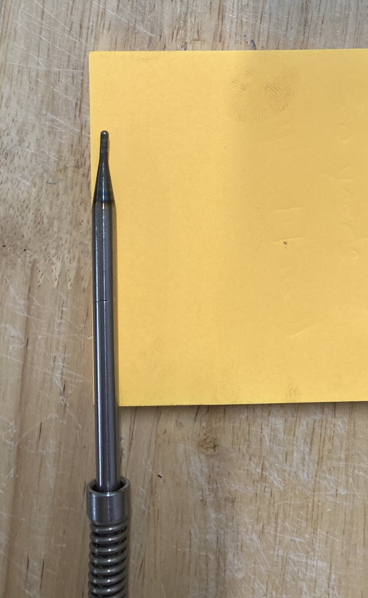

I recently bought a new tikka that was very rough to cock, upon stripping the bolt I found this

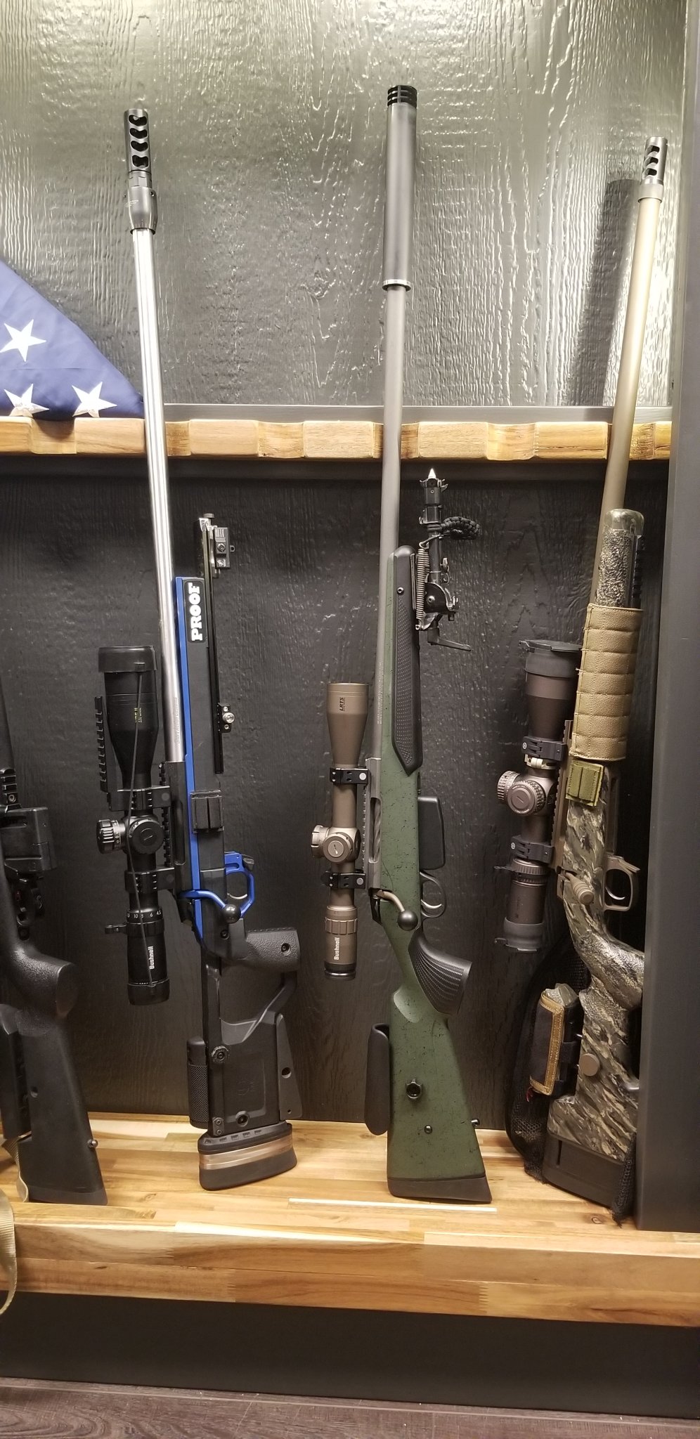

Pic for interest. Thanks.

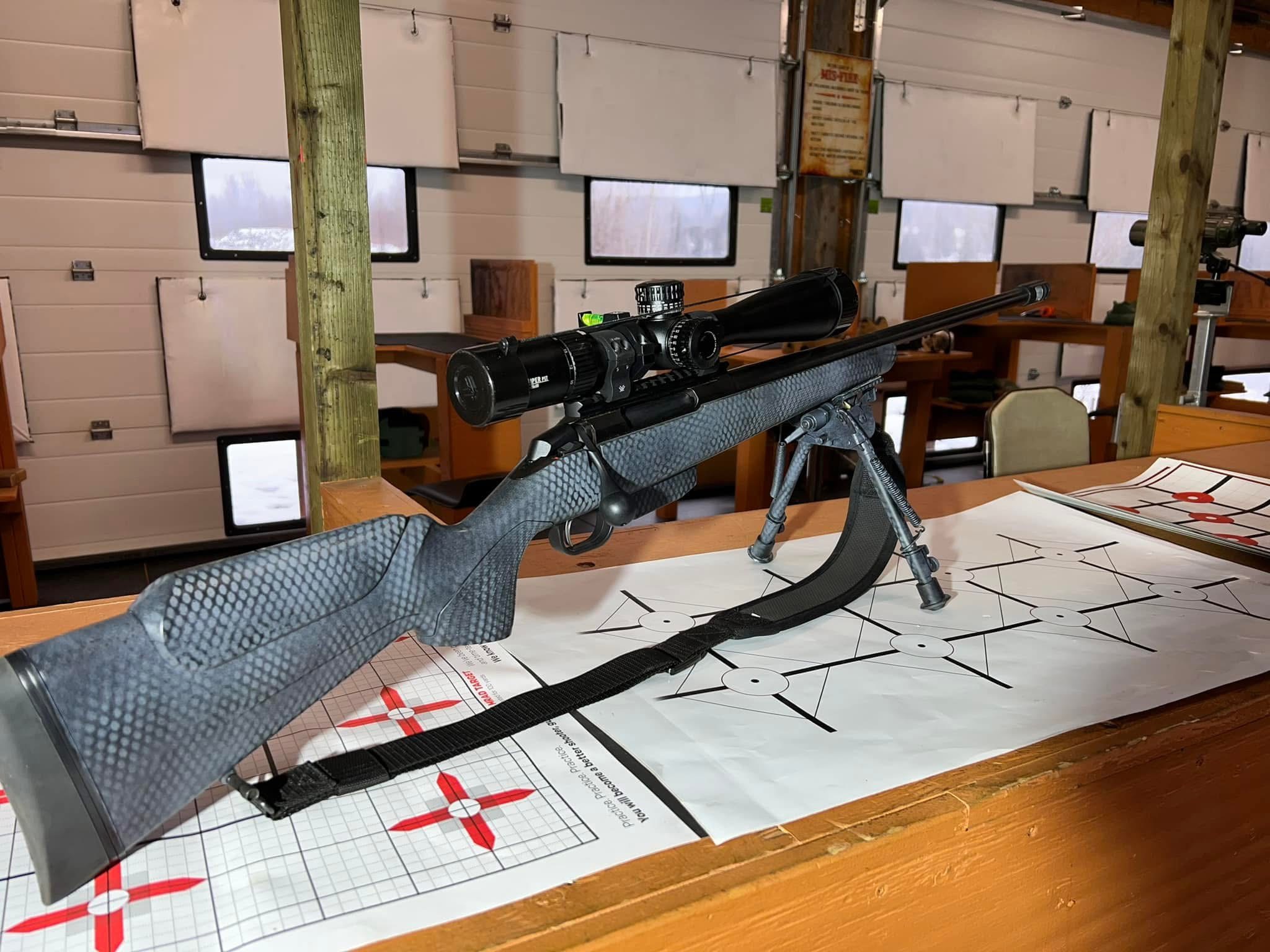

I am somewhat involved with the technology of the product as well as user/tester and therefore won't go into details. The stock is made with complex technologies which might be different to what is there at the moment.
edi
edi
They're already for sale, why can't you say how rigid it is?
They are very rigid and strong, have a double monocoque design. No milling involved. Internal alu in areas where fittings go. Carbon shell inside the barrel channel as well as inlet and cheek raiser opening. No hollow areas.
