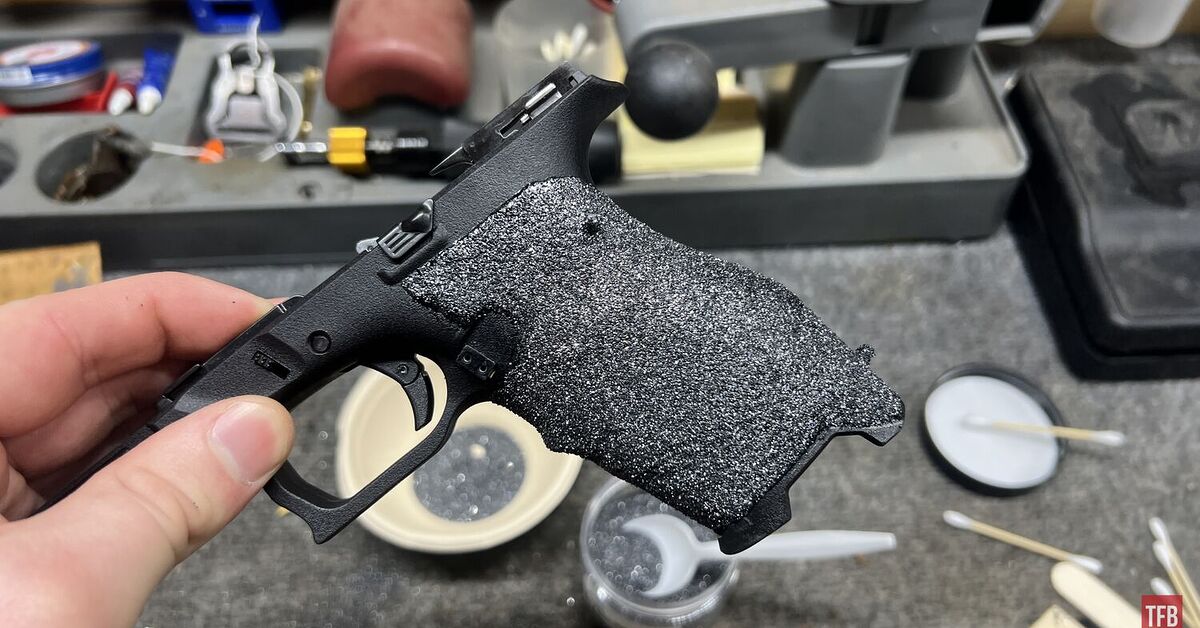

Hey mate, I haven't seen that product before, but now you have my interest! I might have to see if I can find something similar over here, but no, I was going to stipple the grip areas myself as the moulded grip panels are a bit on the smooth side.

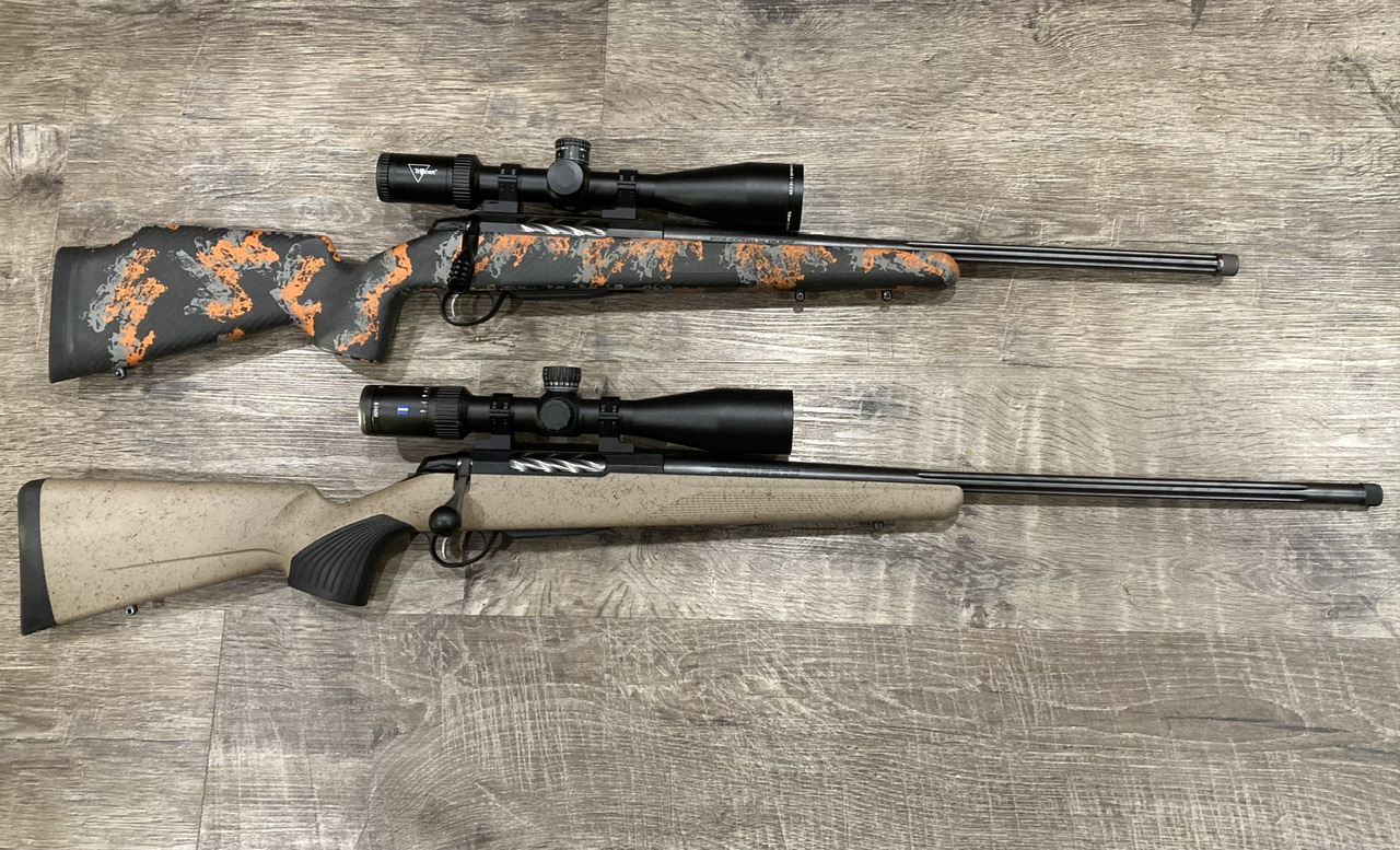

Question: Does anyone have experience with the 6.5cm 24" fluted Tikka barrels. The regular factory barrels shoot amazing, I wonder if there is any difference in witnessed accuracy, fluted vs non fluted?
Not a Tikka barrel, but they come from the same place. 24" fluted 6.5cm, it shoots really good.
They’re the exact same.

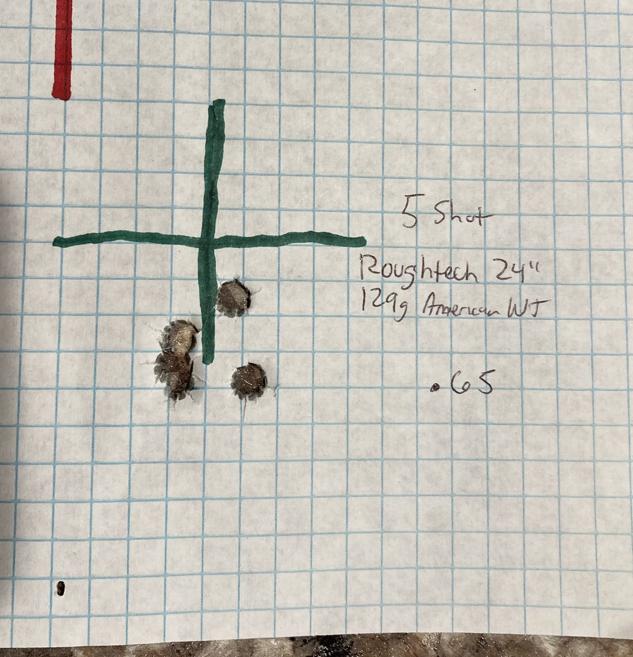

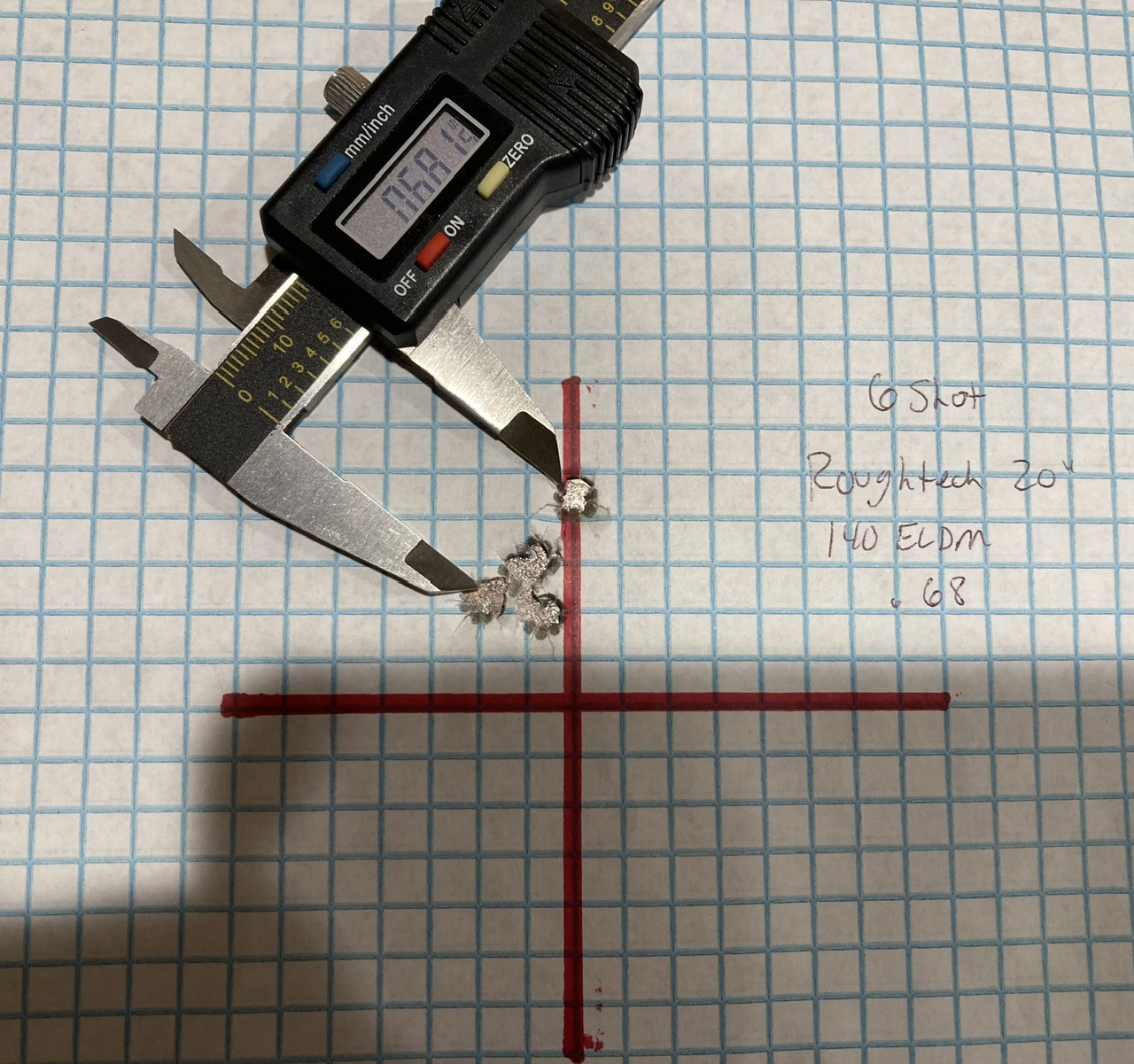

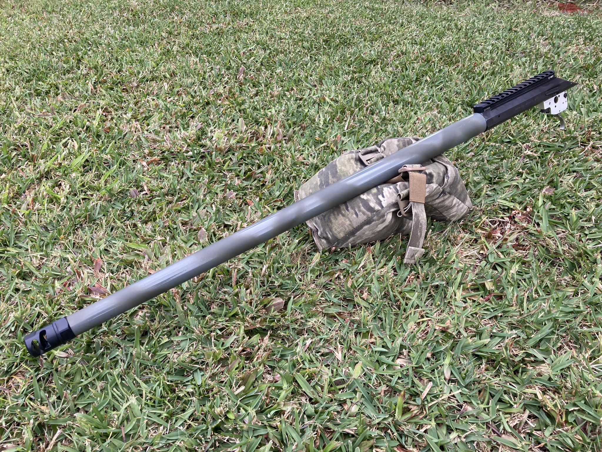

Both of these are the 24” fluted 6.5cm barrels on a Roughtech. Well, one isn’t now, it’s been cut to 20”. Both are shooters with factory ammo. Have some loads made that I need to shoot
View attachment 8528421View attachment 8528422View attachment 8528423
