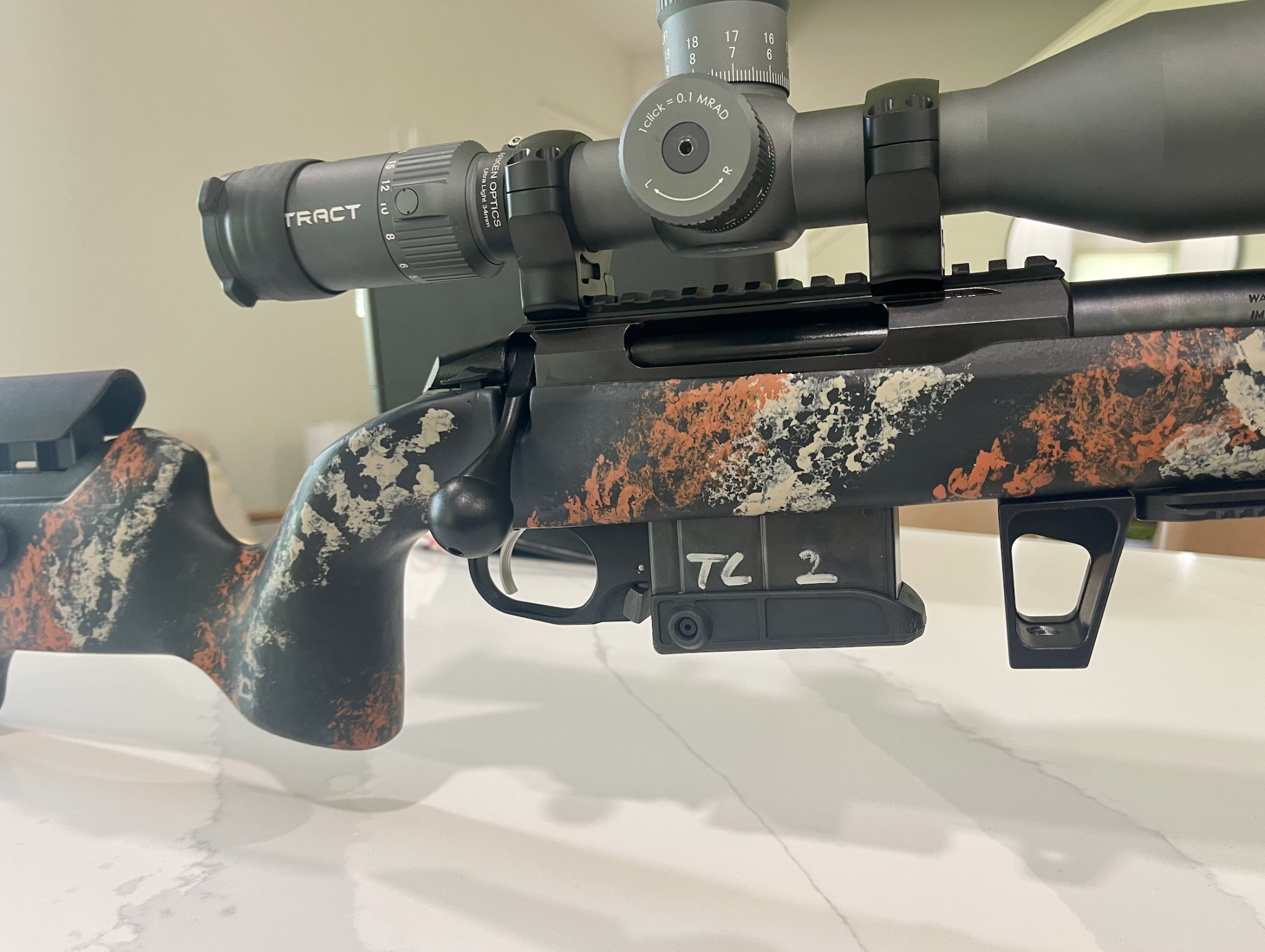

Finally got the Tikka t3x car. Looks really good with a suppressor. Got a couple boxes of 175gr fgmm. Will be doing research on factory match ammo that’s been successful with this particular gun model.

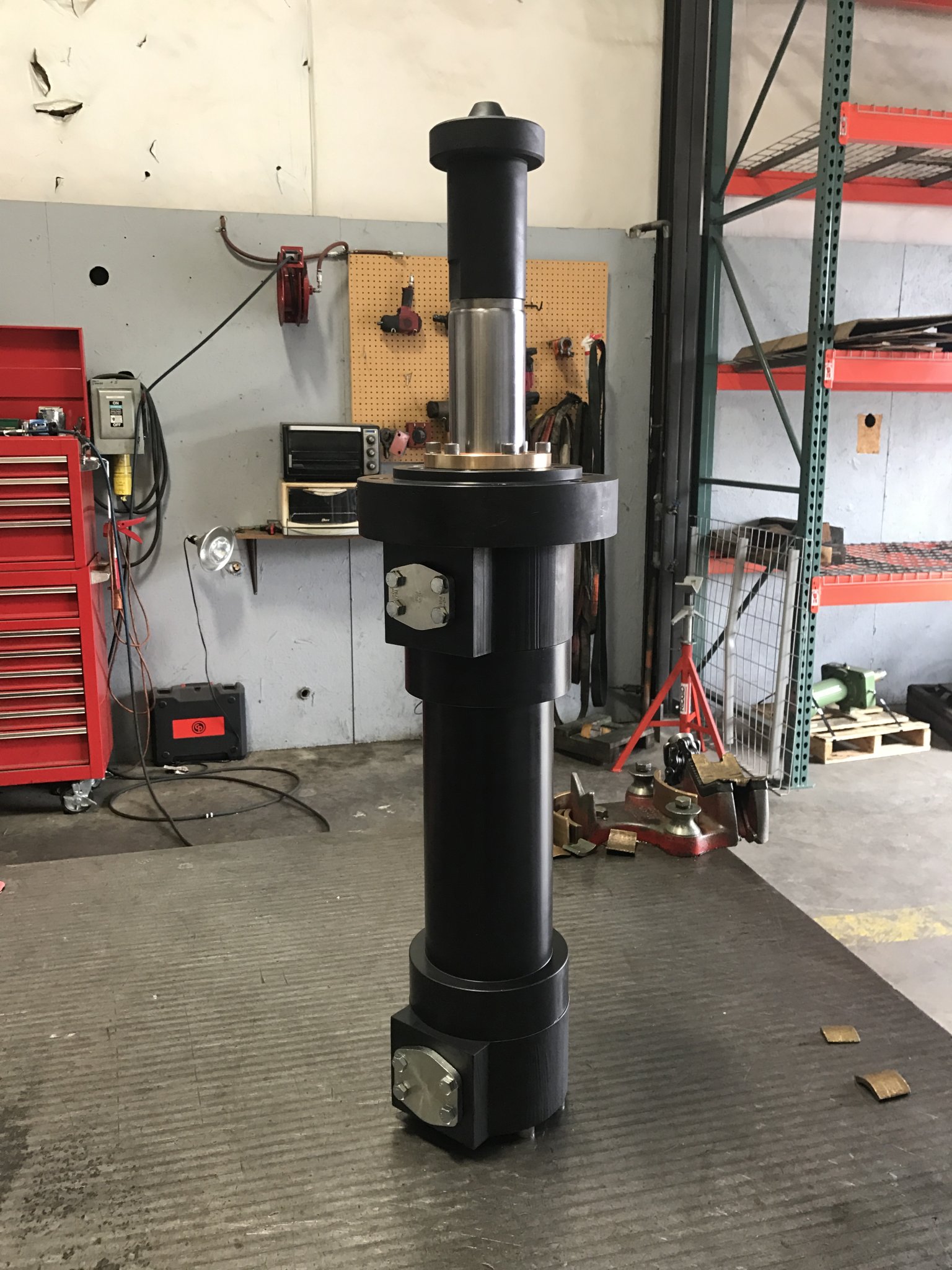

We build hydraulic cylinders, and we have gone to nitriding entire cylinders to prevent corrosion. The type of cylinder pictured, without nitride, after a year in service, looks like it’s been at the bottom of the ocean since the titanic sank. With nitride, they look brand new, no rust, just look like they have some dust on them. Like a dusty version of the brand new one shown.

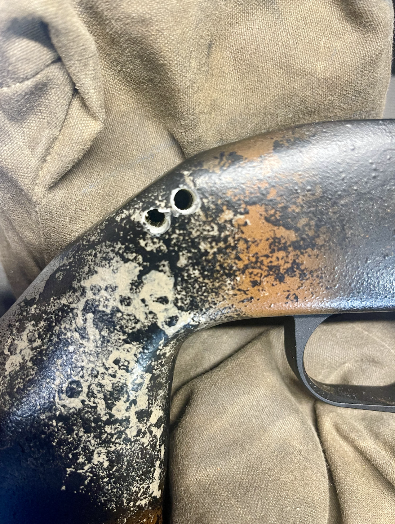

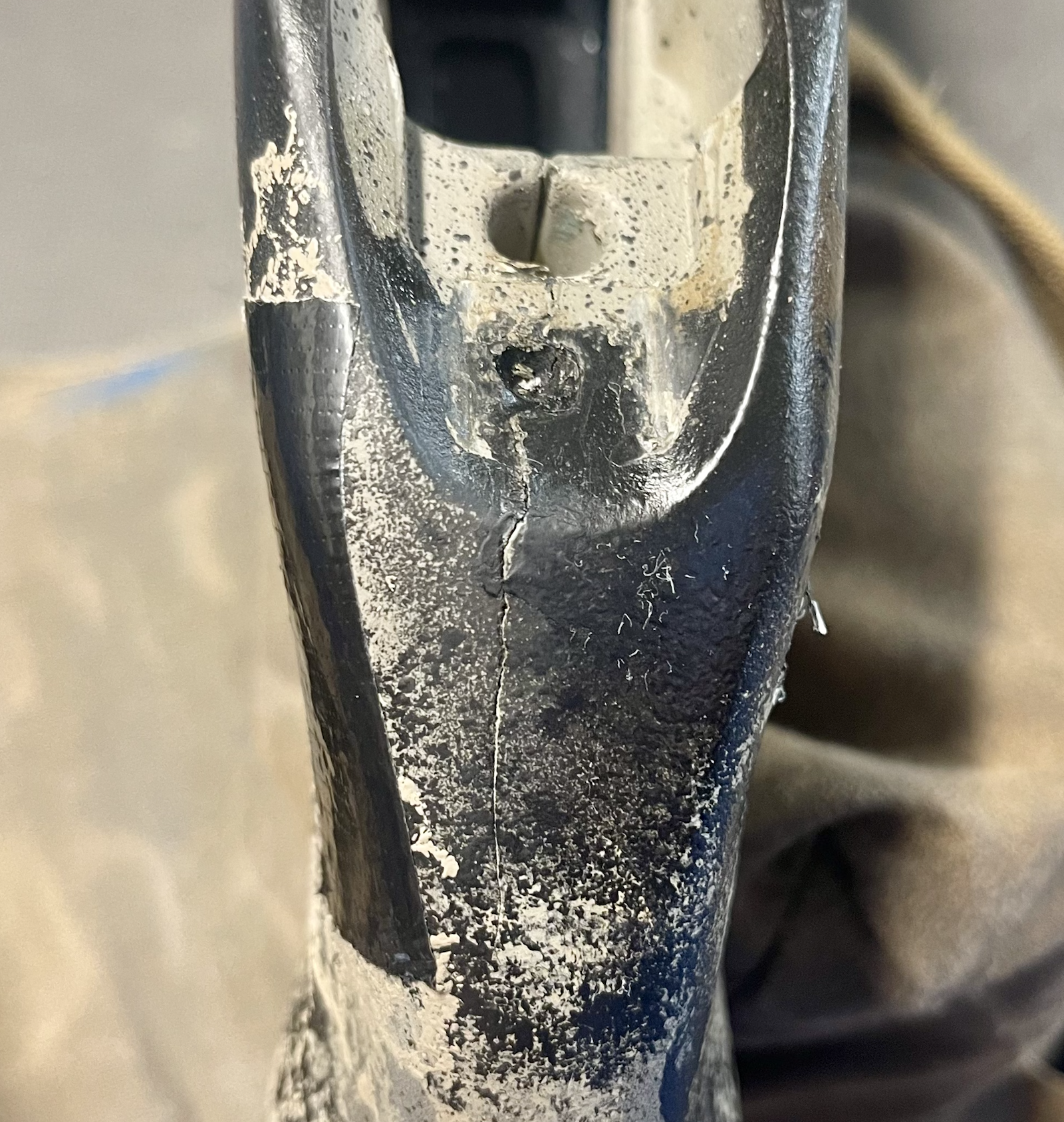

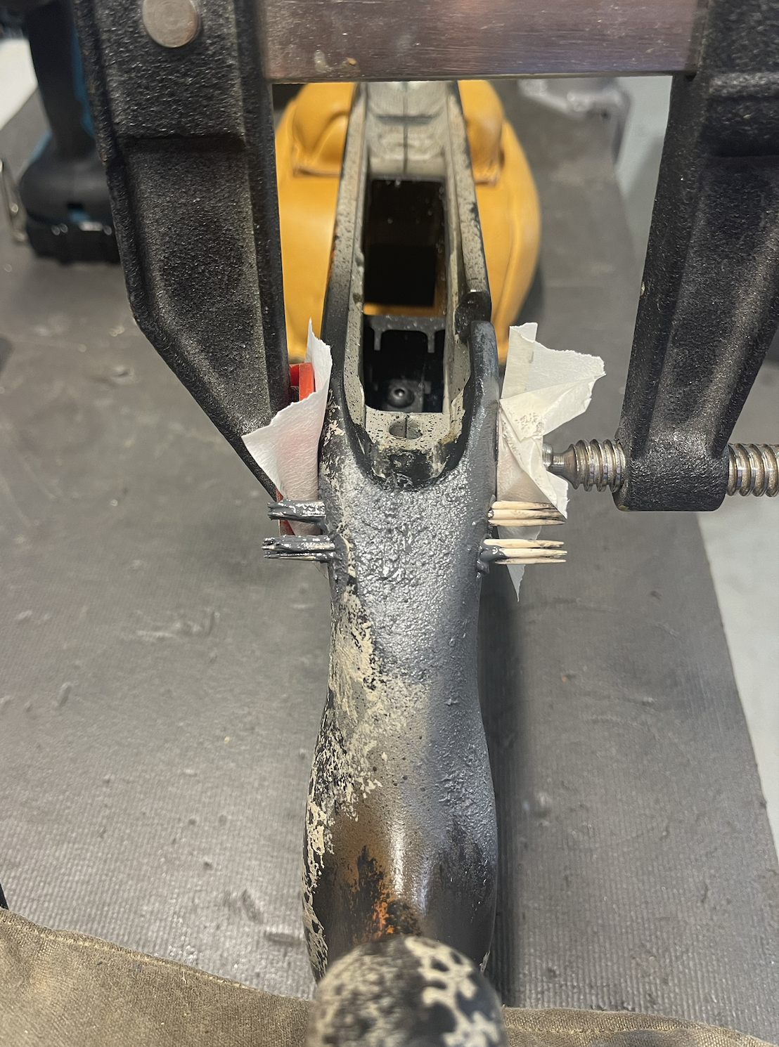

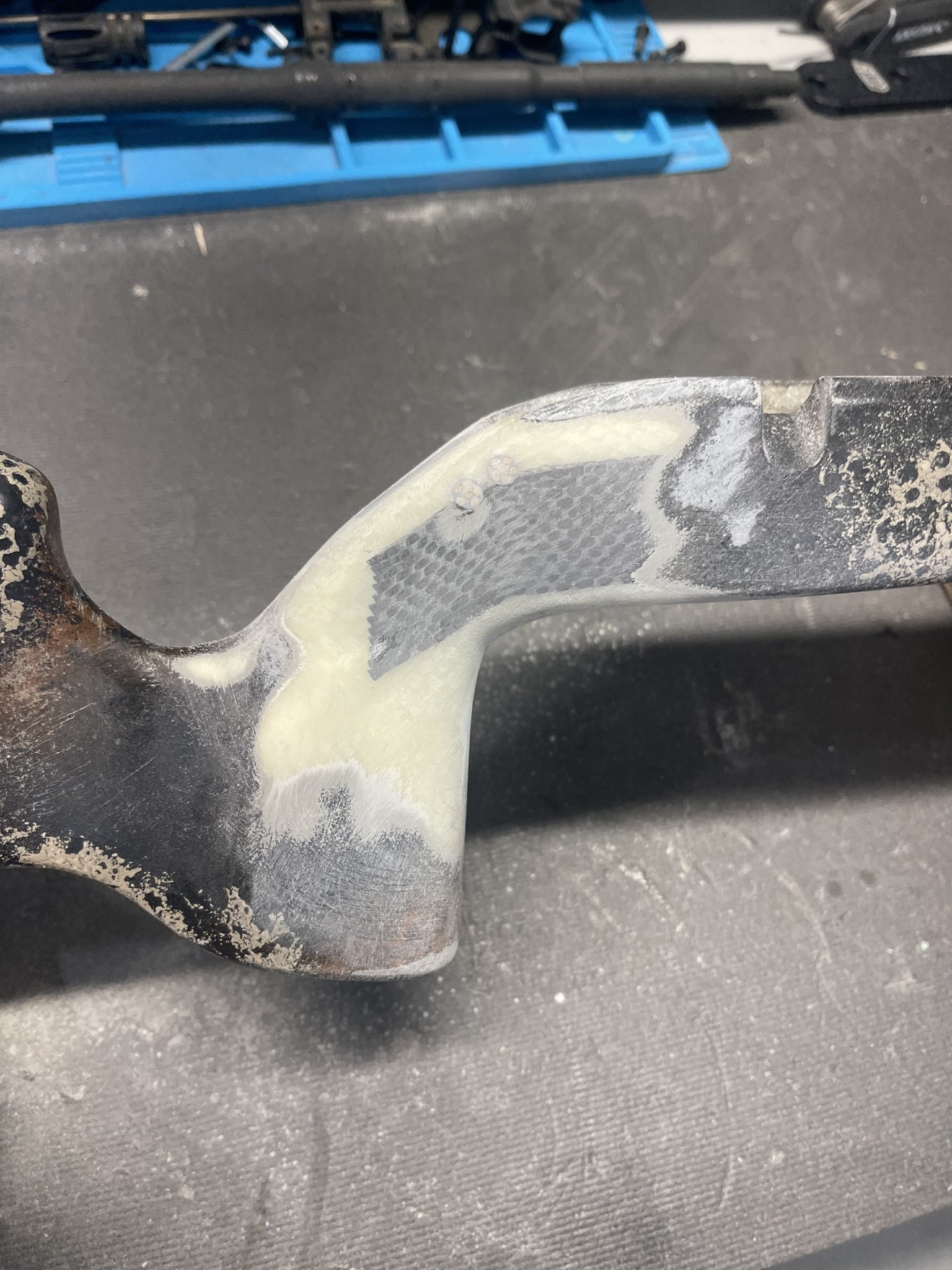

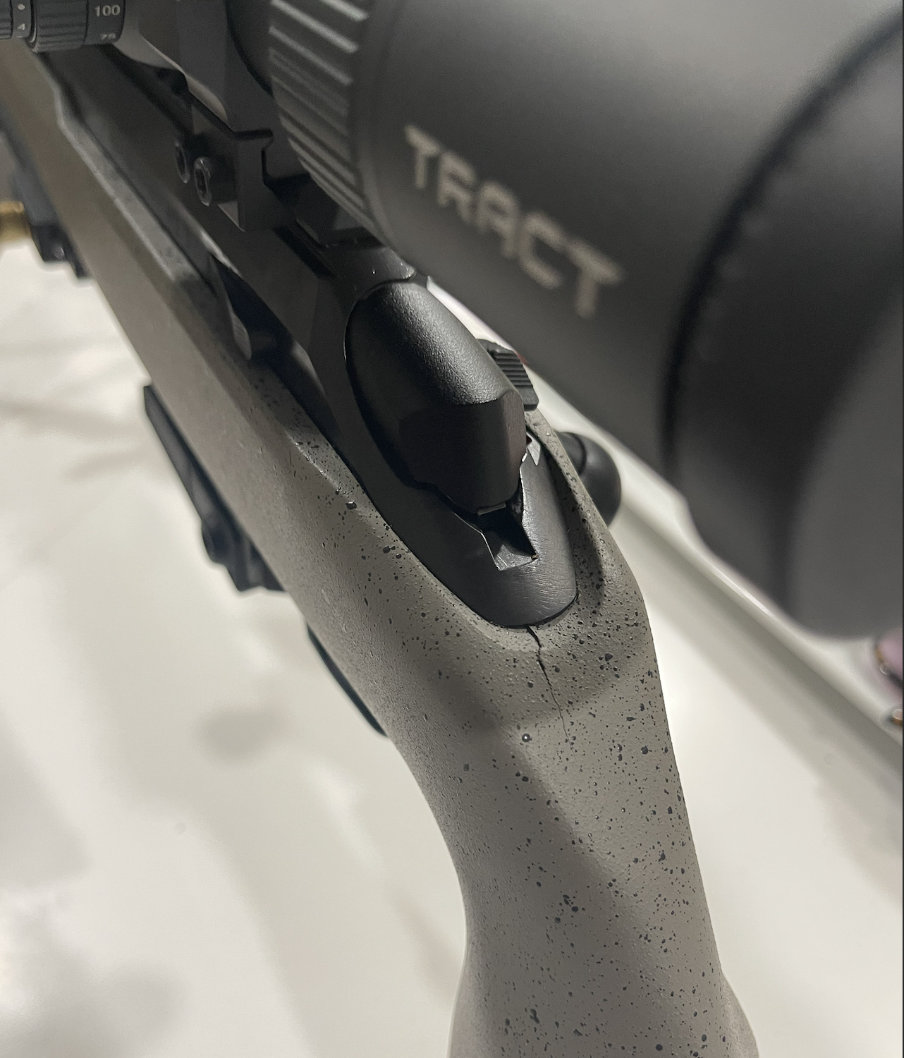

Hey gang,
After everyone chiming in, I decided not to roll the dice with Beretta.
1. Nobody had anything positive to say about their warranty process and CS.
2. CS told me they had no available stocks to replace it with that they could find. I could not bring myself to hand it over with any idea when I would get it back. If it were a mechanical issue with the action, then obvi I wouldn't have a choice.

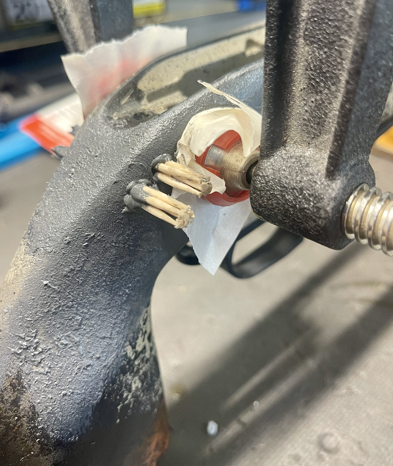

So, I took redneckbmxer24 input, but I used the strongest JB Weld I could find at around 5600psi. I drilled out the tail of the crack, cleaned well with acetone, filled, sanded and cured. I purposely did not attempt to clamp the crack closed, as I wanted the filler to have some tooth against the fiberglass (I'm a woodworker). Because I now had an eye sore, I decided "nah" and painted it. If the crack reappears, I'll just scrap it and put it in a chassis. Hopefully it'll last, as I actually like the stock. Paint job inspired by my 457 that's in a Manner's stock.
Before:
After:
Thanks to the hide for the input!
Not sure if you guys remember this from last year, but I got about 400 rounds out of the original repair but it just opened back up. I suppose it's just way too much repetitive psi right behind the action. After the first 50 or so last year, I kind of thought it might hold up, considering the beating the stock would take in this specific area. It'd either be fixed or open back up right away.
Just for fun, final attempt– Drilled out a couple of mortises perpendicular to the crack. I was going to peg them with solid material, but decided to use multiple pegs, in this case, toothpicks lol, so I can impregnate the "tenons" with resin. If this doesn't fix it nothing will. I'll send another update once it's finished.

Welp, here's the final. If she cracks again, it's going into the trash. I went ahead and formed up a fat palm swell and thumb shelf like my Manners. Super comfy. I used Marine-Tex due to high psi, can build it up thick, easy to sand and bonds well to fiberglass. I didn't bother filling in the air bubbles after it cured. Sorry, forgot to get a shot of just the Marine-Tex from rough to sanded before painting.
I repainted it a few days ago and put about 40 through it today and seemed fine. Time will tell, of course.

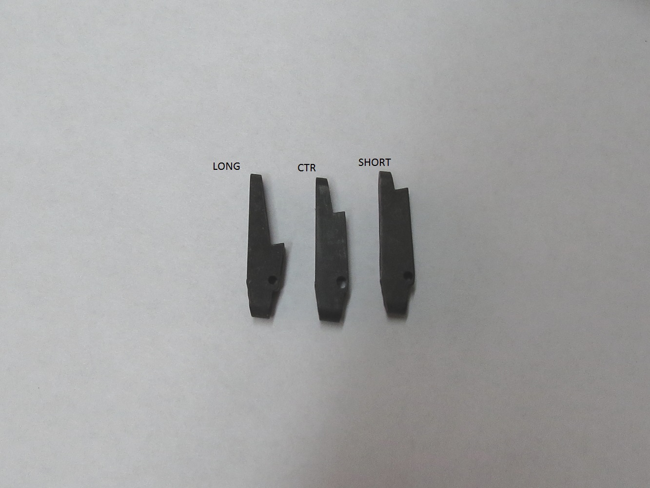

So does anyone have a definitive magazine internal dimensions list by chance? I'm trying to see which magazine would come closest to 3.036", if there even is one. If not, are there aftermarket 'spines' if you will that adjust the internal lengths?
The CTR and the MDT AICS ! Without ! Binder Plate are nearly the same inner length. Thats the reason I bought them and not the ones with Binder Plate. They are quite a bit shorter.
MDT Product quote:
"... Without a binder plate you get a longer COL (2.960" vs 2.870"), but they may require modification to the feed ramp of the receiver. Check if your action would be able to feed 2.960" long cartridges, or have it modified if you want to use magazines without binder plates...."
