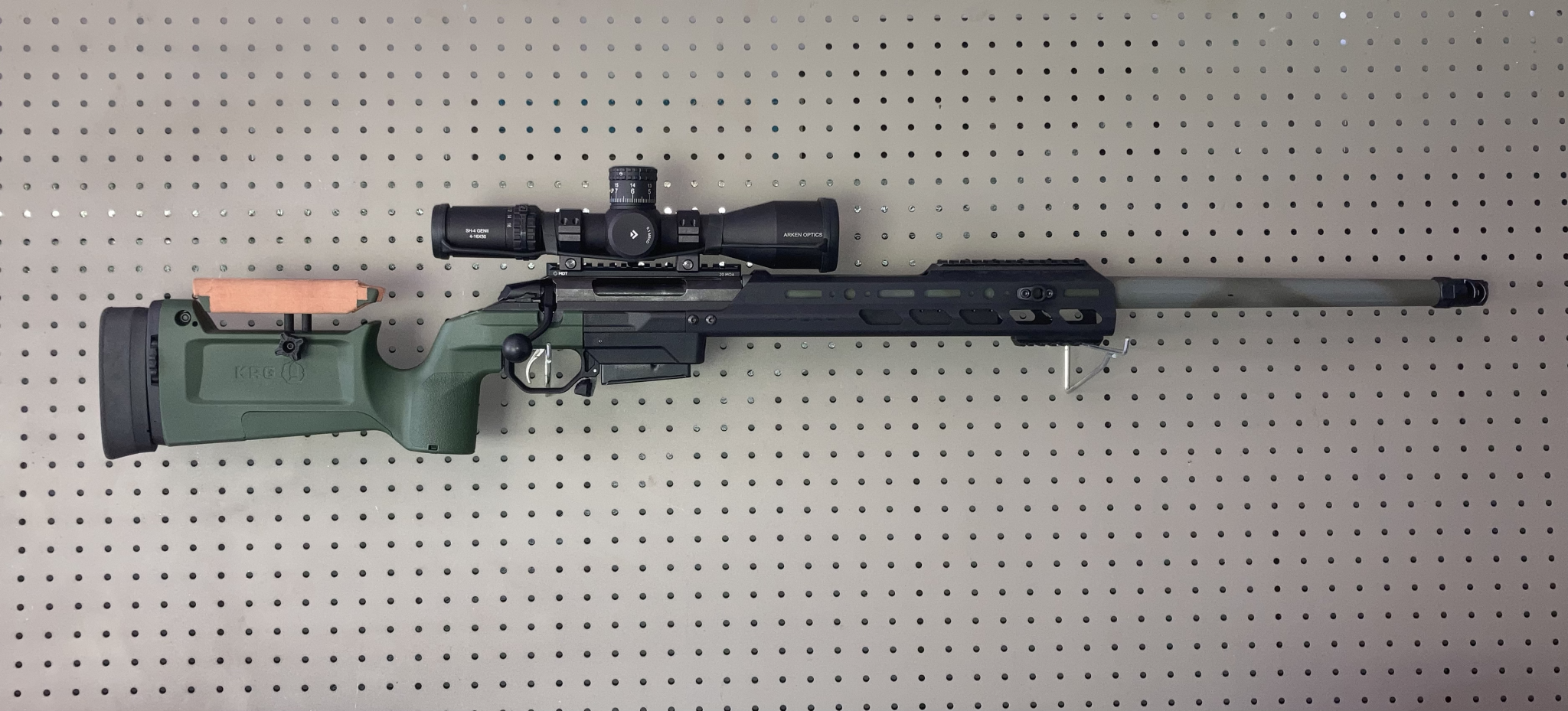

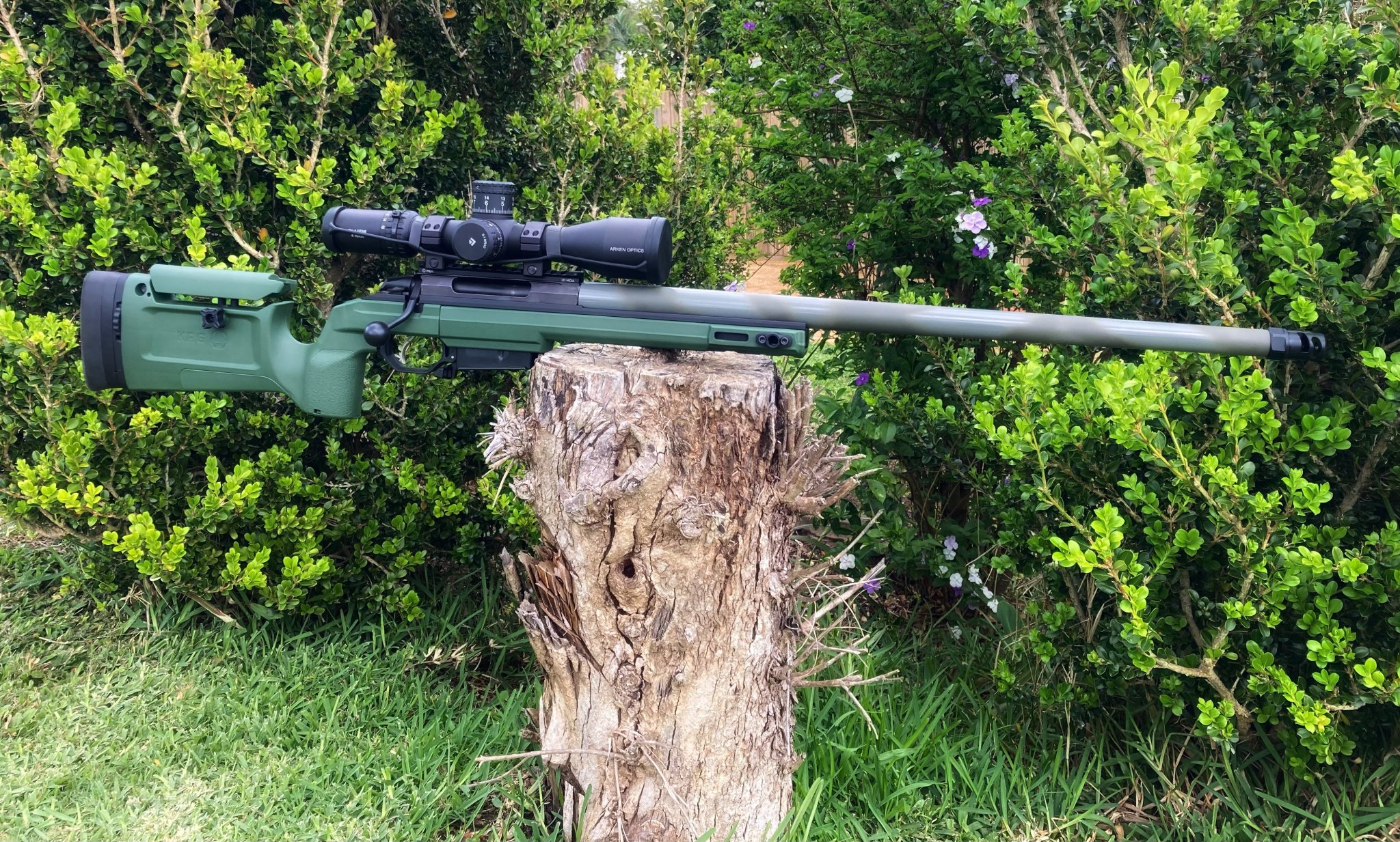

Finally got the CTR in a stock. I got the trg mag version as I like them better than most acis pattern mags at 10 rounds.

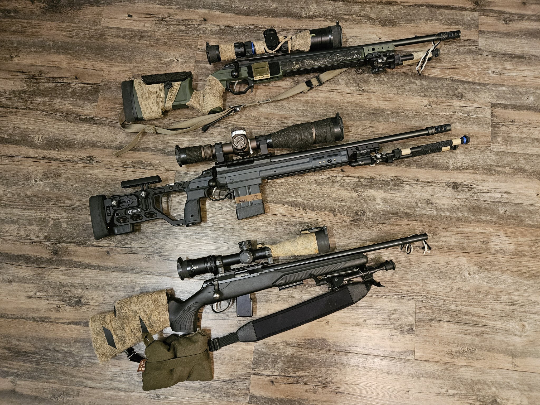

My Reaper and Ranger with CTR bottom metal inlets. I swap my rifles and stocks like legos. I use the CTR inlet bottom metal for AICS mags from Mountain Tactical for my 223 and 6.5 PRC in both stocks. I added the ARCA rail to the Reaper and the SRS ARCA/Picatinny rail to the Ranger.Have a Look at German Gun Stock Reaper Hunt Stock
Those are two very sexy riflesMy Reaper and Ranger with CTR bottom metal inlets. I swap my rifles and stocks like legos. I use the CTR inlet bottom metal for AICS mags from Mountain Tactical for my 223 and 6.5 PRC in both stocks. I added the ARCA rail to the Reaper and the SRS ARCA/Picatinny rail to the Ranger.

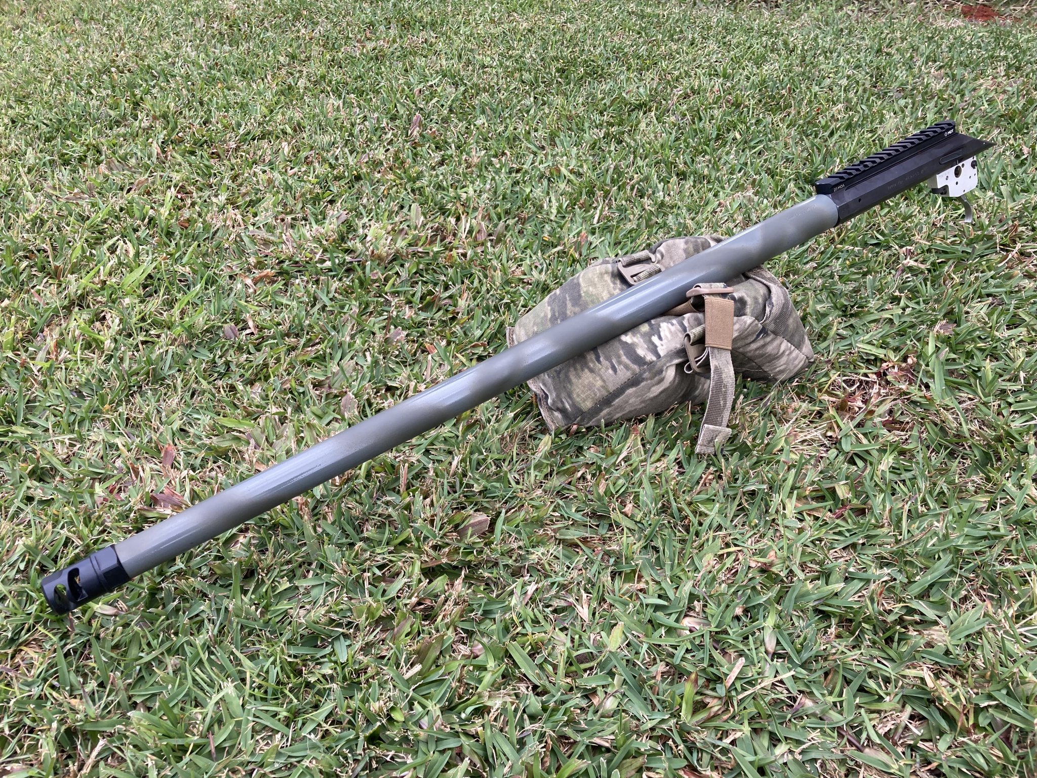

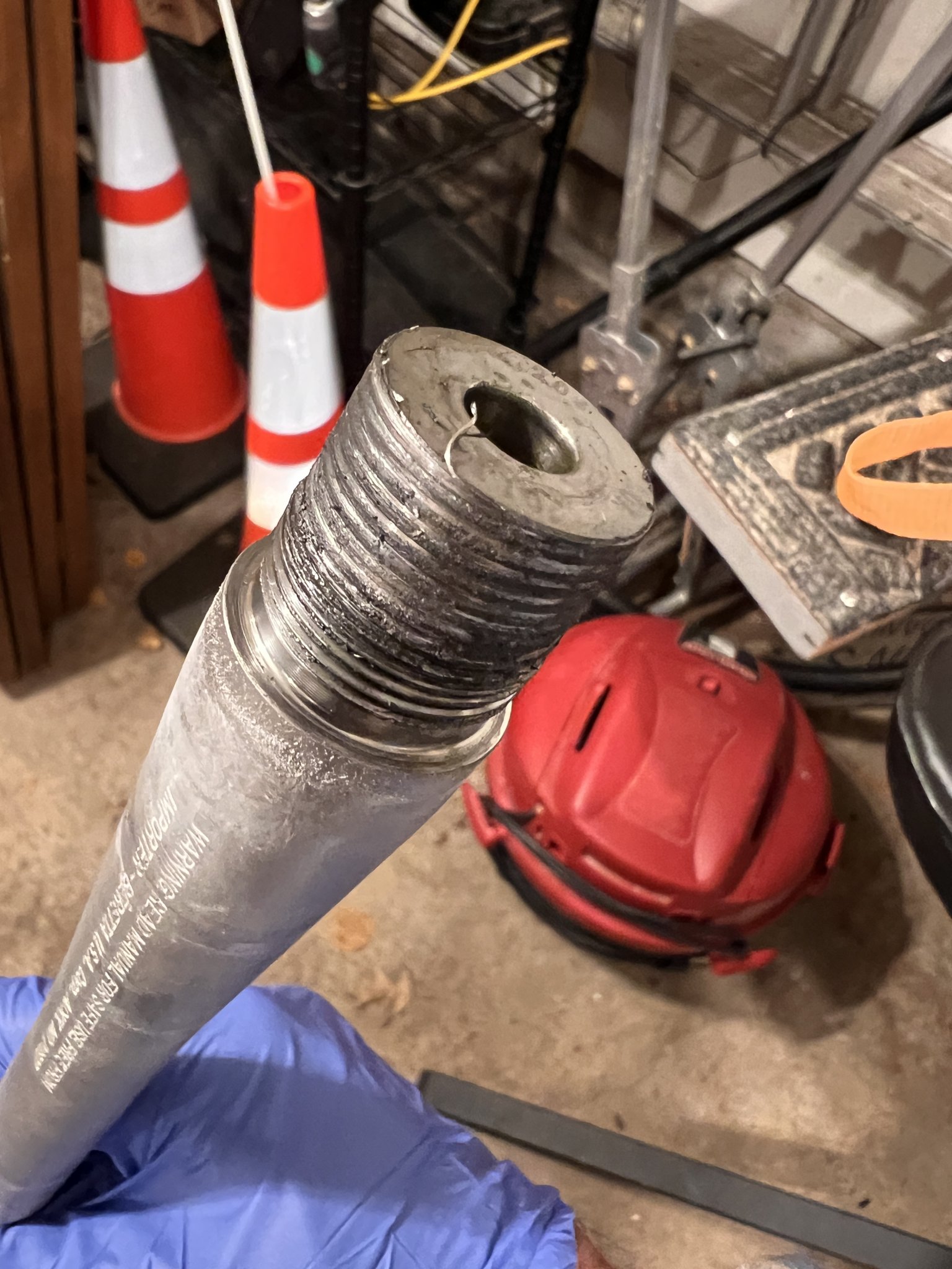

Tikka barrel Removal - not smooth as could be, now what?

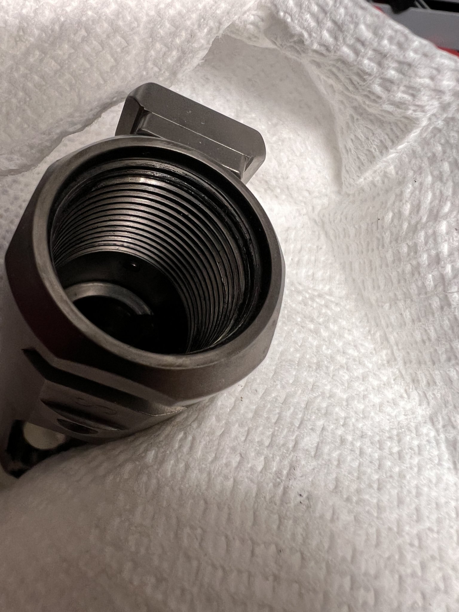

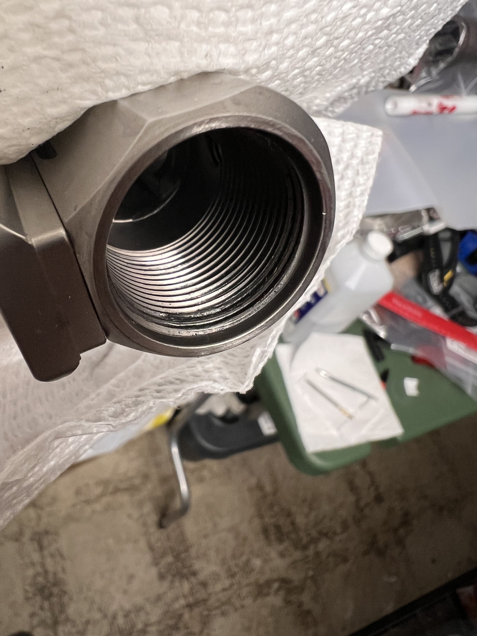

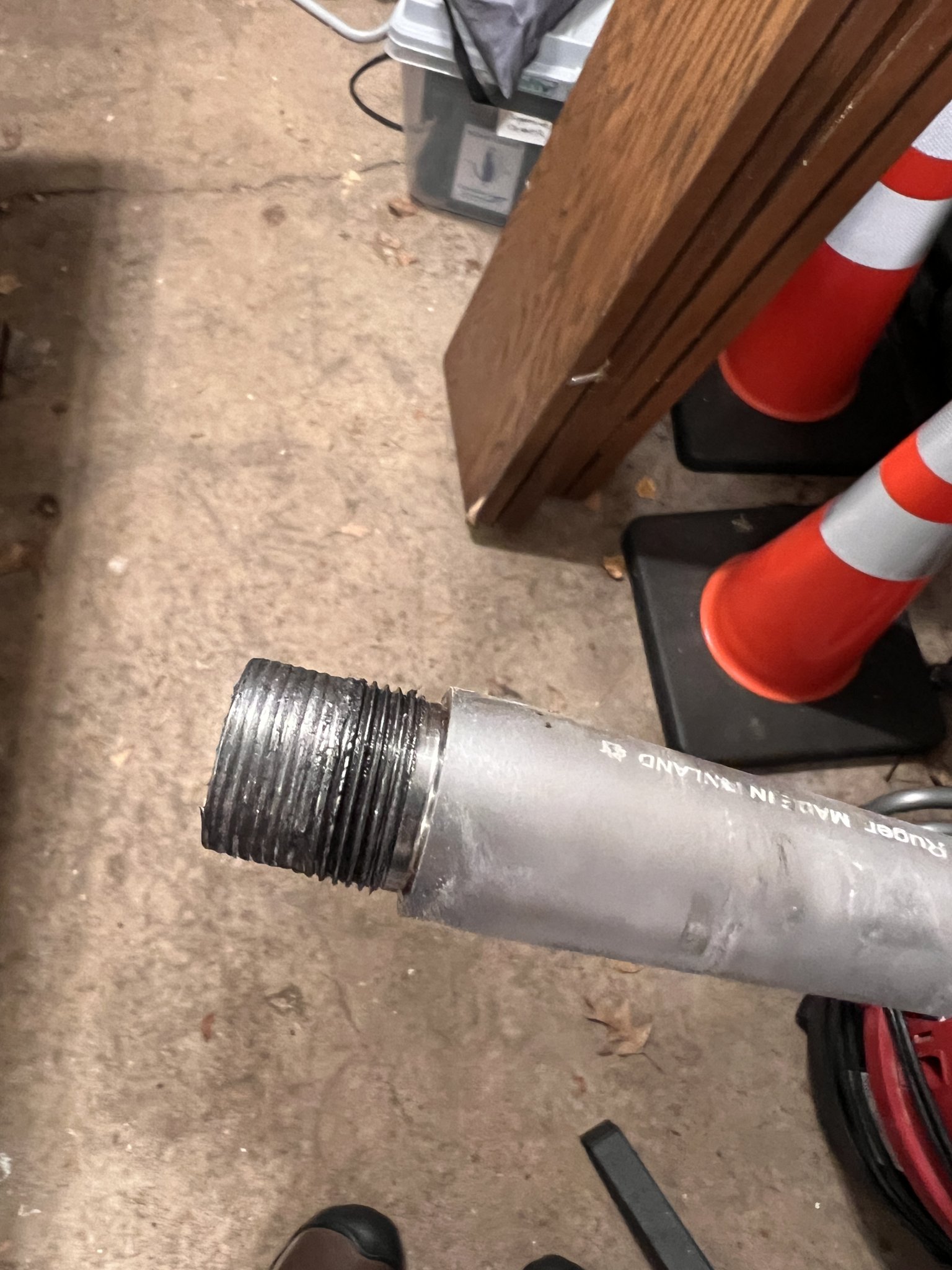

Using a barrel vise and Wheeler action wrench, the first action/ barrel came apart fine. The second rifle/action was a 300 WM. T3 gun. The barrel was tight. Finally after lots of work, it came off. The threads in the end of the barrel and initial threads of the action don't look very...www.longrangehunting.com
Gunsmithing - Tikka barrel removal, what happened here?
I've heard Tikka barrels were tight but wasn't expecting this. After breaking the action free, it took considerable effort to unscrew all the way off. Anybody ever seen anything like this with Tikka? Im leaning towards something going wrong during assembly at the factory and they just muscled it...www.snipershide.com
Before someone chimes in with the “too-deep pic rail screw” idea for the above barrels, the front base screw on Tikkas isn't on top of the threads.
It appears there is some truth to the “Effing Tight Tikka” myth.
Also, some personal experience in this matter (do check out the above links). I might as well come out and say it. Maybe it’ll help others in the future.
This horror story also just happened to me on my first ever barrel removal attempt. Happened to be a used T3. I had asked the seller why he was selling. He said, “I don’t need another project,” and in retrospect, he said it in a way that probably should’ve caused me to back away.
Maybe I had the exterior action wrench too tight, or maybe the factory barrel was threaded wrong at the factory, or maybe it was removed by an prev owner and reinstalled wrong. There was plenty of what appeared to be grease-like substance on the threads.
Maybe the prev owner used a too-long action screw? There was epoxy on the dovetail and down the threads where someone had glued down a pic rail, I imagine. Maybe some of the epoxy leaked forward into the barrel threads? Fuck if I know.
I certainly should’ve stopped once it was apparent that it wasn’t getting easier to unscrew. I had never dealt with galling before.
I used decent equipment. Short Action Customs Modular gun vise. Brownells exterior action wrench.
Sometimes you learn the hard way. My barrel is toast, and I think the action is too.
Look at that metal peeling off at the end of the threads.
View attachment 8439479View attachment 8439480View attachment 8439481View attachment 8439482
Obviously not attempting to screw my nice expensive prefit into THAT.
Luckily I already have a T3x Super Varmint to use for the prefit. Having a gunsmith remove its barrel. I am now literally a bit “gun-shy” lol.

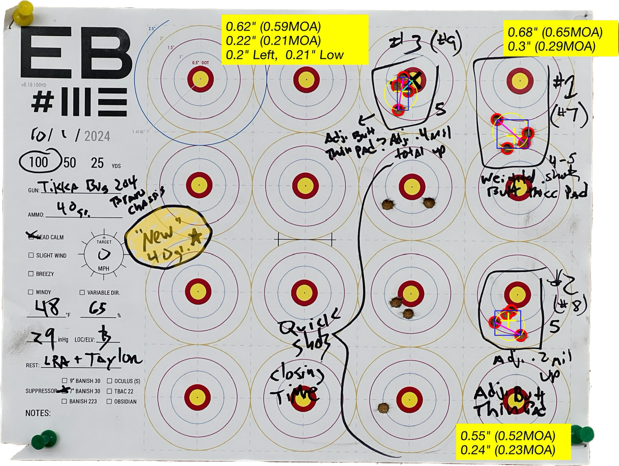

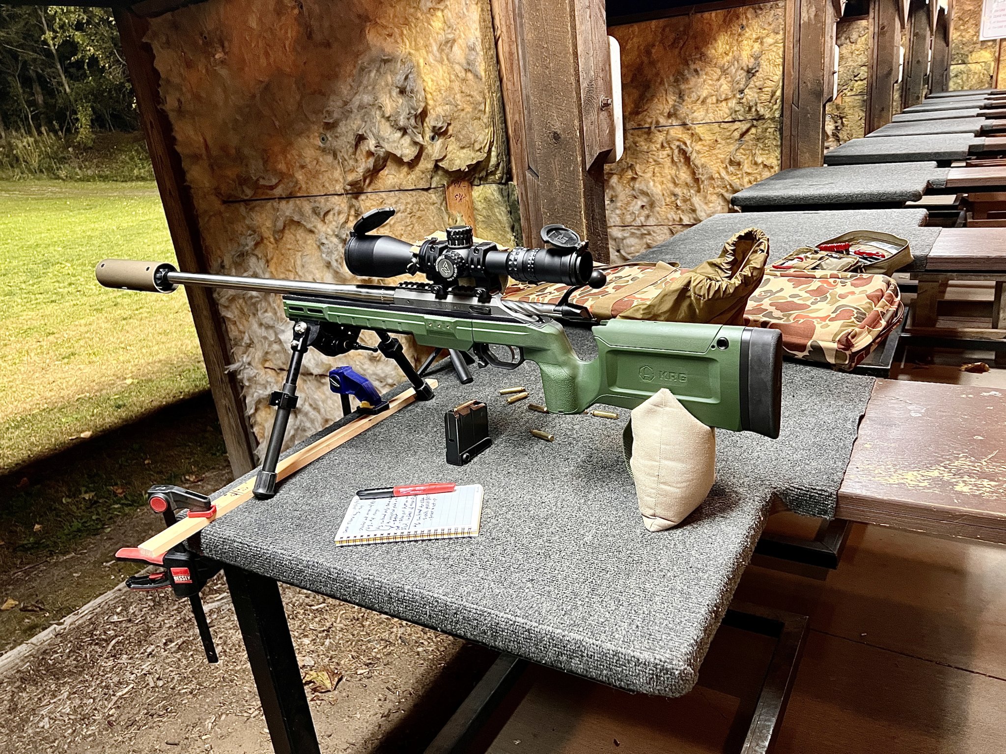

Meanwhile, I brought a different Tikka, a Super Varmint 223, into a better gunsmith than before (first guy wanted to “touch up the chamber” of the Bugholes’ barrel) and he removed the factory barrel.
I then put the Bugholes barrel on by myself with my Short Action Customs modular vise and the super-nice Bugholes Tikka action wrench.
No surprise, it shoots quite well! Probably better than the target shows, as I am still getting more comfortable shooting off a bench with a bipod.
Plus I have it in a Bravo and I don’t like the rear end of that chassis. It’s uncomfortable to me and it makes shooting harder than it should be (again, for me). I love my W3 so a Xray butt in on its way here as I wanted a lighter setup than a W3.

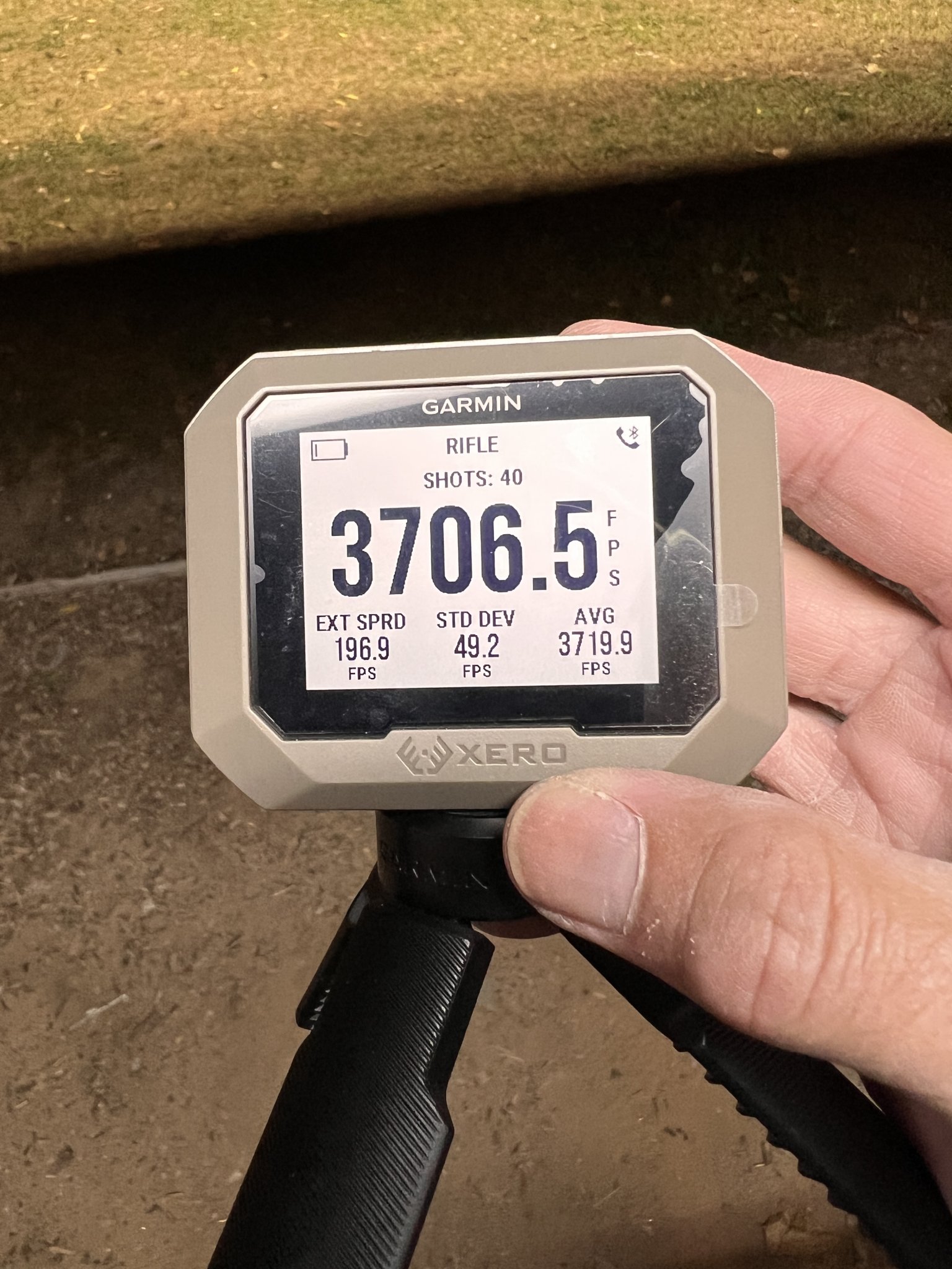

Oh yeah, shooting Hornady factory 40gr Superpreformance Vmax, which often has an ES/SD like this, which makes the barrel look all the better:
