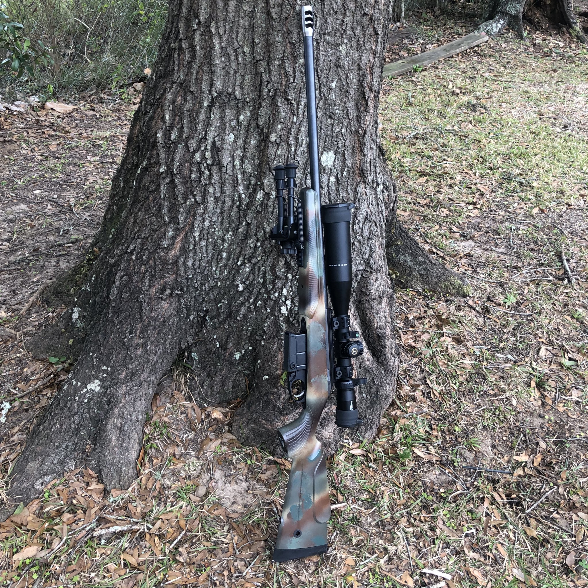

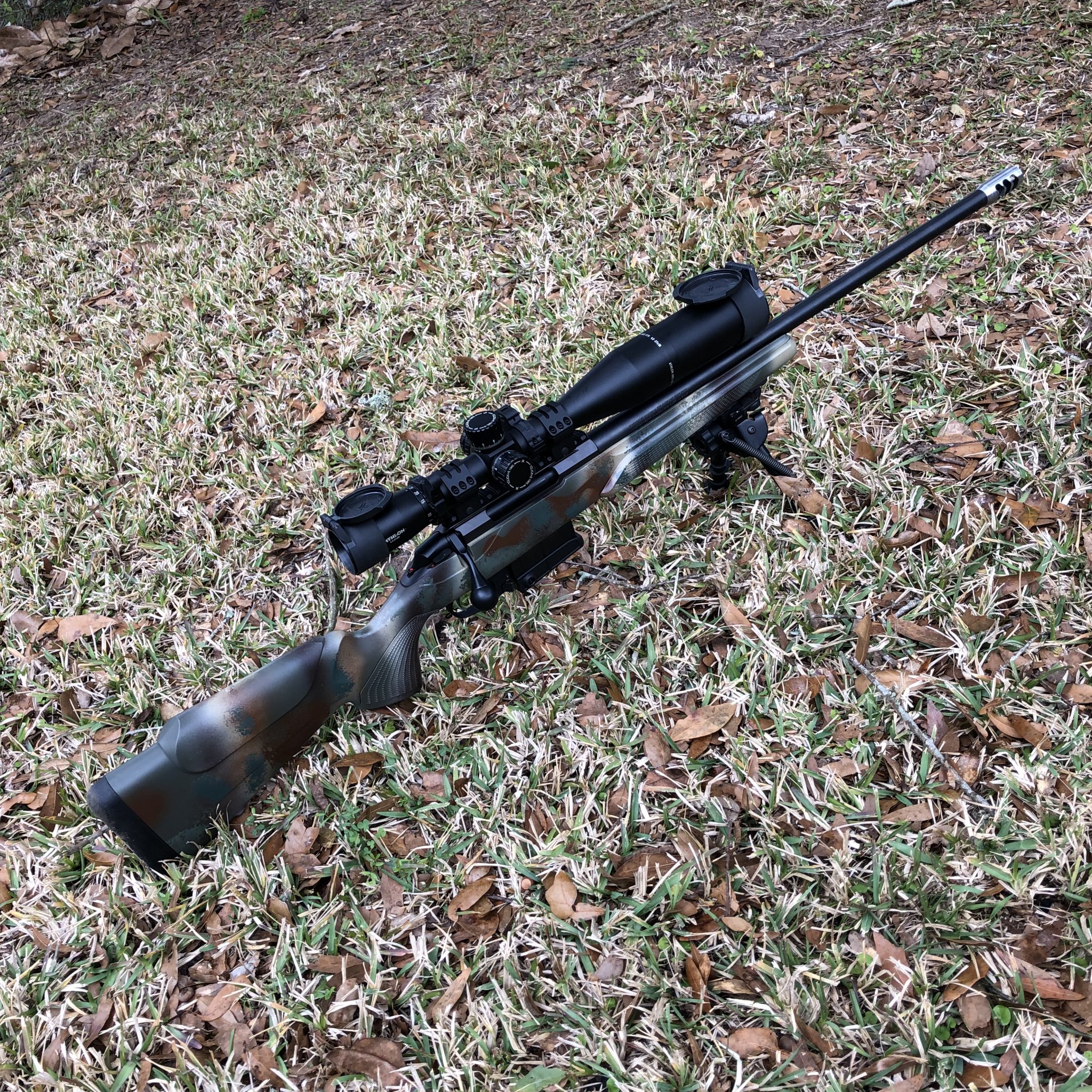

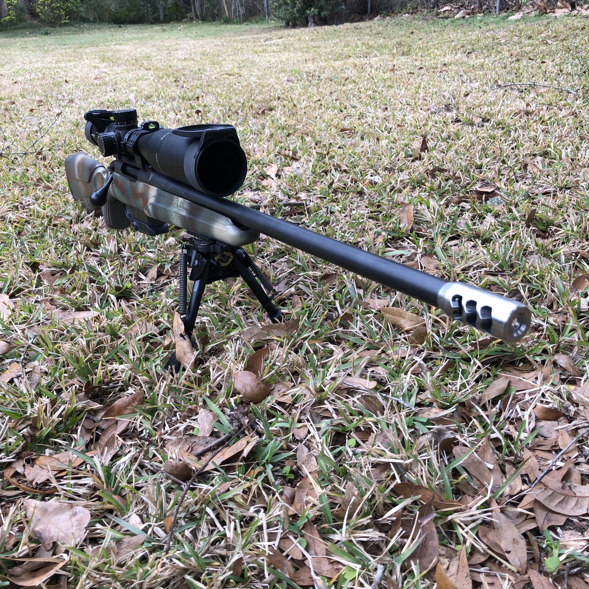

After the thread about painting stocks, I finally got down and did it myself. Been thinking of it for a long time, but had always been a bit cautious.
I am quite happy with the way it turned out. Just will have to clear it at a later date. Dont have many places to play with paint.

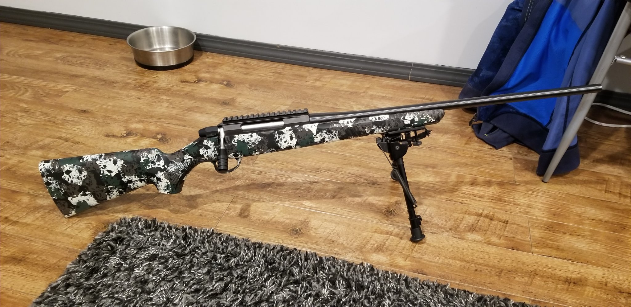

The sponge method could apparently work even for a total noob like me. Depending on season, I'd use more white, or more shades of green.
I am definitely new to painting things on rifles. This took me no time at all. I am happy with how it came out, much cheaper than the alternative stock upgrade.
Where I generally hunt is the badlands. So lots of colors around. Upper fields canola or wheat. Lower fields are grazing pasture.
Can be a few feet of snow, or no snow. Every year is different.

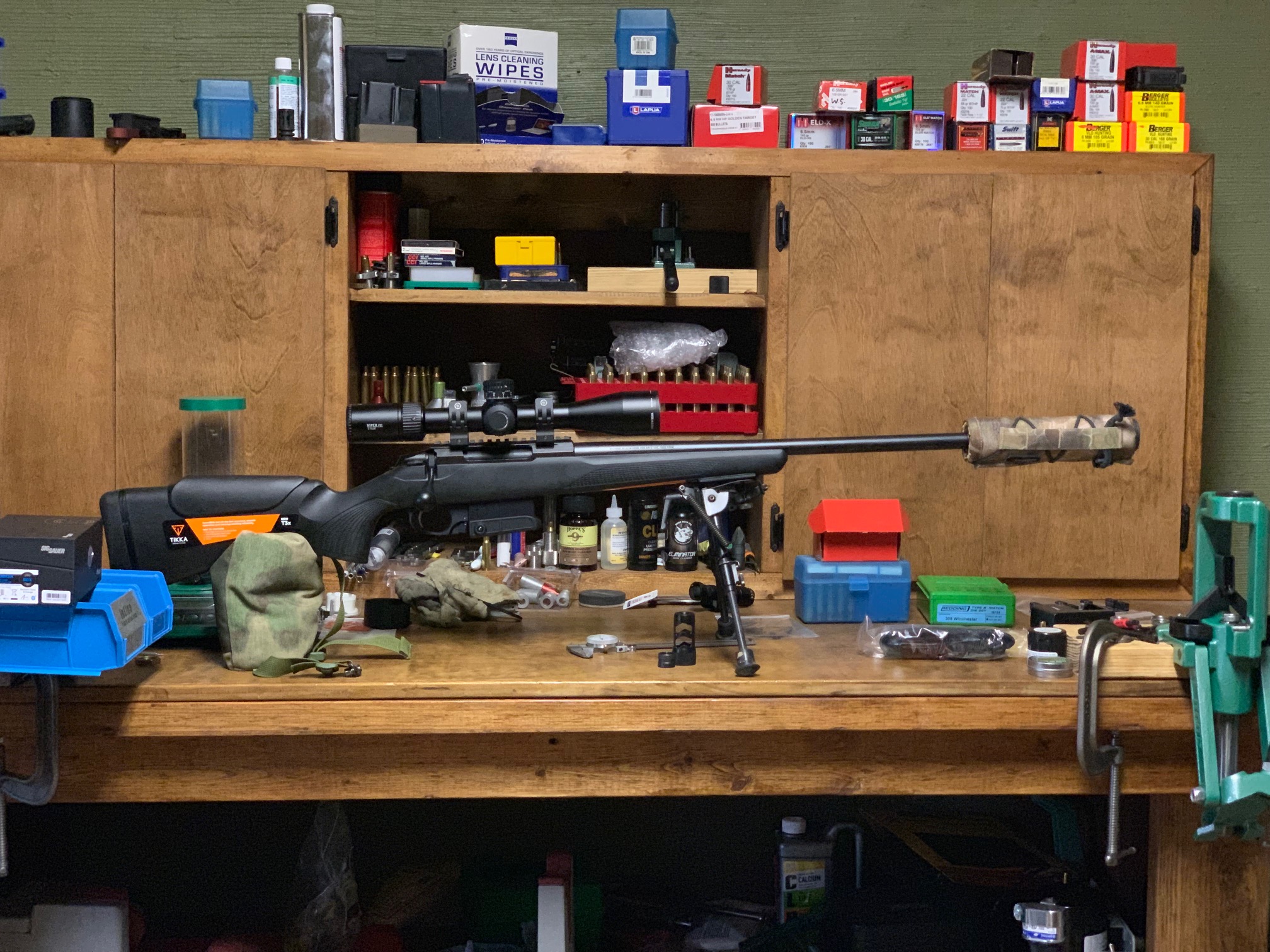

Setting up my Cousin's CTR we're about to drop it in an A5. Love this thing. Really wanting a T3 varmint right about now that i could drop into something like my PRS2 and make a 223 trainer. For right at $1750 minus the bipod and can that is one heck of a setup for the money. Yodave trigger spring has it right at 1.5bls.

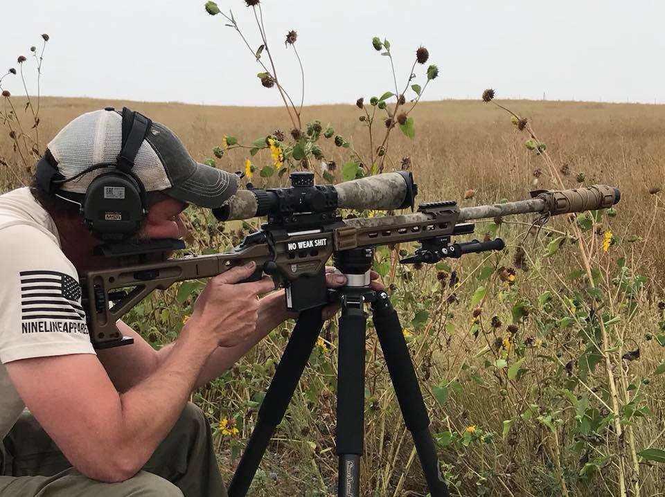

I think you are heading down a good path. I know I love my Tikka Varmint/Trainer...
MPA Comp BA chassis
Timney Two Stage
Leupold Mk 5 5-25x
DS Varminter 4.0 Suppressor (I had the barrel threaded 5/8-24)
Sterk swept AI style bolt handle
MPA Comp BA chassis
Timney Two Stage
Leupold Mk 5 5-25x

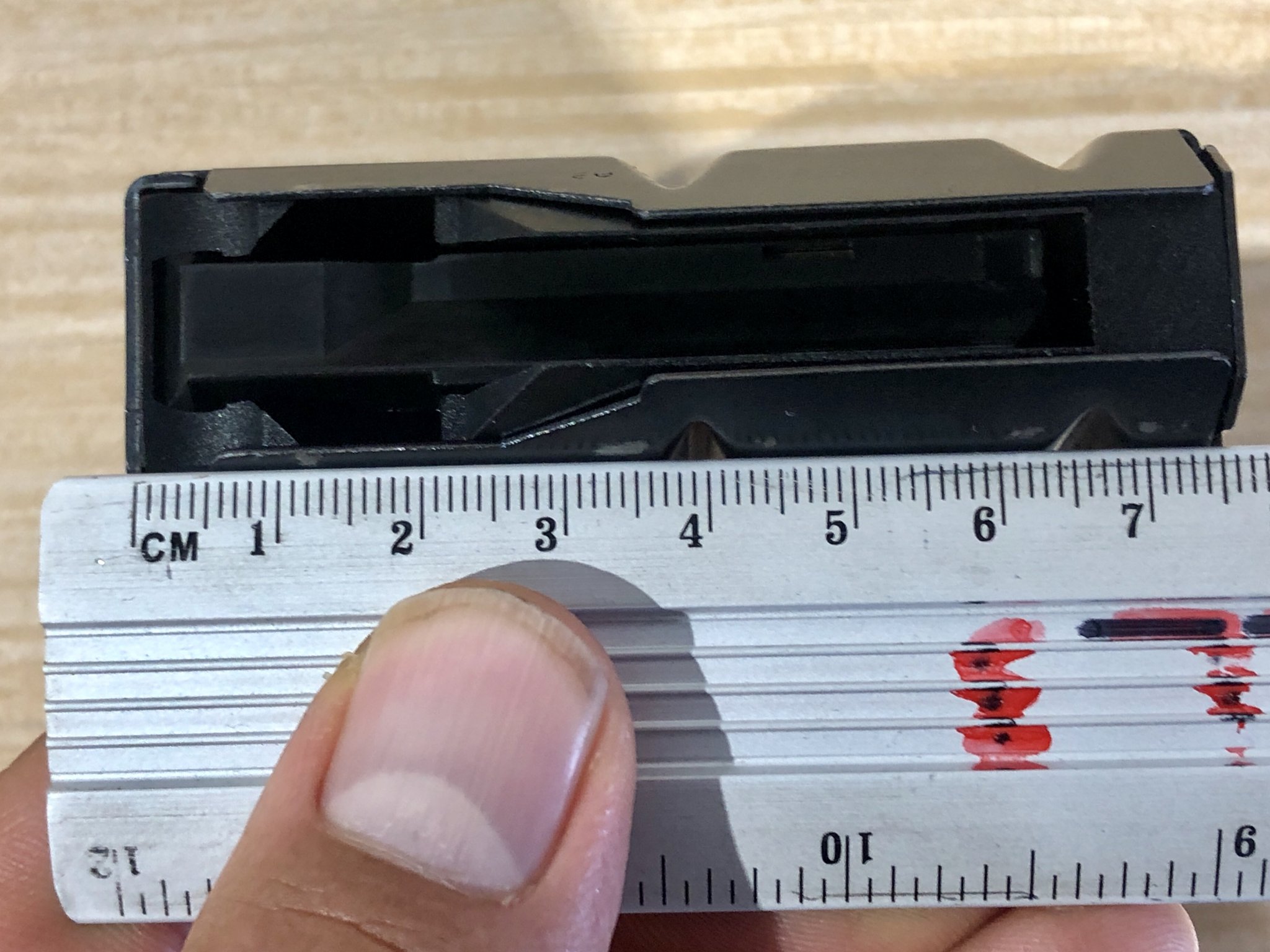

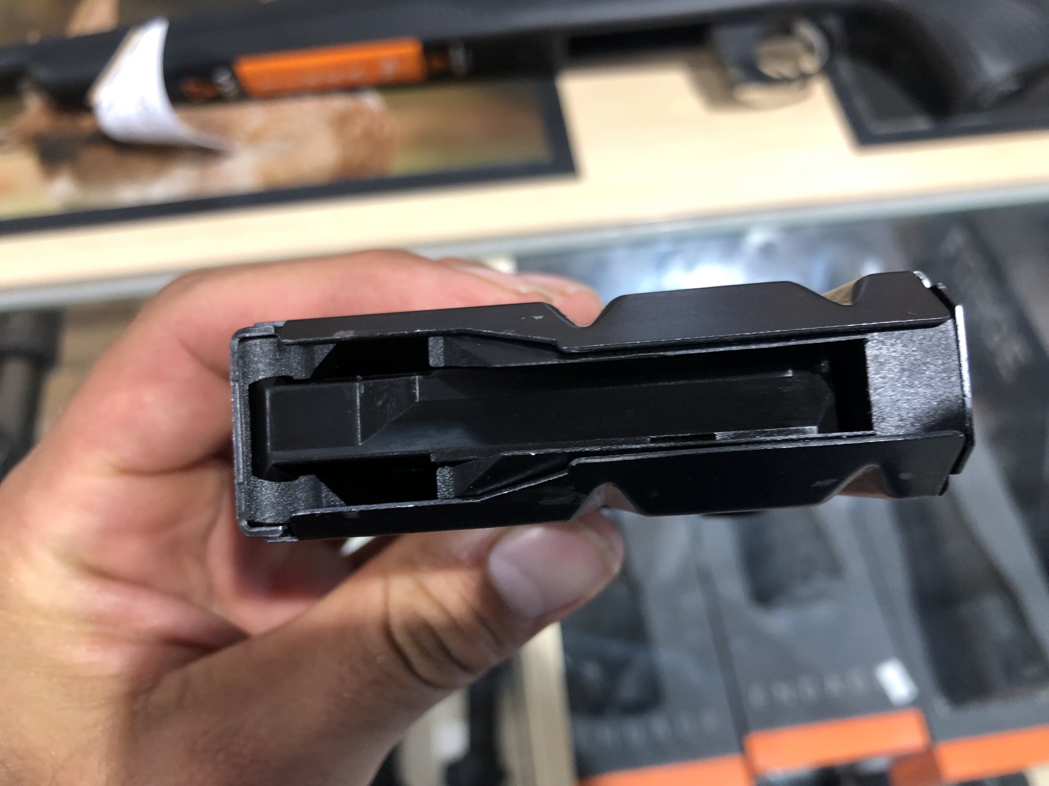

I have seen a picture and a video of someone shooting a .223 CTr and the outside of the magazine looked just like the 308/6.5 CTR mags. The insert like the accurate is probably right on the money.
I was in my local gun shop the other day, here in Australia, and they had a Tikka T3X CTR in 223 (1:12 twist) sitting there. I was in a rush but managed to snap some photos of the magazine.
According to the shop clerk the 223 CTR mag is the same exterior dimensions as the 308 etc CTR mag but with an insert.
From my not-great photo it looks like the max OAL in the 223 CTR mag is roughly 65mm to 66mm (2.56” to 2.60”) which is nice and long for those wanting to run heavy bullets or seat further out. ?

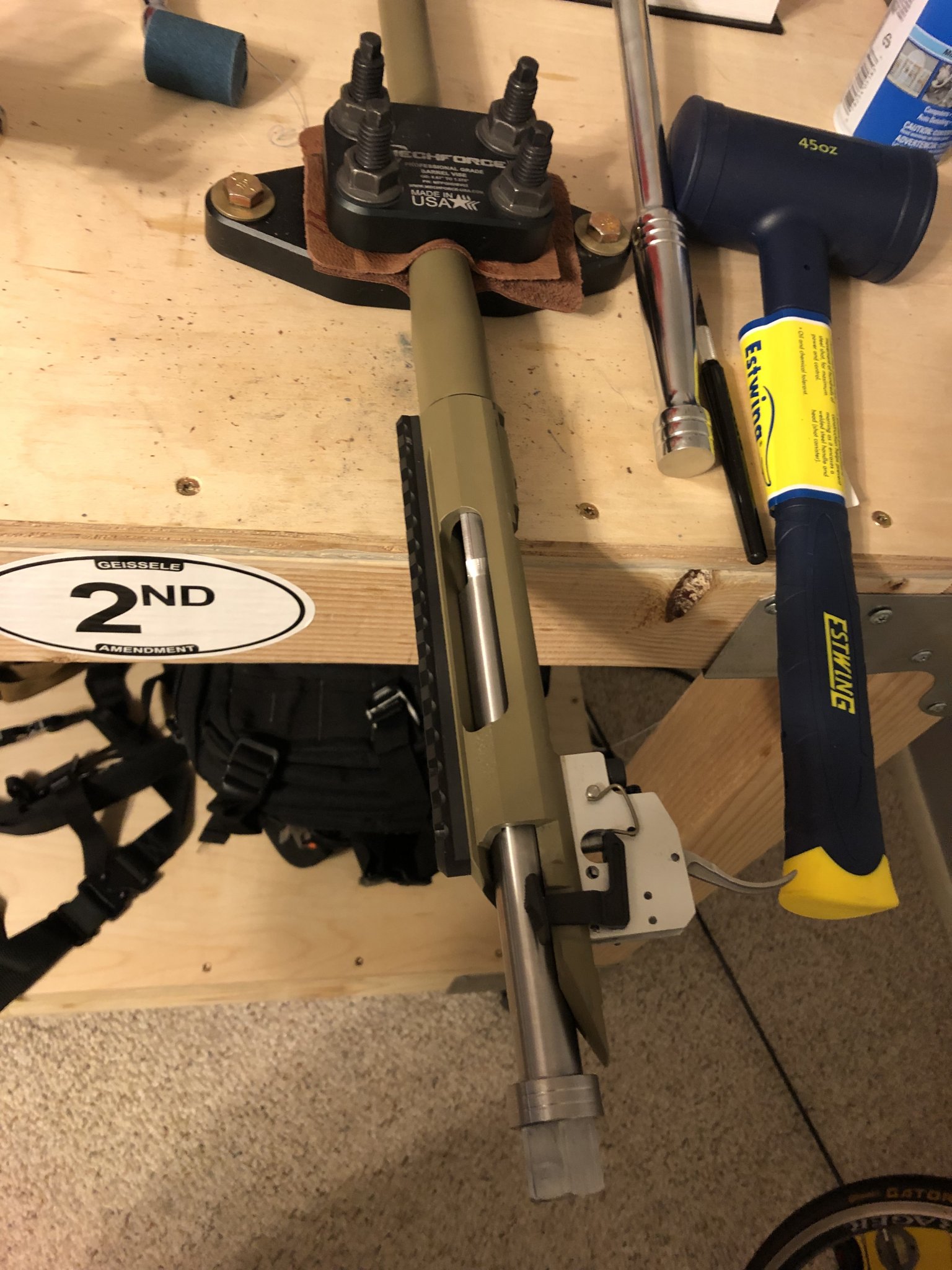

Well that's fascinating, I used the exact same barrel vice to remove a Tikka barrel and those leather pads were worthless. Seems like they decreased the friction rather than increasing it and the barrel would end up spinning. I asked Mechforce about it and they said the pads were more for delicate finishes and applications requiring less torque.
In the end 3 sheets of plain white paper in between the vice clamps worked like a champ. Barrel was held fast and the receiver came off without too much effort.
-Stooxie
-Stooxie
oh the original pads are toast lol. That pic was my other Tikka that has been upgraded by a smith. That barrel was a breeze to get off, the factory one...that's another story however. Still can't get it to budge and think I ruined it to be honest.
Reactions: Stooxie
Ha! Ok, so our experiences are sadly consistent! ;) My factory barrel wasn't too bad. I held it upright for a couple days with Kroil around the threads, although who knows if that helped. Then I clamped the barrel at a point were it didn't have much taper and then wedged a piece of 2x4 under the barrel shoulder to eliminate any flex when I turned the action wrench. I used a Wheeler #1, also with paper between it and the receiver flats. Seems to do the trick nicely. Maybe that might help you.
-Stooxie
Yeah, my factory .223 hunter barrel is not coming off ever I don't think., mainly because I'll mess up the finish if I do it, and I don't want to pay a smith to pop it off because then I'll need to buy another barrel for it!
