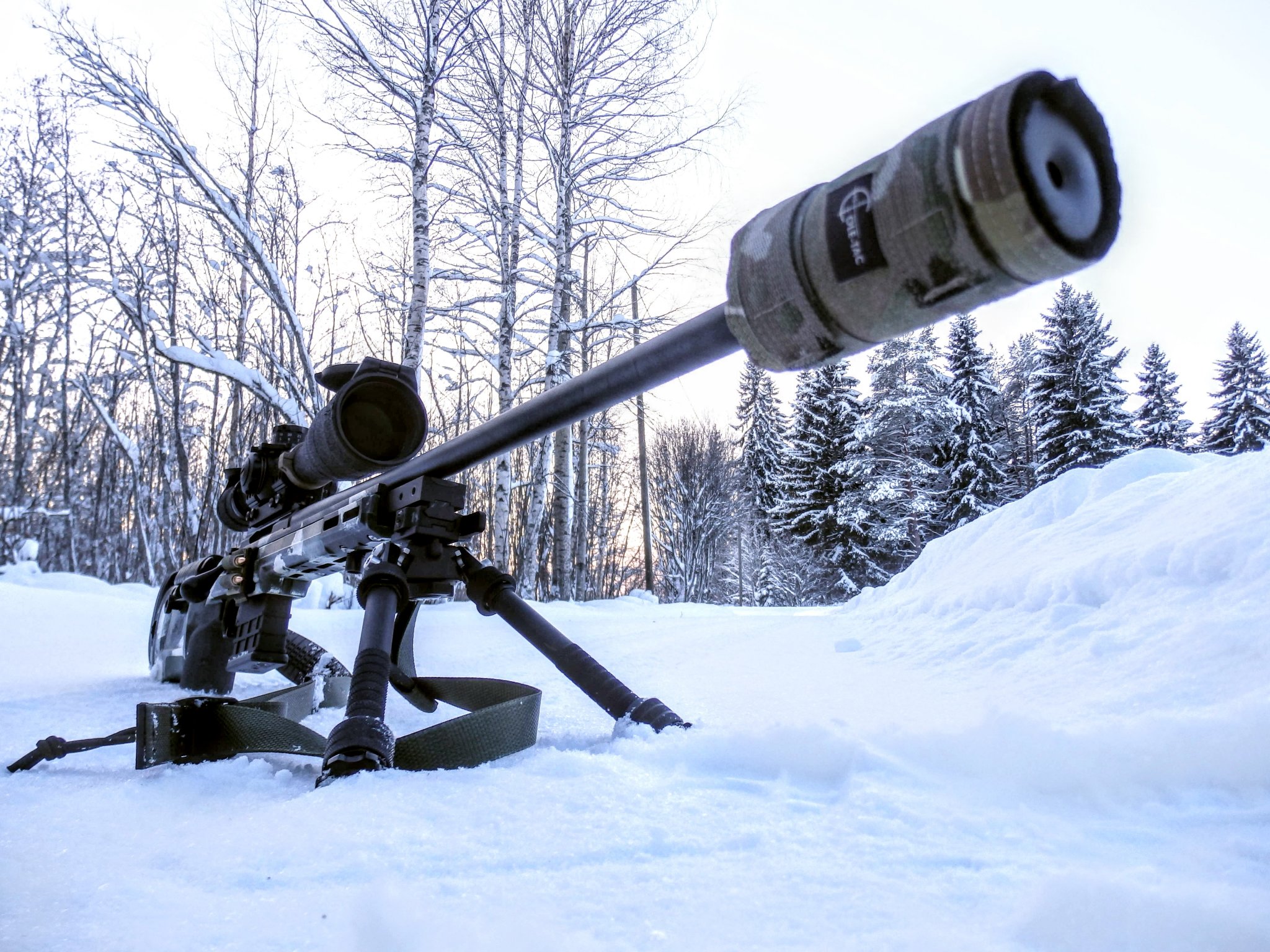

I like the Thunderbeast 30CB with an Ultra7 mounted.
