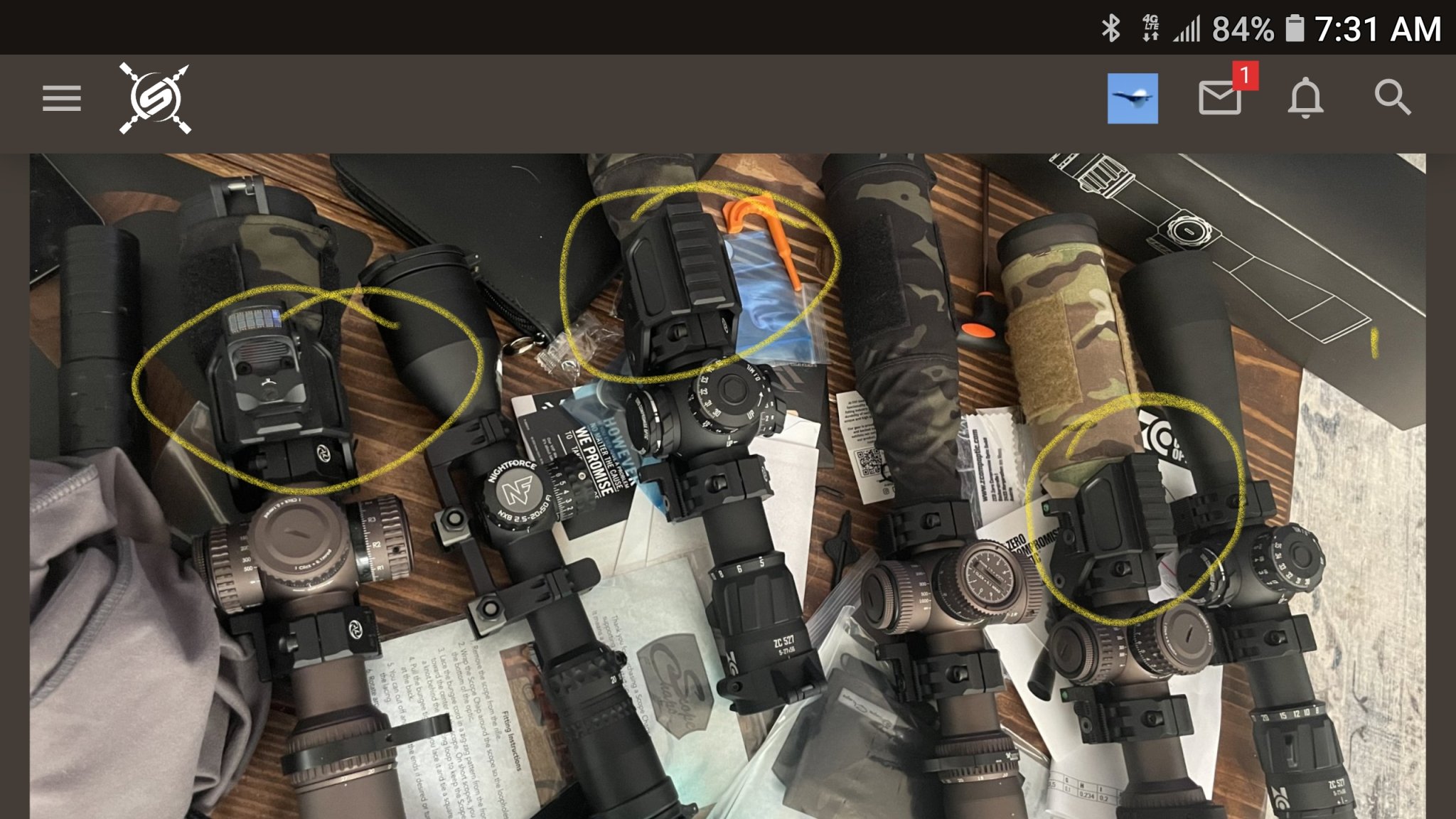

welp.. going to take some crap for this. After more thorough look with a light… it’s not the ocular lens. It’s the lens on the objective side of the turrets. But not the outer lens. It’s a lens by the turrets.
If it were me, I would talk to whomever it was that made the scope and if they have a US facility and agreed I’d send the whole damn rig in as is. Rifle and all, then ship them some ammo. Give them the best possible chance of figuring out what is going on and why.

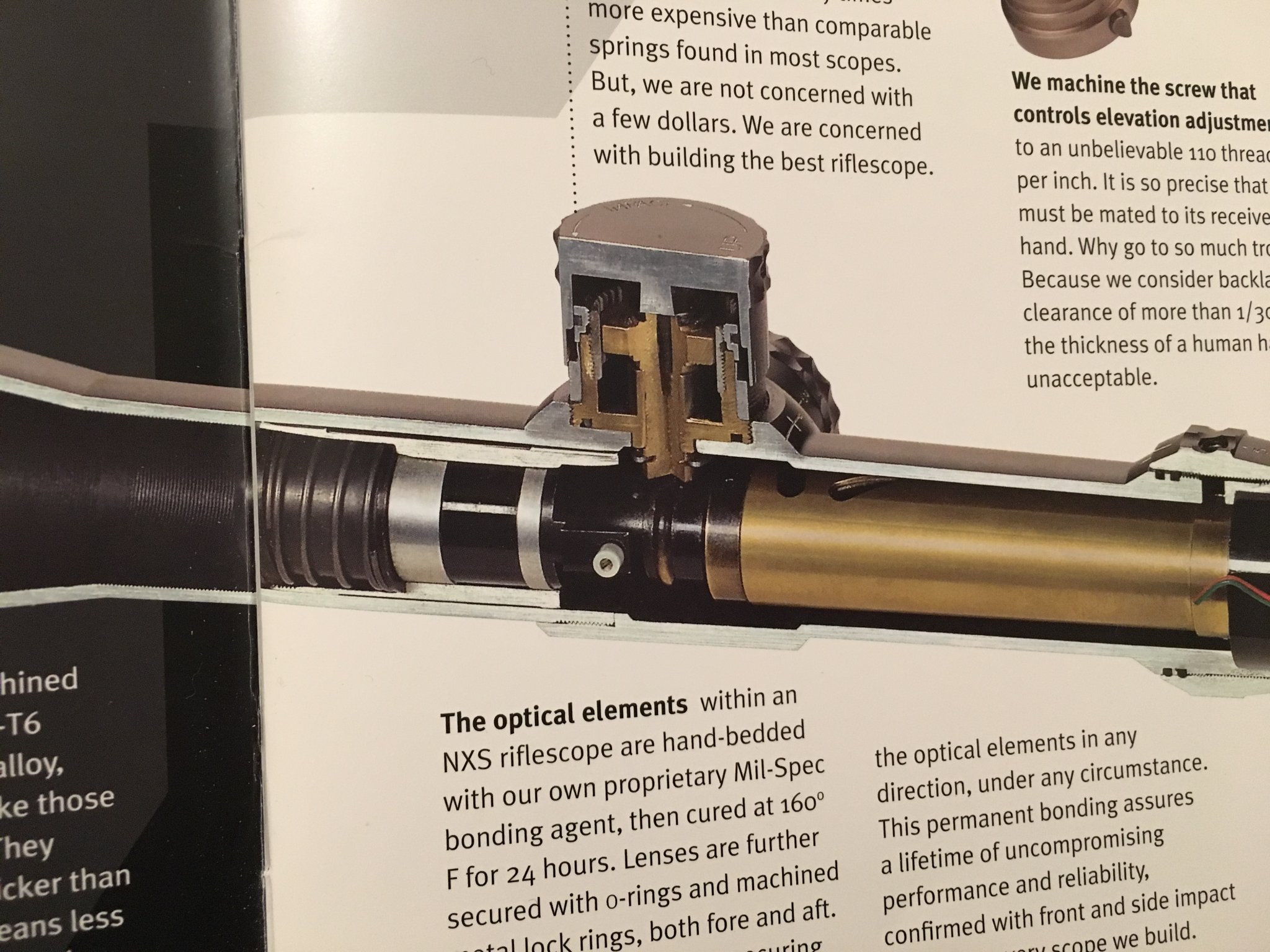

So likely the parallax lens didn’t adjust anymore either? As I think that’s the lens that is just forward of the turrets.
Here is a pic from old nightforce literature, but the idea is the same on many of the brands.
If it's the lens by the turrets, basically under the rings, makes it even more likely you are over torquing the rings.

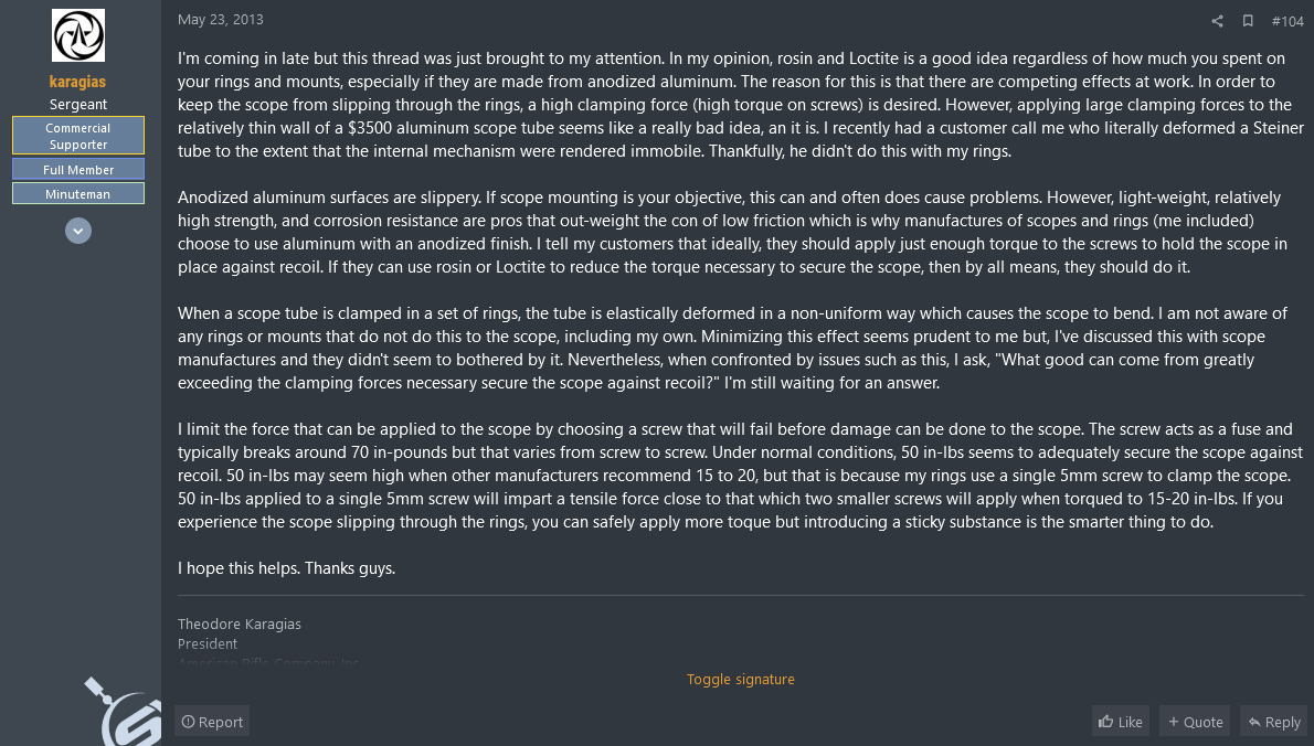

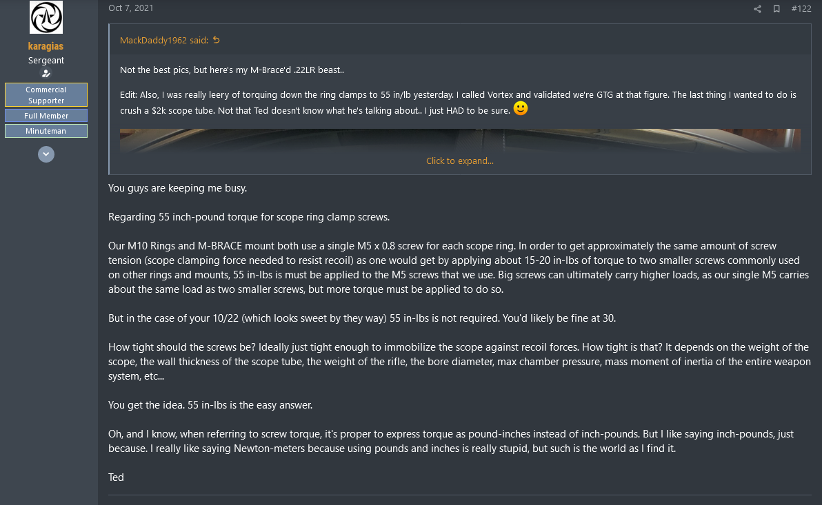

How have you verified that your torque driver is accurate?
I agree. But I’ve checked and even went lighter the second time. I’ve never heard of the lenses cracking but the turrets operating fine and the parallax moving fine. I’ve been using a torque spec higher on other brand scopes with the arc mount with no issues.

What are the extra front mounts used for? Red dots/reflex?
Could the extra mount be causing the problem?
If it's the scope on the far right, has the OP installed one of the extra mounts?

I love my arc rings but for the love of god I wouldn’t torque them to anything above 35 in-lb. As long as your scope doesn’t slip, the minimum amount of torque is the best.
It's been beat to death already, so I won't repeat the obvious, but do you make a habit of ignoring mfg direction or is this a one-off situation?
