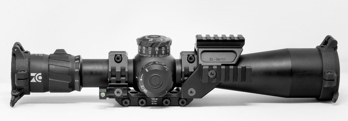

I suspect what is wrong is a misalignment of the lens seat to the lock ring threads. This would cause the lock ring to land on the lens only on one side and stress the glass substantially.
Subsequent replacement lenses would also grenade.
I don't think it's the scope and I don't think it's the torque on the rings. Correct me if I'm wrong, but the rings torque on the main shaft of the scope? The ocular twists and turns via a somewhat flexible seal on the main shaft. I don't see how torque will transfer to the ocular piece. However, if the rings were not true center to center that could be enough movement to transcend the seal and crack the ocular.
Could also be the ocular is touching the rail because the rings are too low.. but going for the above.

It's not rings, It's a mount. The mount weighs 11.8oz. It's a fucking beast. It's probably the most idiot proof mount there is.
Here's a picture.
No one pays any attention to details or reads past a sentence anymore!
