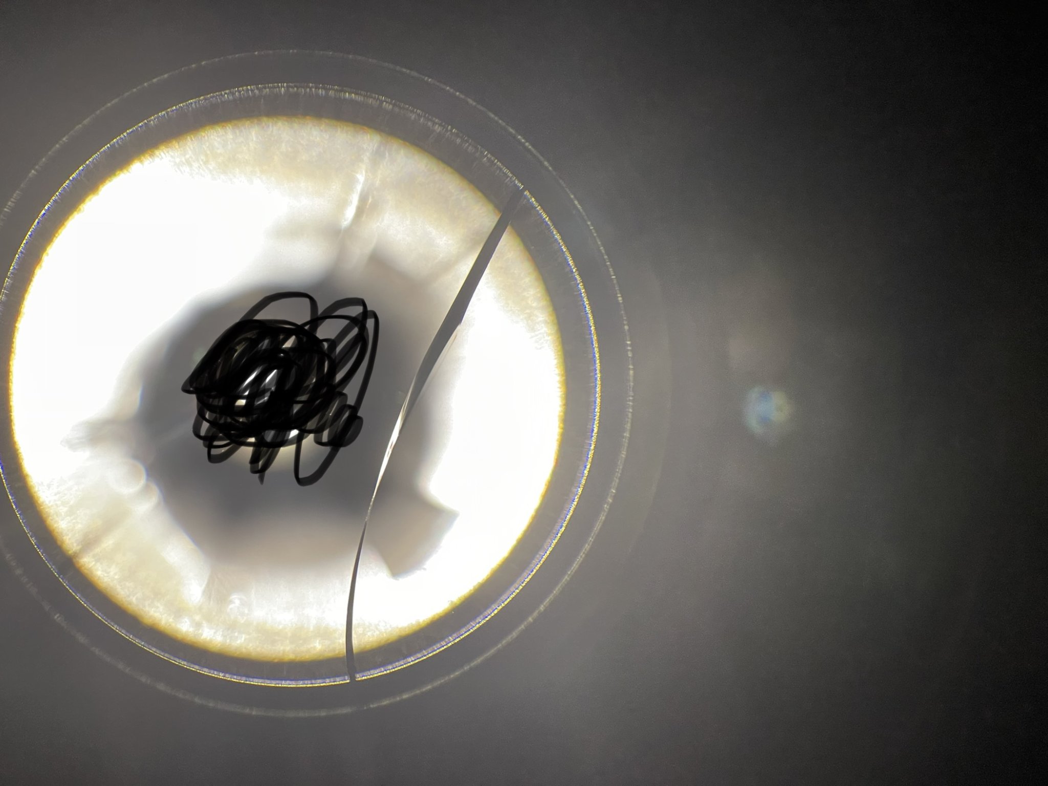

Although, this is a stupid thread. OP should just send his scope with the mount back to the MFG and be done with it. Let them test away. Im sure they want to know what's going on too.
That's crazy, especially happening to two identical scopes.
I'm gonna go with the rings being overtorqued as the culprit. If it were a manufacturer defect, I'm sure we'd have heard about it by now from others. Or you are the most unlucky SOB and happened to get two defective scopes from a top tier manufacturer that failed in the exact same fashion.
Occam's Razor.
Occam's Razor.
They just repaired it the first time. Not replaced. Maybe an out of spec tube. If the rings were putting too much torque then I’d have turret, magnification or parealax adjustment issues. 🤷🏼‍♂️
Reactions: Arc Light
This thread could be half the size had you just posted those pics in the beginning lol
Posting an issue doesn’t make you a dick, had you logged on to bitch without ever giving the company a chance to make it right that wouldn’t be a different story
I love my arc rings but for the love of god I wouldn’t torque them to anything above 35 in-lb. As long as your scope doesn’t slip, the minimum amount of torque is the best.
Ditto: I've shot literally hundreds of FTR matches plus all the testing. Fun shoots, ELR etc. I've never torqued a scope ring 1X. Snug it down. Check it often before you shoot but snug is all you need. Never had a problem.
Reactions: MarshallDodge
I don’t see how crushing the middle of the maintube would have anything to do with the ocular that spins within its own housing.
I was thinking the same thing but as I sat here and thought about it, If the tube was flexed I suppose it could also load one side of the ocular housing and that stress may transfer to the lens. I would think you’d feel it binding though. Very curious what the manufacturer finds if the mount is shipped with it.
Reactions: greybeard0058
That might be except the ocular housing spins aft the magnification ring housing which effectively arrests any distortion of the maintube coming from the ring area.
ARC rings will be just fine with a z comp. i have 2 of them and never had an issue. Here is an old post from them.
I'm not sure where you see that we don't recommend more than 25 inch pounds. The literature and Operator's Manual clearly say to use the ring manufacturer torque specs. I know, I wrote the manual.
