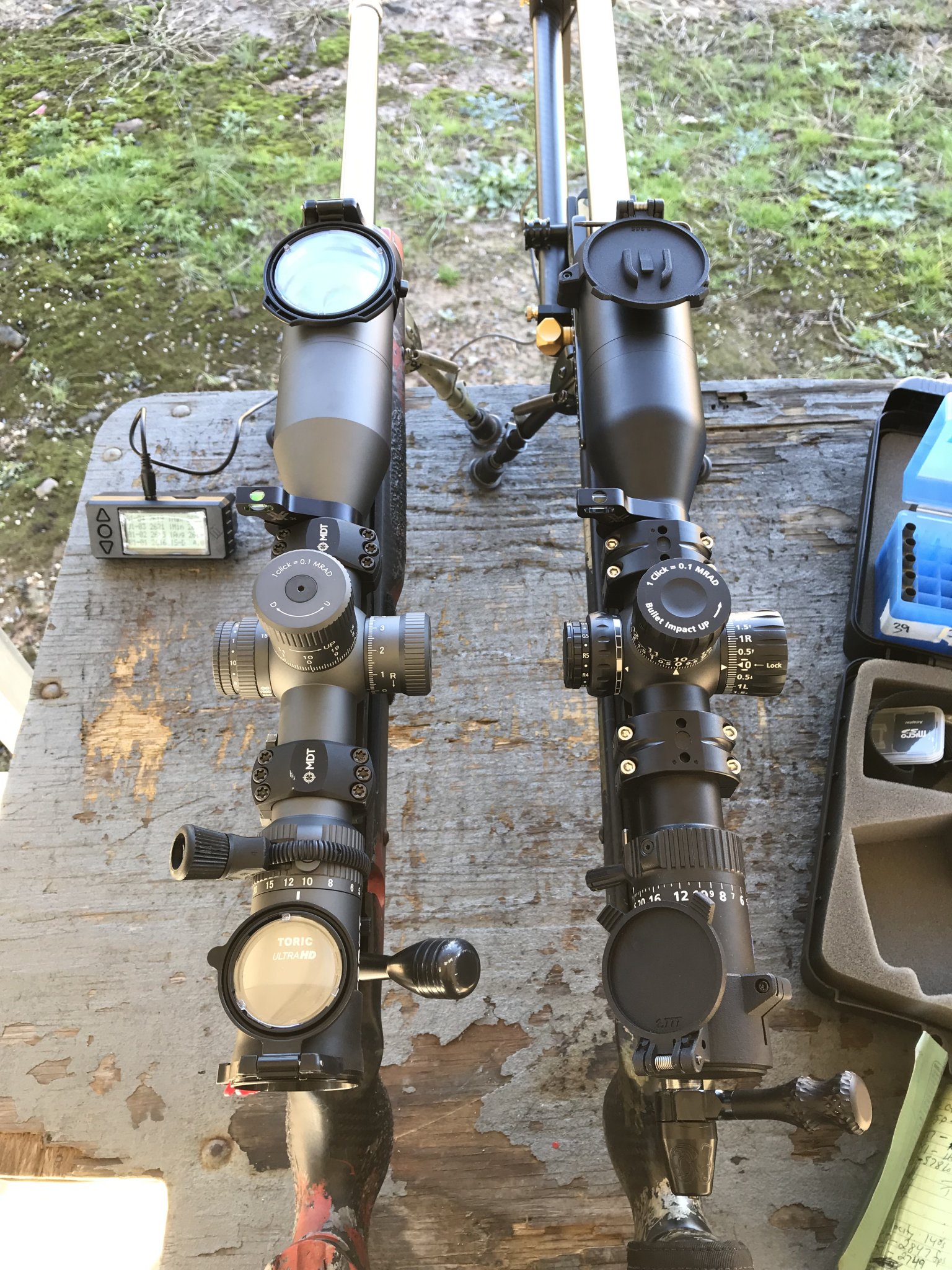

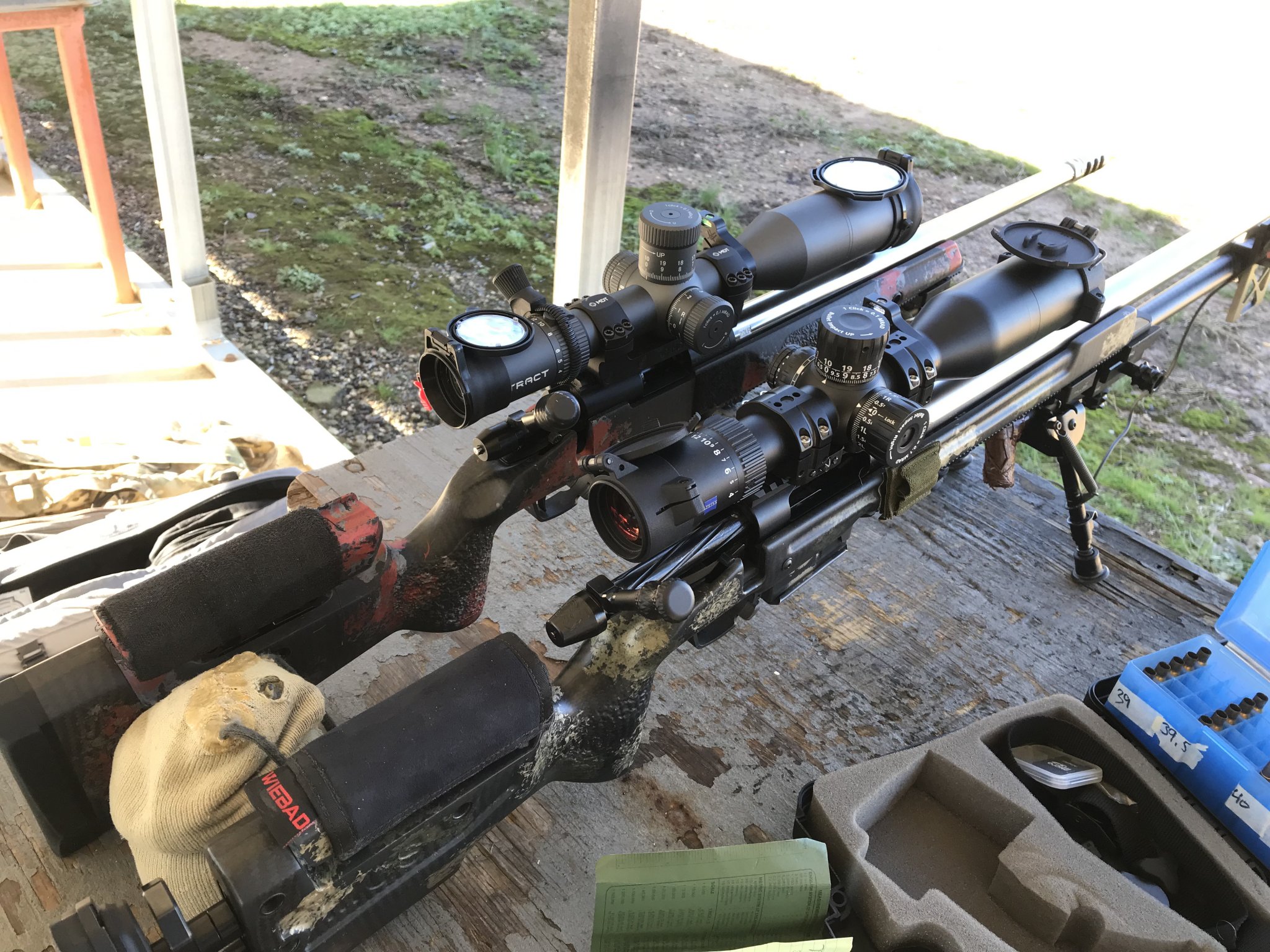

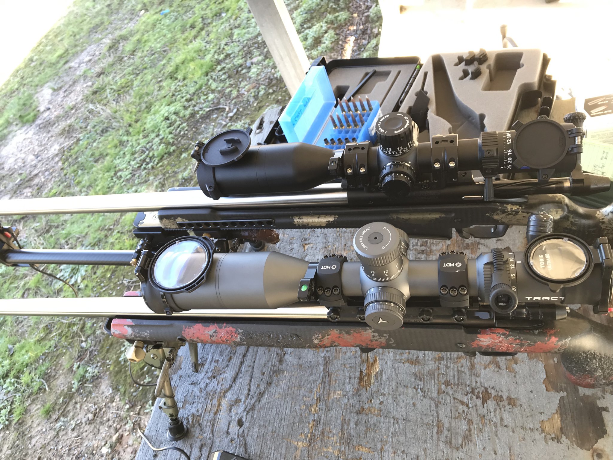

Well made it out to the range finally! I had zeroed the Tract the other day at home on my 30 yard range and no surprises. went out today and Gary @DownhillFromHere was out there with his ZCO so we compared the 5-27 ZCO to the 4-25 S3 and 4-25 Tract. I know not a really fair comparison but not a bad one.
Some comments on the Tract first though as it's new. The glass is very good for a $1500 scope. Clear and bright and the reticle is great like the 4.5-30 reticle I had was. Illumination is daylight bright also so can be used in bright sunshine at matches if needed. Knobs are audible and tactile. After zeroing on the 20 MOA base I had 27.1 mils of elevation so with 47 mils total you can see I still had plenty of ability to add cant to the rifle and get more. The eye box seems easier to get behind than the 4.5-30 was and there is less of the "tunneling" feel, which is actually the outer body of the scope, and not a real tunneling like the S&Bs. All in all this is an excellent scope in it's price range and I am glad I got it.
Now to a little comparison with all on 25x. Glass. Well as you guessed the ZCO had the best glass. It was just a little brighter but clarity was just a little better than the S3 which was just a little better than the Tract. We were looking at 400 yard steel and a small ribbon that was tied to a bar out there and they all could give good definition of the steel hits and bolts and the ribbon.
FOV was all really close. The ZCO was at about 8.4 mils, the Tract at 8 mils and the S3 at about 7.8. So basically a push as all have a good FOV at max power. When you dial down to around 15x they also all have goo FOVs for taking shots at multiple targets on a stage. The reticle is still usable on all of them for holds also.

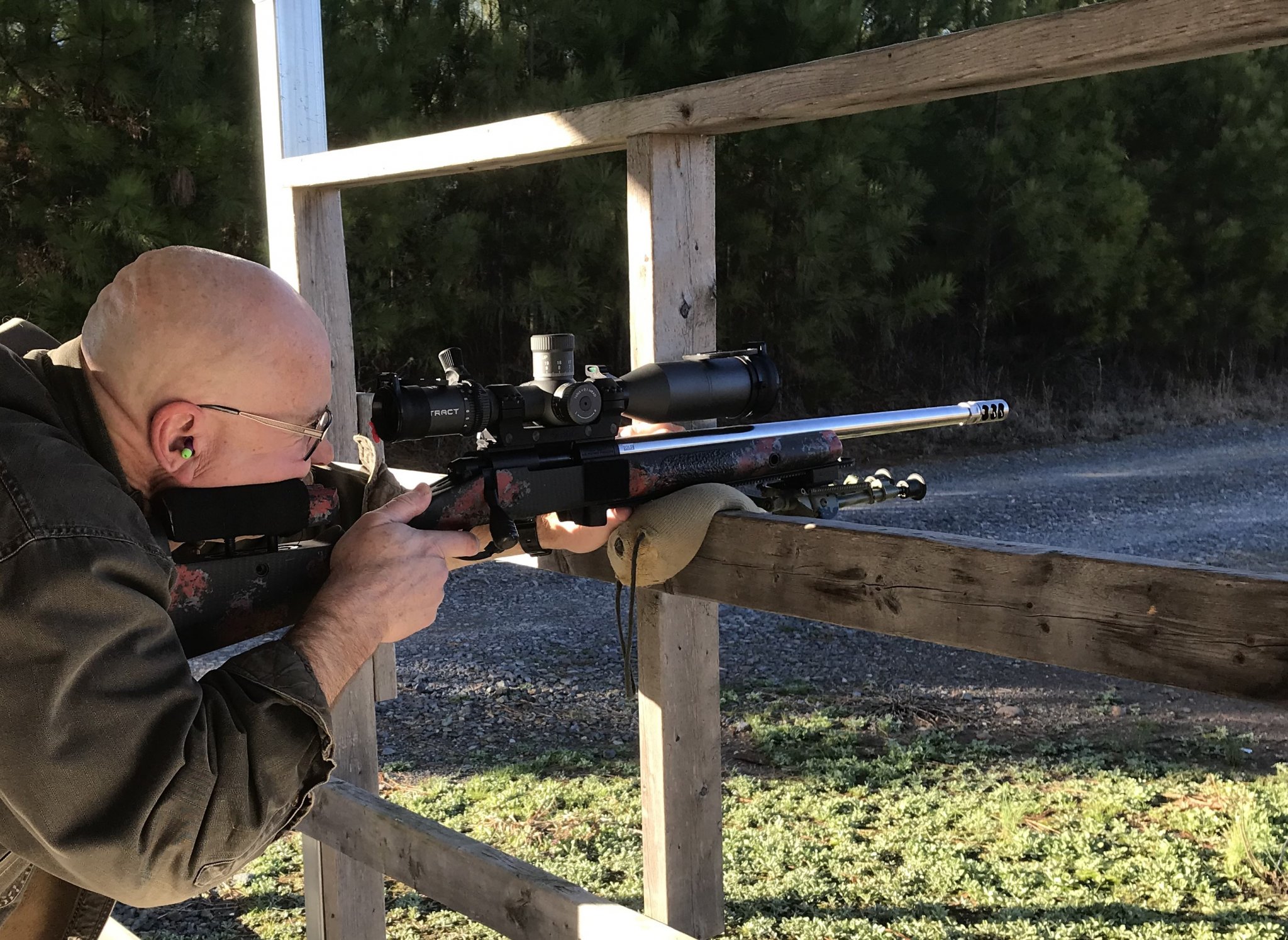

One thing Gary noticed was that he felt he had to get a little closer to the scope than with the other two and I used my pen(all I had on hand) to measure from the side the distance from his pupil to the back of the scope. With the Tract he was about 1/4" closer than the S3 and about 1/2" close than the ZCO. There was a good distance with all so you weren't right up on the scope so recoil would hit your eye but just a hair closer. I just threw the rifle on a prop to get a feel of it in the pic below so you can see that I didn't need to be right up on the scope and plenty of room between you and the scope.
Here's a few pics of the Tract on my rifle and some shots of it next to the Zeiss S3. I am sure I missed something so ask away if there is a question.
