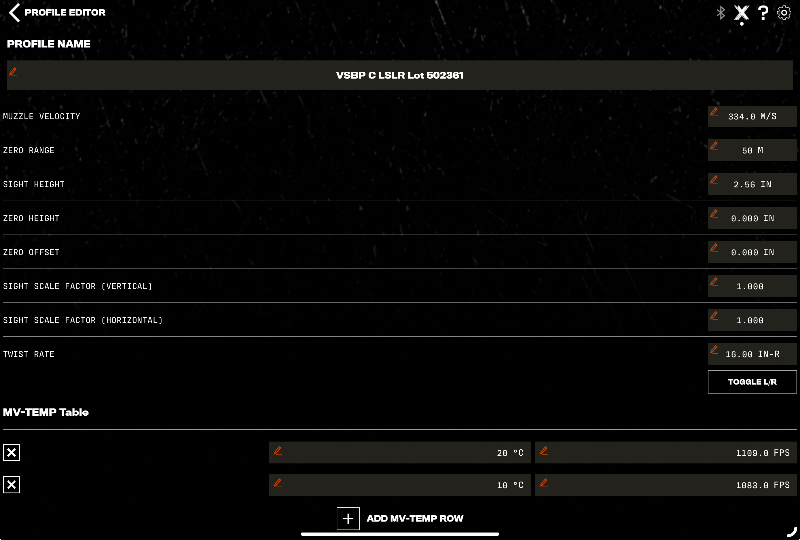

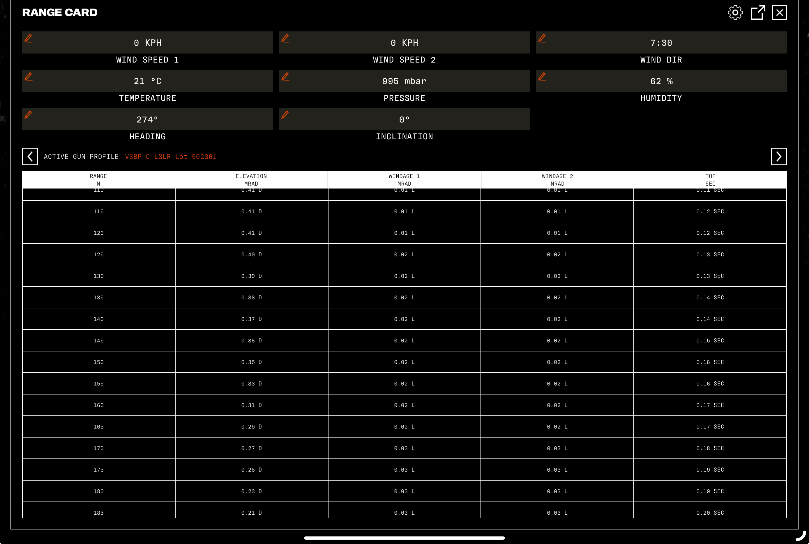

The possibility to generate the range card works only with only the primary muzzle velocity, if you add different data, for example different temperature and related different muzzle velocity the app doesn’t transfer it to the Vector and the range card is completely wrong.
Also if the muzzle velocity is in m/s the possibility to insert data related to different temperatures is only in fps.
Have you experienced same issue ?
