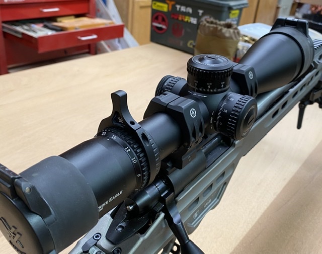

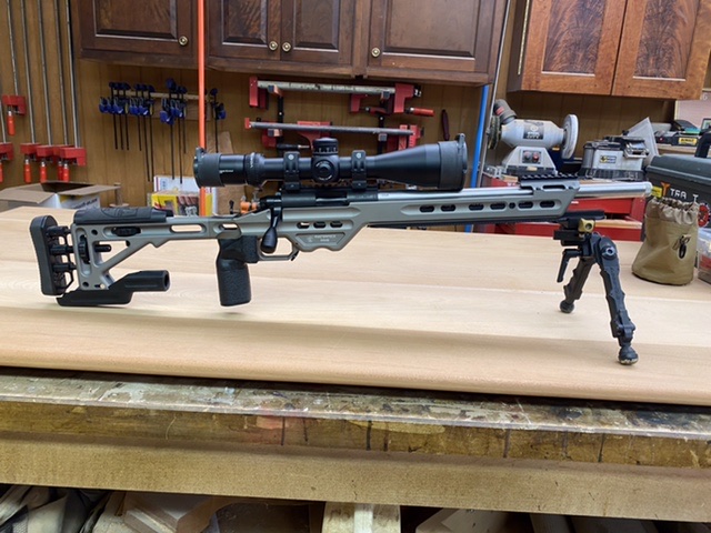

I got my scope early this morning and immediately mounted it on my Vudoo and headed to the range. My first impressions of the scope were very good. I was pretty impressed by everything I saw. I was pretty surprised by the locking turrets as well. I didn’t realize the scope had locking turrets.
Well to the meat of the matter. I got to the range and set down with the Strike Eagle, a 6-24 Midas Tac and 5-25 Gen 2 Viper PST. The glass on the Strike Eagle and Midas Tac are darn close. The PST may be a little better but it’s marginal. Between the SE and TAC it is really tough to say because the FOV is so much better on the SE. Personally I think people place way too much emphases on glass quality. All the scopes demonstrate some level of CA at higher magnifications which is to be expected at this price point. If you think you will be getting Razor glass at this price you will be disappointed. That said, for the price the the glass it great and you will not be missing any shots due the the glass.
The eye box and FOV on the SE is fantastic. I would say the Strike Eagle is hands down the best of the three in this regard.

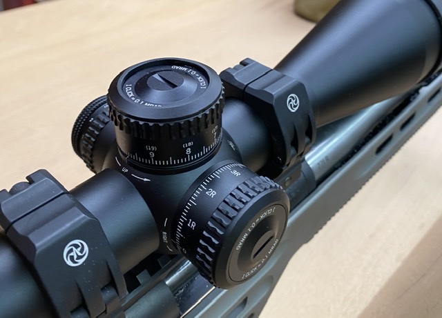

The turrets. All I can say is wow. I was very surprised at how nice they were. I would say they are comparable to the Razor turrets. The Midas TAC turrets are really nice with auditable clicks. The Viper turrets in my opinion are okay. The SE turrets take just the right amount of force to turn and have very distinct clicks. With my Tango 6 I sometimes have issues with knowing where I am because I don’t feel the distinct click into the next position. With the SE that is not an issue. The turrets also lock which is a game changer for me. I have had one two many windage turrets move on me. If a scope doesn’t at a minimum have a capped windage turret I wouldn’t even consider using it on a competition rifle.
The magnification and parallax are nice and smooth. Much better than the PST I have. The magnification ring on it is very difficult to turn. The addition of the nice aluminum throw leaver is a really nice bonus. The illumination is a little tough to turn as well but not a big deal for me. I just don’t really use illumination. Illumination is daylight bright if that matters to you. The diopter is a little too easy to turn. It was spinning just trying to put my lens cap on and I had to re set it several times. If you aren’t going to be covering like I did that could potentially be a problem.
I didn’t do a formal tracking test. I did run the scope from 50 yards out to 200 yards and back more times than I could count and it returned to zero every time. I don’t use a zero stop on my scopes so I can’t really say how that works. I have MOA built into my rail so I only have about 5 mils below zero so I had right around 25-26 mils of useable elevation which is fantastic for a rimfire.
That’s about all I can say. For once I was really surprised by a Vortex Optic. This scope is what the gen 2 Viper PST should have been. With this release I can see a gen 3 PST on the horizon that will,have a lot of the upgrades this scope has.View attachment 7301485View attachment 7301486View attachment 7301723View attachment 7301724View attachment 7301725

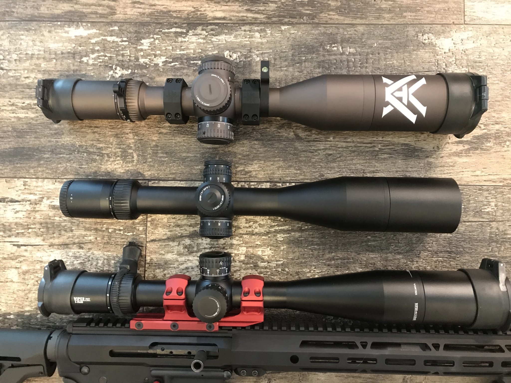

Here's my 2 cents hillbilly review. Just got my Strike Eagle 5-25 today along with Arken Halo medium Rings(1.26).(not In the same package:) Installed on the old faithful Savage Mark II on an EGW rail...not sure if this is factory rail. Got at least 3/8 clearance.
First impressions are excellent for me too. Including 60 dollars worth of accessories with a scope in this price range impressed me greatly!
Turrets. This is my first Vortex 'tactical' scope so I can't compare between other Vortex scopes. But I've had several Athlons recently and these turrets fall right between the Ares BTR gen 1 and the Ares ETR regarding click feel and resistance. Not too loud and crunchy...not too slight. Right in between where I like it. I have not owned a scope with locking turrets yet..so they will take some getting used to. I think the turrets have enough resistance that accidentally turning them would be almost impossible.
Tracking. From the sorta crude testing I did it tracked perfectly. I had a strip of paper at 50 yards with mil graduations on it and the scope in a 15lb base. Every click from top to bottom and left to right moved the reticle like it should've. The reticle lined up perfectly with the mils graduations on my chart. My chart and homemade scopebase were not capable of measuring tracking to the finest degree, so I'll leave that to the pros.
Optical quality seems very good for the price point...easily on par with the area BTR gen 1...maybe a bit better. CA is definitely present, but also expected. I will never be able to blame this scope for poor shooting!
Overall...I think Vortex did an incredible job specing out this scope with all the features at this price point. I had my heart set on a Midas Tac but when this was announced, especially with a mil/leo/fire discount...it was a no brainer for me. I saved several hundred dollars and got every feature I wanted. This will be the perfect precision 22lr scope. I think Vortex will sell a metric shit ton of these scopes. Looking forward to spending some quality time behind it.

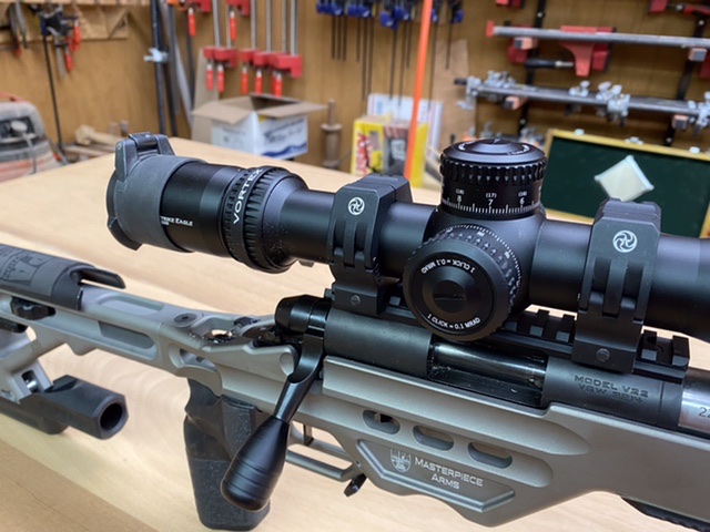

Small update here.
I mounted it in the Arken Halo rings...tightened everything down. Left the scope at 'optical zero' like it came.
Fired two shots at a target 50 yards away. Exactly 3.5 mils low two holes appeared. Dialed up. Did not touch the windage knob.
I confirmed zero with several groups, installed zero stop and reset the turret. Done. 12.7 mils of elevation left.
It was so easy and painless. I did not miss tiny allen screws in soft brass one bit. Bravo Vortex.

Well I made it to the range today and even though I don;t have the Strike Eagle mounted up yet I was able to do some good comparisons with the 5-25 PST Gen II. I looked at targets from 100 to 550 yards, which is as far as the range went.
The Strike Eagle did very well. @DownhillFromHere ,aka Gary, was out there too and looked through the Strike Eagle and he himself is a PST Gen II 5-25 owner and had his as well as mine out there to compare. We both agreed the PST just edged out the Strike Eagle for glass clarity but it was close. The clarity to the edge of glass was actually pretty good also. Again slightly better in the PST but not by much.
Feild of View is one place the Strike Eagle seemed to slightly be better. At 25x with both scope you get the following in the reticle for hold over.
Strike Eagle: full 7 mils viewable on reticle. You can see down to 8.5 mils and on the 8 mil line you had 3 mils of wind visible to use.
PST Gen II: Full 6 mils of viewable. You can see down to 8 mils and on the 7 mil line you had 4 mils of wind visible to use.
I had my PST on an AR in a 0 MOA base and zeroed I had 10 mils of elevation. Gary had his on a 20 MOA base and had about 16 mils of elevation. With that even with the zero stop set up and you getting 18 mils of elevation you still get more than the PSTs. Just something for people to contemplate.
Again I can not wait for the rings to show up and I can get it mounted up on my Vudoo with the 40 MOA base. I will post back elevation info with both the zero stop and without.
I have mine on a 40 moa rail on my Vudoo. I don’t use a zero stop and have 6 mils below my zero and 27 mils of useable elevation on mine for a total of 33 mils. I was pretty surprised I had that much elevation available.
Yeah I am expecting somewhere in that range. With my 3-18 Razor II on the 40 MOA base I get about 25 mils. With knowing you have 6 under a zero stop really isn't needed.
