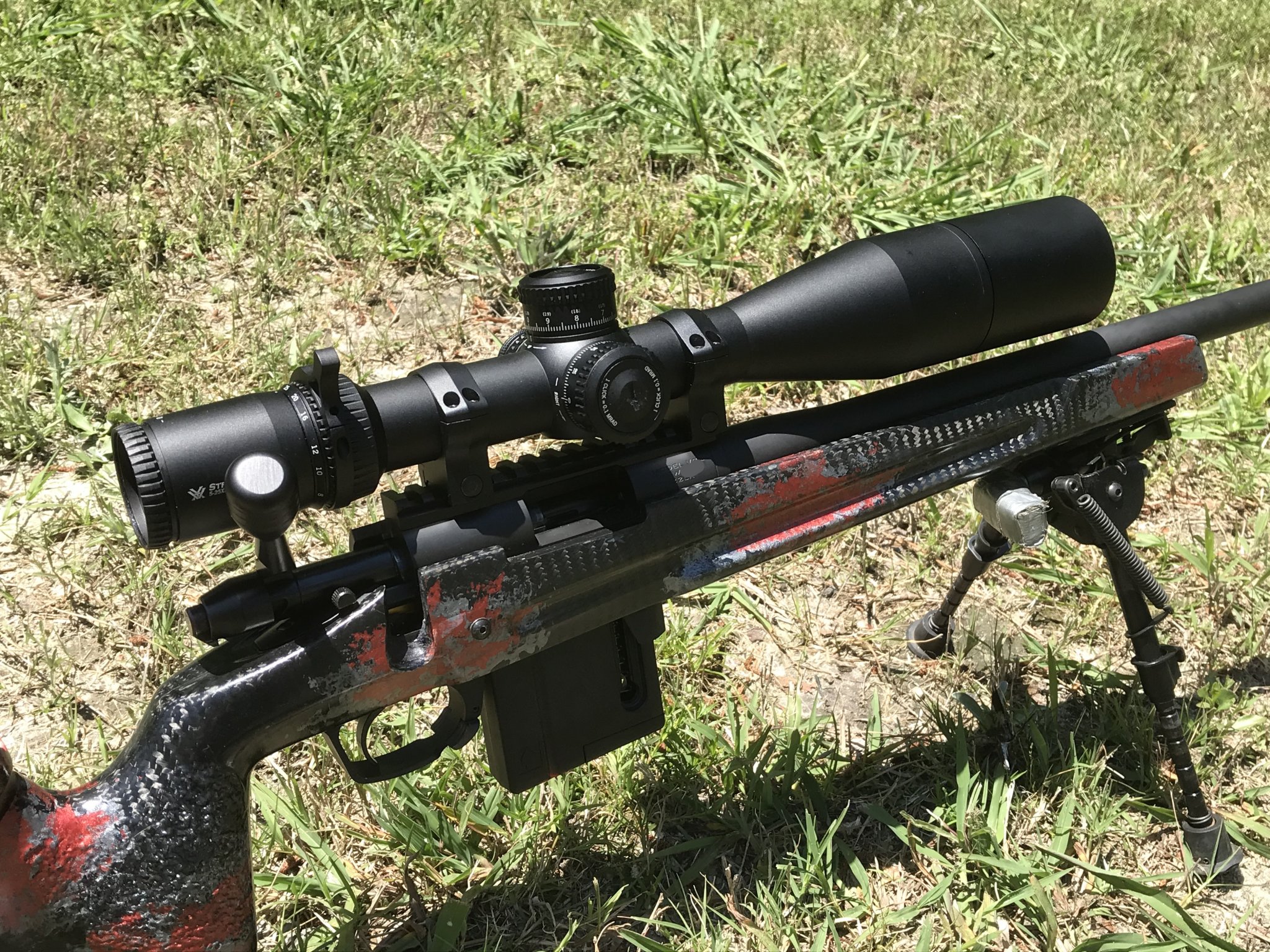

Well finally got my rings in and got my Strike Eagle mounted up on my Vudoo. The Vudoo has a 40 MOA base so after zeroing I had 24 mils up and 8.6 mils down from my zero. I didn't use the zero stop as having under a full revolution below my zero I wasn't worried about it at this point. I will say after zeroing, dialing up and down and then back to zero I took another shot and it was right on my zero. No shift which is good. I am looking forward to testing out the Strike Eagle. Seems to be a very good optic for the money. Next is a tracking test.
I guess what I meant to say was a tracking test on paper past 5 mil.

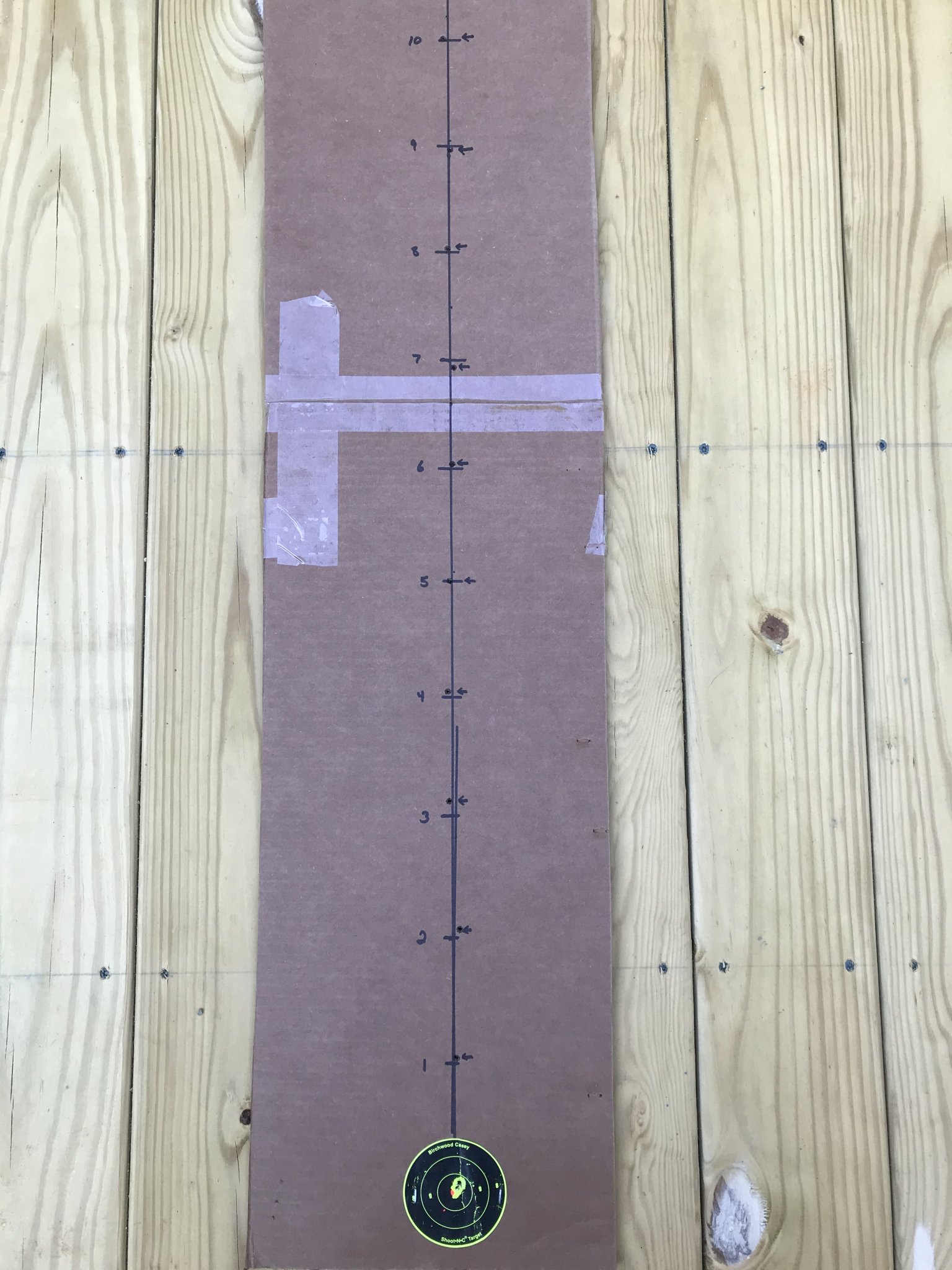

How about out to 20 mils? I took my usual 100 yard tracking target and put it at my 50 yard range at home. Laid the reticle against it and it was right on. Then I shot the target. Being at 50 yards each space is 2 mils so the 10 mil mark is 20 mils. I dialed up to 20 mils at 2 mils each. I think it did pretty good. As you can see from the bottom before and after the zero was a little high to begin with but after dialing back to it it was right there for return to zero.

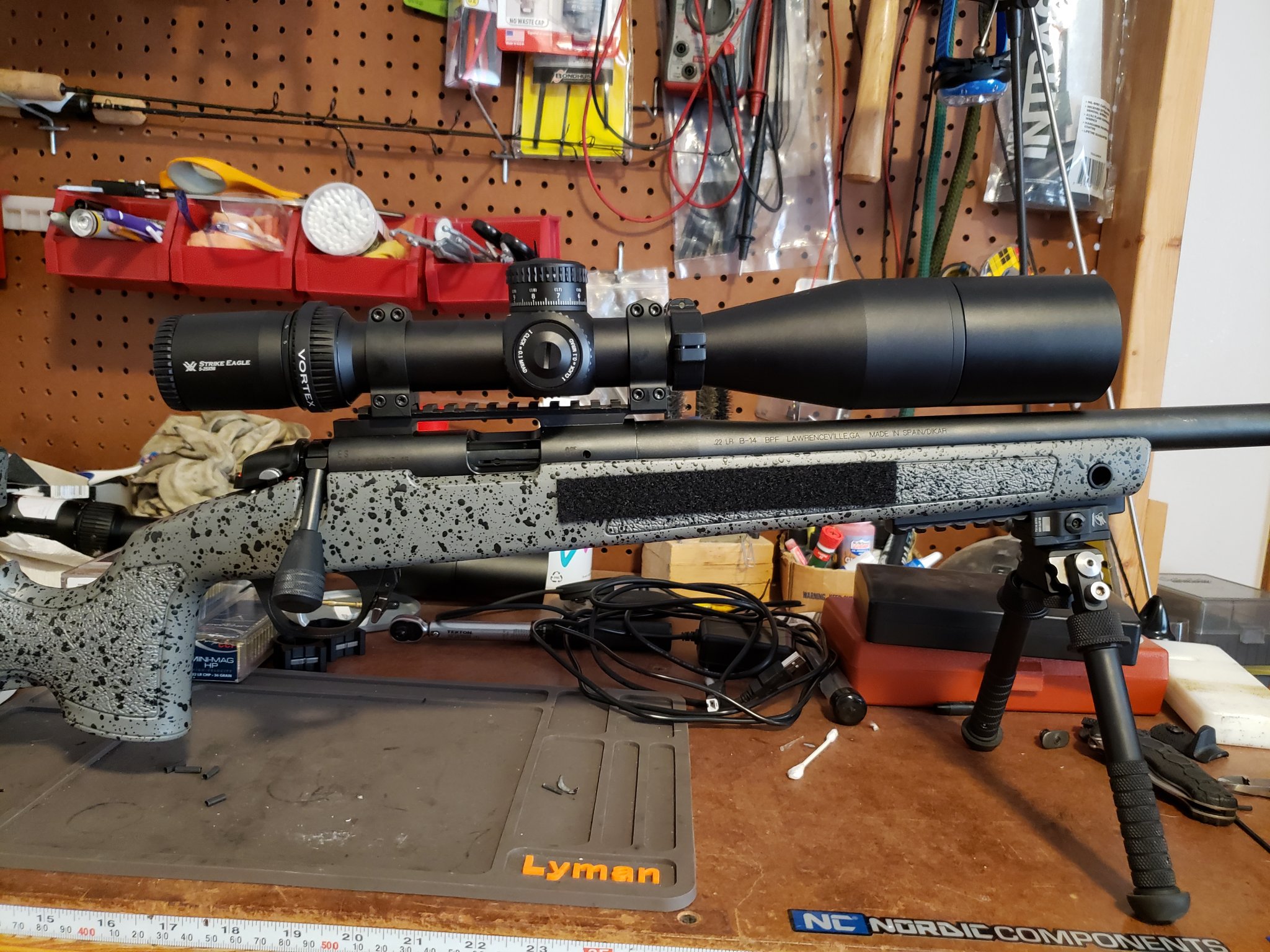

Finally got mine, and in case anyone is thinking of putting one on a Ruger American Predator for a budget build, I put Vortex PMR 1.1” rings on and have probably a quarter inch or so of clearance to the barrel with scope caps on (standard 0moa rail also).
Reactions: Rob01
Sounds about right with caps and 1" height there is about .1" of space between scope cap and barrel. Some a little more or less depending on contour.
