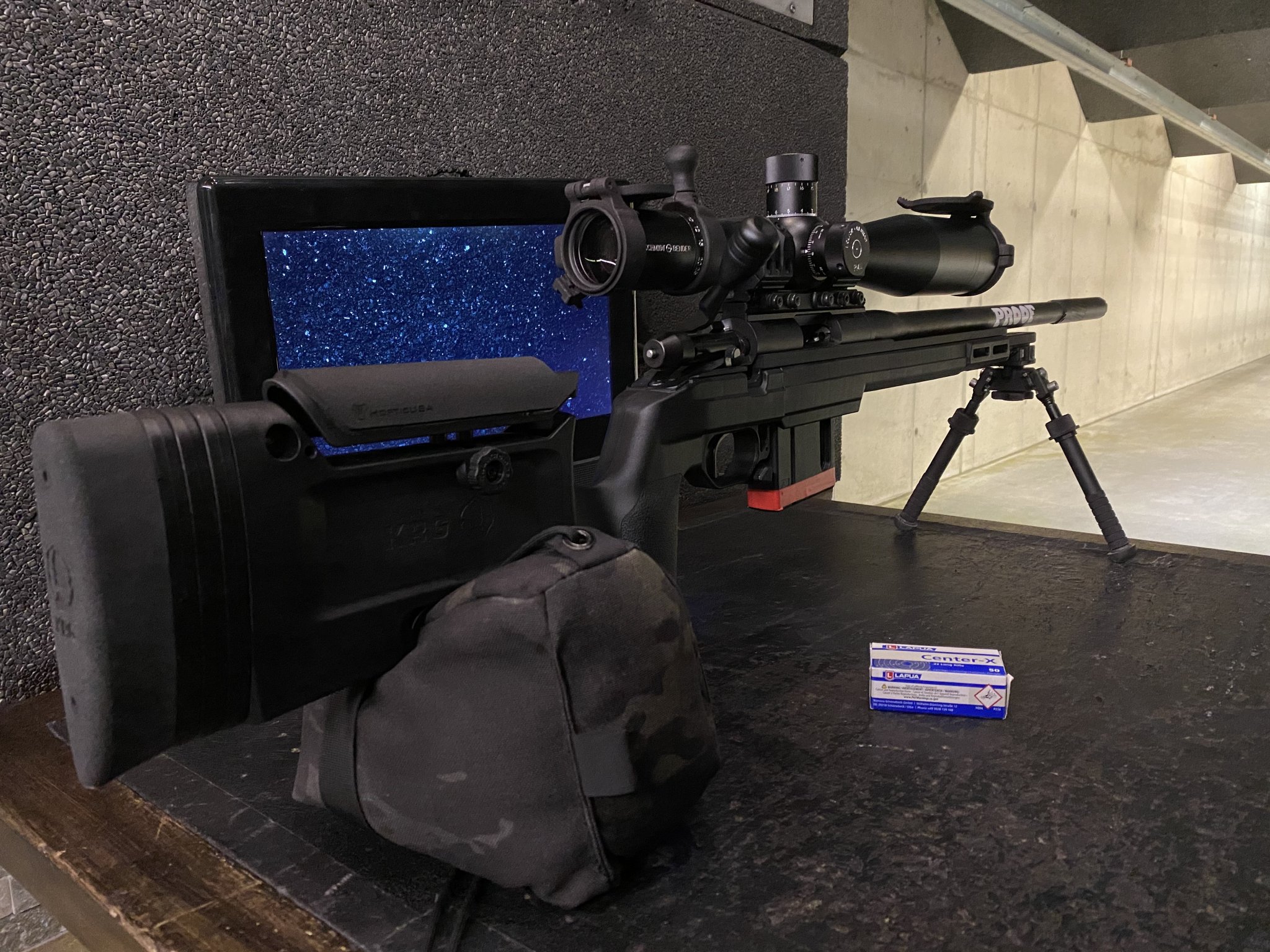

Rifle is ready, I just need to find some time to get to the range.
