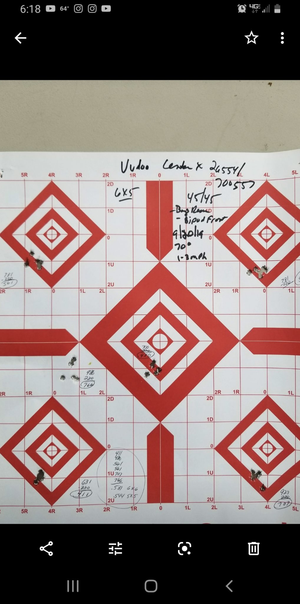

Anyone else not getting that great of groups using center x with their vudoo? I guess that’s not entirely accurate the 50 yard groups are great but they are with almost any ammo it’s the 100 yard and farther that open up. Don’t get me wrong it’s not bad with cx average about an inch to 1 1/2” at 100. I just get far better performance with Eley Match and rws r50 with mine and I’m totally fine with that I know every barrel likes what it likes I was just curious if anyone else had similar ammo results ?
I had to test about a dozen lots of Center-X before finding a really good lot, and due to it taking me several weeks between the time I received the samples and the time I was able to shoot them, everyone else in the country had already figured out that it was a good lot, and I couldn't find any more of it. That was 3yrs or more ago, and since then, I'd sent a V22 bbl'd action to the Lapua Test Center, where Daniel was able to find a lot that shot plenty good enough to satisfy me. I ordered two cases of it while he & I were talking the test results over, it arrived less than a week later, and I'm very pleased with it.
I have shot a couple of lots of Eley Match EPS that will out-shoot the Center-X I have at 200+yds, but I haven't had the best results in getting it to feed 100% of the time, and since the difference in accuracy isn't great, and it's $4/box more than the Lapua, I'm good with my Center-X.

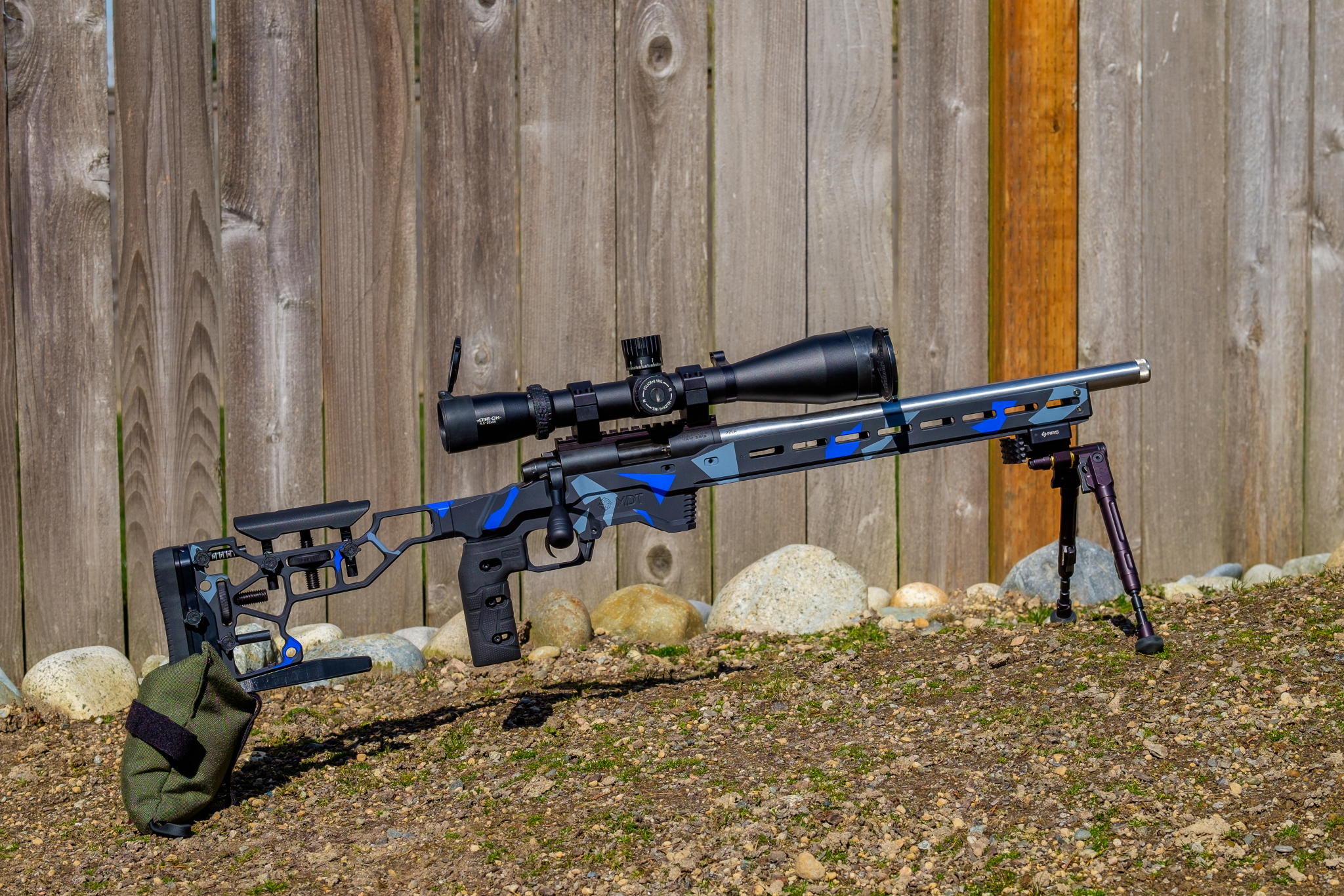

Well it's here, and it's put together.
Vudoo V22 Kukri 18" Ace Barrel
Huber Staged-Break 2-stage 1.6lb
Athlon Ares ETR 4.5-30x56
Seekins 1" Rings
MDT ACC - Cut down 3.5inches
3 Internal MDT Acc Weights (Adds 1.56 lbs to front)​
Aluminum Butt Plate (lessens back .5 lbs)​
3D printed bag rider (lessens back .2 lbs)​
TBAC Bipod
With the bipod on, it balances right in front of the mag well. So basically I would want another 1lb or so of weight up front, maybe 2 external weight sets, or have switched to a MTU barrel profile instead of Kukri.
I should've done my action graphite black like the chassis. Not sure what color I would want to cerakote the barrel.
I've just been dry firing the Huber 700, and even though it's .6lbs heavier than my 2-stage Timney on the Tikka, it breaks when I want it to... there's all this talk from Huber which goes over my head, but it feels better than the Timney. We'll see during comps.

I agree with you on the Huber physics. :geek:
If it balances, why another 1 lb up front? Is there a front heavy preference I'm not aware of?
I pretty much agree with everything you said I have 3 more lot’s of cx to try definitely haven’t given up it. The Eley feeds pretty good in mine but again you’re correct on price. I really should send my rifle of to the Lapua test facility but I just have so much fun shooting it I’m not ready to give it up for that time yet.
