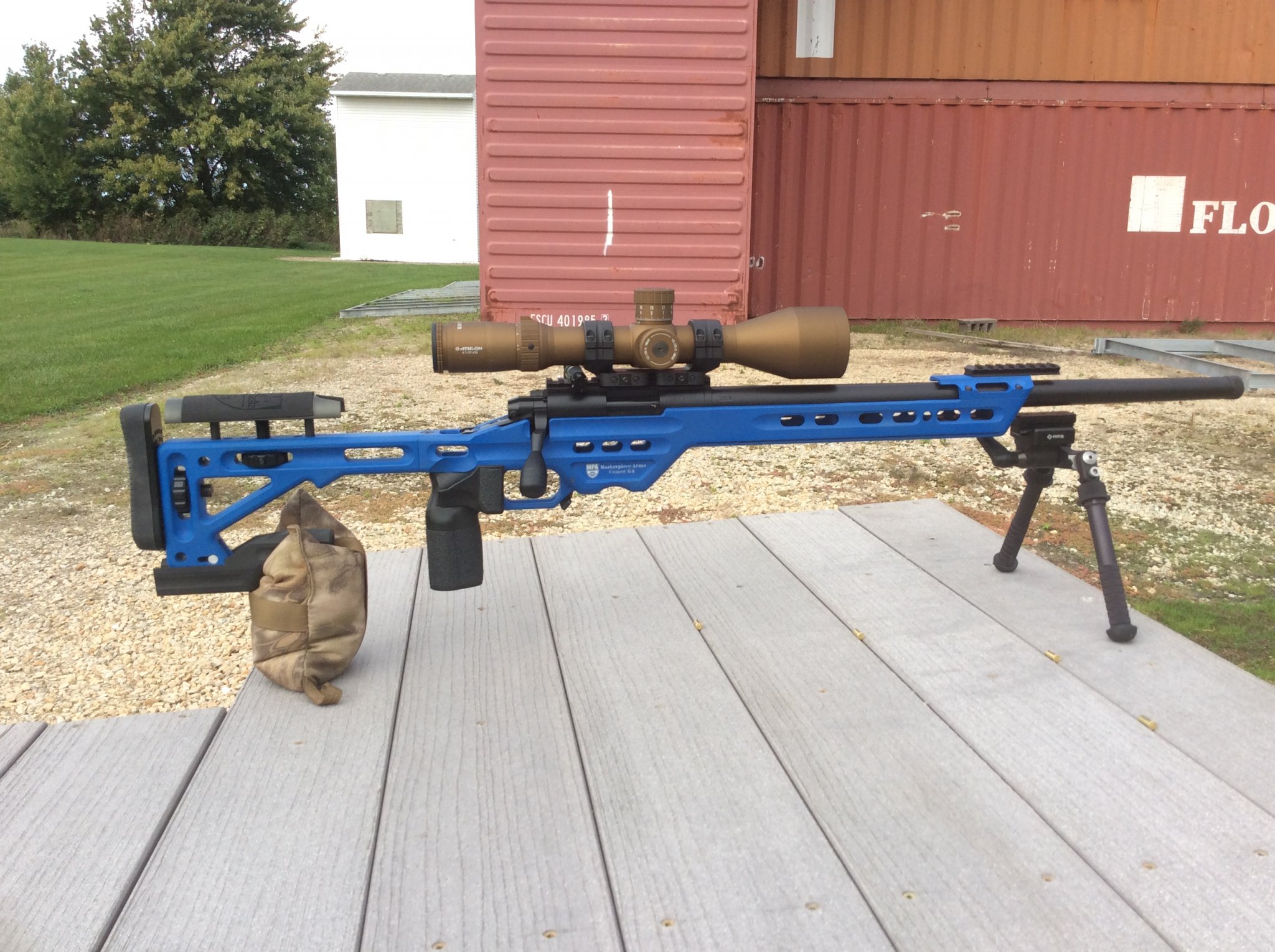

I have a question about rifle weight and balance, less scope. What does an 18" Kukri taper barreled action weigh in an MPA BA chassis? How does it balance? Thanks in advance.
It's not going to balance well. You'll need a full front weight kit. You say less scope, but I mean you're going to be running a scope on the rifle :) I haven't tested it w/o a scope, but I know running a Vortex PST II, Razor AMG, ZCO, it's really back heavy and you'll need a lot of weights up front.
I've got a 22" (actual just over 21") spiral fluted kukri in a mpa ba with the mpa front weight kit.
Still not enough to balance it - need another ~2lbs out front to get balance point ahead of mag well.
Right now the best balance I can find is a KRG X-Ray/Bravo/Whiskey with weight kit, can get the arca alu foreend too which adds more up front weight too.
I also advise most people to buy a 20" MTU to not have to pay extra $$ for weights.
Ive got a carbon bergara in a xray with arca alum forend and still needed the Tweight to get it to balance at the front of the magwell. Even with that still is a touch rear heavy on most barricades.
I'm partial to the Bravo. I've worked hard and spent a lot of $$$ to get it to balance with an 18" Kukri. Either a 18"+ MTU or a 20"+ Kukri to be safe with the Bravo. BTW, the polymer tool-lees buttpad height mechanism weighs less than two polymer spacers. I've added every weight and add on to the fore end, mine's aluminum, that I've probably got AI chassis money into it. ;) I've added the NV bridge just for the weight. With the bipod and suppressor, it balances really well. It will even balance fairly well w/o the suppressor and bipod only. Without those it tends to be just slightly butt heavy. Throw the Railchanger-X with a schmedium Game Changer on and it's golden.🤠
The Aluminum Arca Foreend adds like 1.5 lbs to the front. Might be worth getting one of those :)
I was about to build a new X-Ray + Aluminum Arca Foreend + Weight up front.

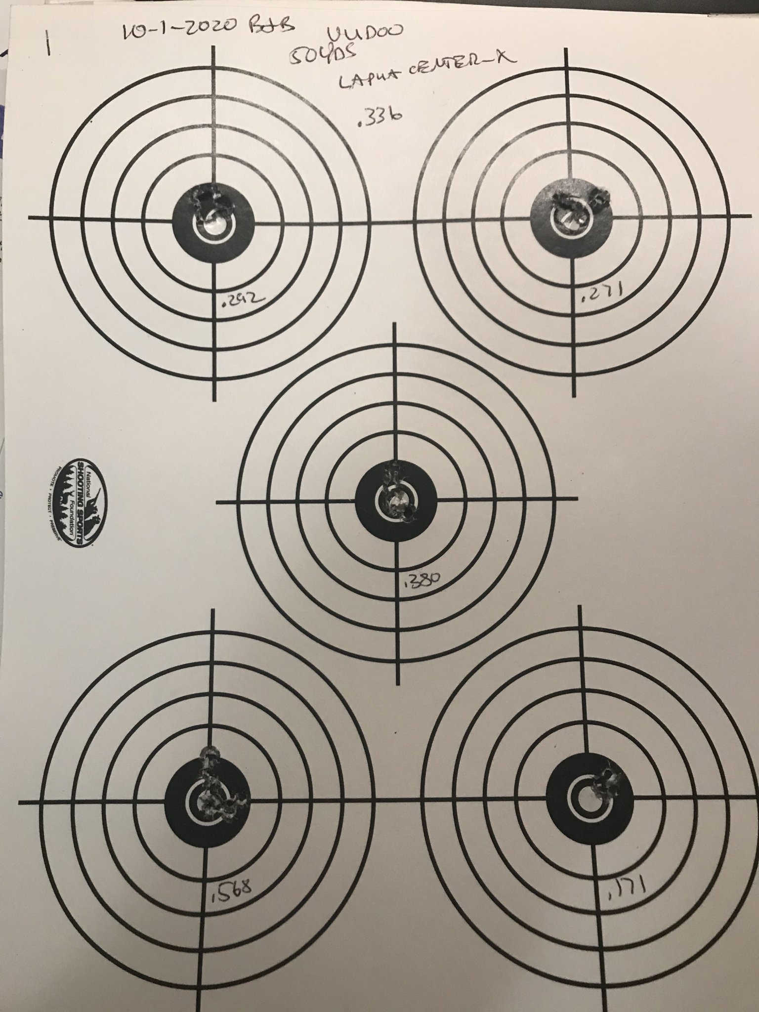

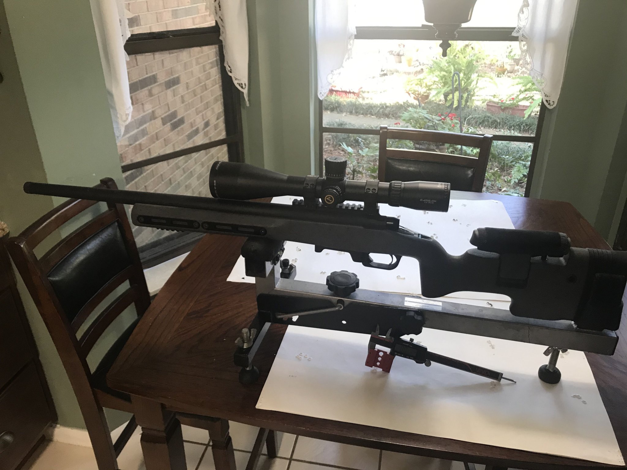

Second day at the range with my new Vudoo. First day was sight in and learn the gun and trigger. About 250 rounds.
My rifle Specifications:
22" Ace barrel in MTU Graphite black
Grayboe Ridgeback stock gray with black spider webbing
Trigger Tech two stage trigger set at 8oz-1lb
20 MOA scope rail
Large Bolt Knob
Athlon Ares ETR 4.5-30X56 scope. 50 yard zero.
Ammo Test:
All shot at 50 yards off a rest. 5 shot groups 5 targets 25 rounds. Another 170 rounds today. Up to 410 now.
Lapua Center-x .336 C-C
SK Standard Plus .339
SK Pistol Match .340
SK Rifle Match .352
SK Long Range .401
Good start. Going Monday to work at 100 yards and 200 yards and get a good Dope. Trying to get a thousand rounds through it as I have a date for the Lapua Test range in Arizona the second week of November.
In the rifle picture under the rest is the tool I use to measure groups and get center to center measurements quickly and can be found here. https://www.sinclairintl.com/shooti...p-measuring-caliper-attachment-prod38778.aspx

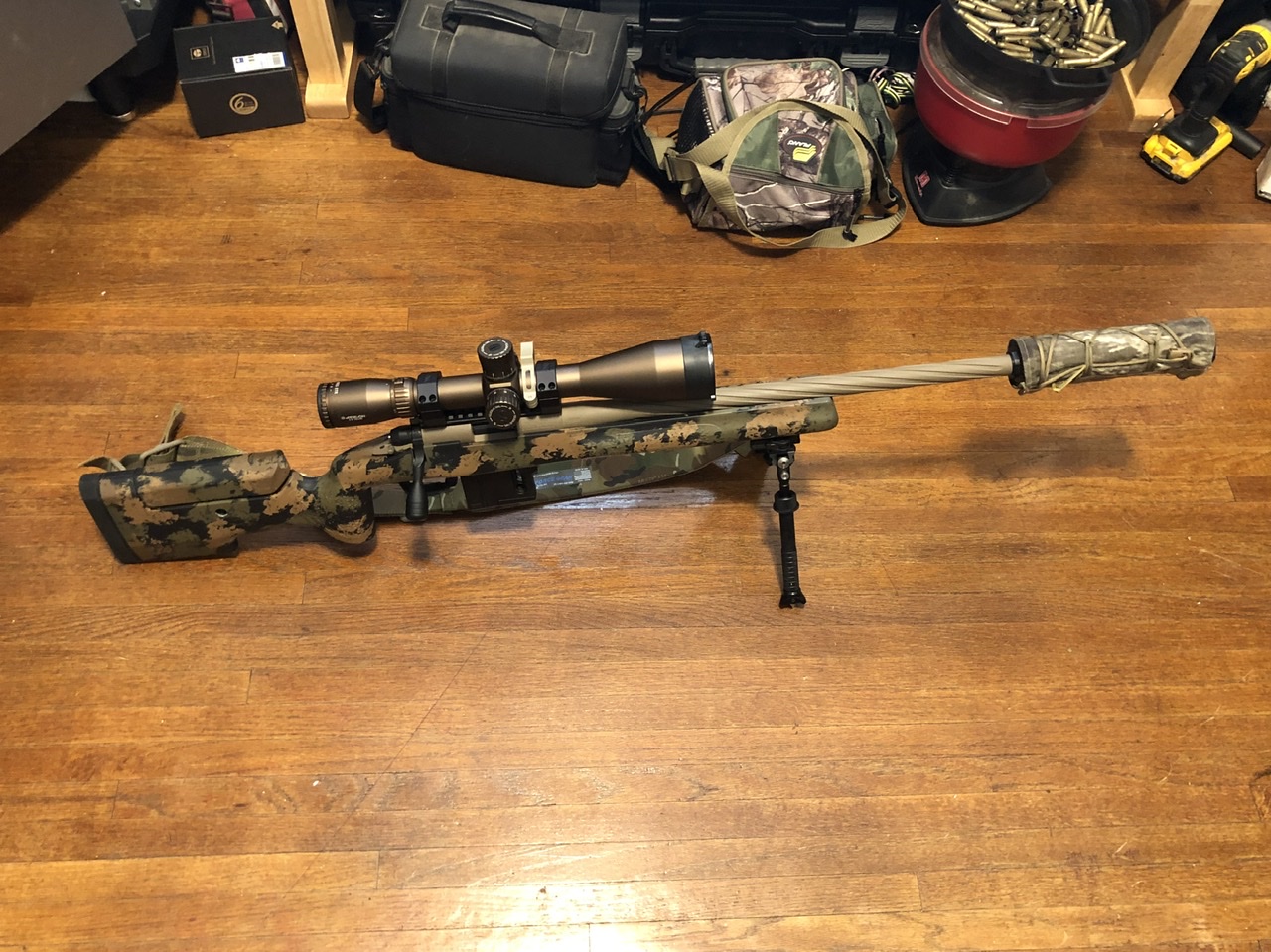

I was able to take possession of my Vudoo on Friday. Only got to run one box of SK rifle match through it but it started to look more promising as I neared the end of the box.
My specs:
-Vudoo right handed repeater
-20” Kukri profile fluted Bartlein barrel, I thought I was getting an Ace barrel but I don’t see a reason to complain yet.
-40moa rail holding an Athlon Ares ETR in Seekins rings
-Geissele super 700 two stage trigger
-FDE cerakote
-Currently sitting in my Manners T4a mini chassis until my T6a shows up for this rifle.
-Form 1 suppressor, also have a sparrow but wanted a “to scale” version for my Vudoo.

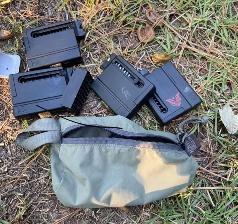

I was surprised to find that my mini chassis is way off from holding the Vudoo mags to chamber a round. I had to hold up on the magazine to chamber a round so I need to find a new mag catch or use rubber bands until my new stock comes.
Simple target, all 50 rounds that I fired without the suppressor. It will come in to where it should be. The last two groups I shot were the best, I’m excited to get it out again if the rain stops.

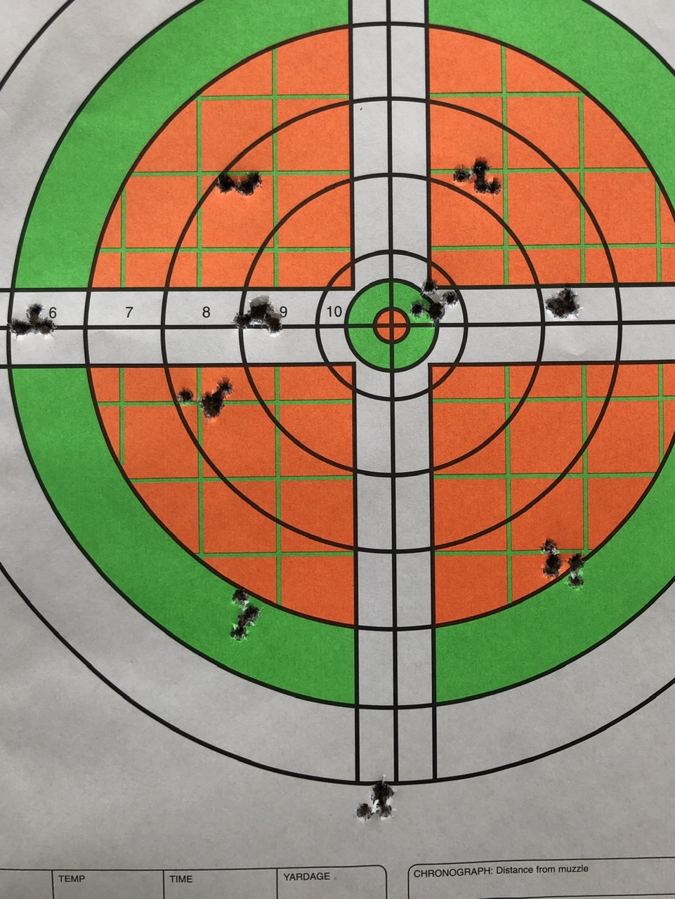

So when I received the action this week and installed it in the chassis i noticed if the bolt is closed, decocked or cocked, for a long period of time the very first bolt lift is really hard to lift. Once it has been lifted it cycles smooth like butter. This also happens mag in or mag out. This also happened before it was put into the chassis. Does anyone have any ideas what it might be?
The next issue i noticed was today after taking it out onto the range maybe 2 out of 10 shots of SK Long Range Match would be really hard to feed and push the bolt down. It runs super smooth otherwise. I've only shot SK LRM through it so far.
Has approximately 300ish rounds out of it
