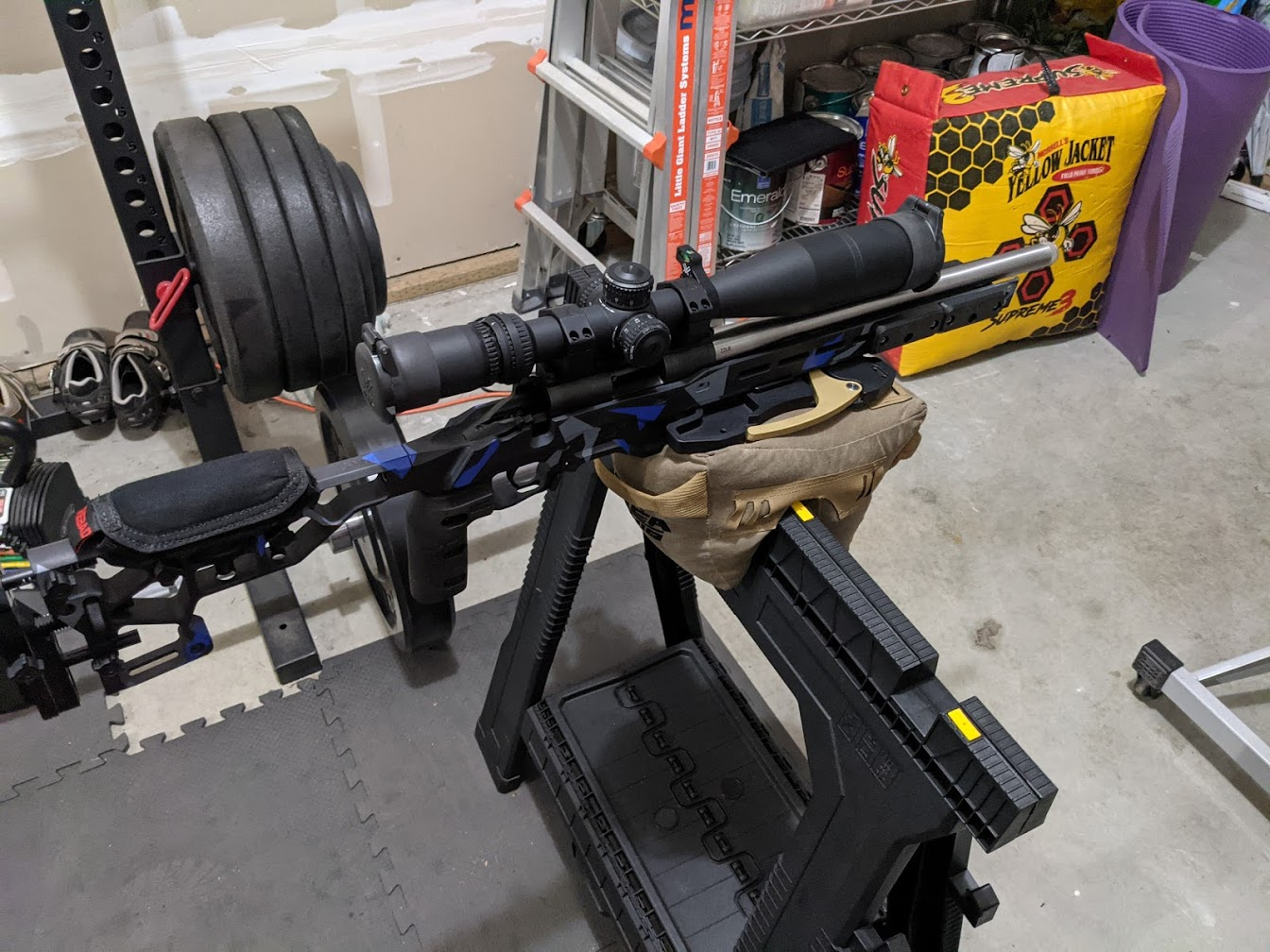

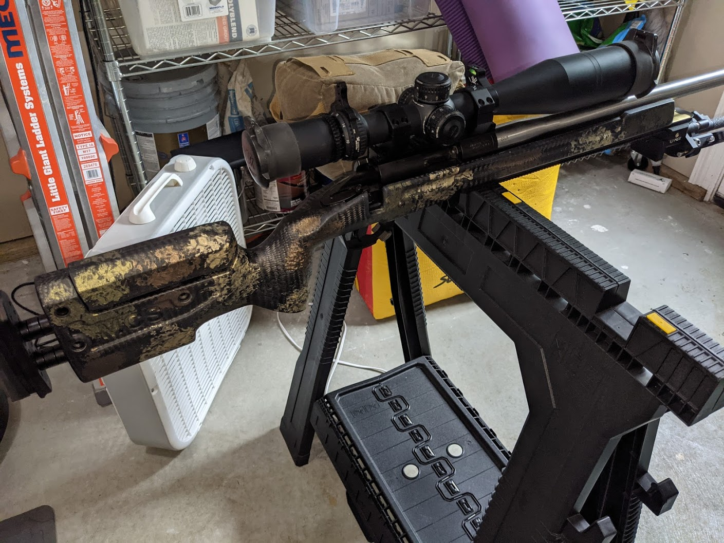

I got super excited with the Manners PRS-TCS stock arriving and hoped it would balance the Vudoo, but sadly it is way too butt heavy.
This is with the rear weight removed, all 7 weights added to the Area 419 arca rail, and the MDT Ckye Pod up front, and it barely balanced in front of the mag well. No bolt or magazine in either. No way to add more weights :/ So just not going to work. I need to I guess build a Manners PRS1 setup if I want it to work out on a Manners.
Reactions: marctolate
What happened to the MDT? Can you return the Manners?
It's back in the MDT. I'm super happy with it now that I have it tweaked. I put the Manners on the Terminus Zeus 308/6GT.
I do want to try to trade my other ACC for a Manners PRS1 though. I know the Manners PRS1 w/ Arca Rail balances really well on the Vudoo.
