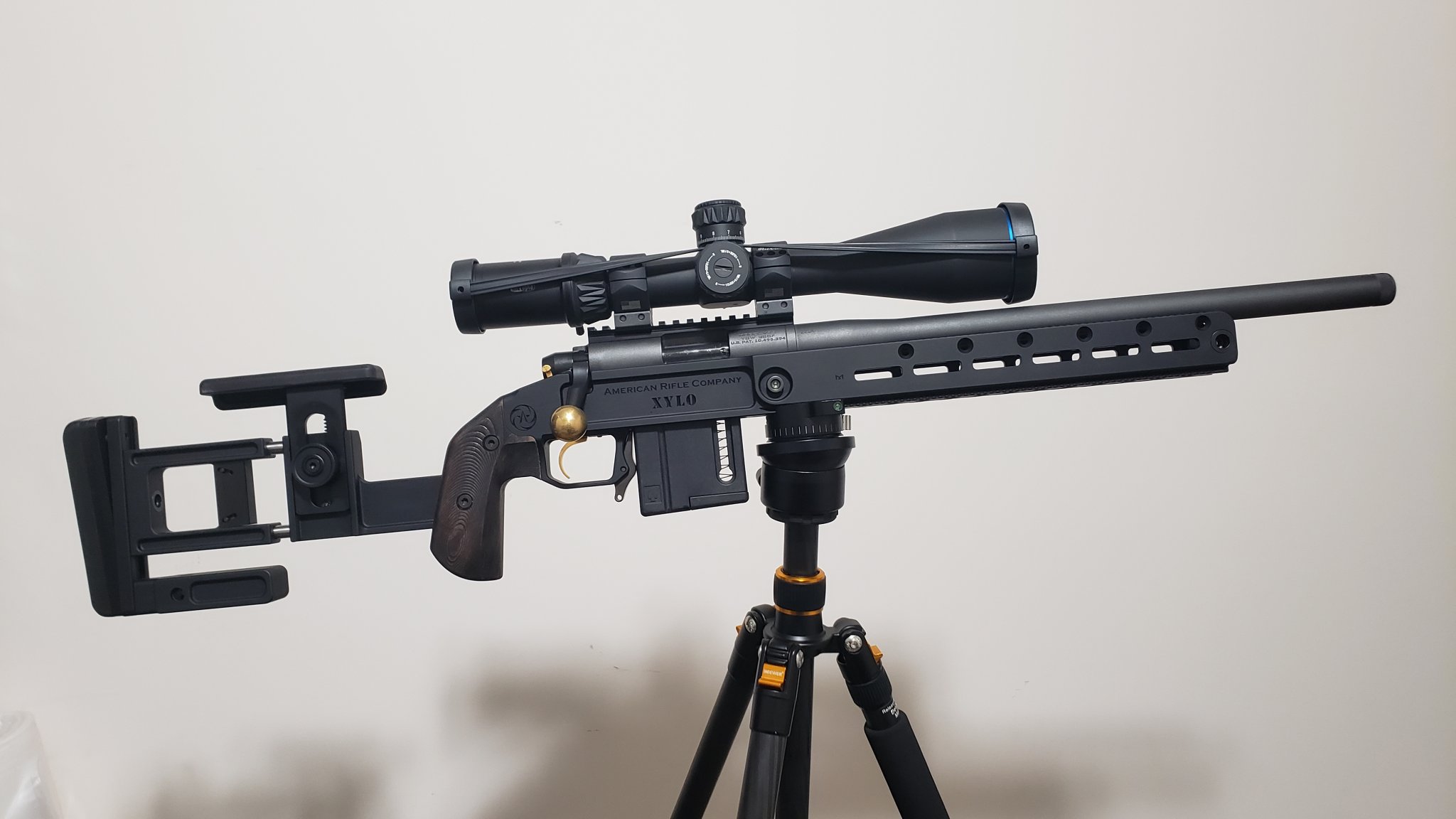

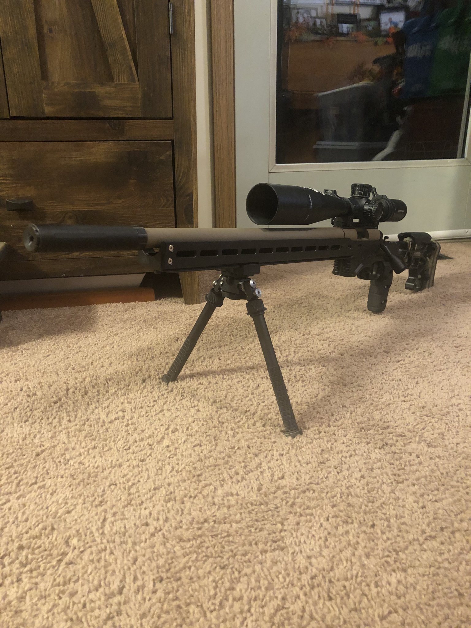

For those who are waiting from Vudoo, ordered barreled action mid June and it arrived at FFL 8/31.

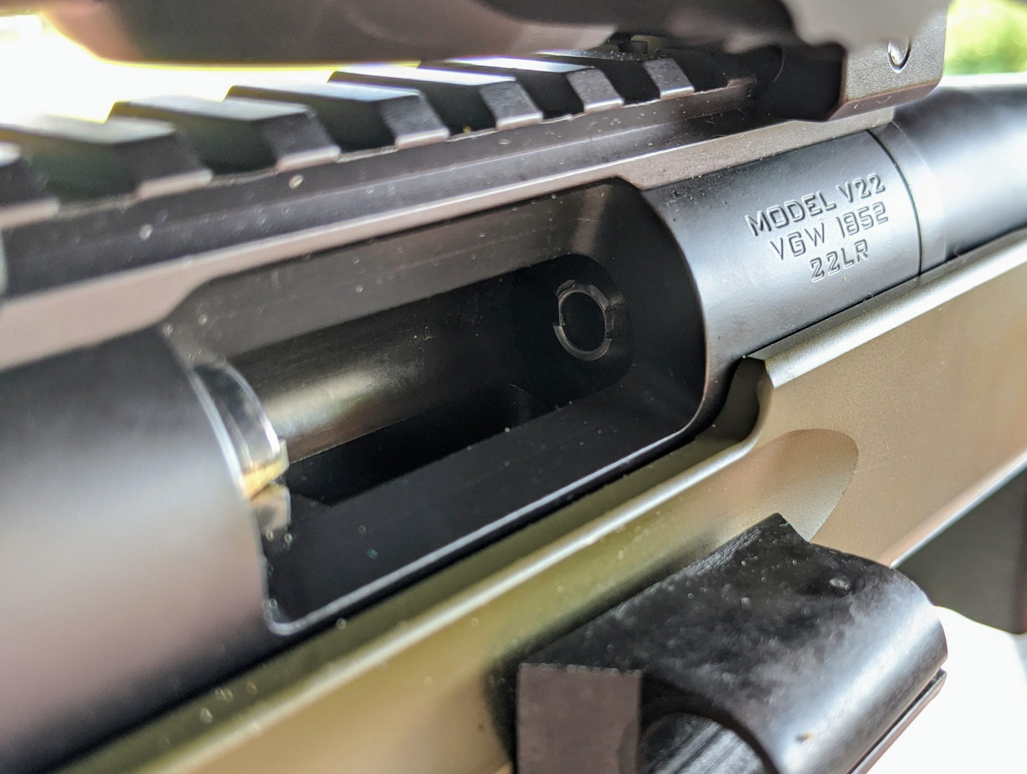

@RAVAGE88
Educational question - did Vudoo switch back to a flat breach? I am guessing this is what this is?
My friend is looking to get himself a Vudoo and looking at the used market to save some money. So he's trying to understand what version/breach etc to understand how much he should spend or wait for a new one. Is this the conal / hybrid breach?
Thanks MB.
Reactions: Jefe's Dope

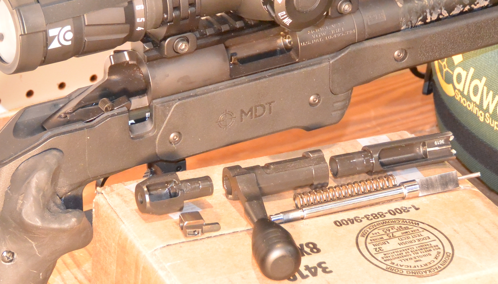

A flat breach would look like this, with no area of relief at all around the sides:
Vudoo beefed up it's cone / hybrid breach on newer guns to have more support around the chamber but still have some relief around the edges to have a place for fouling to be able to go. The thought is that it makes it less likely for someone to damage the chamber while still having plenty of room for fouling to go. Even their original was not really a cone breach in the way some Anny 2013 owners have cone breaches that allow them to attach the barrel in any orientation as that design makes it super easy to damage the chamber as any impact on the breach face then typically deforms the back of the chamber. I expect you can probably order a Vudoo with any of the variations. I ordered it flat. I belive the standard is now the thicker hybrid breach your #3213 is. I really don't think any of the choices is a whole lot better than any others.
Thanks that helps explain a lot.

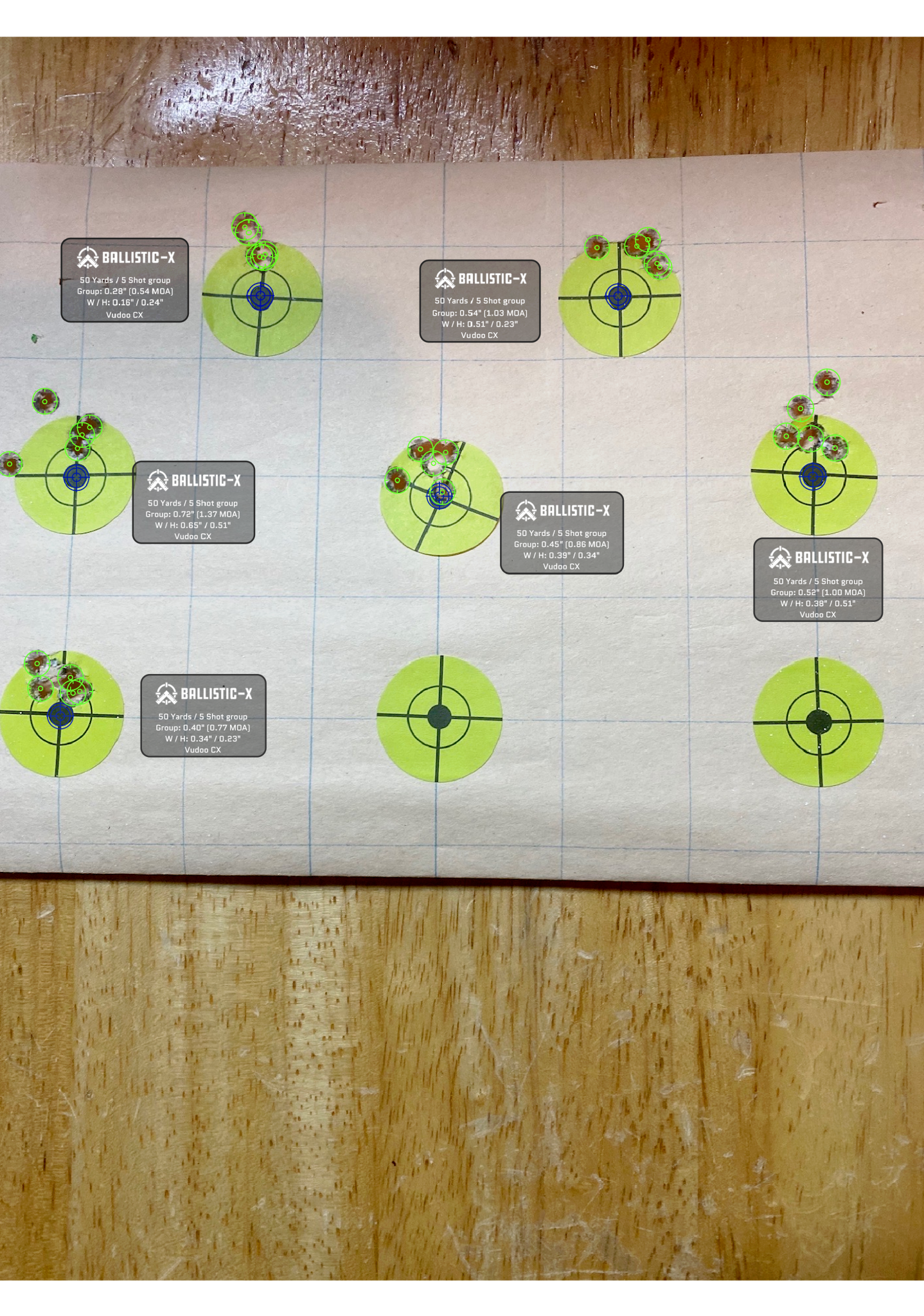

Ran a test today to begin verifying accuracy with and without a suppressor on my setup. I have a 16.5" Bartlein, barreled by Vudoo and was running an AAC Element II.
100 yard groups with the suppressor ran +/- one inch. I ran 70 rounds of SK Rifle Match through the barrel then tested the last 3 groups. The last 3 averaged .75" in 2-3 mph wind coming from my 8 o'clock.
Need to do some more testing, but wanted to see if others are seeing better accuracy without a suppressor.
This is the general consensus. You may get better, but most seem to grow. How much is dependent on rifle and suppressor and ammo.
Thanks and good to know! The most noticeable improvement was the lack of fliers in those three groups. I usually see at least one per group with my suppressor attached.

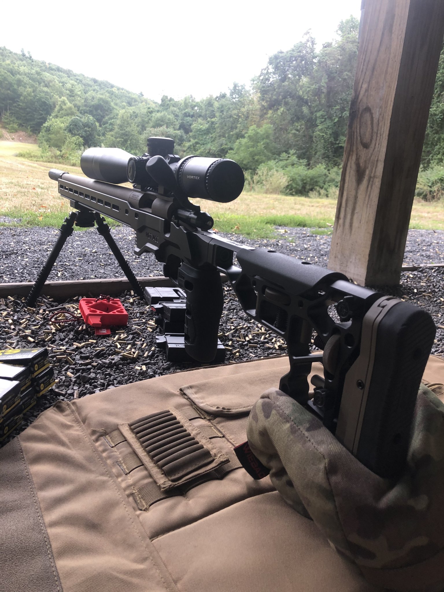

I finally got out again with my Vudoo yesterday. The range has a max of 50 yards but if anyone else is there shooting closer everyone is stuck at 25 yards. When I arrived I was the only one there. By the time I got unpacked and set up a handgun shooter showed up. He was willing to wait so I was able to shoot these six groups from 50 before moving to the 25 for the rest of the day. I could use a little more trigger time.
Nice! Dry firing is your friend too. Watch some online videos, natural point of aim, dry fire practice.

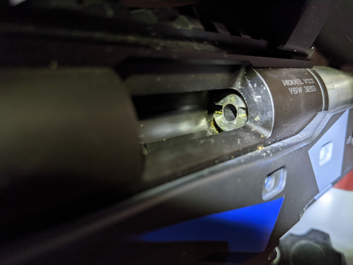

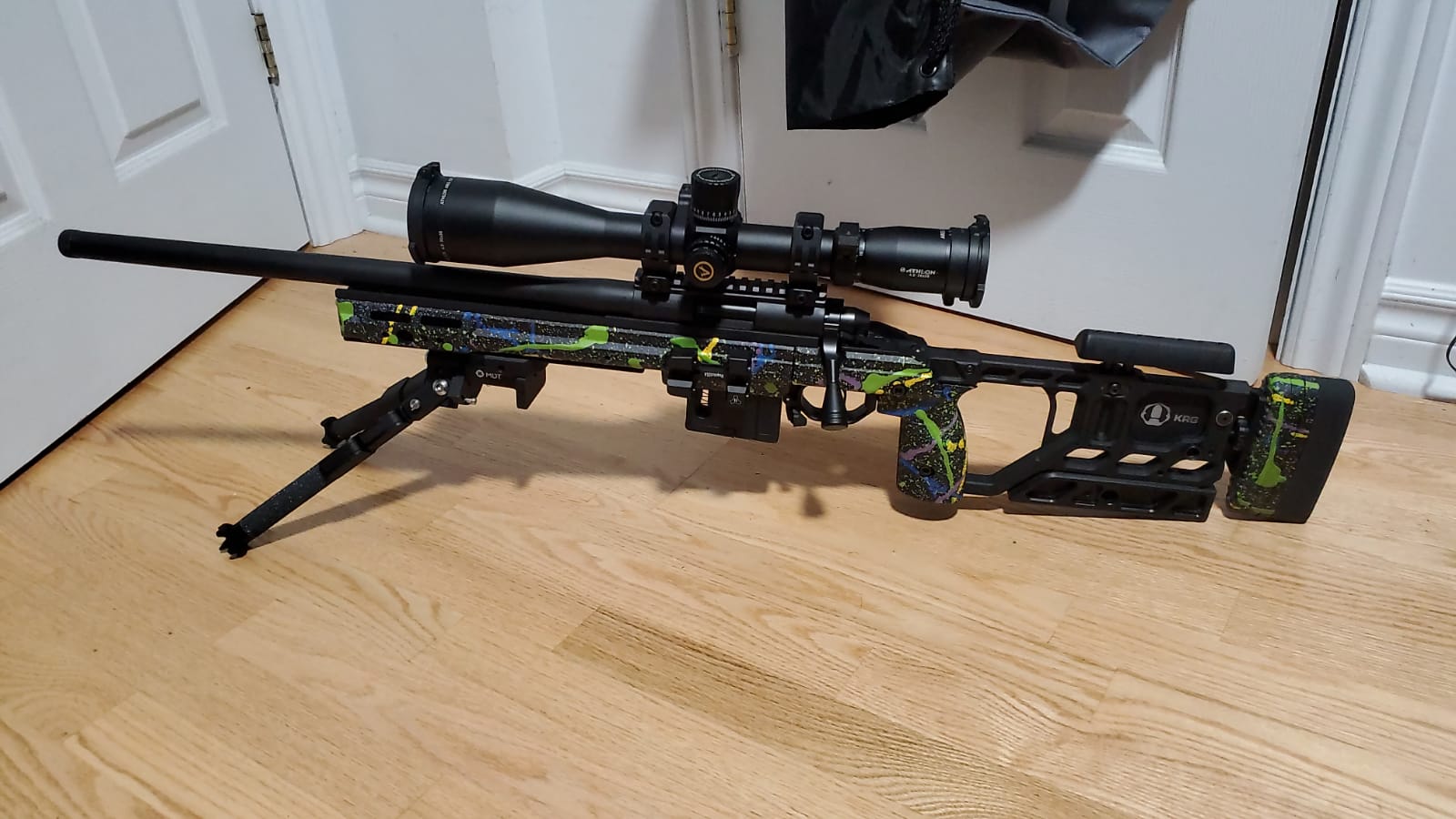

Just got this new to me v-22 barreled action.
Vudoo V-22 20" Kukri
Krg Whiskey 3
MDT Ckyepod
Athlon etr ares 4.5-30x56
installed into chassis at 55 in/lbs
So when I received the action this week and installed it in the chassis i noticed if the bolt is closed, decocked or cocked, for a long period of time the very first bolt lift is really hard to lift. Once it has been lifted it cycles smooth like butter. This also happens mag in or mag out. This also happened before it was put into the chassis. Does anyone have any ideas what it might be?
The next issue i noticed was today after taking it out onto the range maybe 2 out of 10 shots of SK Long Range Match would be really hard to feed and push the bolt down. It runs super smooth otherwise. I've only shot SK LRM through it so far.
Has approximately 300ish rounds out of it
Reactions: Tokay444
When I have all the brass inserts, it will balance barely in front of magwell on flat surface. But when it toss in on the bag, because of where it has to sit it’s still a little rear heavy. The mtu will probably fix that. I also ordered the weight tunable arca rail from 419.
But, I think the revelation will be a good fit for the kukri without having to add so much weight.
How did the 419 rail mount up on the foundation? I want to add more weight and this is one of the few options I have left.
Krg Whiskey 3
MDT Ckyepod
I like the 80' s themed paint splatter on your chassis.
On the bolt lift, you might try dabbing a little grease on the cam in the bolt that the cocking piece rides against when cocking. That area getting dry or gummed up on any bolt gun can make the bolt lift hard. If I were you, I would be inclined to disassemble the whole bolt as well and check how all the pieces feel against each other and if they are lubricated. There is a youtube video showing disassembly. It is pretty easy to do. I think Vudoo recommends something light like CLP for lube. I am in Ohio where it isn't very dusty and tend to use Lucas #2 grease on my rifles because it stays put.
On the hard close occasionally on the SK ammo. The Vudoo chamber is a tight match chamber. If the ammo gets just a little out of spec on some rounds it will close hard. I have typically noticed this on CCI std but it will be the case on whenever an ammo gets a little out of spec. The chamber is designed to engrave all rounds a little so when one is just a bit off it will get pretty firmly jammed in and you may also not be able to extract the round unfired. Such is the nature of pretty much any match .22lr. I would say the Vudoo is actually more forgiving than most as the lugs appear cut with an extra generously angled surface to help get those really out of spec rounds started into the lands. My Anschutz is considerably more of a PITA when it comes to convincing a particularly out of spec round to get into battery.
Dittos on the difficulty in closing an Anschutz bolt on slightly out-of-spec ammo - my 2011 is a PITA in that respect. None of my three V-22s are anywhere near as hard to close on any of the Eley, SK, or Lapua ammo I've tried in them.

1. The Scope Mounting has the scope not parallel/coterminous with the barrel. They 'point' in different directions. Or,
2. The scope is canted and not square with the barrel. So when I go up to 6.2 MOA to shoot 100 yards or 15.0 MOA to shoot 150 yards it is off because of cant.
What am I missing? What else could it be? I feel like I have looked hard at the upper two issues... Maybe not hard enough...
What would you suggest as a way to Trouble Shoot this? And make sure zero is zero on the vertical axis of the scope regardless of distance...
Thank you in advance for your help.
4Certain
Try a tall target test @ 50yds to eliminate the wind at range.
As you run the scope up it should stay on the verticle line..
Oops didn't refresh page, not twisting turrets then disregard.
Carry on
Question re: Scope Adjustment or Attachment:
Good afternoon Sniperhide friends. I have a Vudoo Gen 1 in an MPA BA Chassis with a Burris XTR III 5.5-30 x 56 scope. My zero is at 50 yards. I can shoot and it stays on zero pretty well. But when I shoot at a distance the impact zone tends to move to the Right. Note attached my target today at 150 yards. (Shooting Lapua Midas +) (Holes at bottom of target, not from this session). It could be 'wind'. but I have seen it occur, like today, when there was little to no wind. Go back to 50 yards, right on. Go to 100 and it is to the right. As I try to figure that out, I only come up with two options.
4Certain
Good morning Guys. Thank you for your thoughts. I answered my query this morning. I had NOT set my scope properly. It was NOT square with the world. On this set up I used an old system from the past that worked fine with less magnification Second Plane scopes. That inside the house door jam was not far enough away... I set up this morning with a 55 yard Plumb Line. My Vertical Cross Hair was NOT vertical. That, I believe, explains my shooting to the right...
I had four different machinist levels on the chassis. Made sure the scope was aligned with the Plumb Line as I tightened the Top Scope Ring Screws. Then I readjusted my Burris On Scope Bubble Level. Gee was it off!! The little BB Ball Level on the MPA Chassis was pretty close. Checked all levels and plumb line again...
Now to go find a time to get back to the range and do some more shooting. But I believe this will have remedied the "Goes Right" situation. Yes, I need to account for wind. And a little can still move it a fair amount at distance. And I need to make sure my gun is level when firing. And I need to do my trigger control part... But all those things I can do.
I thank you all for thinking and posting. You were helpful. And I appreciate it.
Grateful. 4Certain...
And may we all pray for our Military and First Responders and our Country on this 9-11 Anniversary.
Stay Strong and Resolute USA. Stay with the Constitution. Live out High Moral Ideals...
Go back and shoot it again. It would have to be extremely canted to account for that much lateral movement. Also, our brains tend to keep the reticle pretty level while we shoot. So, even though the reticle was canted in relation to the rifle, you likely had the reticle fairly level naturally.
I think you’ll find it was a combination of several things still.
