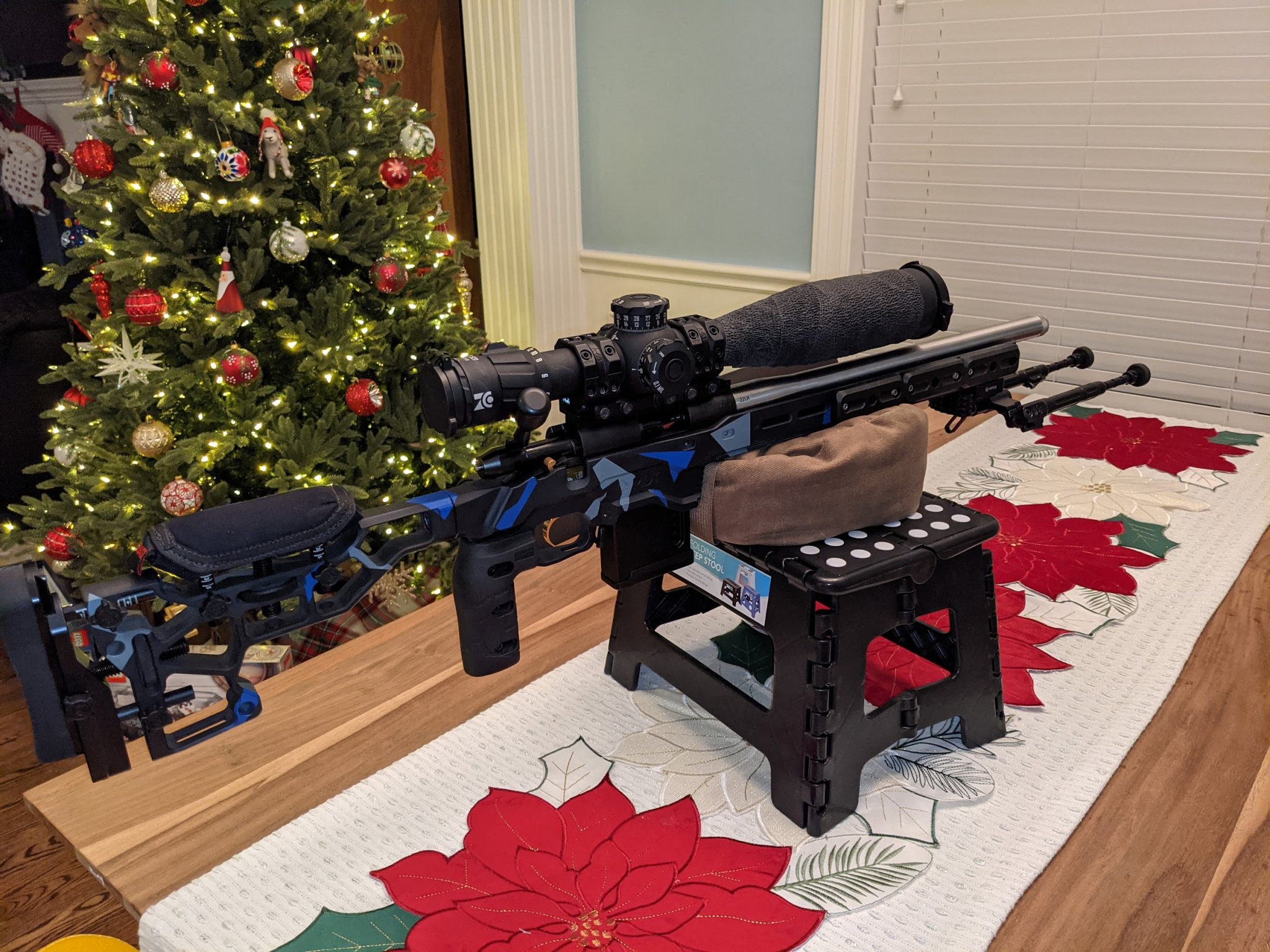

Finally got the Vudoo put together. 20” kukri barrel action, diamond 2 stage, manners TCS with a Vortex Strike Eagle. So far it’s a shooter, although the Midas + has been a let down.
As others have mentioned, it doesn’t balance, rail is full of weight and the rear weight has been removed. I think I will add an Area 419 brake to put some more weight out front. Haven’t weighted it but it’s heavy. Going to be full moving it around during our NRL22 match this weekend.
A few things you can do.
Ask Manners for the steel arca rail instead of the aluminum one.
Get the KSS ATS tuner, it's 8oz. A hellfire brake is only like 4oz.. or get both and then it'll be 12oz :)
The tuner at least will improve your groups, the hellfire brake 🤷
Reactions: unoigo
Thanks. The steel rails are on back order, that was my first thought but will get one eventually. Good call on the tuner. Yea, the brake was more so for weight, nothing more.

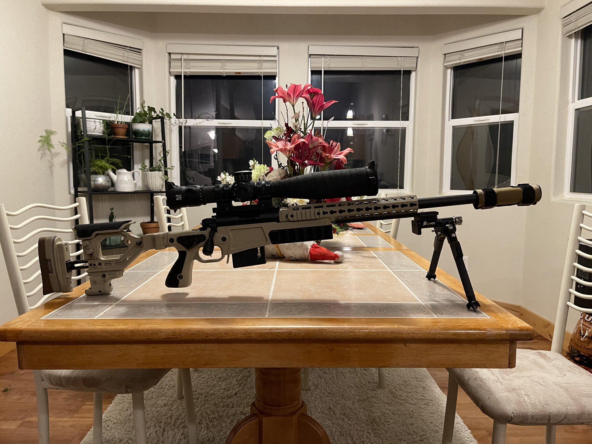

Here she is in all her glory 🤤 Picked her up tonight and assembled. Got the mags to all fit and feel nice and tight in the mag well. I’m happy with it!!
@littlepod you were way right about the balance, it feels much better with the 20” MTU barrel on it and almost balances perfectly.
Also my trigger pins were in with the action screws as well @Bradu
I thought the same when I received mine. They were in the small bag with the action screws. Did you check that?
Didn't get action screws either which isn't a big deal since I already have some with my bottom metal. Also, just noticed the set screw for the bolt disassembly isn't there like in the video.
That’s very strange. If you bought it new from a dealer or gun store, I would give VGW a call tomorrow morning. I’m sure they will send you what you need. Hell, even if it was 2nd hand, I’m sure they would get you what you need.
I bought it from Mile High and emailed them about the trigger pins. Was looking everything over and happened to notice the allen screw so I'll need to reach out to them. I was originally just looking to try to get it up and running by the weekend but looks like that isn't going to happen.

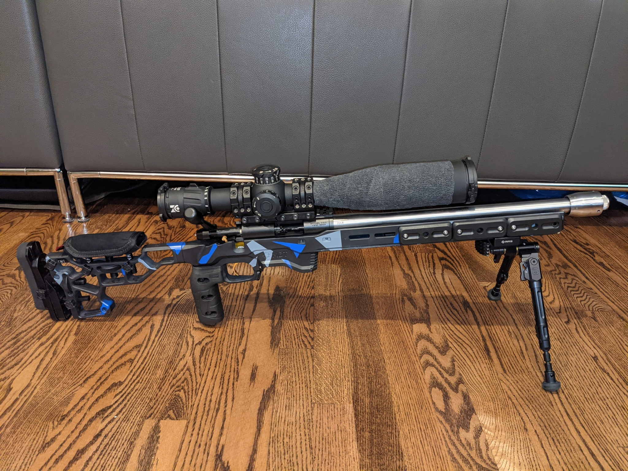

How does your mag fit your TCS? Does yours feed ok?
