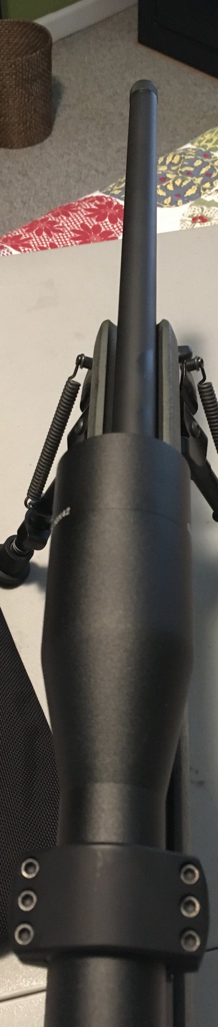

I doubt that you will have any issue, as far as accuracy concerns go with your barrel being slightly off in the barrel channel.
Over the years I have encountered numerous guns that were slightly off. If you looked at 100 guns closely you would find that there would be way more than you think, that are not exactly perfect to .0005.
You could fix that if you wanted to. You would have to remove material in the receiver and bed the action. Not really a big deal.
You would use something like painters tape or surgical tubing around the barrel to keep it centered in the channel as the bedding cured.
In other words wrap the tape ( or tubing or whatever you use) around the barrel precisely until the tape LIGHTLY touches both sides of the channel, without bottoming out in the channel which would cause the action to be tilted, off level.
Even after a proper bedding job there is no guarantee that the barrel with be perfectly centered in the channel down its length. Some of this depends on the stock itself. But it would be quite a bit better than it is now.
You'll need to shift the position of the entire action in the stock, not just force the barrel into alignment. Just a few thousandths of position change in the receiver will make a big difference in the location of the barrel in relation to the front of the fore end.
Know what I mean?
It's not hard.
T.S. - I had a hard time explaining this even though I've done it about a thousand times. lol
Cuzz-Vudoo has already issued me an UPS call tag to ship it in for repair. Then I started thinking-uh, oh dangerous-that maybe just maybe I'm being a bit nit picky. So, I decided to reach out to you folks for feedback. If it needs to go back, then fine. If it doesn't, I just saved Vudoo some time and ultimately, money.

Not really to stick my nose in what's not my business, but, The good people at Vudoo will want you to send that back.
My guess is that your stock is imperfect. It could be fixed pretty easily, but they will probably just put your barrelled action into another stock and send the one you have now back to their distributor. This presents a fine opportunity to have this gun bedded.
Mike and company would not want this gun out there. A problem has shown up here on SH......Although a cosmetic problem, I am 100% sure that they want this taken care of.

@RAVAGE88...other than cosmetic, does this barrel cant to the right/not centered propose any issues? View attachment 7164736
Most guys on this site (me included) have an OCD and a barrel cant like this would be a no go. A few years ago I did have a similar issue with a Savage. Once I rebarreled it and put a new barrel lug, the alignment was good to go. BTW a barrel cant isn't necessarily because of the stock. I saw that you're returning it to get it fixed. Good call.
It's the stock.
What do you think? The barrelled action of a Vudoo V22 is warped?
This is an issue with the stock and although it will shoot very well, it’s not acceptable. I see you’ve received a call tag and it’ll be dealt with quickly. Very sorry for the trouble of having to return it, but we’ll make it good.
MB
From what I have seen this was a pretty common issue with early Grayboe stocks. I have two and a friend has one as well. All have the barrel canted slightly to one side. I actually have a Grayboe stock waiting for a Vudoo when I get one. Hopefully they have fixed the issue.

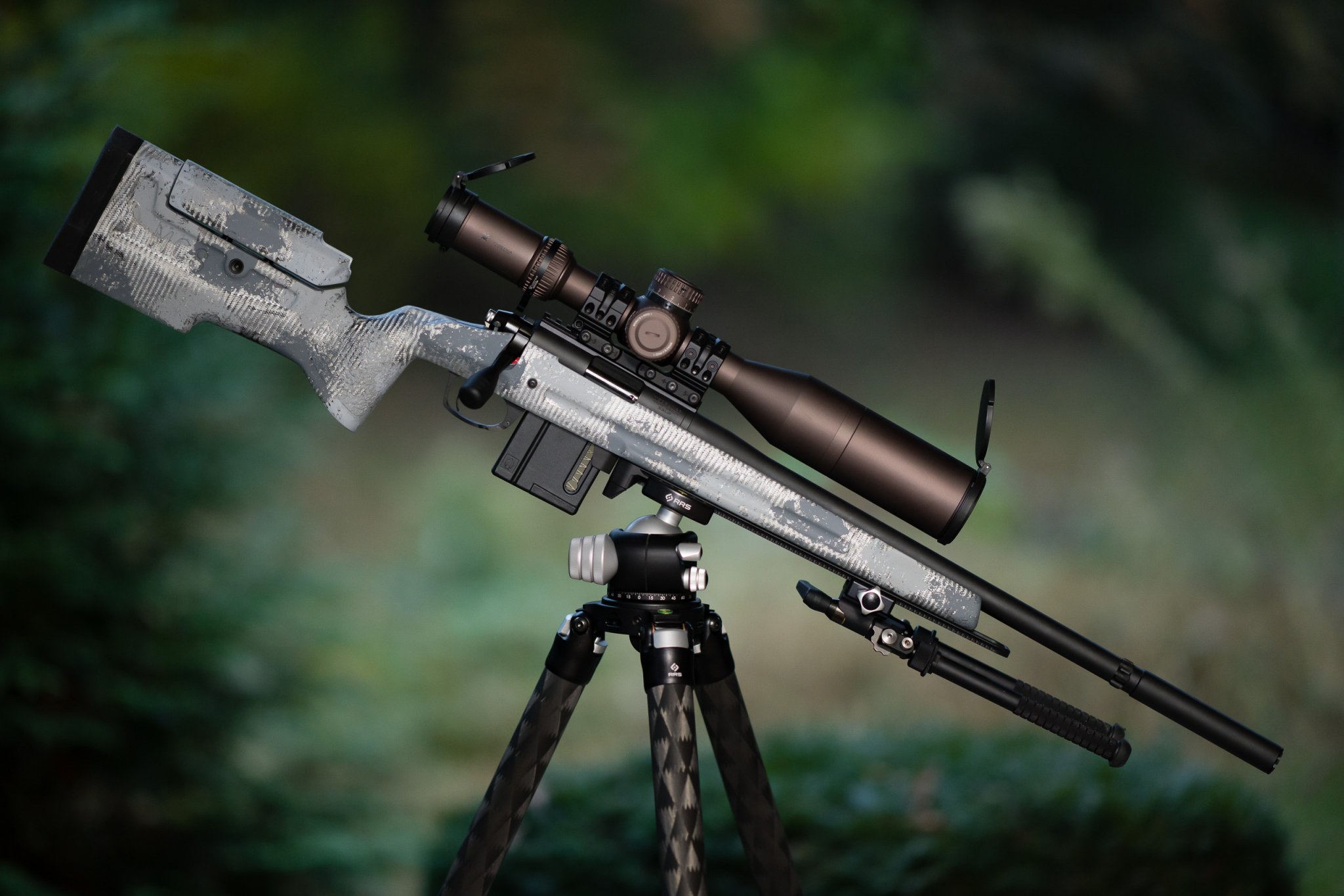

Just got mine yesterday, first range trip today. My only regret is waiting until now.
V-22 barreled action, 18 inch Kukri barrel.
Manners PRS1 with gen 2 mini chassis and Area 419 Arcalock rail.
TriggerTech Diamond.
Vortex Razor HD Gen II 4.5-27 (maybe temporary).
Good photo. Any comments on shooting with a tripod as support?
RLS
RLS
I’m not really an expert. I’ve shot a little from a tripod and found that it’s more stable than completely unsupported, but quite a bit less than off a bipod. It can be tricky to position the rifle perfectly, even with a solid ballhead. Part of the problem I think is that a ballhead is the wrong device—photographers using supertelephoto lenses will generally use a gimbal head that keeps the axes of rotation above the center of mass. A rifle is even heavier and would benefit more from something like that.
