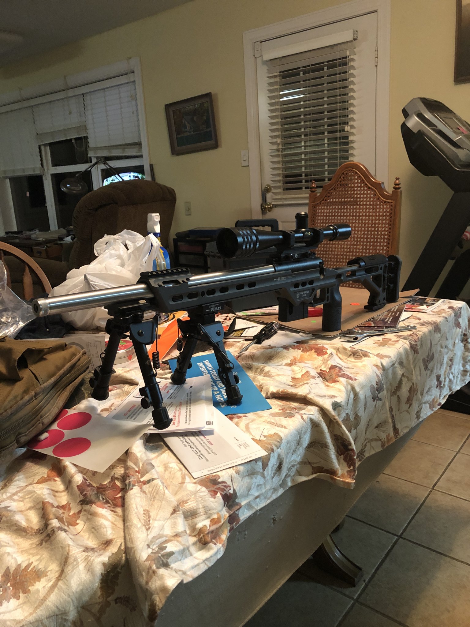

I can give you more advice than you want but im far from excellent. I will post pics but it will probably be a week or 2. Im supposed yo get it thursday but weather says rain thursday and friday. There are good target pics of some very good shooters in the 5x6 or 6x5 thread. Several with Vudoos.
I went to work on my trigger yesterday and while i was there they got the to ok to let me have my gun. after several hours and phone calls, Bix n Andy decided that i need a lightest 2nd stage spring, its in the mail, they were very kind, patient and helpful, also talked to Vudoo they were perfect as always. I hope the Vudoo folks will forgive me for the pics if i get them posted. I was running out of daylight, excited, first shot was a foot high at 25 yd. i forgot to boresight. I shot targets that were already there and shot at. The last 4 shots are about as good as i can shoot, the rest will get better and i will post more pics.
