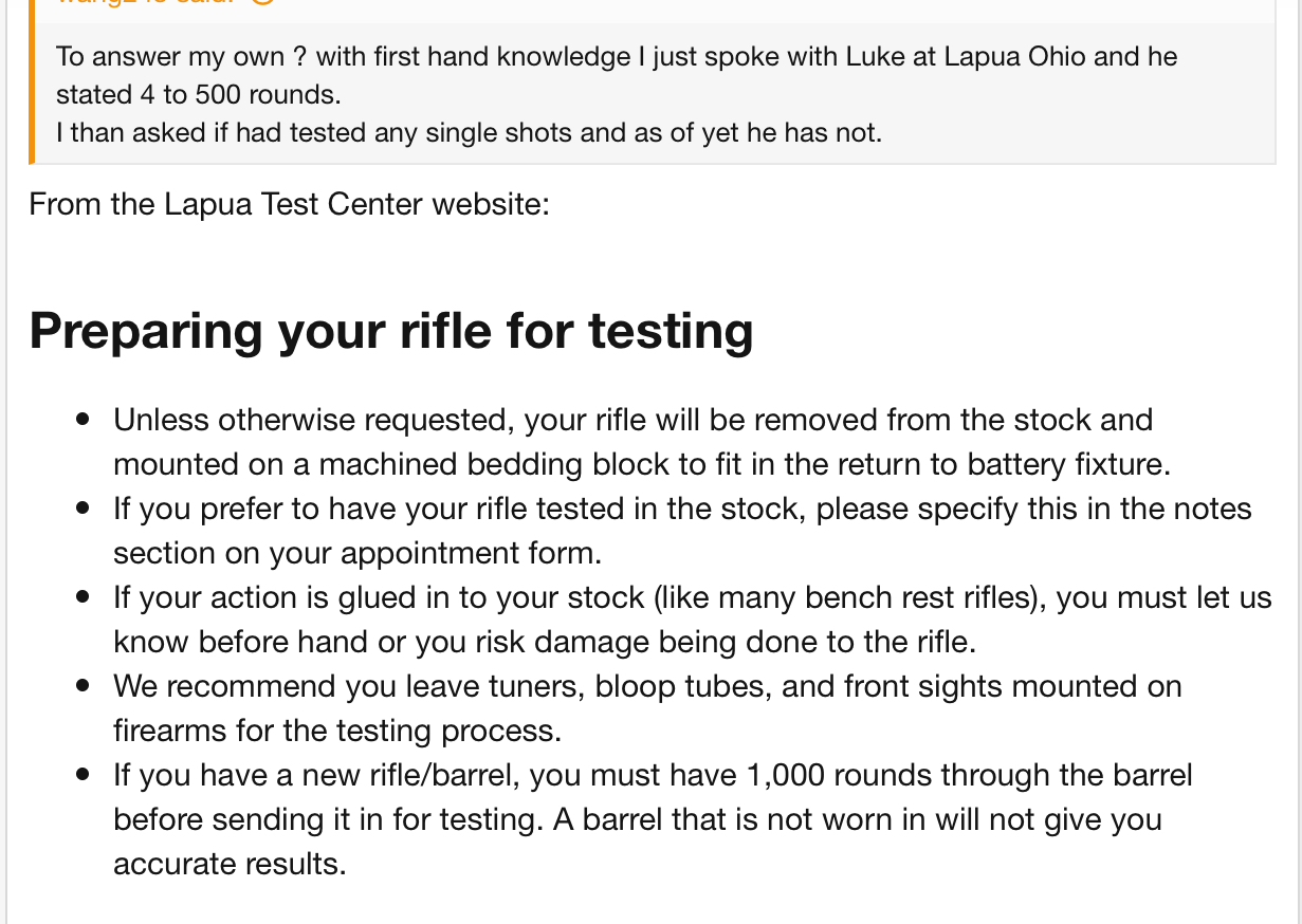

trying to wrap my head around 1k rounds before testing. I have always shot f/class and know the barrels burn up ben there done that many times. But wouldn't a good rim fire shoot its best shots after a little break in and cleaning ? If you have a good rim fire barrel why does it take that many rounds to break in? I am newer to 22lr bench rest so just seeking info. wouldn't some witches brew cleaner do as much break in as 1k rounds ? Just seeking knowledge.
If it’s a good barrel that has been chambered properly it will shoot as good as it is going to right out of the gate. At the very most maybe just a few hundred rounds, but none that I have owned needed any more than that. At least that has been my experience...
Not wanting to start anything but this information I was going off. Your mileage my very but your spending a lot money and I can only tell you mine shots better every outing, could be the shooter bounding with the setup or the whole system breaking in .
Still loving my V22S get out about every weekend maybe not so much getting to be below zero weather but I want to see how it act in real cold weather.
What do you think MB did you make this for cold weather or is the chambering going to be to tight .
Anyone else going shot in the cold or just going to be me ?
FYI:
This not my information this is screen shot from another site this is where I read the information.
L

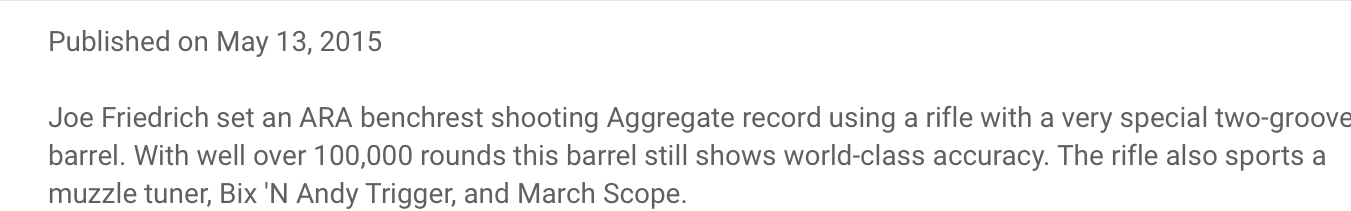

My 52C was made in 1960 and know I have have more than 20k round thru as I bought it used does it still shot great for me I would have to say yes, is it world class no but I’m not either, Rimfire from what I understand can go on and on compared to center fire rifle. What everyone thing ?
@mattt: Very good question.
My assertion is the number of rounds required to break-in a barrel is an open question. A lot of opinions but neither data nor theoretical justification for the number of rounds. Has either Lapua Test Center given a reason for the number they specify?
Some comments:
(1) Ammunition does not have an accuracy/precision. Only a rifle-ammunition-shooter combo have accuracy/precision.
(2) I have not seen a definition of what it means to break-in a barrel. Perhaps when the accuracy/precision no longer changes according to one or more statistical metrics. But what metrics and by how much? Say when the average precision in different 6x5 Challenges differs by less than 0.010 MOA?, 0.050 MOA? more? Choose your poison but please state it quantitatively. Otherwise like blind men describing an elephant.
(3) A hypothesis: The number of rounds needed for break-in could vary substantially. Say zero rounds to who knows how many, however anecdotally likely not none.

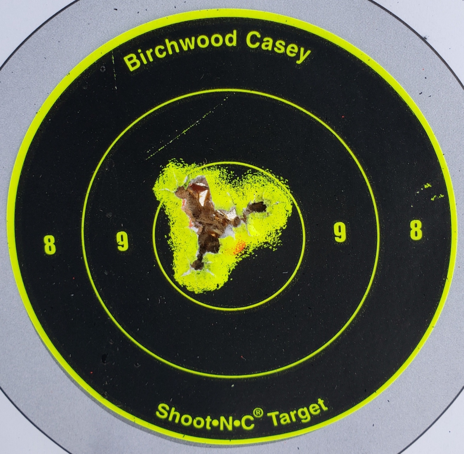

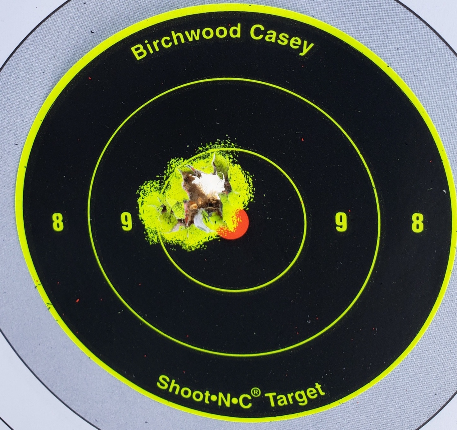

Sure:
These were at 100 yds 15 degrees weather but sunny. Lapua polar biathlon .bipod with rear bag.
This isn’t the weather to testing for score but I needed the range time and wanted to see what the V22S like the cold.
You can judge for yourself.
Did the build care about the temperature ?
I’m planning to get out with it below zero also as long as it’s sunny.. only 3 more months of Winter..
The popsicle sticks were just for fun little harder that groups only one shot per stick.
Enjoying the build.

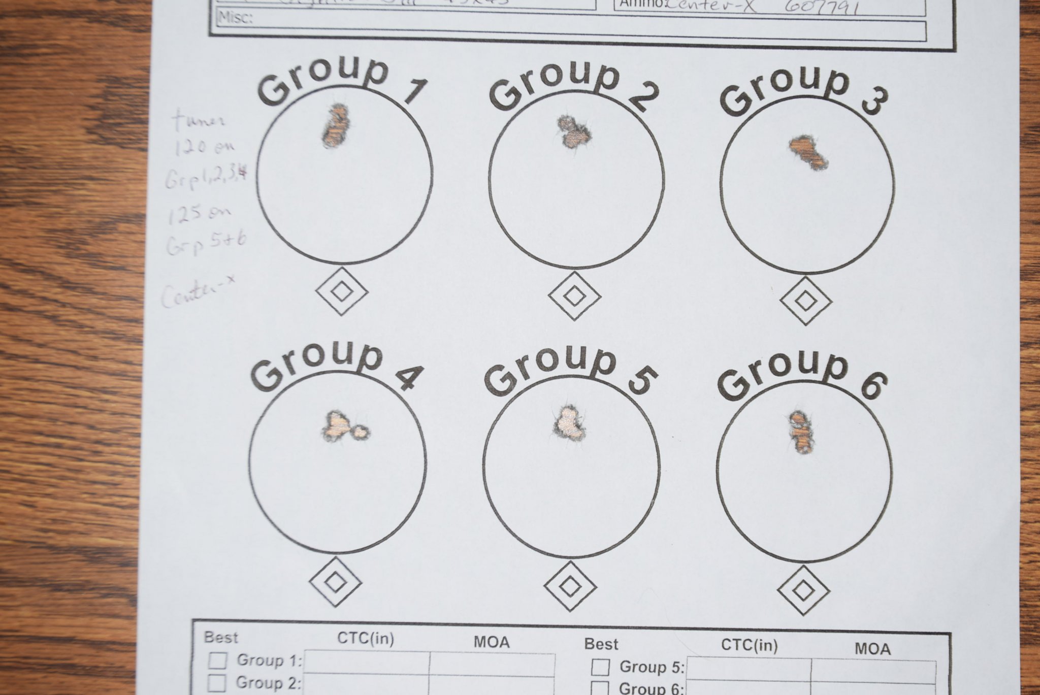

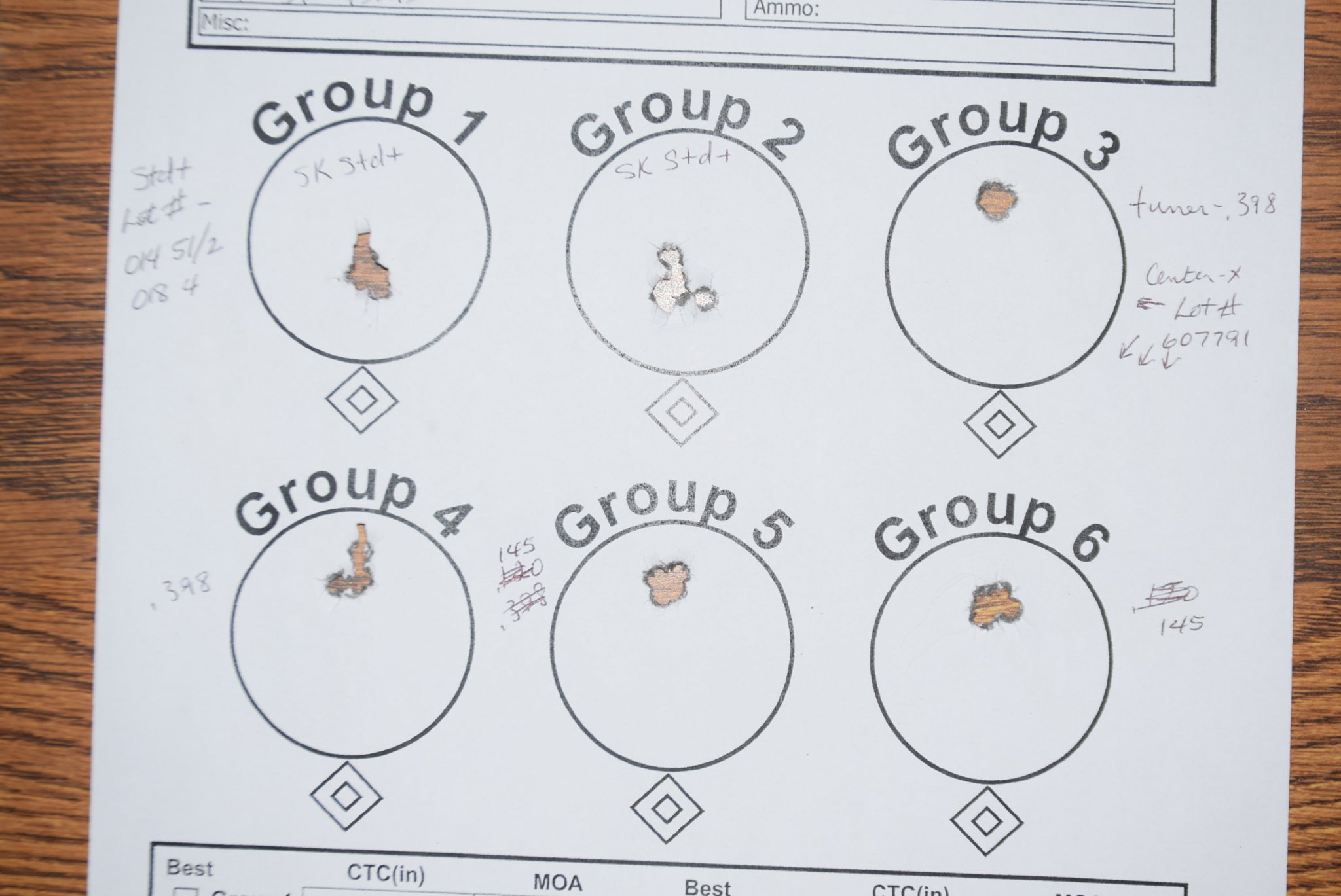

I was able to get in some shooting at 50yds in pretty awesome conditions late in the day about a week ago - temp was 47*F when I started, and wind was calm - unusual, but very welcome when trying to establish a solid no-wind windage zero on a new scope. Rifle was shot with Pro-X tuner attached; my scribbles on the targets were due to some confusion as to where I had the tuner set. Good thing I've got new glasses ordered with stronger scrip for the bifocal - I thought I had the tuner set for 120, but wasn't seeing the finely engraved scale correctly, as it was on 145. I can see the scale well enough indoors, but with bright sunlight outdoors, it gets tougher to see it clearly. At any rate, groups #1 & #2 on the 1st target were 'warm-up' strings with an average lot of SK Std+, then I switched to a lot of Center-X that was 2nd best during lot testing 3 or 4yrs ago - I'd found an outstanding lot, but my testing had been delayed by work & weather, and I wasn't able to find more of it, so settled for 7 bricks of the 2nd best lot, which hasn't shot all that well in my V-22 repeaters. However, it does pretty well in the Shilen with Nevius chamber & the tuner, so I'm glad I've still got several bricks of it. I'm shooting off a portable bench that's a little hard to get comfortable with, with the same homemade SS front rest & rear bag that's in the pic of the rifle. I'm seeing pulse beat in the Sightron SIII 45x45 scope unless I shoot w/o any upper body contact with the bench, which isn't easy or comfortable for me to do. Have a lot to learn about 22RF BR shooting, and am also thinking seriously about buying a single-piece rest. I used the Purdy method of calculating the initial setting for the Pro-X tuner, and wound up out at a setting of 398, so then re-calculated to find the EC of the bushing, and subtracted it to come up with the 120 setting. I think the rifle shoots very well - it just needs someone who has a clue to pull the trigger...

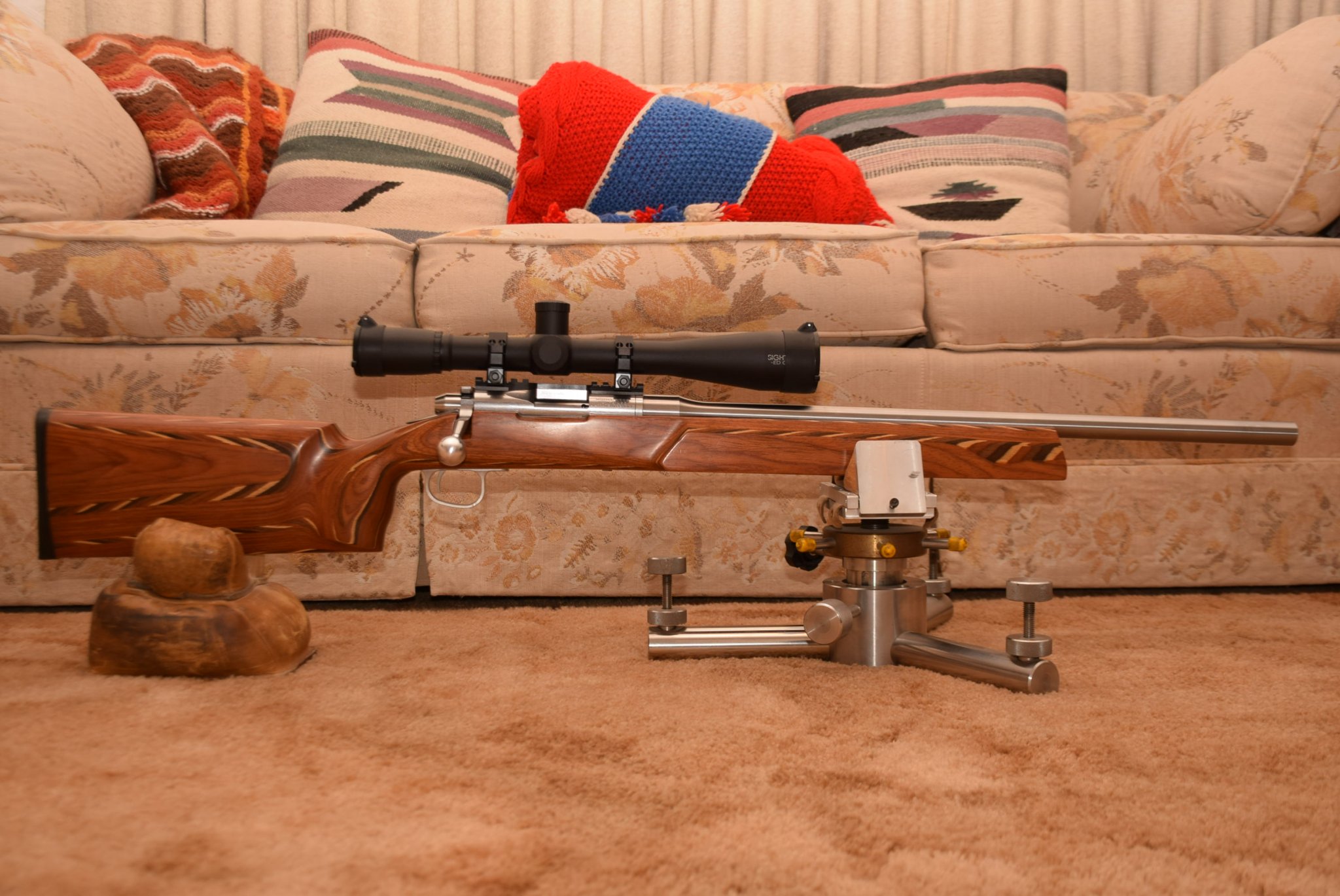

Happy New Year Mr Flat, I am surprised that you are one piece restless. I bought an Arnold one piece 6 mo ago for testing, I had no intention of chunking my bipod but i dont think Ive shot a round off the bipod since. I really like this thing. One of the thing its done for me is to see how much a slight wing affects me. I only have a repeater, thinking about a ratchet.

Cuzz - I've been researching one piece rests for a couple of weeks, though I've thought about getting one since I ordered the V-22S action. Some 22RF BR matches forbid the use of one piece rests, but regardless, I feel it's the way to go. In fact, I ordered a PQP precision joystick rest with the fuzz button top from Killough yesterday, and am very much looking forward to getting it in hand and doing some shooting with it. AFAIK, there are no 22RF BR matches being shot out here in the western Kansas area; I'll probably have to drive a couple hundred miles down to the Wichita area to find any. But I feel I'll need such a rest if I'm ever going to get the tuner sorted completely out, along with a more substantial bench set in concrete...
Happy New Year to you as well!
