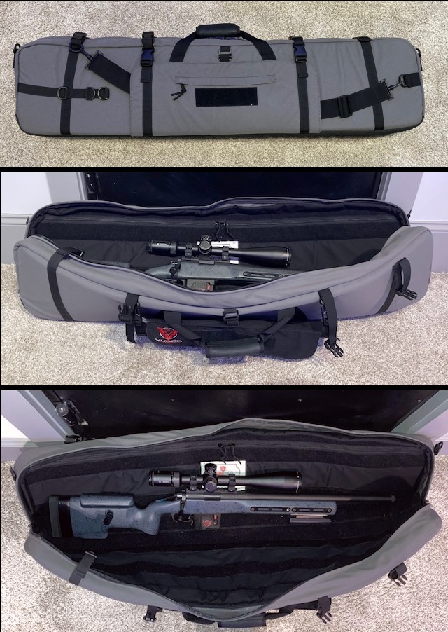

Can someone post a picture of the Vudoo soft gun case with a rifle inside? Thank you.
Here you go. The case does *not* open up enough to lay flat open (the zippers don't go all the way around to the bottom).
There are also more pictures of the bag here:

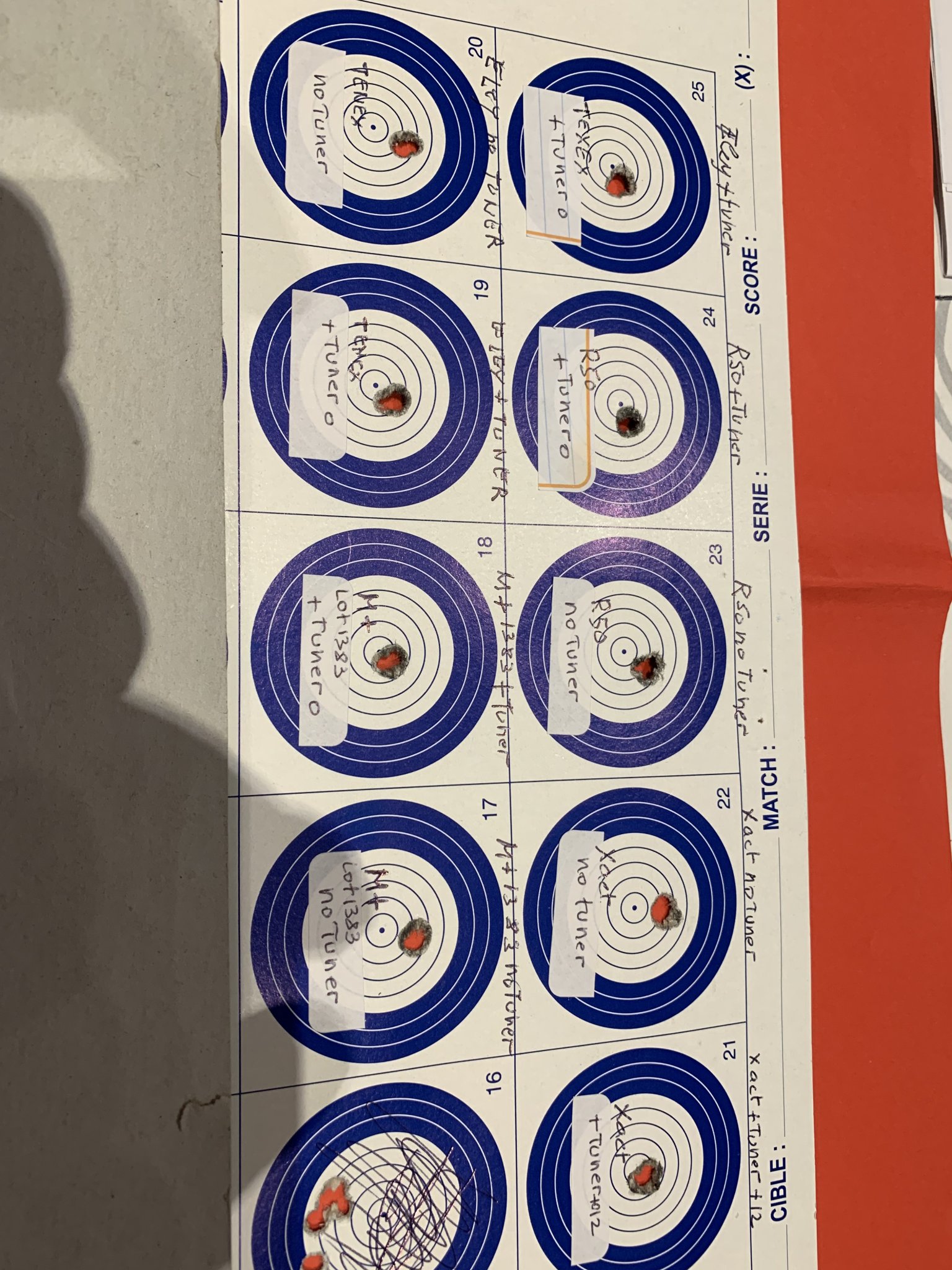

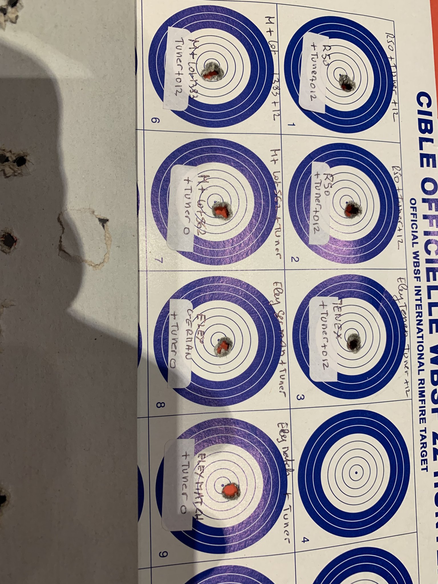

Here is an indoor test with my V22s, of different brands of ammunition
R50, TENEX and Eley Match and Eley Match German, LAPUA M+ and Xact
the R50 is a lot that is at least 6 years old!!!
Tests with Tuner, without Tuner or with Tuner set to 12 ( 1/2 turn)
5 shots in each grouping
View attachment 7786423View attachment 7786424
At what distance were these shot at??
What you see is what you get! I was really surprised! The mat and plywood are theirs. There's one issue: The plywood bench is supported on either side with what looks like furring strips or 1x2's. No problem there. That's sturdy enough. The issue comes in if your rig is HEAVY. My rest, rifle and rear bag weigh quite a bit. Enough to "sag" the plywood when resting your elbows on it. What it needs is two pieces of the "fine 1/2" layered Russian plywood" glued together making 1" and cut to fit. One could even cut a handle in it for easy transport. I'm thinking of suggesting it to them. The Russian plywood was my friend Drew Certain's idea. I've never seen the stuff but he tells me it's stout stuff!
GTI, I had a chance to visit OnTarget on Monday. Had a good testing session, but you are right, the benches are way too flexy. So, I am headed back this Friday to shoot another session. I had a prop that I made for shooting at Gat Gun, which will help at OnTarget. It's basically a one inch thick wood (pine) step replacement (from Menards), with foam attached to the bottom to minimize vibrations at Gat Gun. I think if I place the board to the right side of the bench at OnTarget, it should help a lot to stop the flexing of the plywood, given the thickness of the board. I'll take a pic or two and send it your way so you can see what you think. My board will set on top of the plywood (plywood/board/one piece rest/rifle), close to the right side where the support is best. I'll let you know how it works. The things we do to adapt to our environment...
Sorry, let's get back to the Vudoo thread now.
Best regards everyone...

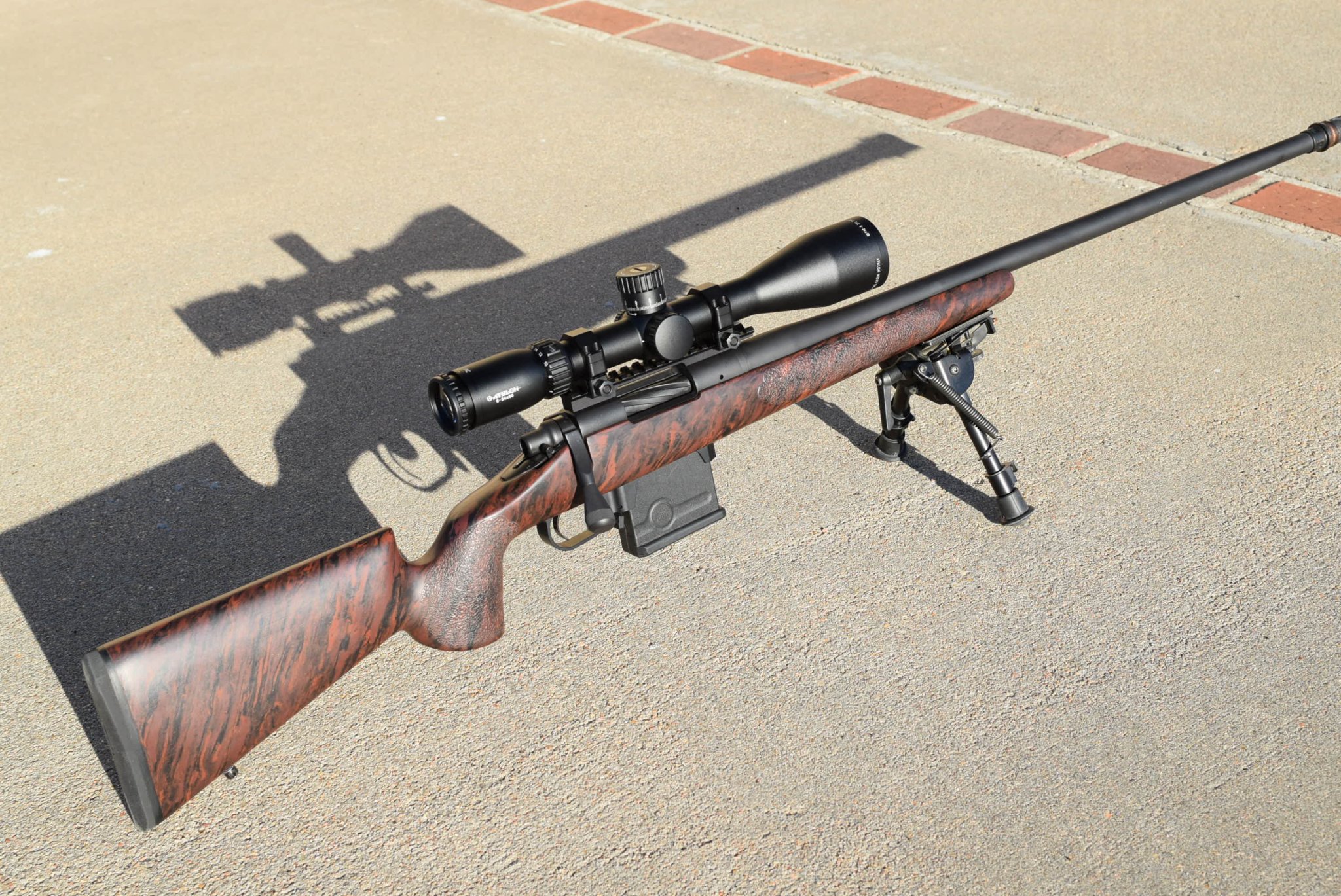

Dennis,
Which model McMillan stock is that pictured above? Beautiful stock by the way!
It's a Game Scout. Biggest difference between it and the Game Warden is that the latter has a wider forearm to allow the use of heavier barrels. Having been a long-time user of McMillan's tactical A3-5 & A5 stocks, I've grown to prefer the vertical pistol grips of these & Manners' T4A, EH1A, and PRS1T stocks.
Reactions: ccollier

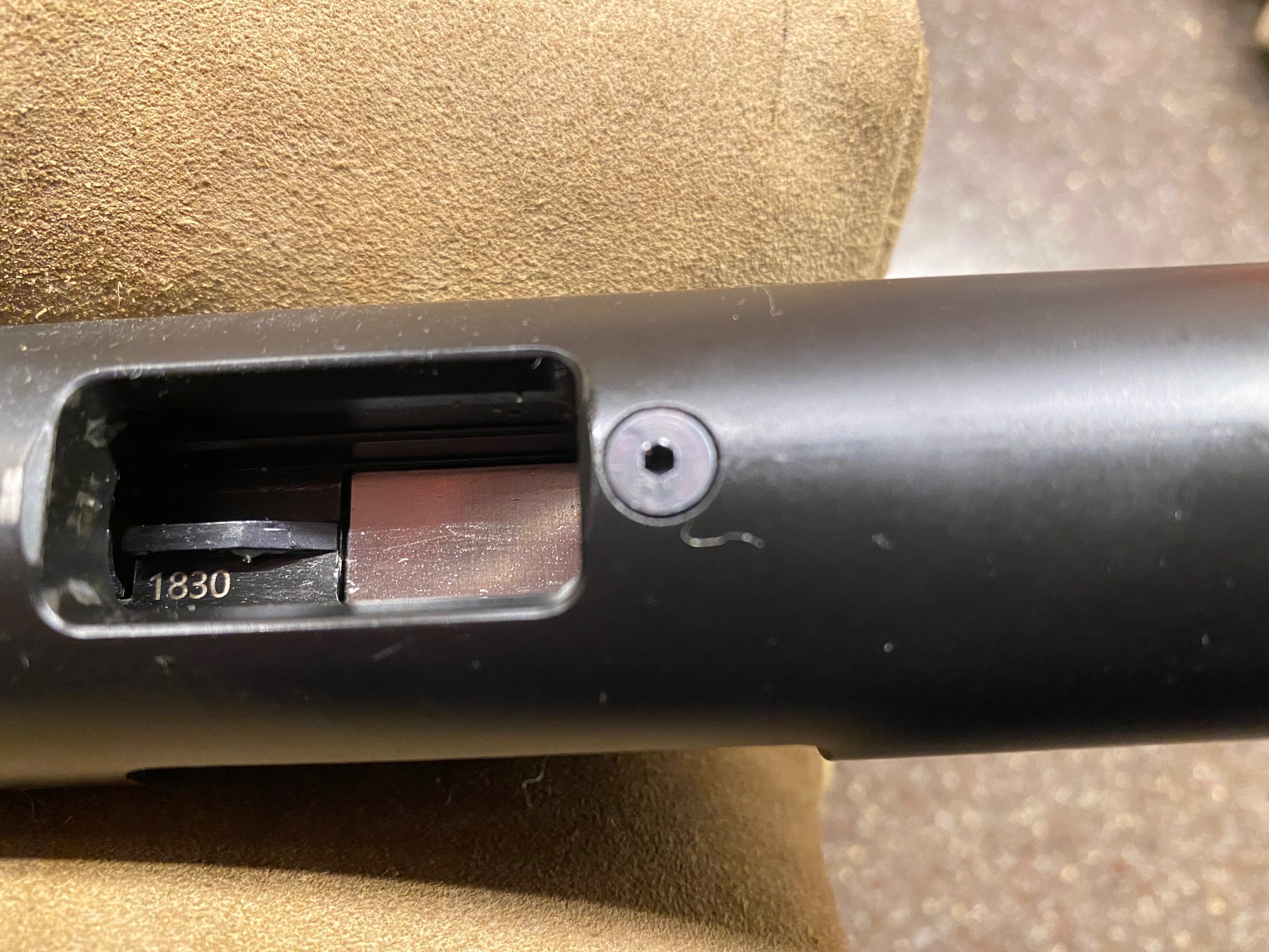

Is this Metric or US ? .05 Allen wrench
It's US (SAE), so .05 inch.
If you're asking because it doesn't seem to fit correctly and won't loosen the screw, I had that problem with a new Vudoo here... Vudoo had me send them the bolt and they loosened the problem set screw and replaced it with a new one and shipped it back to me, all under warranty. No problems since then with that rifle's bolt, or others.

I had trouble loosening the striker/firing pin screws of my V-22S with a .05" allen wrench out of a Bondhus set - it wouldn't fit into the hex cavity. I wound up going to MSC's website and ordering a couple of Wera brand allen drivers in .05 size, and they both fit and easily allowed me to loosen the set screws to change springs. These aren't L-shaped wrenches, but are drivers, with a rotating top that I put my index finger onto to provide pressure to keep the driver tip down into the hex screw, and then use thumb & middle finger to rotate. Works like a charm, and - knock on wood - I've yet to round off or break any of the small Wera or Wiha brand allen or torx drivers - which is more than I can say for several of the made in China auto parts store tools I've bought.
