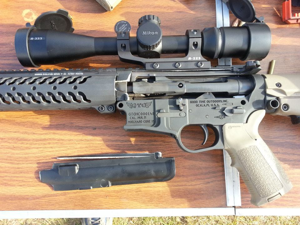

Half in: I know that certain .300BLK rounds will chamber and fire in a 5.56 gun despite early AAC protests to the contrary. Below is a 5.56 DD upper where the owner got his ammo mixed up and chambered a .300 round. The driving of the bullet back into the case upon chambering not only allowed the gun to lock and fire but also raised the chamber pressure through the roof as the pics show. The side of the receiver was blown out and the bolt was destroyed.

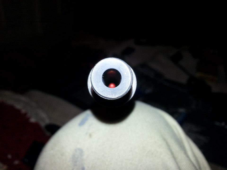

Half out: In this lower the bullet was stuck in the barrel, causing a considerable bulge. The SCAR 16 must be stronger than any portable rifle known to man to survive that. I can't see a single bullet leaving the barrel let alone two but hey you never know.
