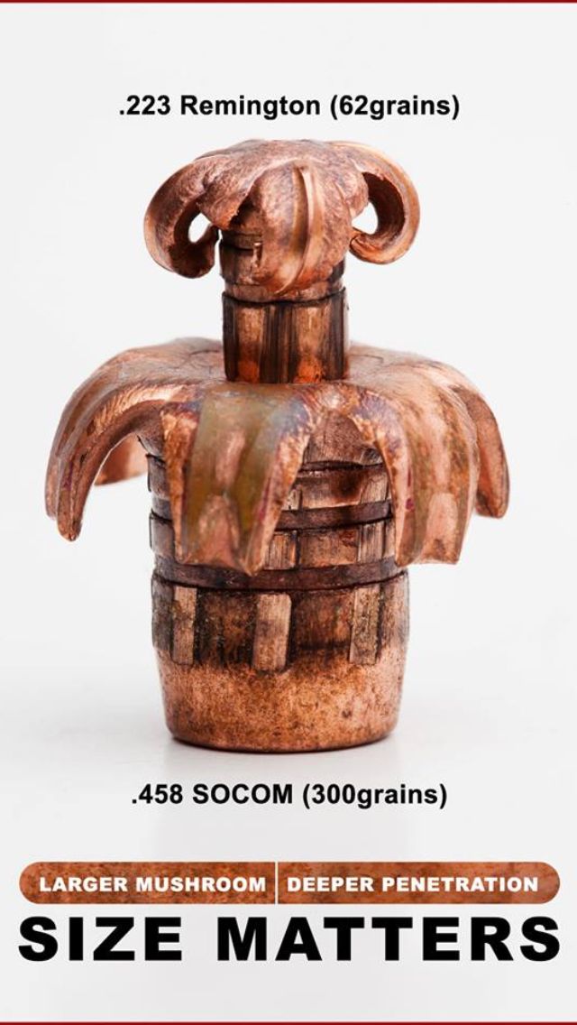

Well, I prefer .458 over the others in its class for bullet selection alone. Fuck SAAMI and her sister. 100gr aluminum hollowpoints to 500gr solids, it's versatile. Not to mention, normal use brass rarely needs to be trimmed. Even full length resizing every time!
Reactions: Franko

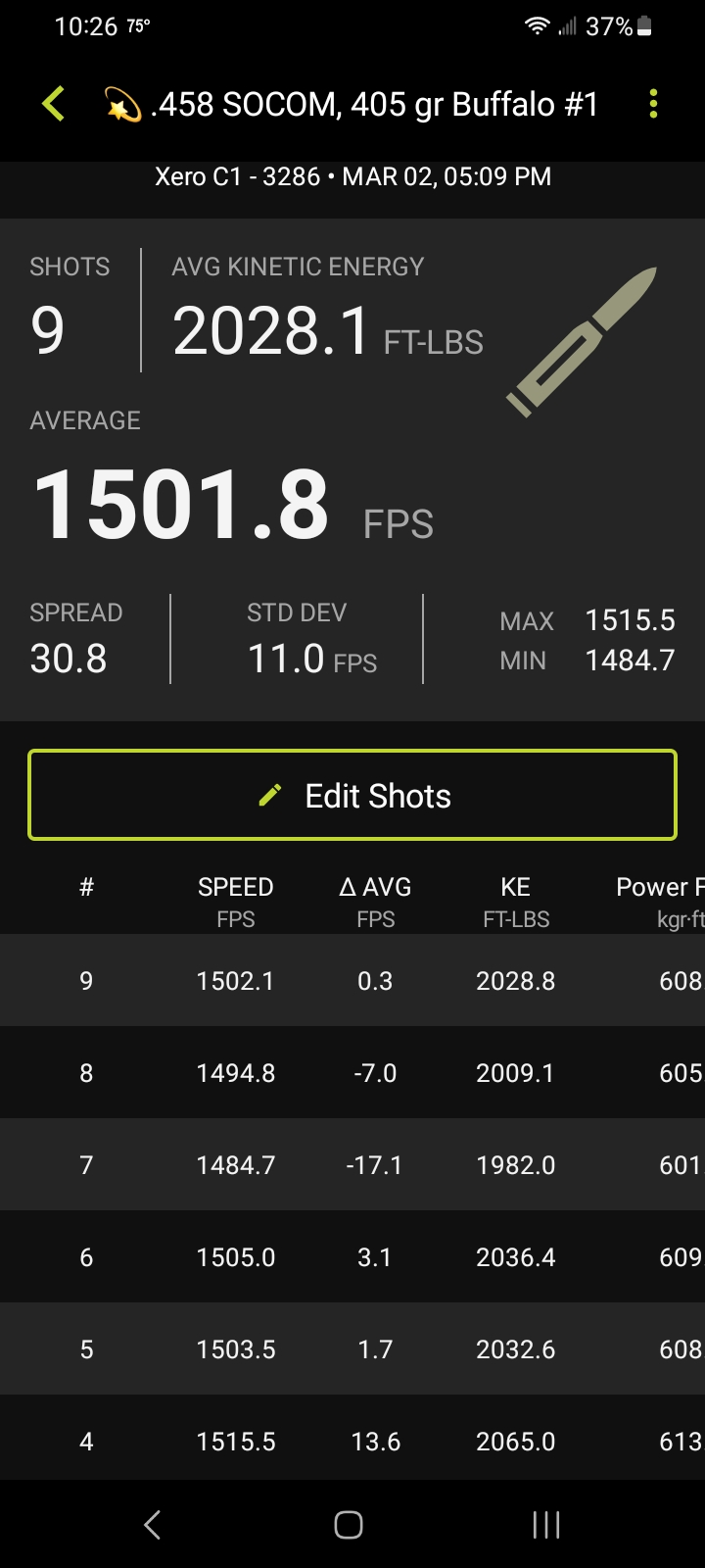

Missouri Bullet 405s are a nice plinking load at about 1500. 16" RRA. You can stuff 14 of them in a 40 rnd PMAG.
Reactions: Franko
