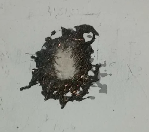

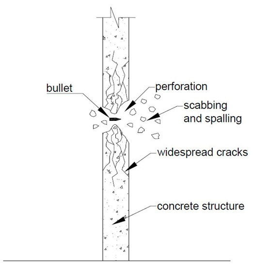

Lots of great recommendations here, I really appreciate it. That study on MDPI.com was very helpful. They only experimented with 1/4" and 1/2" long fibers, but found that steel fibers will make UPHC concrete bullet resistant in as thin as 2".
I can't logically speak to your concrete question, other than asking for fiber and UHPC concrete. It'll probably cost you 30 times more per yard. You'd be money ahead building with two 2x4 walls with AR steel between them. 8" of insulation would be nice too!
Semi-related, but if ever in a gun fight, just hide behind hay bales. I can't even get my 338 to make it through one in the long direction.
If you're building an elevated concrete floor, you have to consider your load strength.... The floor above will have load on top of the strength required to self support the concrete. I would look at pre-stressed concrete if it were my own install. It becomes part of the floor and would also allow for other materials if you wanted additional properties.
ETA: I wouldn't want a heavy floor overhead that was under-engineered or left any doubt about its strength. 4" concrete is NOT going to be strong enough before even considering any ballistic properties.

A high performing concrete using mid-range water reducing products will create a hardened (5000psi) barrier but that needs to be held together, reinforced. I'd use a healthy dose of Forta Fiber in it. When we remove concrete, that stuff is the most difficult.
I've used superplasticizers on a few thin table tops and shooting benches , I'm amazed how well it works and how hard the finished product is.
