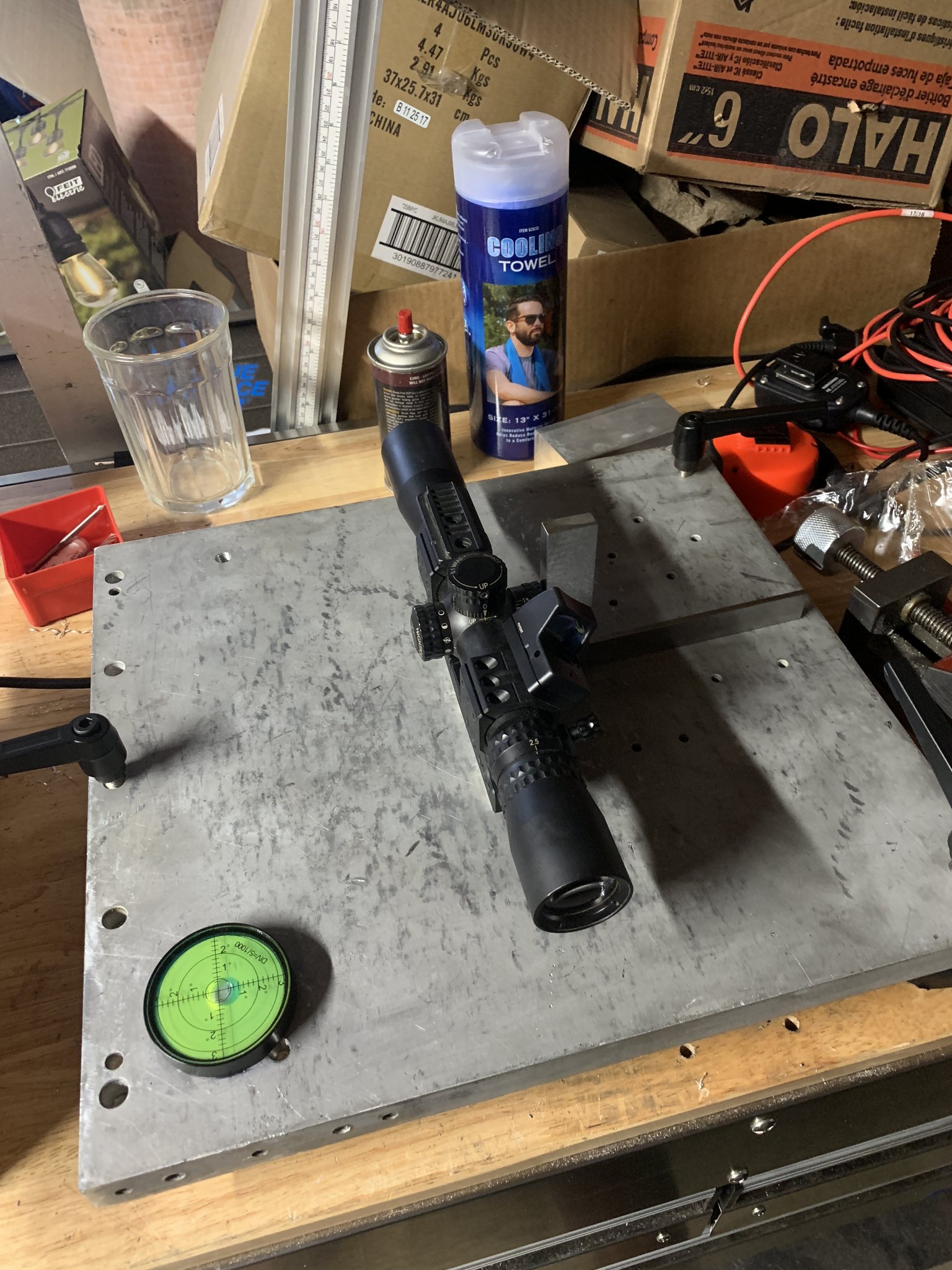

    It’s also why I have my own collimating table and resolution charts...and a giant free hanging tall target.
