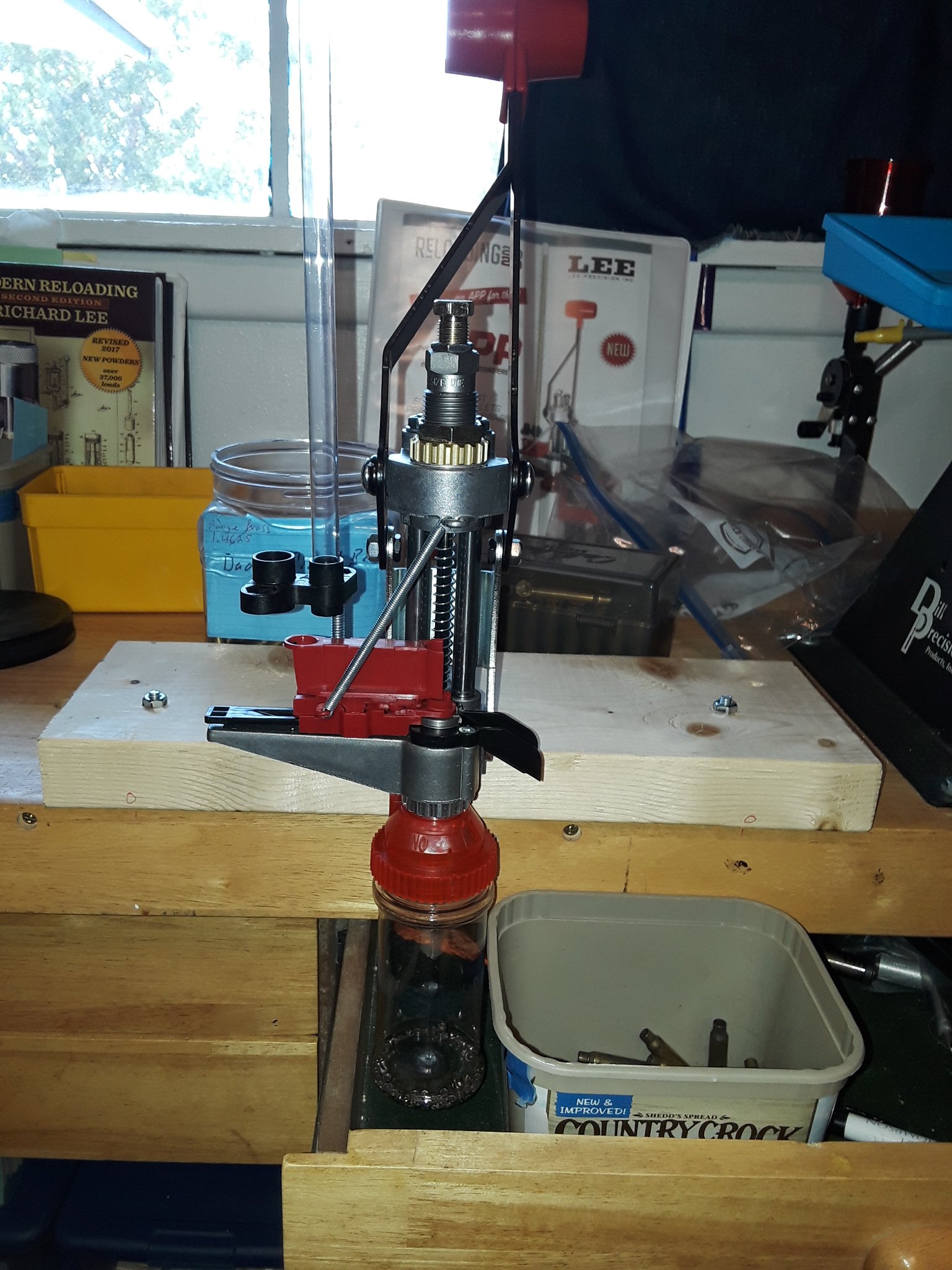

Fooled with lee app till I got it working on a temporary mount .
First time setup a pita but now have passed the initial trama.
Decapped using a readjusted 223 die instead of universal that was too tall.
It was fast and my old hands got less wear on them, the short stroke took less shoulder movements.
I reload for my family and at times a fair ammount so any shortcuts or ergonomics helps my old hands.
Looking to next die setup, maybe 223 flsd with expander removed ?
The federal primers fit fc brass better I finnaly found out.

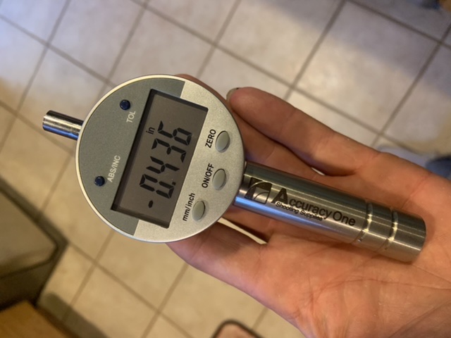

If I ever get though with the flash holes in this fc 308 brass will see if the sizing pin in my collet die less collet will bring my necks up .0005 or .001.
Been running .003 nt in fc brass and would like .002 . Sinclair mandrell still on back order.

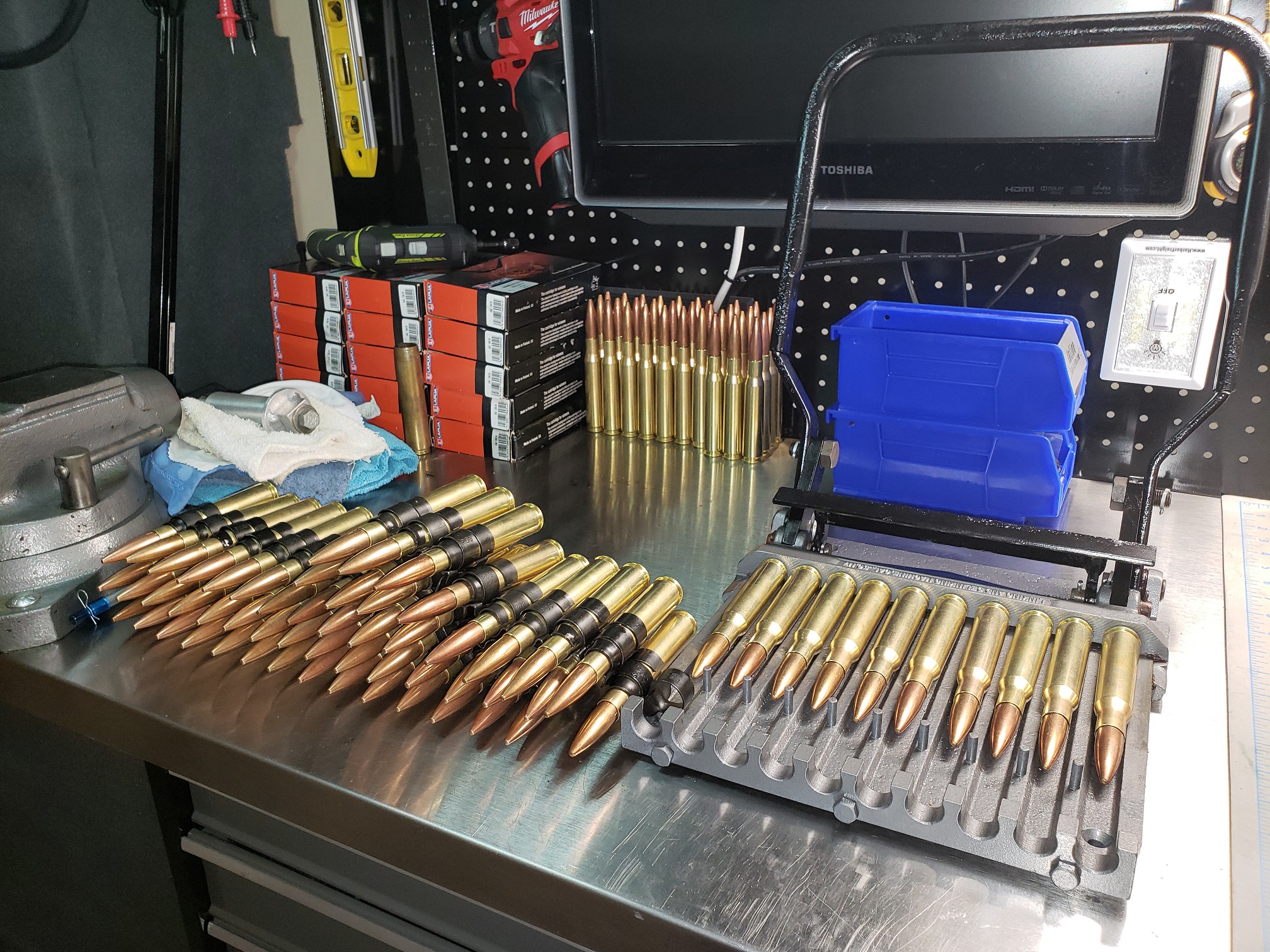

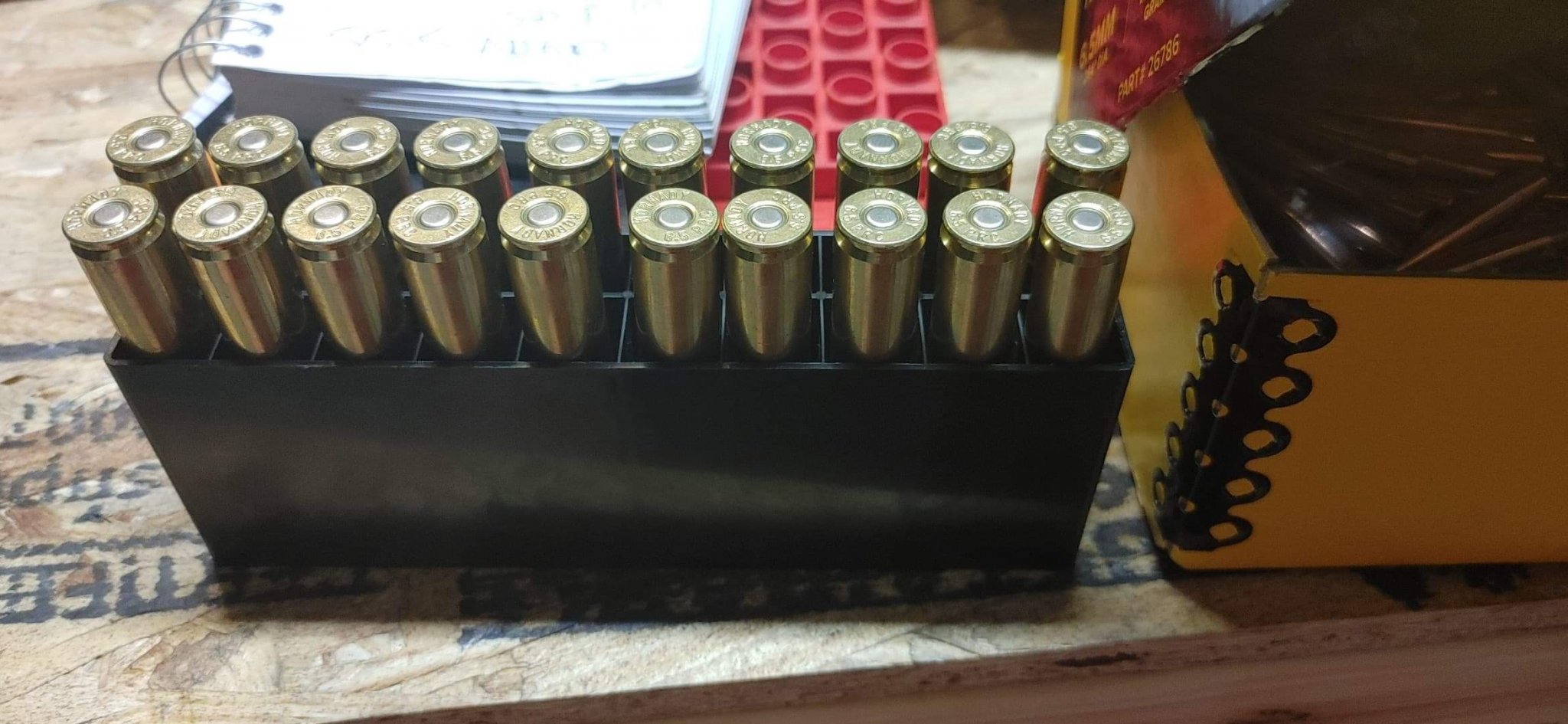

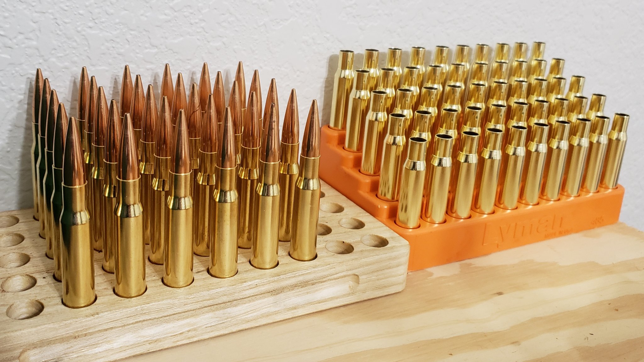

Whipped up 25 rounds of .338LM for the weekend as I revisit the 300gr SMKs. As an aside I also learned that a discarded Lego ain't got shit on a spent primer when it gets away from you and find it later barefooted!

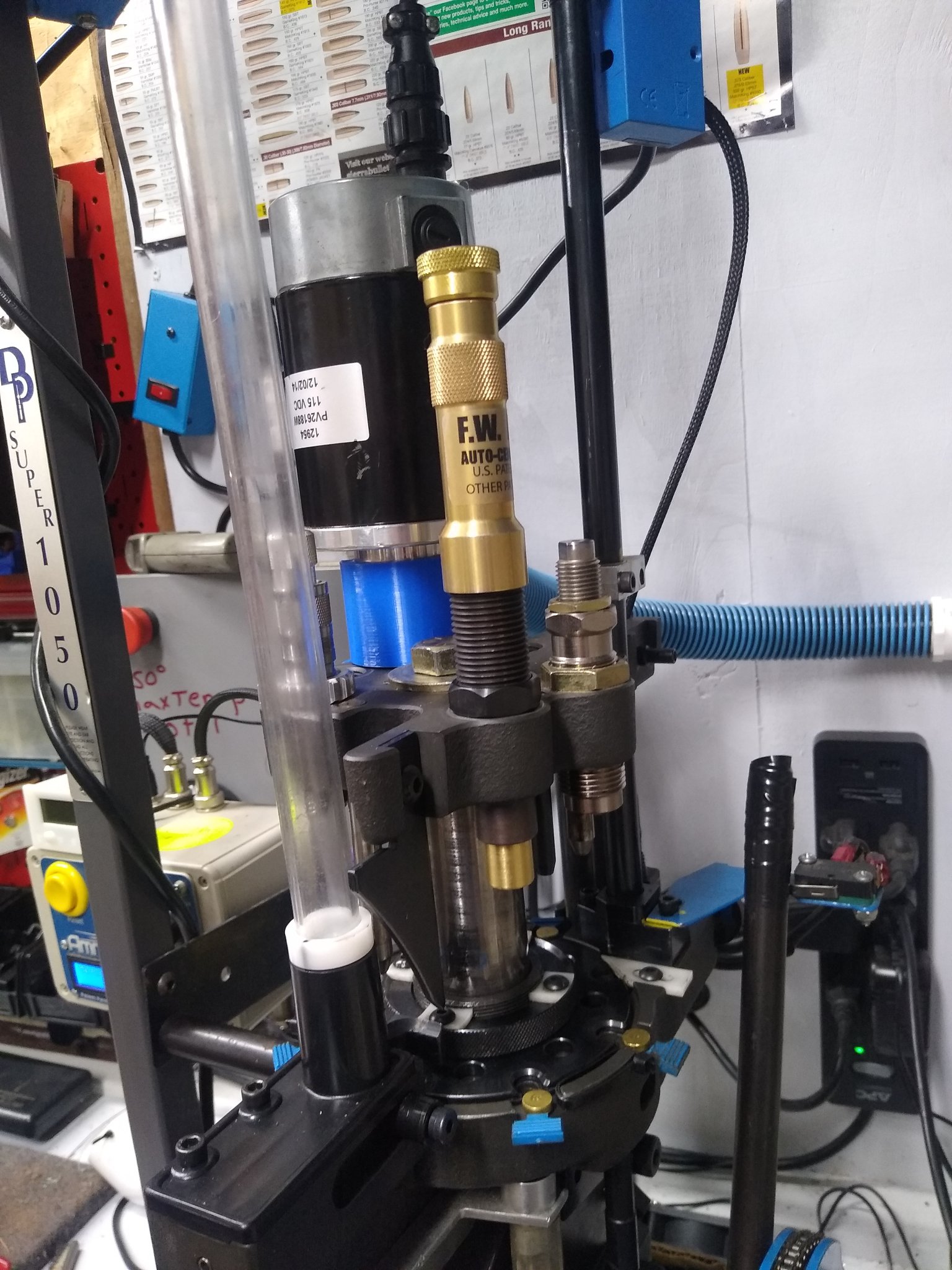

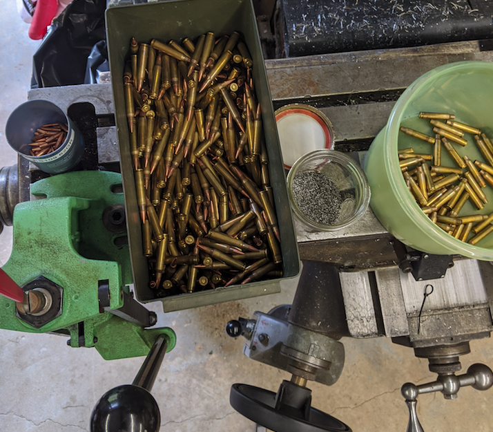

Started pulling apart about 1400 .223 practice ammo I loaded for the daughter’s AR.
My first time w/ progressive press, messed up on the resize (too long).
I found out that it is possible to quickly turn out large amounts of unsafe ammo.
Frankford Arsenal came out with a good bullet pulling tool recently. Ain’t no way I’d be doing all that with a hammer.

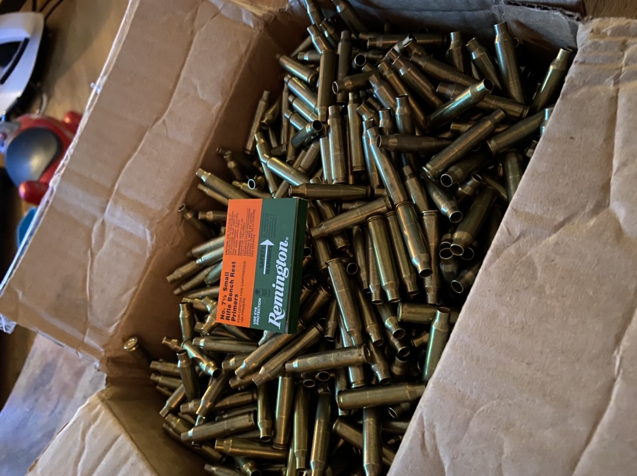

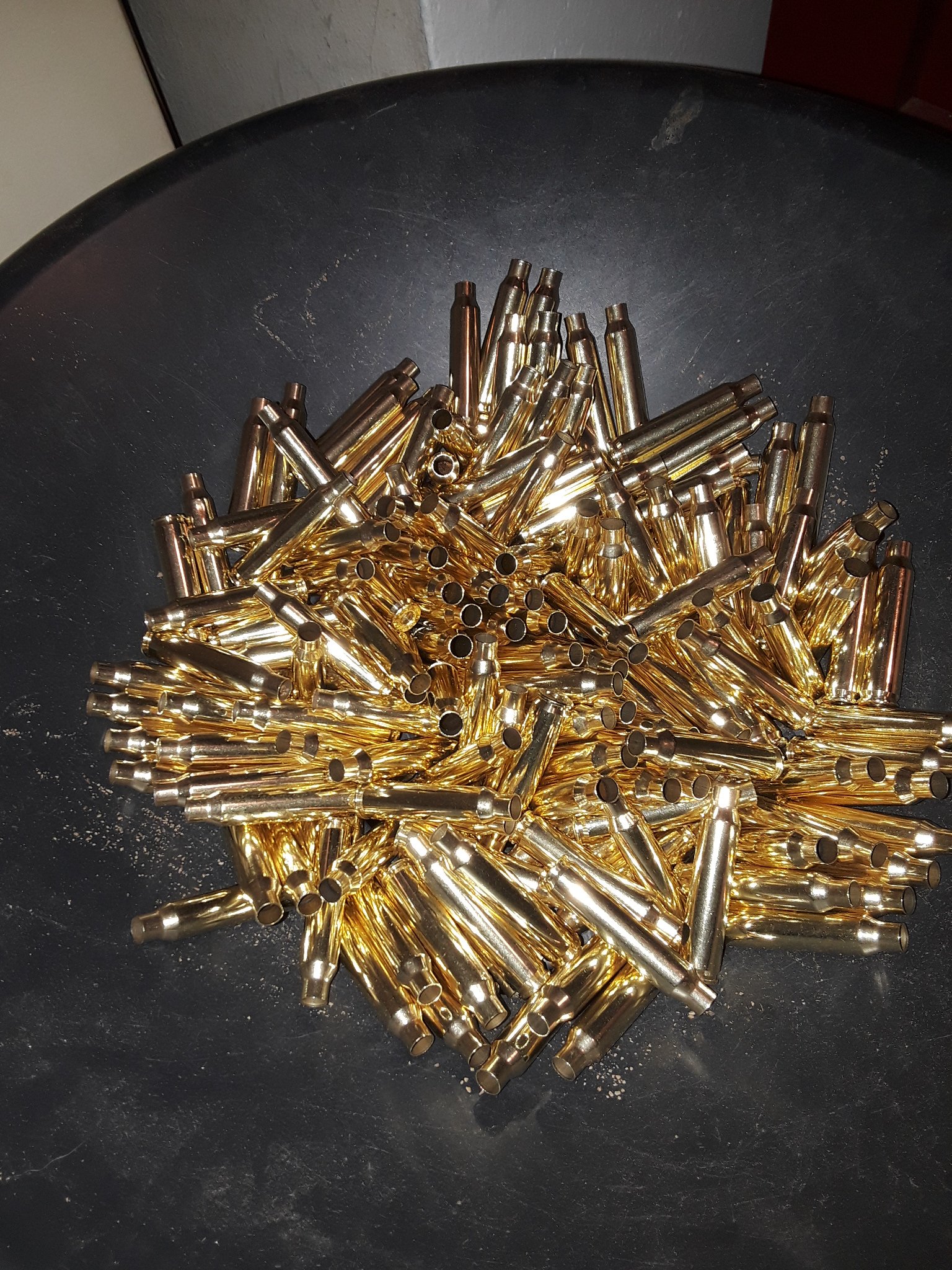

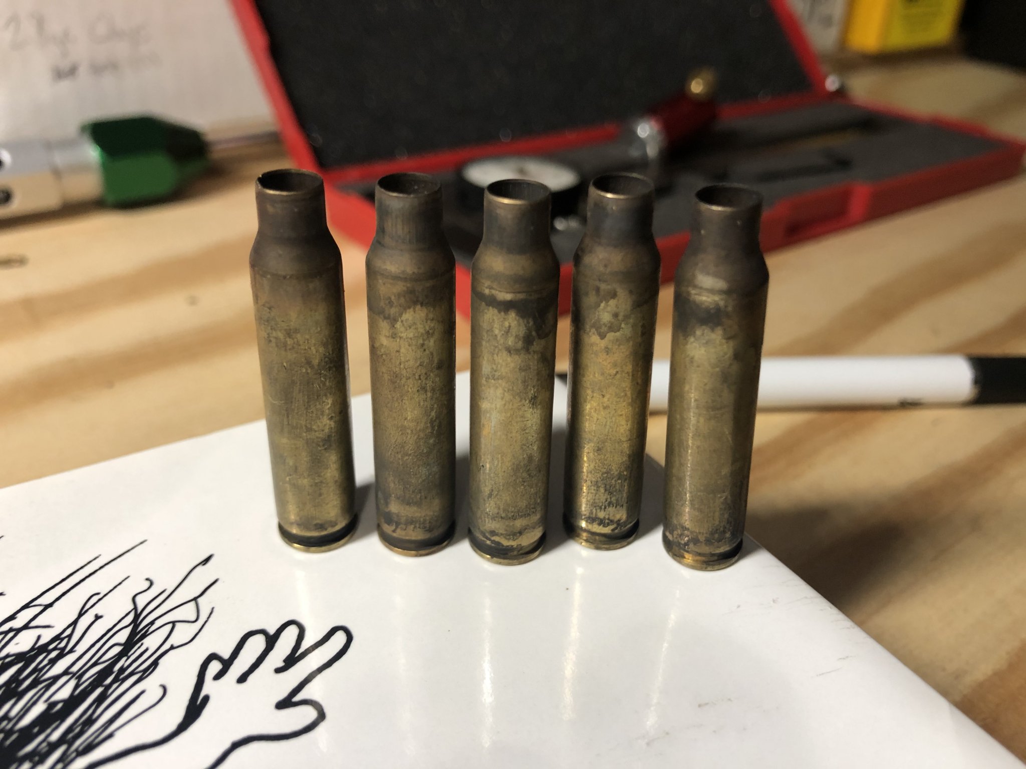

Sorted a couple thousand pieces of 223 brass and pulled out the frontier/LC brass.

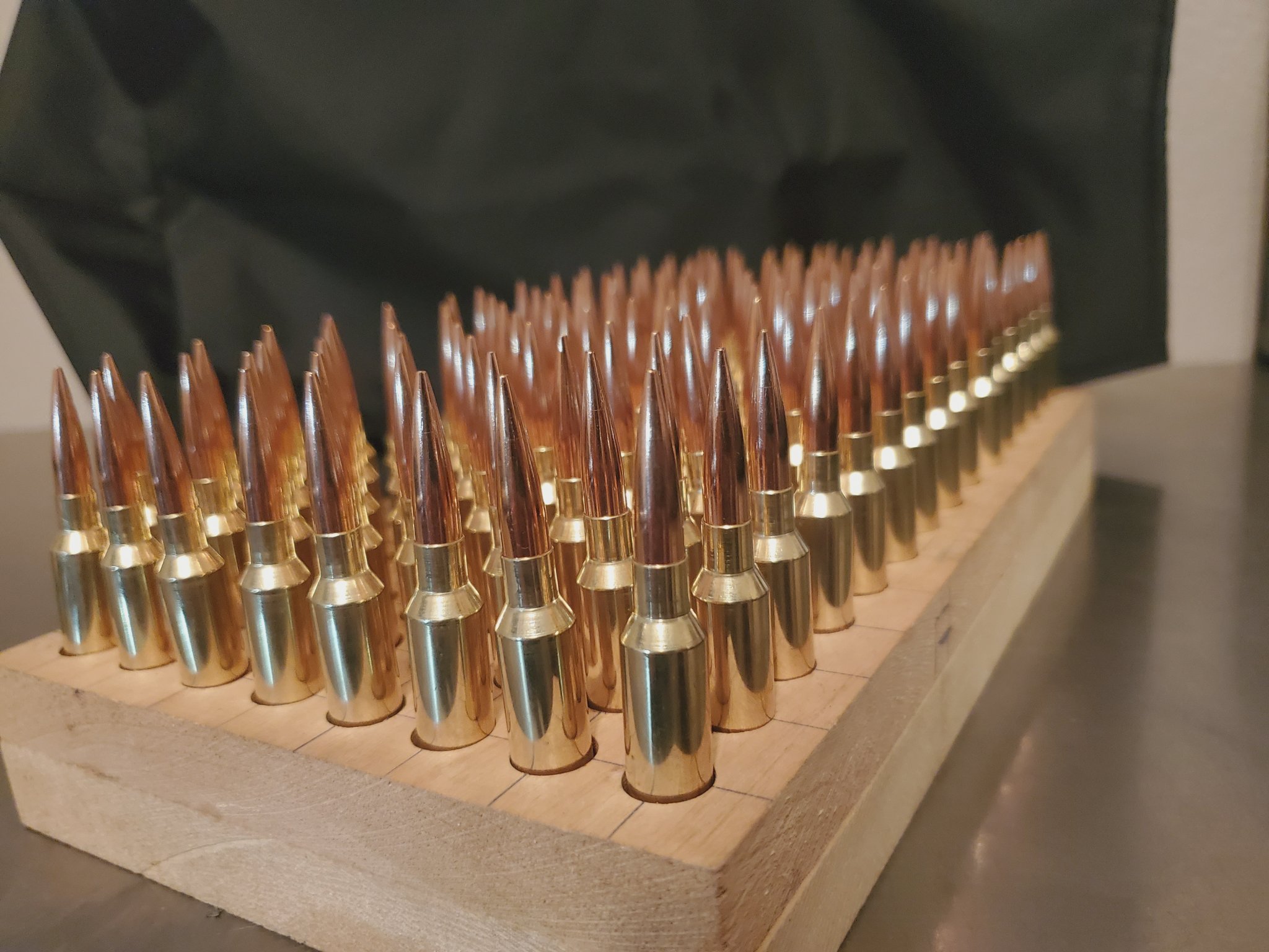

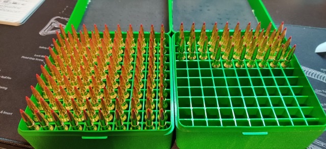

loaded 60 rounds of my IMI razor core load clone. 77smk over 24.8 of AA2520. Would load more but these scarce times I don’t want to burn through my primers too quick.

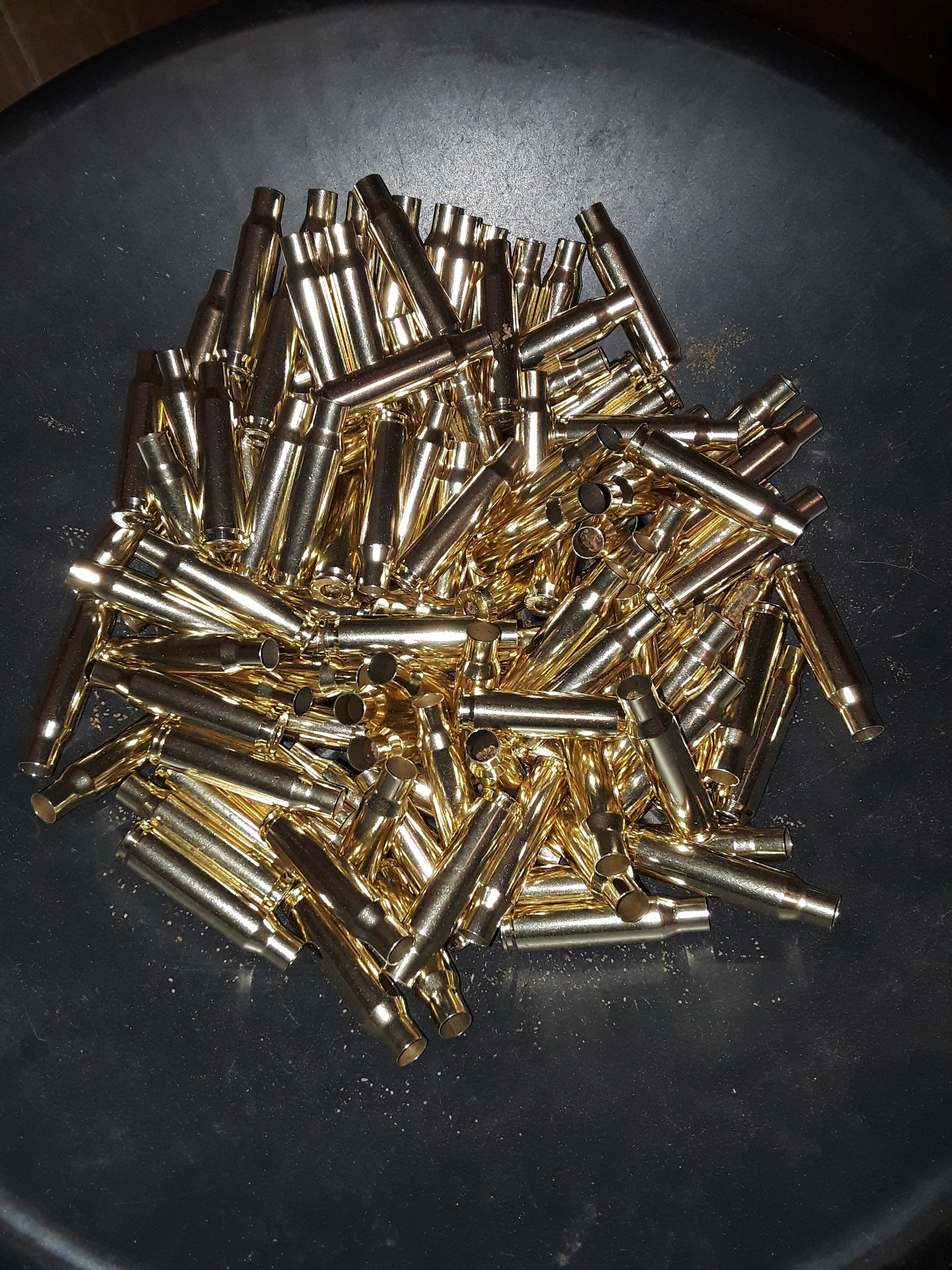

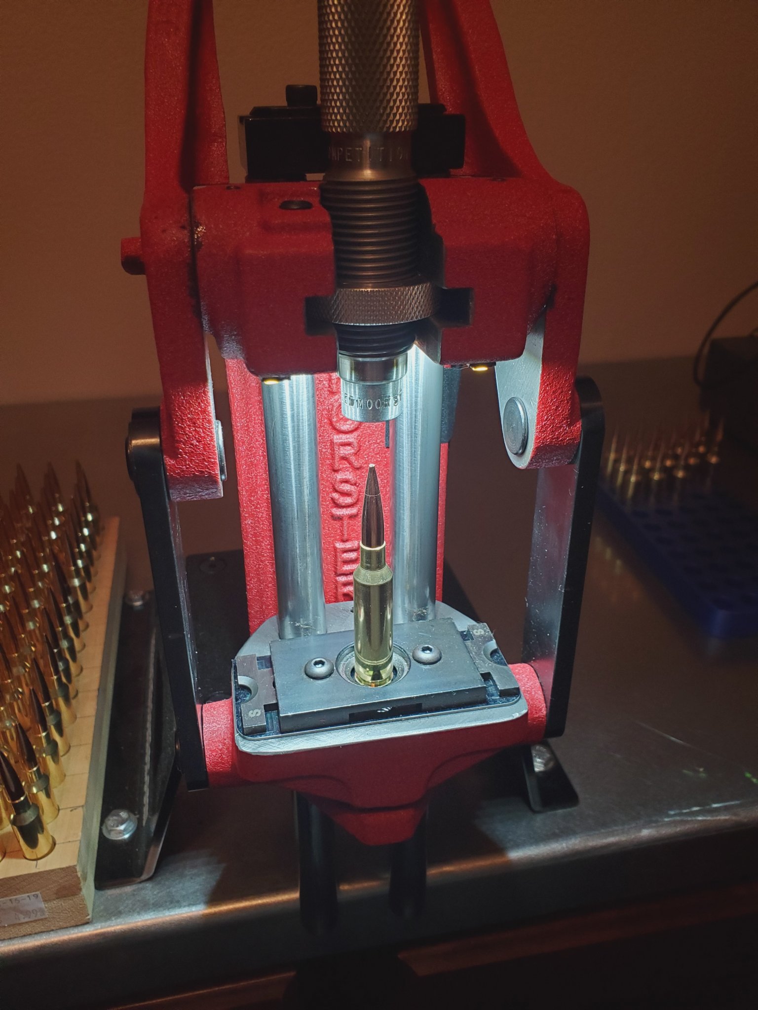

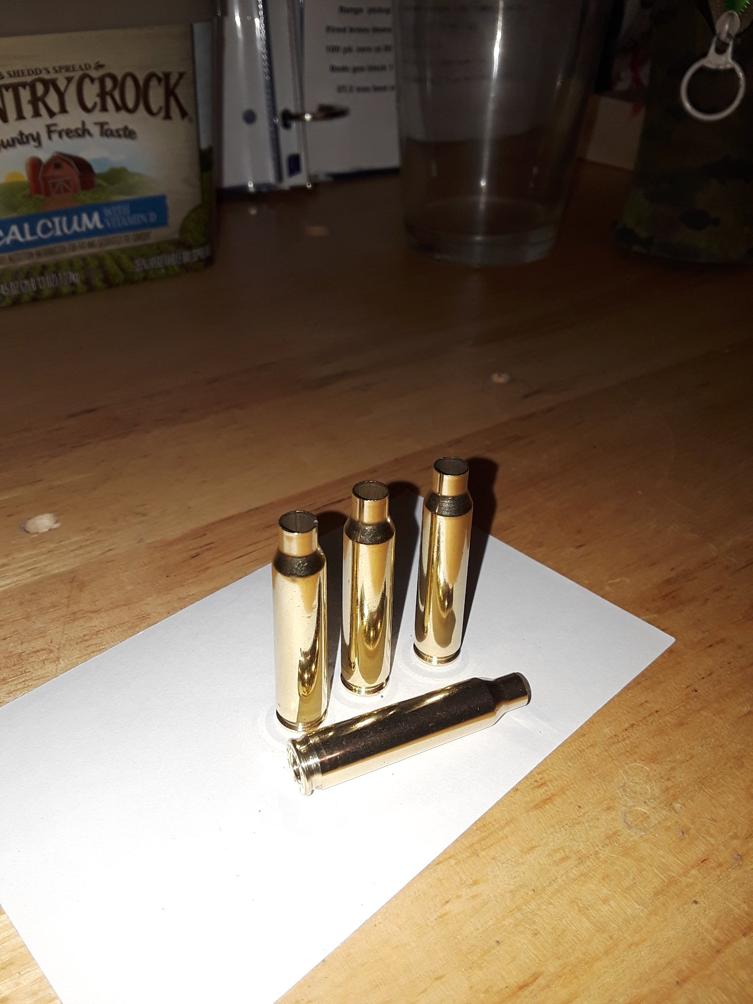

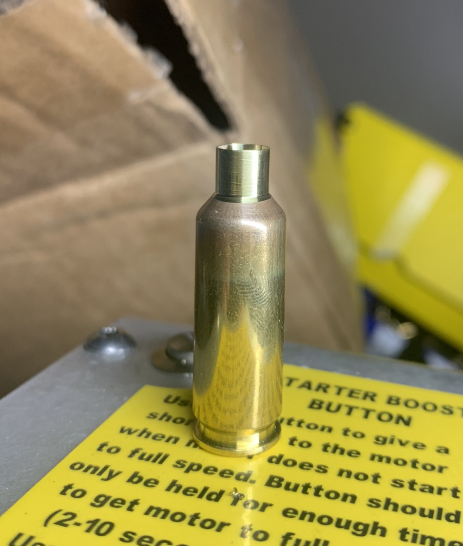

Neck turned, sized, tumbled and primed some Lapua 30-06. Also loaded a test set with 185 Berger Hybrids over H4350.

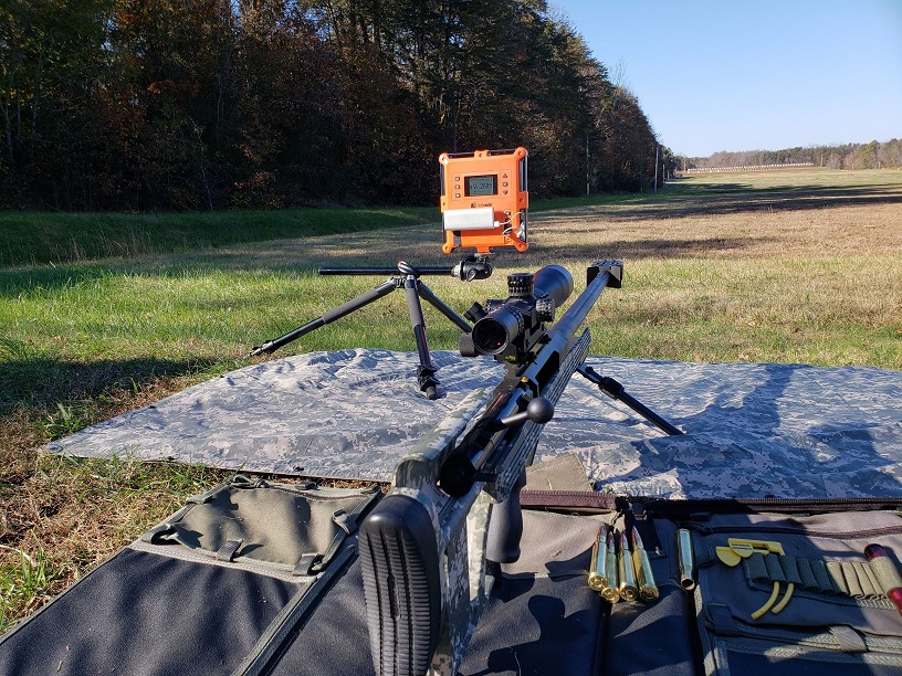

This past weekend I only had access to 100 yards on family land, so I shot a quick 10 round ladder with the 185s and H4350. 10 rounds measured 1.3 inches, even though the powder ranged from 53.9 to 57.5.
This weekend I'll pin point the node, then hit the long range steel at Triple C.

Fireformed another 50 brass for a competition rifle. Next is to turn the necks, anneal them, size and load them back up with the match load. 215 rounds down my .224" barrel and the throat/rifling looks fine for now according to the bore scope. If I'm lucky I can baby this barrel burrner for 2000 rounds before a set-back or re-barrel.
^^^^^ Yeah, I've been told that before so it must be true, not much else to tell. I have been shopping for a M2HB for about a year now and stumbled onto the linker and links so I bought them to motivate me. I currently only have a single shot Armalite AR-50 that I have used in a couple of competitions but I continue to load up AP, API, APIT and Spotter/Tracers for fun.

Out of 600 to 800 box of 223 range brass salvaged 172 pcs of fc for my current plinker load.
Pockets cleaned and reamed, sized and hit the tumbler a second time since deprimed.
Say what you want but this pretty sexy for 223 range brass.
I'm to sexy for my brass.
Forster makes a collet device for pulling bullets, 7/8x14, fits in a single stage press. If you replace the threaded rod with a longer one and grease the collet and the nut that compresses the collet, you can go pretty fast. I recently reloaded about 1,000 rounds of 308. I took it apart saving the primed cases, powder, and bullets. I polished, lubed, resized, and re-polished the cases and reloaded with a different powder charge. I needed to push back the shoulders and change the powder charge. Somewhat to my surprise, it shoots about the same as my other precision 308. I should probably use this when I shoot movers and improvised positions but if I need ammo for prone/bipod, it works.

Over many days and in front of the TV, 1k pieces of 223 tumbled, sized, tumbled, trimmed, chamfered, deburred, primer crimp removed, and now primed and ready to load. Fuck that was way more work than I was anticipating.
Woof. I’ve done almost 3k this year, and have another 1k to do... Giraud tri-way and reaming the crimps helps but it’s just a lot
Question about that 223 brass, cleaned up just fine after the first run through the wet tumbler, but after spraying with hornady one shot, sized, then wet tumbled again with pins, dawn, and citric acid the problem is that after that last tumble the brass is NOT clean. It’s definitely got a black residue on it. My finger are black af after working with the brass and you can wipe the brass and the shmoo smearing around. Wtf do I do to clean in? It will come off with a Towel just fine but I’m not going to individual clean the brass. Any ideas?
