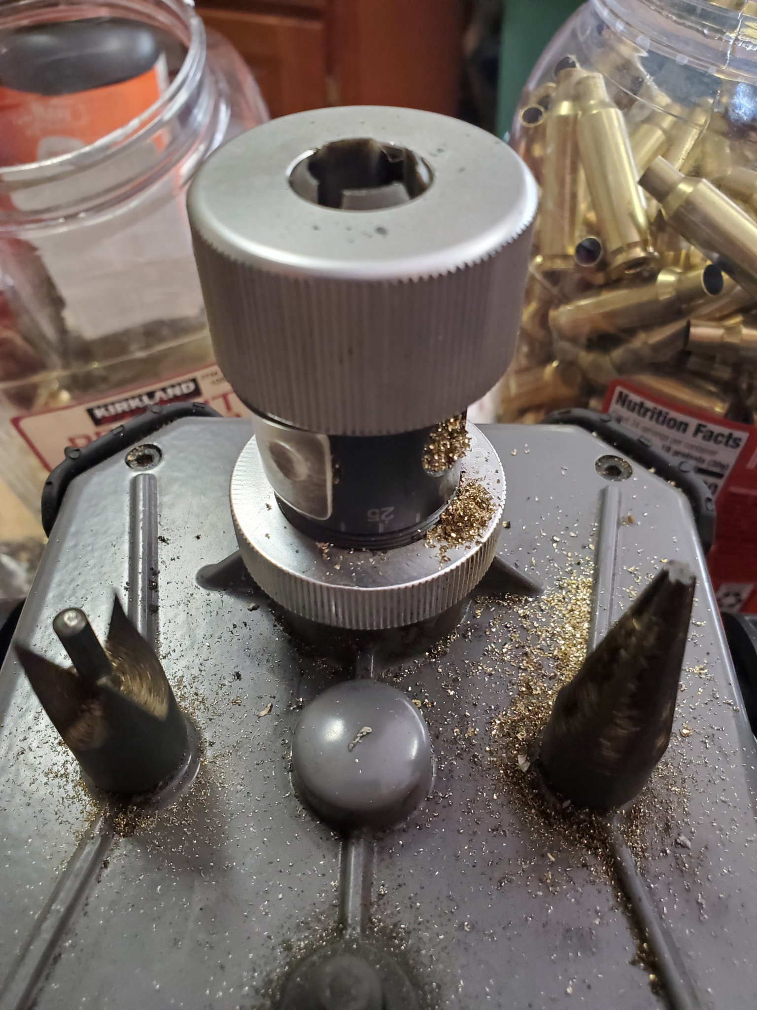

Figured out that all my federal 223 range brass has stingy primer pockets.
So to get cci primers to seat the way they should they were reamed, swaged and uniformed.
Primers were coming out .0005 to .001 above flush.
Interesting that removed shavings from uniformed brass amounted to next to nothing but now they seat well in the dillon on a few test pieces.

Tomorrow I move the drill press into the basement to set up for uniforming primer pockets. Primers, RL22, and SMKs at the ready.

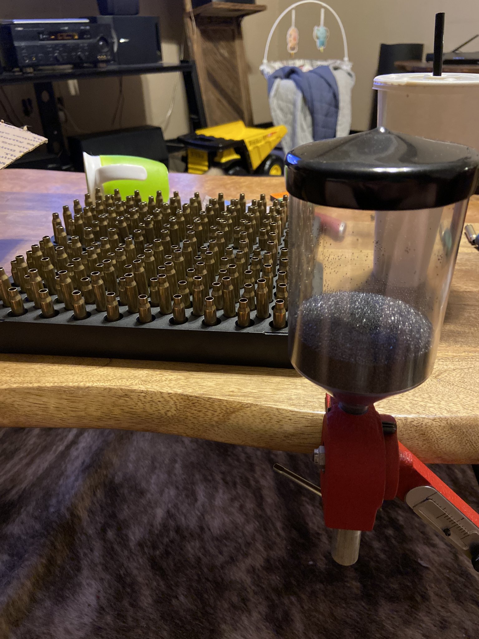

played with my new Forster bench rest Powder measure. Not sure I love it. If you are doing the same charge And never changing it I’m sure it’s fine, but getting it to the exact powder charge you want down to .1gr is a major pita. This thing has 0 fine adjustment making it a PITA dial the charge in perfectly

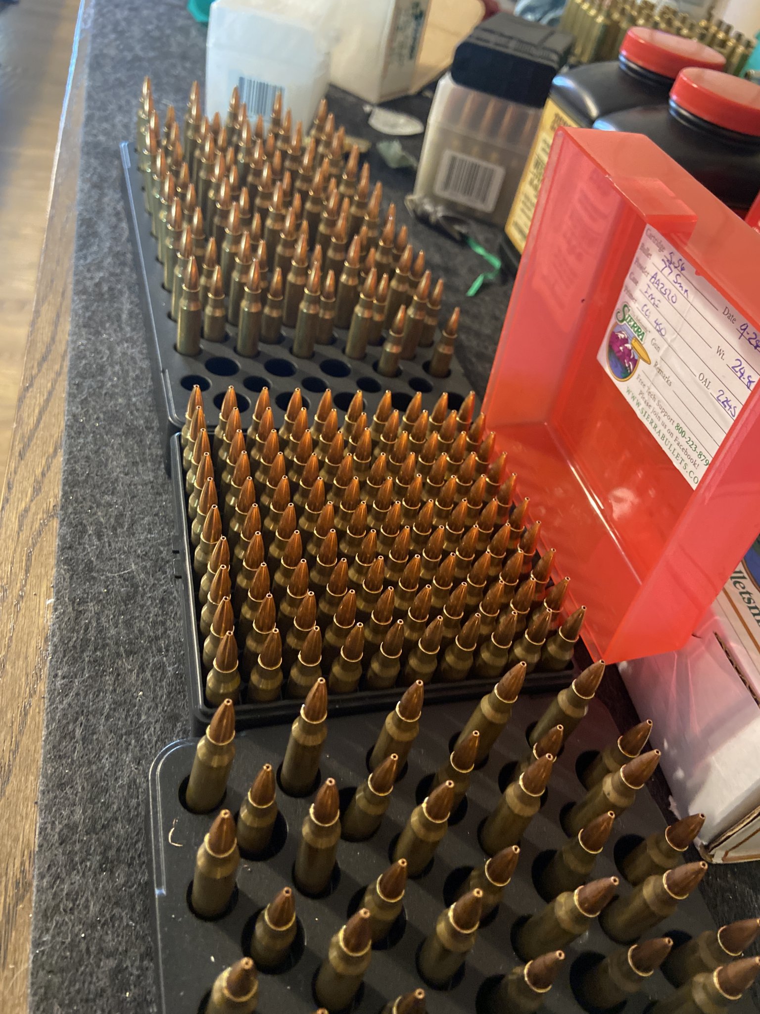

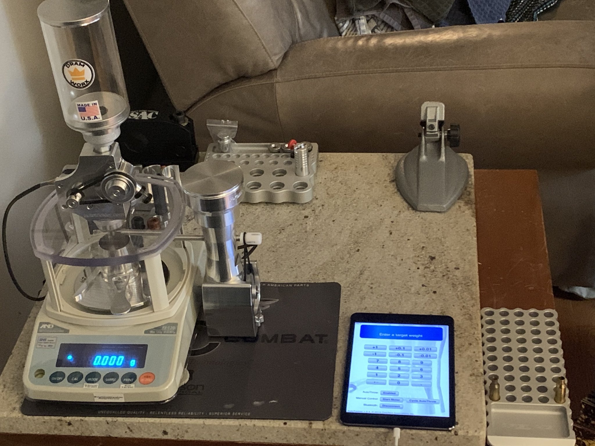

threw charges and loaded those 250 rounds with a 77smk

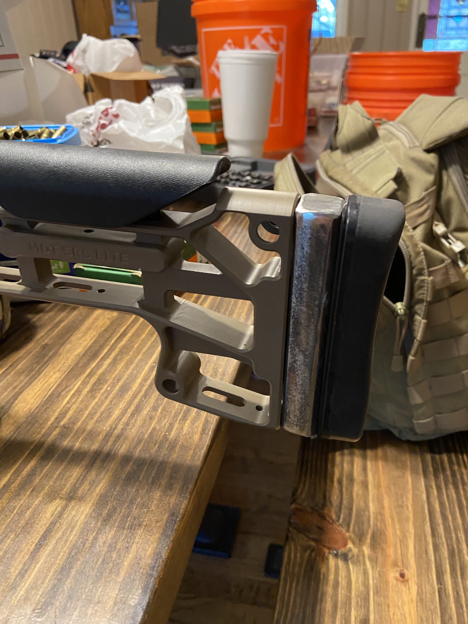

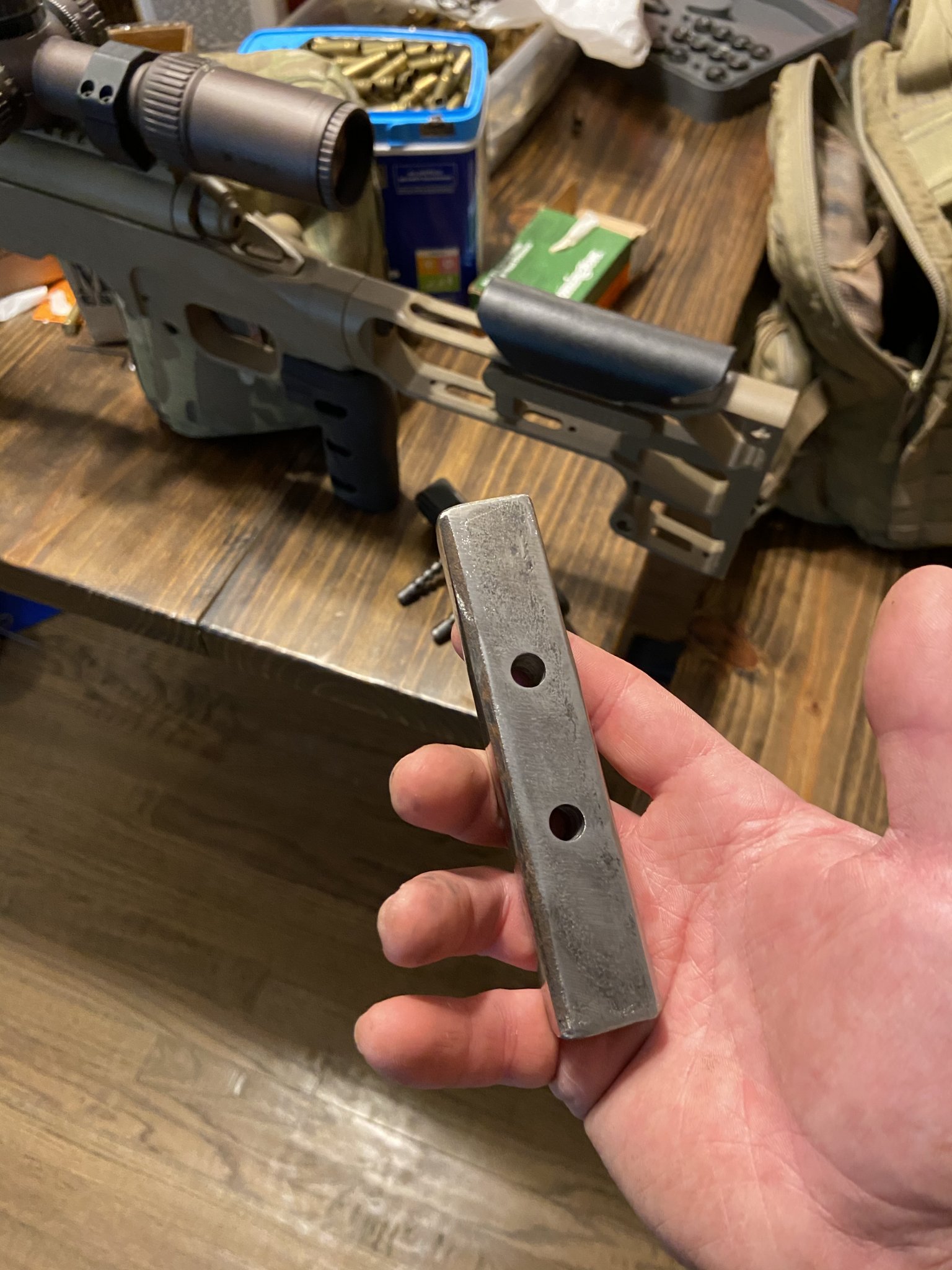

spent 30 min the garage and made this buttstock weight for my mdt chassis. Used 3/4” plate steel. Came out to 14oz. Did paint it black after I took the pic

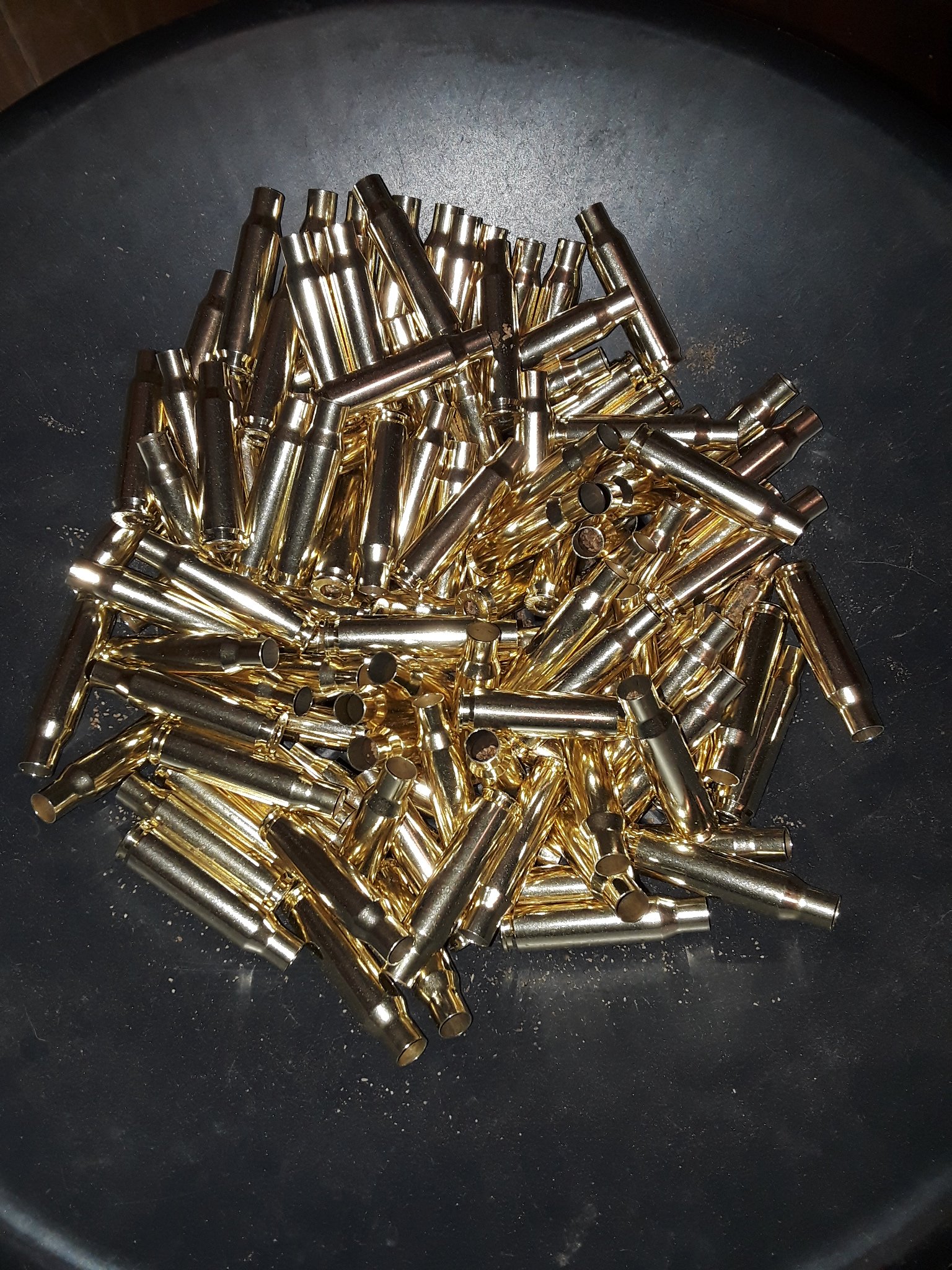

Ever facepalm so hard you spill a little coffee? I've been doing this wrong for years - I have the hornady case tumbler and I knew the little filter thing fit over a 5gal bucket and was roughly the size of the tumbler bowl but never put two and two together... I've been shaking it by hand and tapping brass together to get the bits of media...

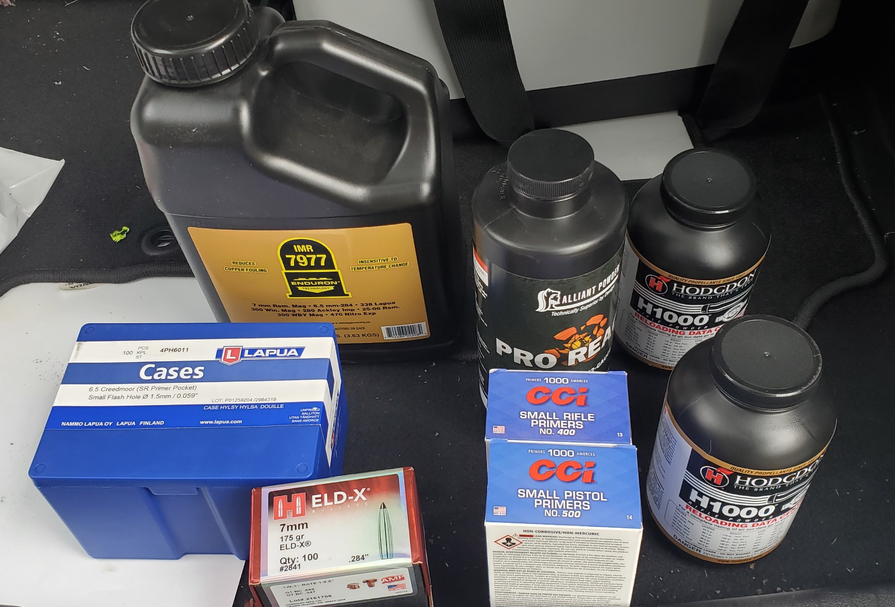

Bit the bullet and ordered a henderson trimmer yesterday, today I'll finish the .223 I prepped and load up some 52gr berger targets over AA2230, with some for the chrono and some to test seating depth. I was running 8208 but my load produced quite a bit of crunch on seating and I think I had some 'grow' into the lands after sitting for six months...

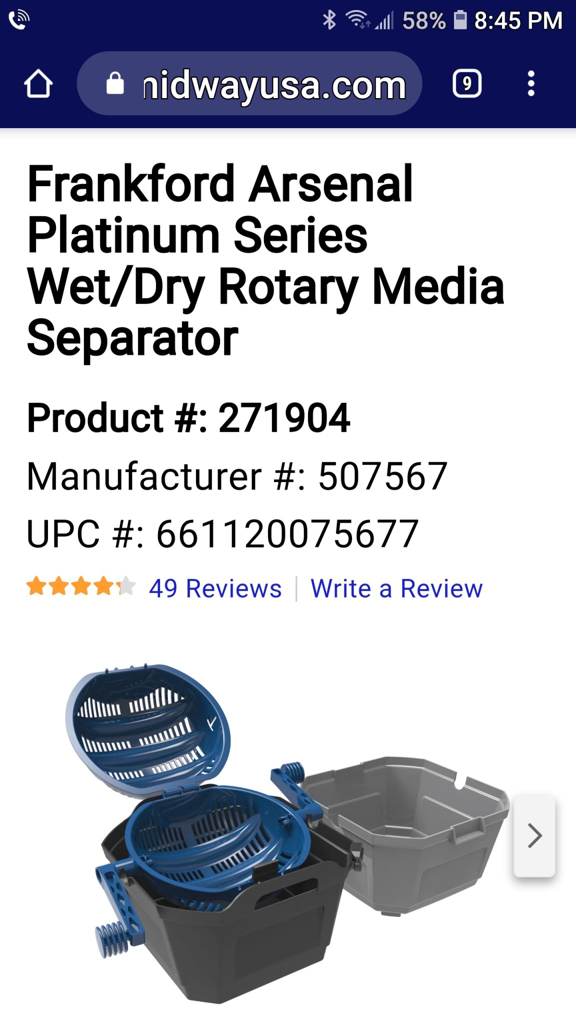

I've had the original Cabelas version of this for over 20 years.
Makes seperating the media a 30 second deal.
I've always looked at those, but also my biggest issue is getting the media out of the flash holes.
I've got an ultrasonic cleaner I use for parts, and some more boretech product on the way; so that's something I'm going to try instead.

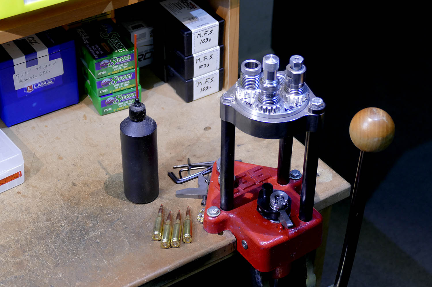

Reorganized my small amount of shelving to accommodate my new caliber.. Still collecting bullets and everything else, too.
('M. F. S.' = Midway factory-seconds'.
They all look better than that in Midway's pic.)

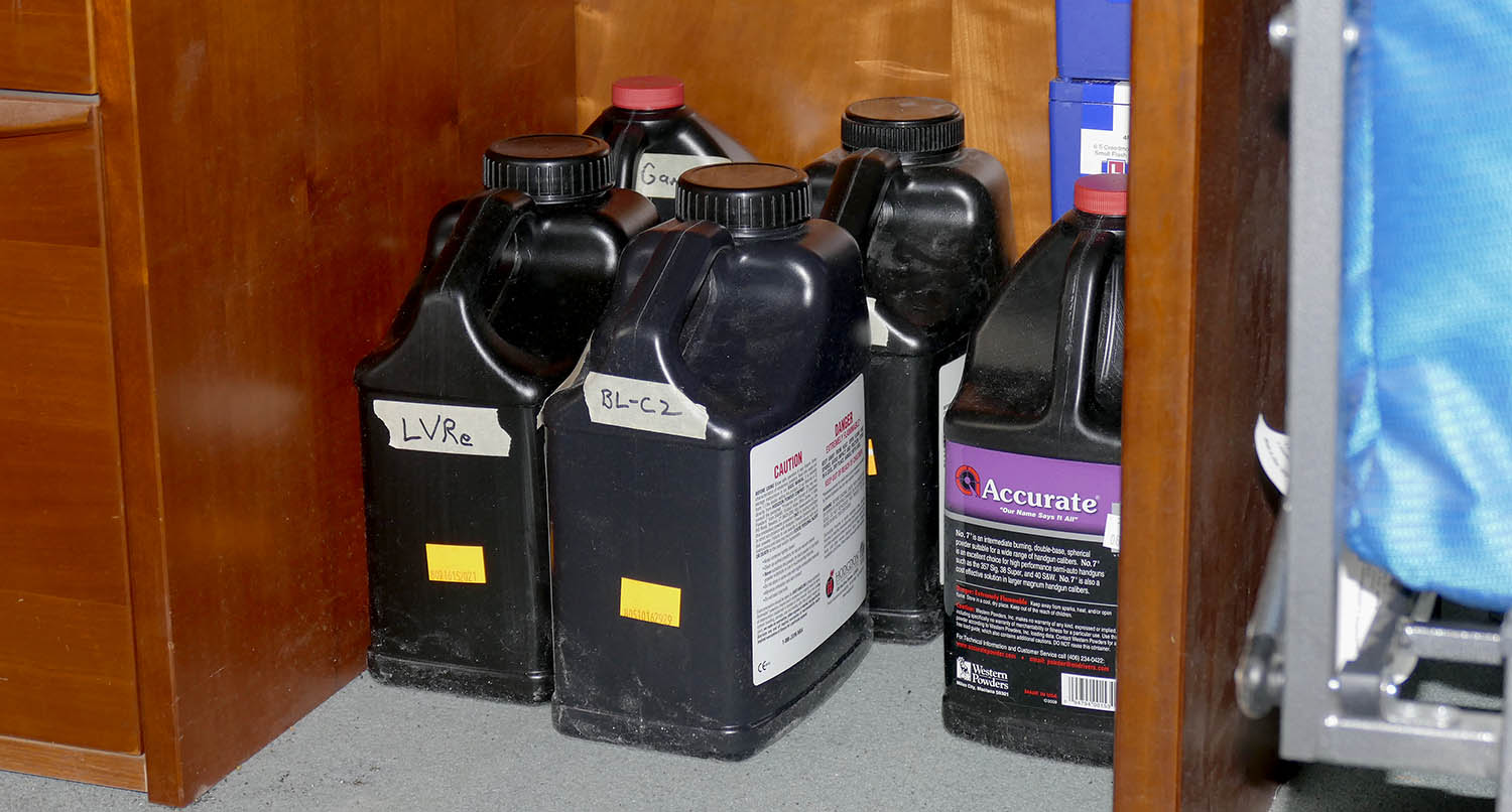

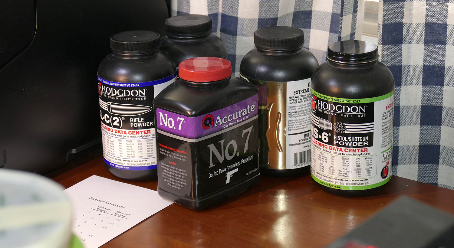

Inventoried and sorted my dozens of powders to sell some...
...(had 29 bottle/jugs) and concentrate on what I might use.

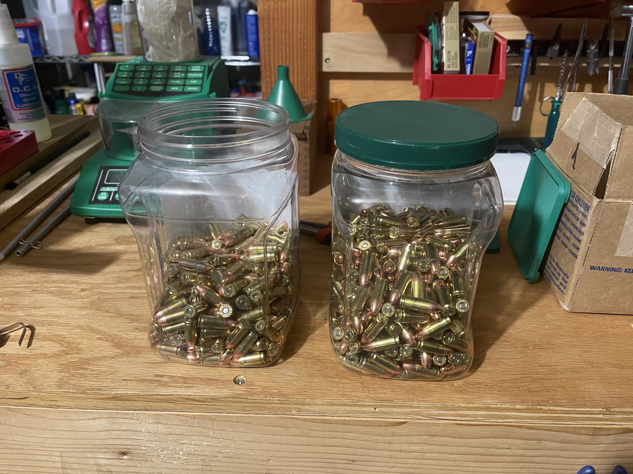

Finishing a couple hundred rounds of 223 brass I had prepped.
Half allready walked out the door with my sons to the range.
Jesus it was still warm from the dillon.

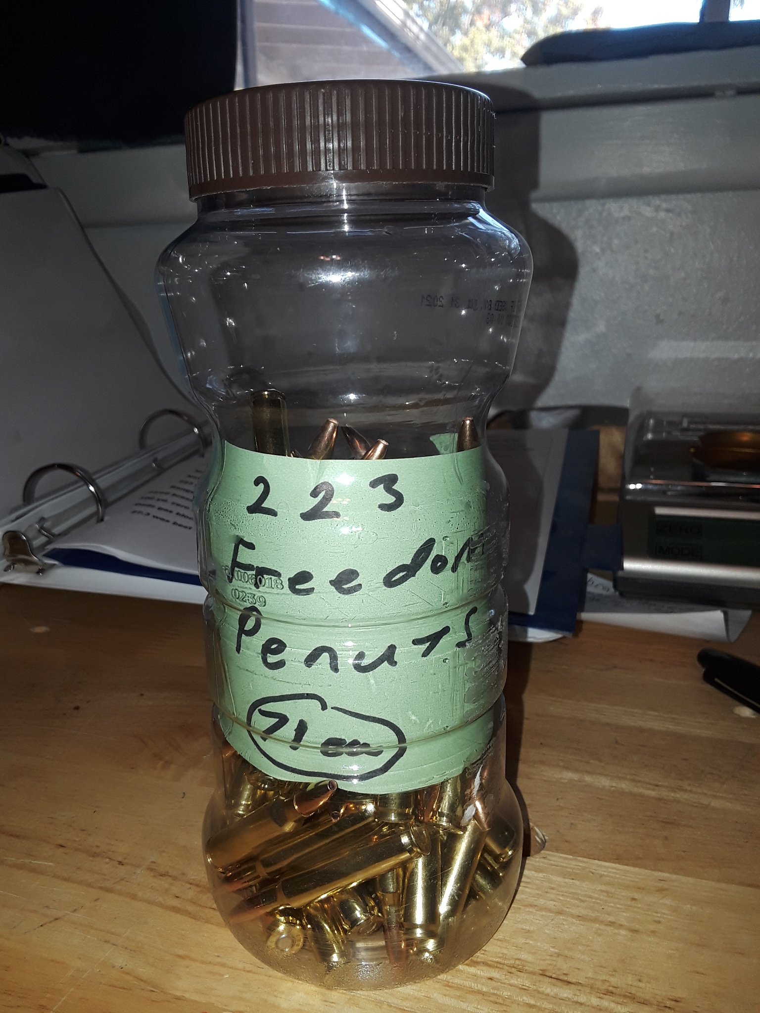

Anyway a recently found free storage unit that holds 2 mags worth, 60 rounds.
Wallmart dog food container.
How about freedom peanuts.
Will fit side pockets of ruck.

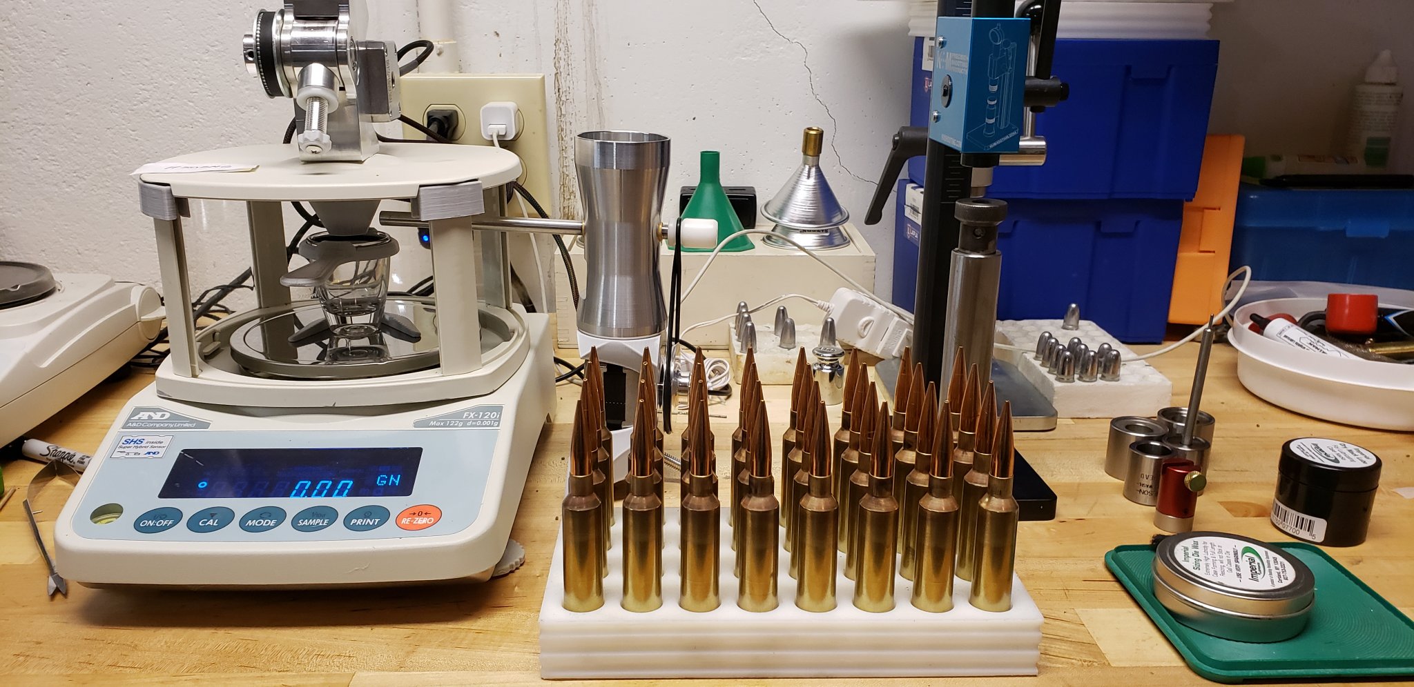

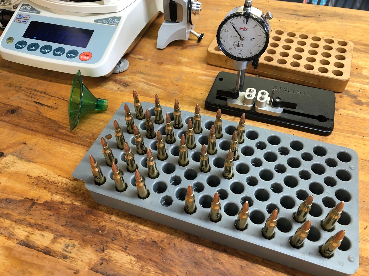

I painstakingly loaded some .22 caliber ammo to go shoot at ~1k yards 'cause some DB called me out on my obsolete cartridge sucking for long range:
tumbled brass
body sized
neck-sized/decapped
annealed
weighed primers
re-primed/mandrel-expanded
trickled powder charge
seated bullets.
Total PITA, but nets .59MOA at 525 yards and .75MOA at 965 yards which does not suck for a .22.
jeffreybehr Dies are but a part and once in a while I will take the de-capping pin out and give it a massage with worn out steel wool Needs a shot of carb cleaner, little carbon here, get those threads, and where the whole thing screws in. It may be standard maintaince for you?
Never lose your settings!!, tighten them down now that the things are clean and tools fit, and use good lube and cleaners. Check the vent hole and blow everything clean to include the top of the press the dies screw into.
I go down to the Veteranarian's place and get good Q-type tips cheap. You don't need too many. Nice long sticks. Cleans out up in the chamber area, throat---
Depending on how many sizings you go through it may last you 60 years with rounds you shoot where I load a few a week and need to do this once in a while. Things just run smoother for me.
It seems like everything man has come up with, it seems to work best when clean and properly lubricated. Everything along the way gets dirty with carbon and brass so after a while, clean them out and see if things don't go smoother for you.
It is amazing what you find in the throats and threads of dies with those neat Q-tips. Best to just keep them clean IMHO
Reactions: camocorvette
Thank you; I might try that. :)
jeffreybehr. Your press looks good and clean now.
As I mentioned above, the dies are but a link in the chain, the link where the work is taking place, where things get dirty, not on our shiney outsides.
You clean your brass and then run it through the die and as the exp. ball is coming out it brings a little carbon and maybe a very small chip of brass from the case mouth with it. Most of it drops out of the bottom but with a little lube still in the die some shit can collect there too then you start getting scratched brass etc. I just try to stay ahead of that so I very seldom have to polish a die because of scratchs from debris on re-sized brass, but I have polished a die or 20.
I too have been reloading for about 60 years and have made more than my share of fuck-ups and mistakes.
I don't clean the dies a lot, just when I think they need it or something is hanging up a bit or I have everything loaded, sitting at the bench and wondering WTF else can I do? I am bored.
Clean one of the sizing dies you use the most often and see what comes out of it. You may be suprised. I would bet it works better for you and don't forget to clean out the vent hole. If you use spray cleaner, or an air hose, catch it in your hand as best you can and let me know what you found. FM

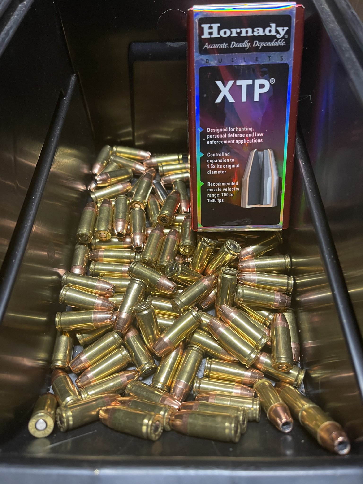

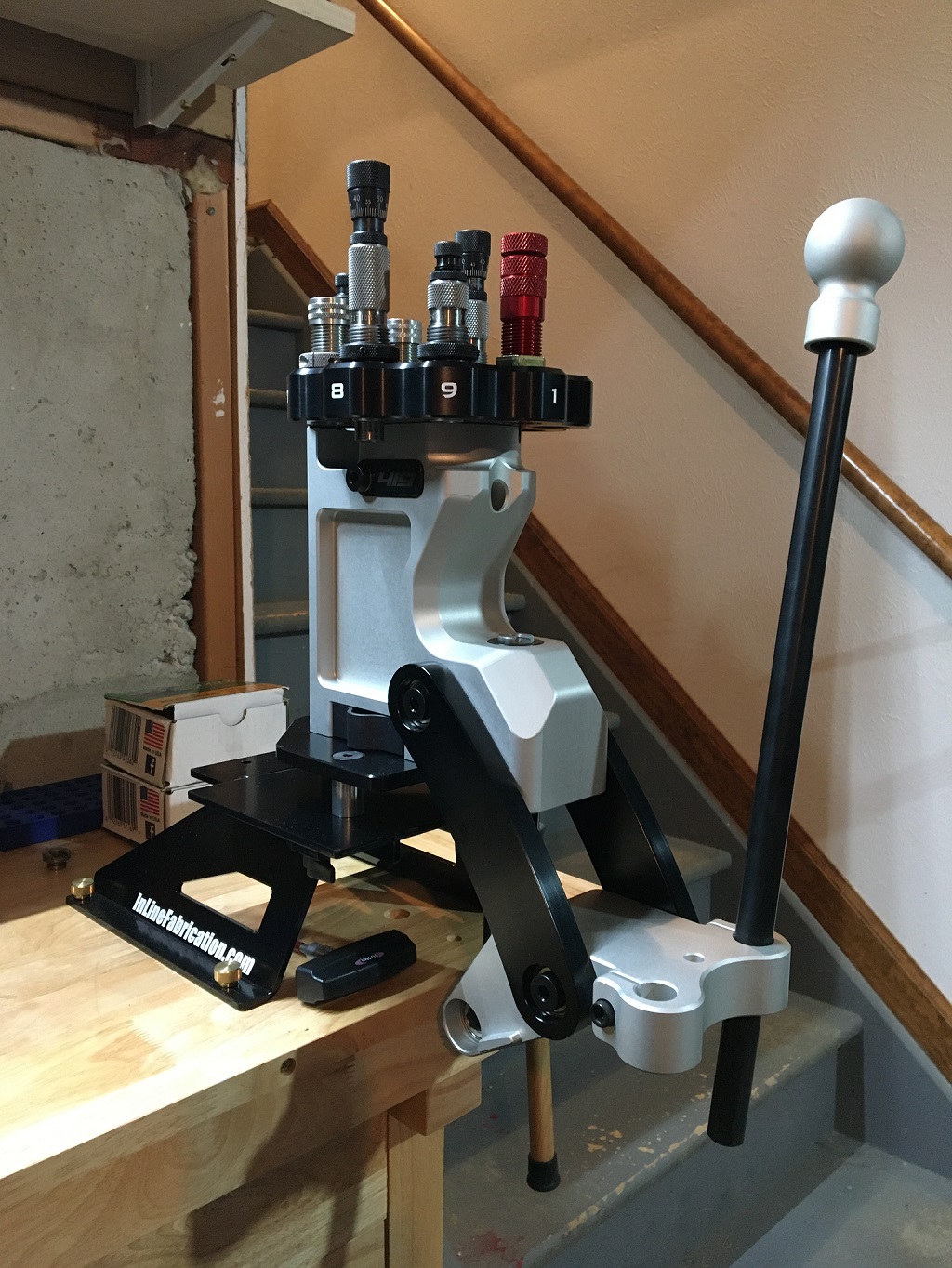

Finished setting up my new XL750 and started initial run of 9mm.
Natually, needed to go back and tweak the flare of the case mouth from the powder funnel depth; as well as the height of the camming pin.
Now I understand the need for multiple tool heads!

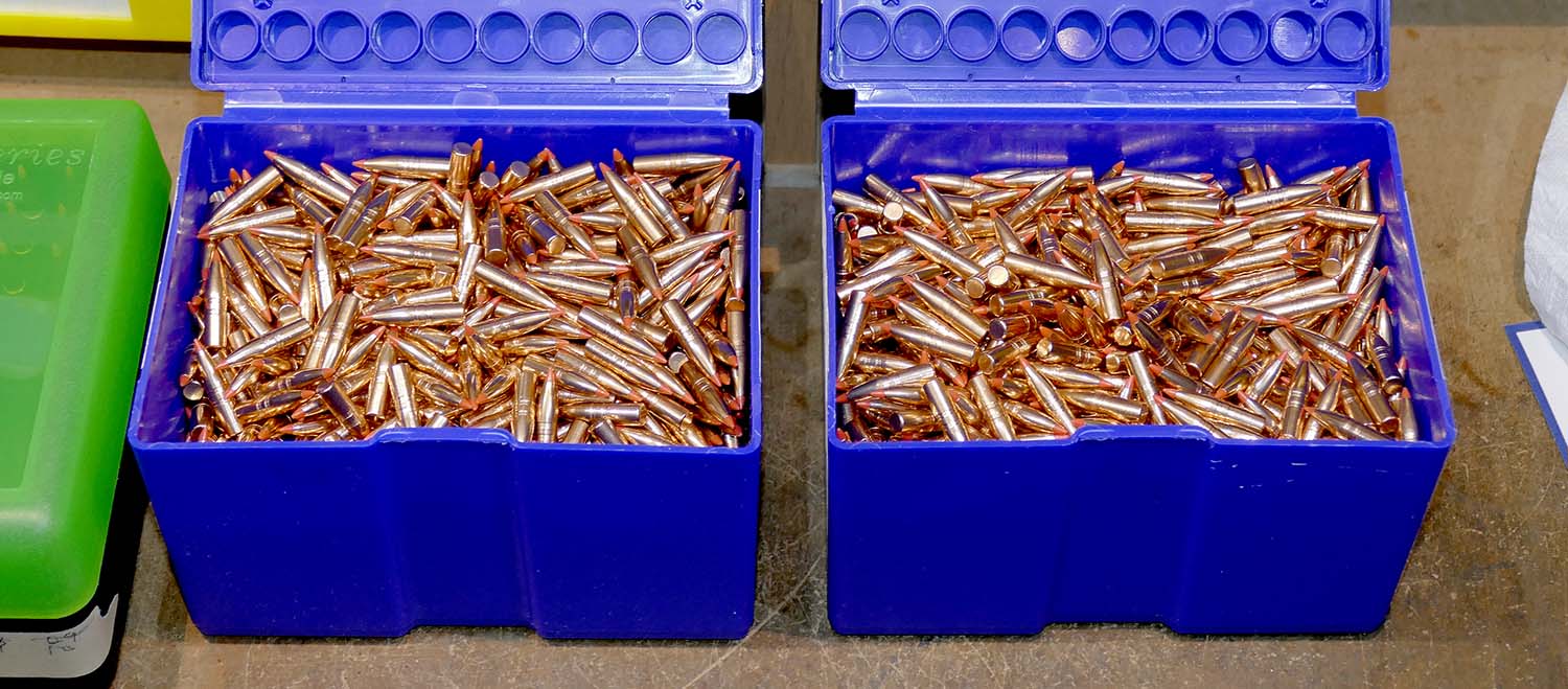

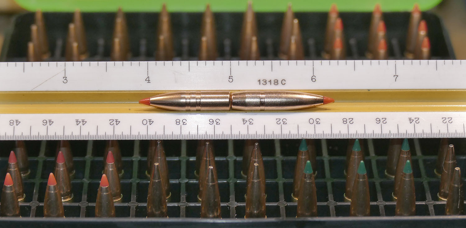

Received another Midway factory-second 6mm bullet...
...the Hornady GMX, the all-copper, plastic-tipped hunting bullet.. This is the 90g. version; it's BC is much higher at .422 v. the 80's .300.
Now have 20 trios of all of my bullets to shoot in the incoming 6mm ARC-chambered 16" AR15 that I hope will arrive by the end of November.. Waiting is not nearly as enjoyable as shooting.
Also found a small batch of CCI primers just arrived at Bruno's and bought two Ks of BR4s which I don't normally use (I use CCI 400s), but they're generally interchangeable, and I buy what I can get in this crazy world of ours.
