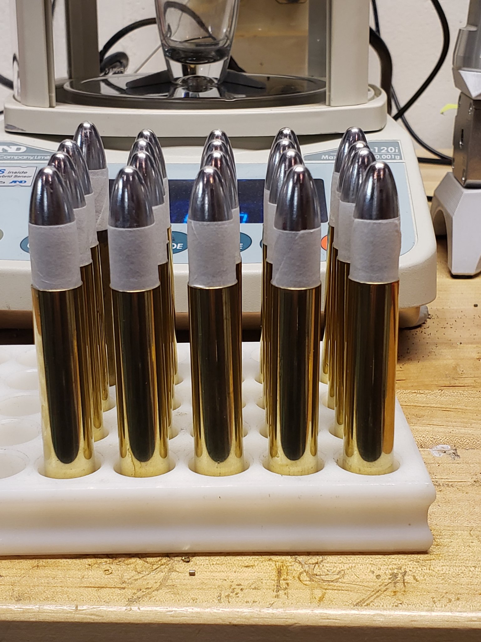

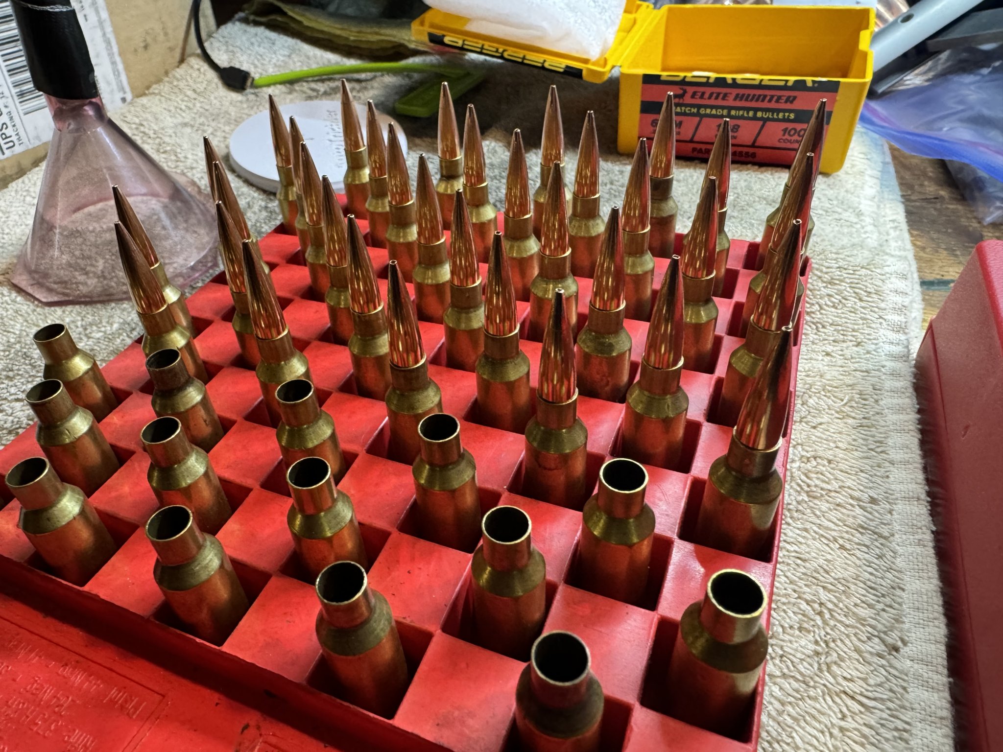

650gr of subsonic awesomeness...

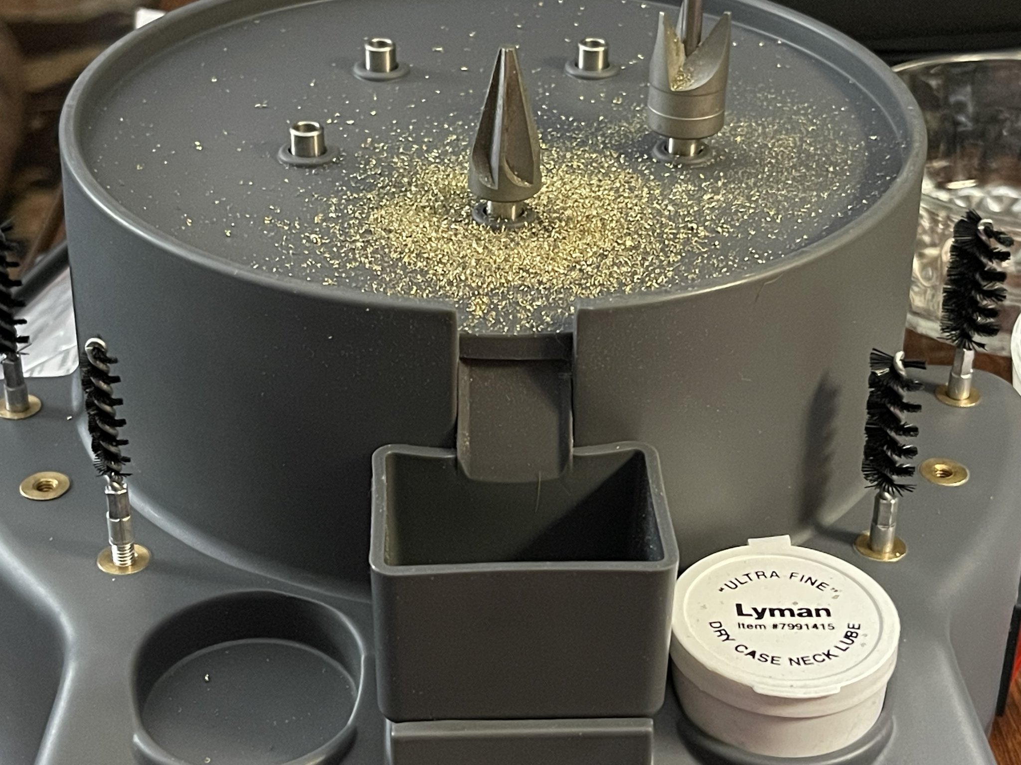

Yup. It’s a pain - haven’t made any more in about ten years. I have about 50 still at this point. I take .338LM brass that already has five or six firings, use a pipe cutter to cut it to length, run it through a die to take the taper out, cut the shoulder with a neck turner…not a fun process.

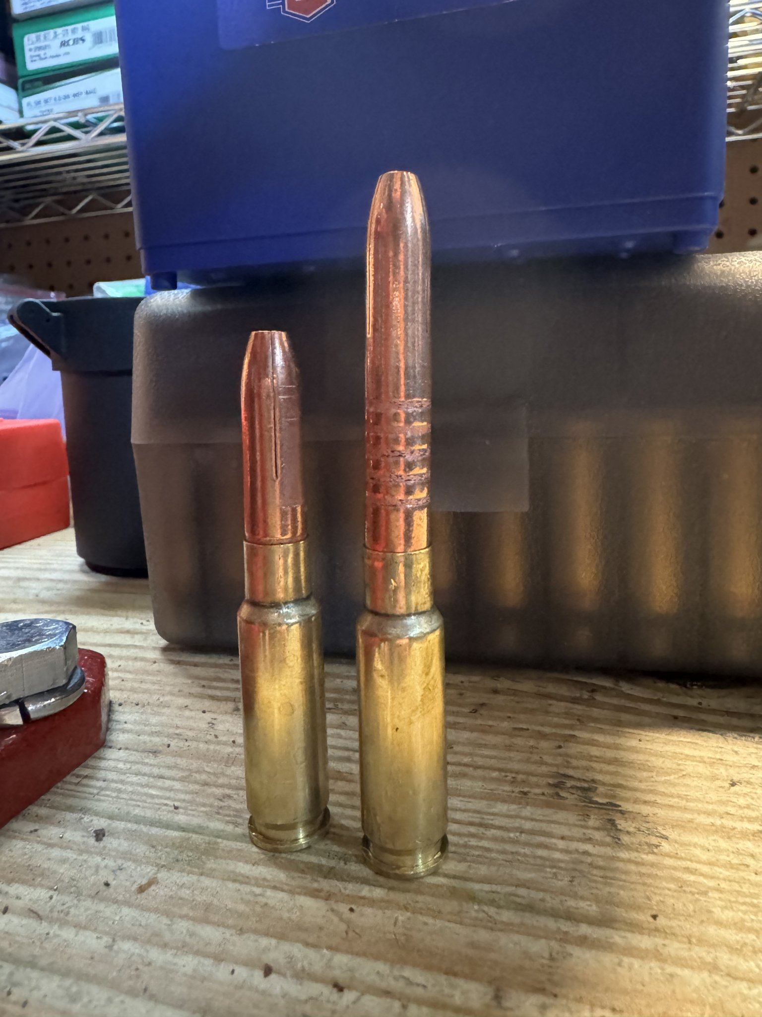

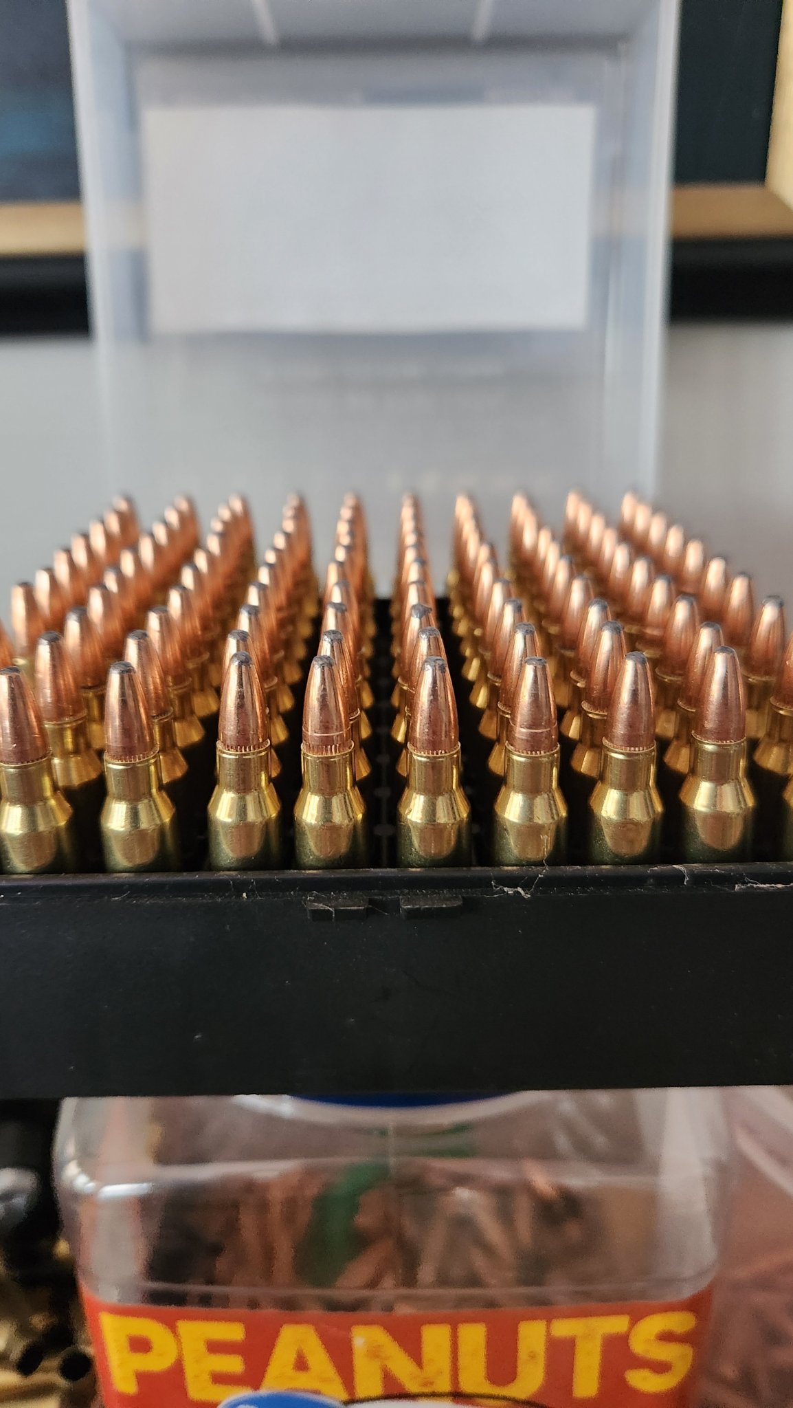

I laddered up some 64 grain Trophy Bonded Bear Claws for 5.56
The lowest charge and highest charges were the most accurate but the highest charge was leaving an ejector swipe that peeled some brass off so I dropped down .02 and settled there. These are one of my favorite projectiles but they are hard to come by since Federal does not offer them as a "component" and will not provide load data for them. I started by using the Nosler BSB 64 grain load data. Velocity via LabRadar at 10ft was 3025 average from a 16" PWS Mk116. I used Benchmark as my powder since I have a bunch of it

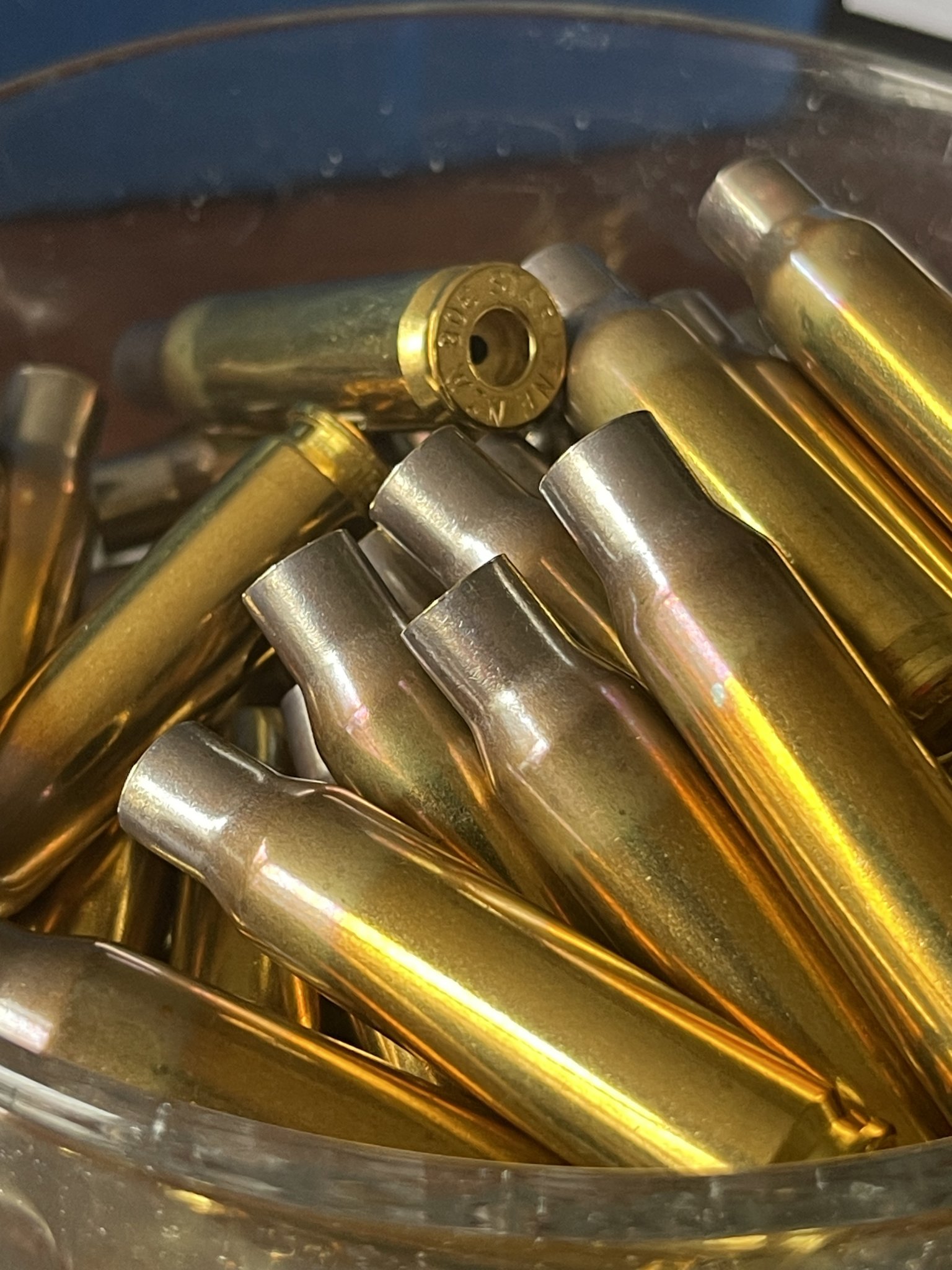

I found myself nodding at the helm this morning…..after getting home from night shift, just after some breakfast…..annealed 100 .308Win cases (Starline).
Knew it was time to get some sleep when I picked up an errant case……still hot.🥵.
Woke my arse up enough to realize it was time to wrap things up & hit it again tomorrow morning after work.

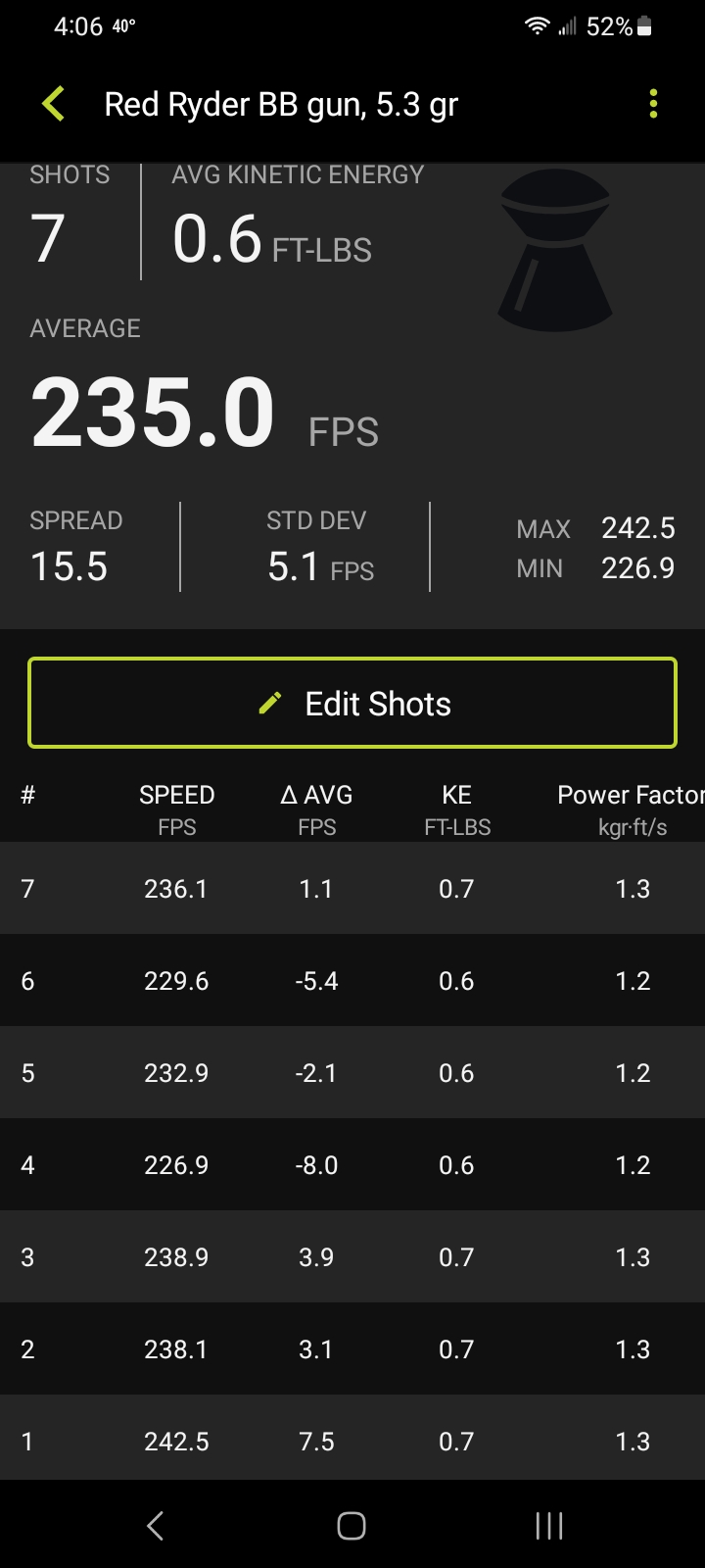

Tried out my new Garmin Xero. Red Ryder in the backyard.
That Red Ryder shooting some tight SD.
Much respect. :)

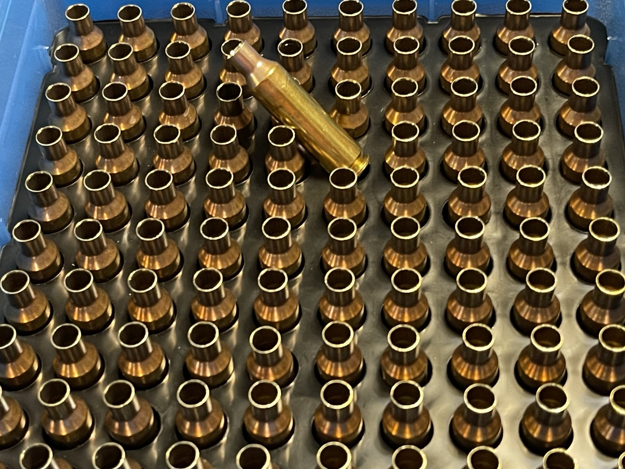

Spent a few minutes this afternoon wrapping up brass prep while the evening news was on.
Judging by the crime reports.....I should be loading more HD ammo, lol.
6.5 Creedmoor
6.5 Grendel
.308 Win
Now ready for sizing, priming, charging & seating......maybe I'll get into that after work tomorrow....maybe.

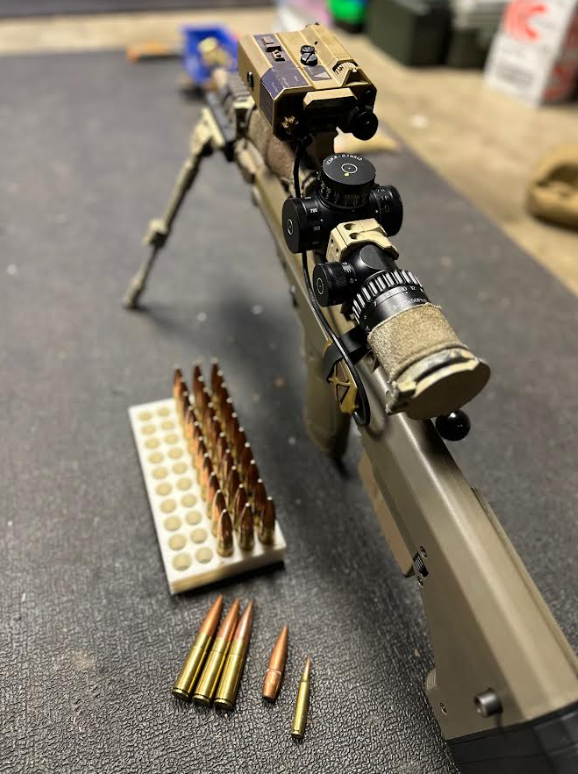

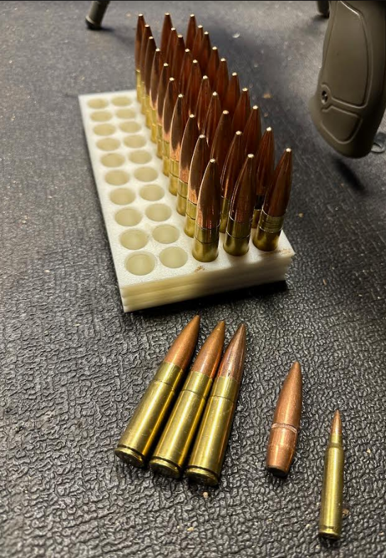

Lol thanks! Hope my blackout numbers are only half as good. Did 3 sets of 10 supers with Lil Gun today, making it 8 different loads of blackout, and 10 other various ammo I want to clock tomorrow.

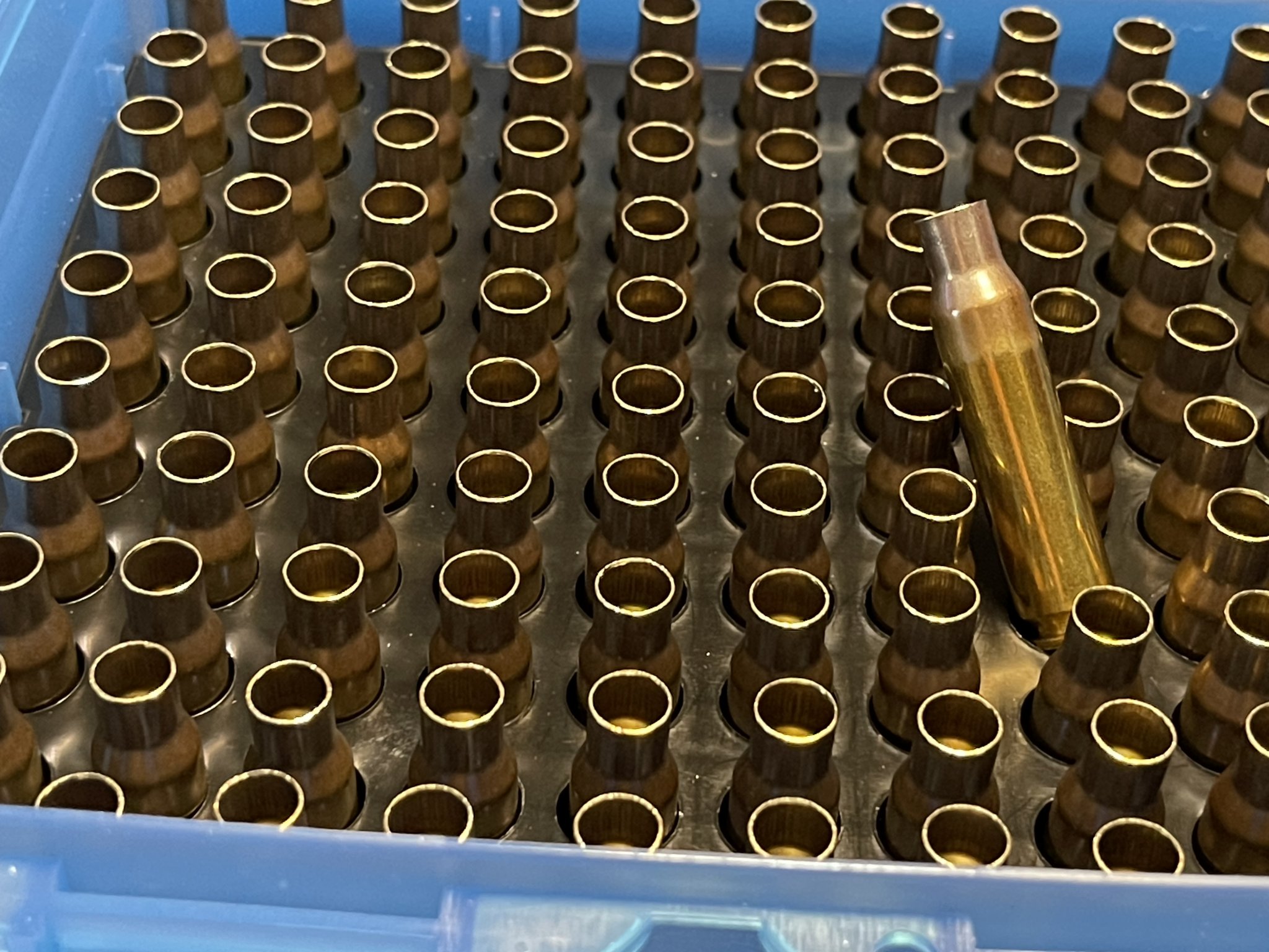

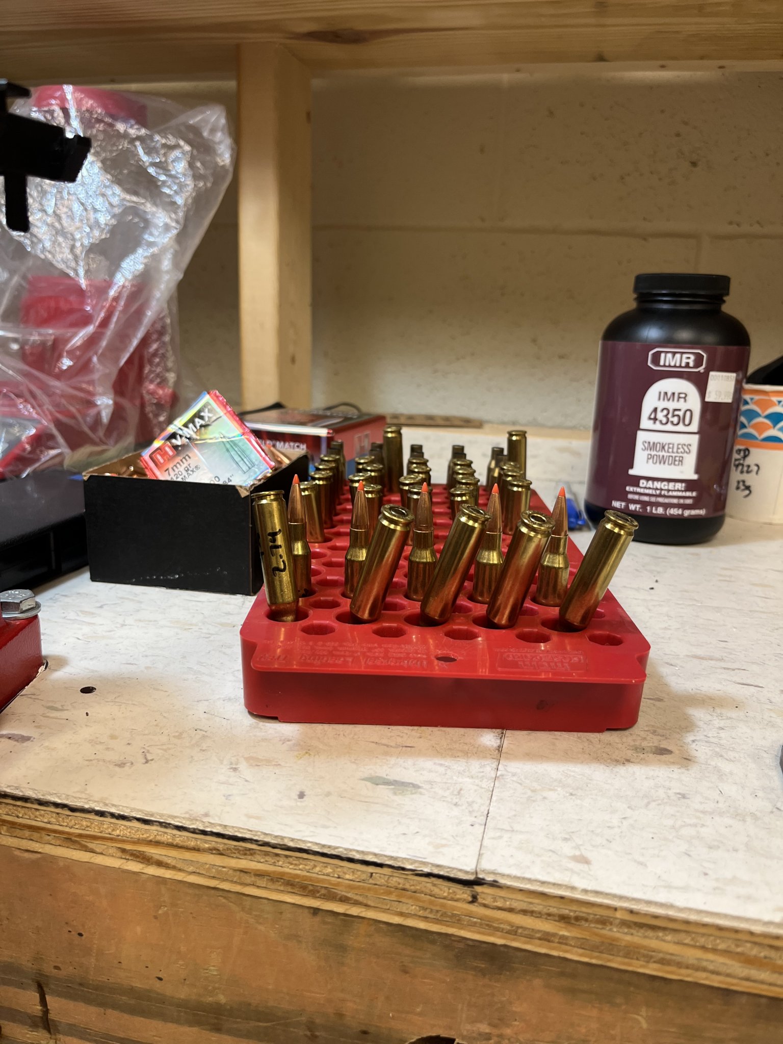

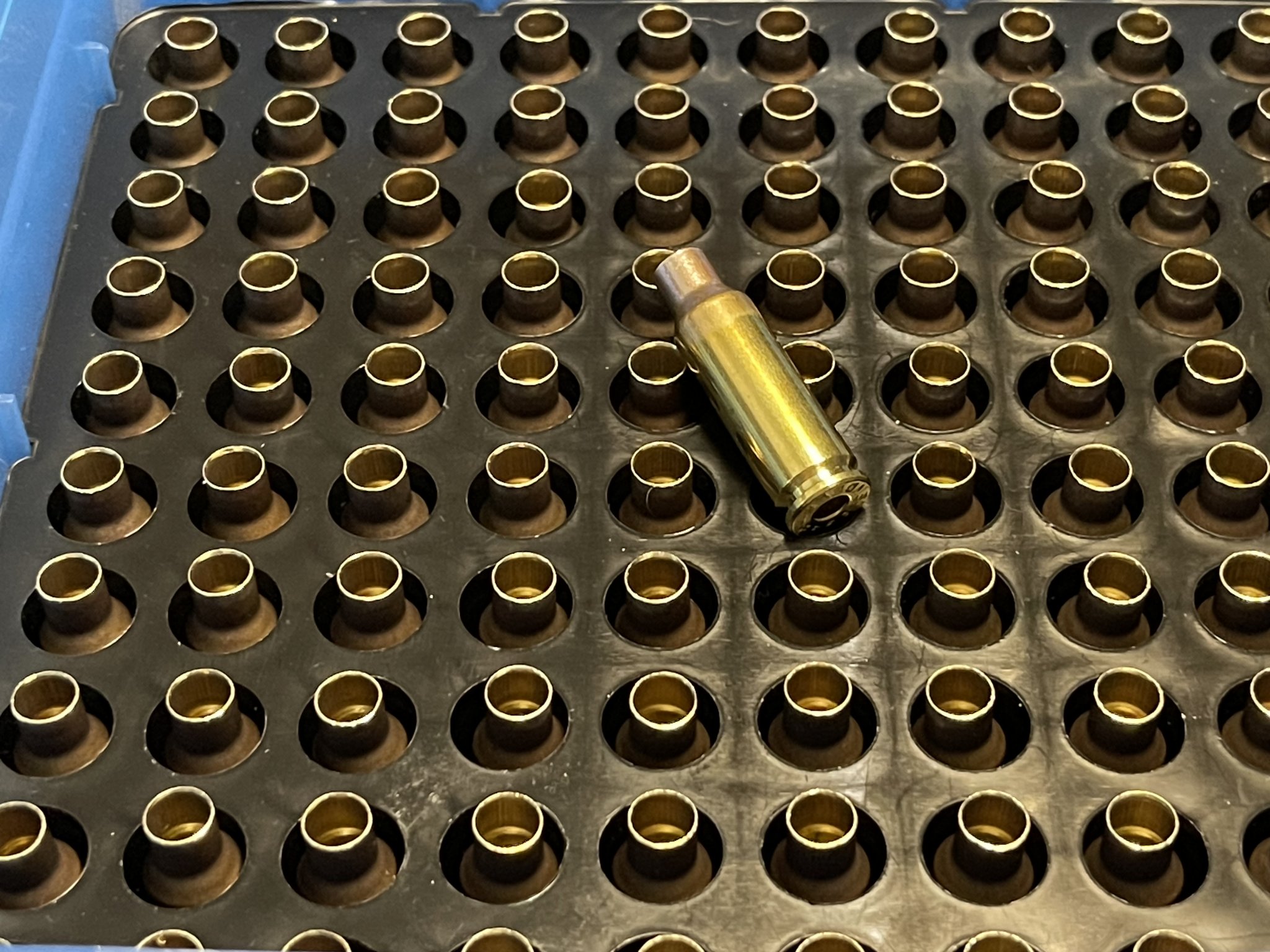

Just finished getting the 221 Fireball set for the first round of load development. 3 bullets and two powders all new to me. I forgot how small those cases are! 🤩
The nice thing is that the max loads from Hodgdon top out just over 20 grains, so I’ll get some good mileage out of a keg.
The hard part is the fact that I’m having to treat the first two bullets like a unique wildcat because of the lack of load data.
