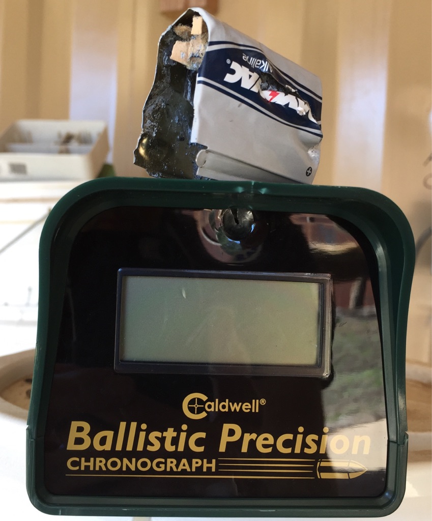

    As to "when" a Caldwell/Chrony takes a hit... yeah. When. But hey, this one still works after taking a 9mm, except it won't talk to my phone anymore...
