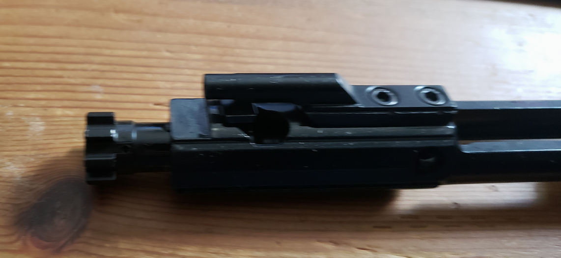

My 22 Grendel was sluggish for the first few mags, but eventually smoothed out. My hypothesis is that a minor chamber imperfection was dragging on the spent cartridges, but polished out with use. Possible that the bolt lugs needed to wear in too.
Can you manually lock back the bcg? Does it lock on the bolt or the nose of the carrier?

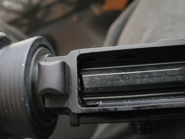

I'll be checking the upper very carefully for burs in the BCG track, etc. I will also give it a bit more oil. It might be a little light on that. No, the BCG never jammed when the upper was empty and without a mag. I'll check that again once I clear it this time. I get the feeling that the ejection is handled better than the feeding. But we'll see. Right now, I have to clear the jam that keeps me from operating the charging handle. Then we'll figure things out.
No, I cannot manually lock the BCG in the open action position. But that I think may be due to a week bolt release button. Perhaps, a bad spring. I'll replace it and see. And, of course, it won't lock when cycling and the mag goes empty.
Sanity check, once you get the jam cleared. Can you use the charging handle to pull the bolt far enough back to clear the bolt catch? In other words, does the rifle have the ability to lock open. Getting a 5.56/223 ar15 to run shouldn’t be this difficult.
No, the bolt catch does not lock the bolt back. It has always been an issue. I may have to replace the spring on it. Or, if that won't make a difference, then I guess we're talking replacement of the entire upper or the BCG, depending on what's cause the bolt catch not to work.

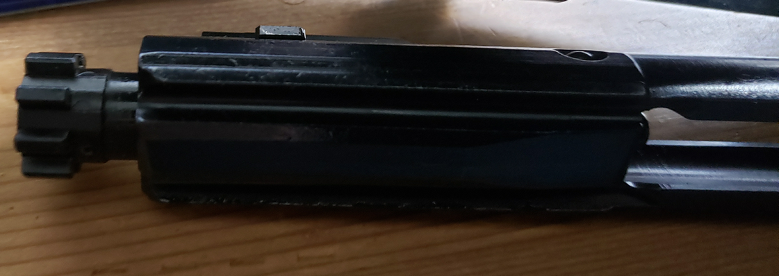

If you cannot manually drag the bolt carrier back far enough for the bolt catch to engage on the front of the bolt, then you have a fitment issue that needs to be resolved. And, this could appear to be under gassing and short stroking because the bcg is not moving as
Maybe you also have a bolt catch issue, but let’s start with the bcg. Pull the action open with the charging handle, then look in to the ejection port. Note the position of the bolt face relative to the bolt catch. Manually actuate the bolt catch while the bcg is fully to the rear. If it does not come up to block the bolt face from moving forward, where is the interference? If it does block the bolt face, or the bolt is far enough back that it could, then you have eliminated this potential issue from the list.
Now, let’s check the bolt catch. Pull the upper from the lower. Set the upper aside. Grab a magazine and insert it into the lower. Note that the magazine follower interacts with a tab on the bolt catch to move it into the engaged position. The bolt catch spring keeps the bolt catch in the down position. A weak spring would only serve to allow the bolt catch to engage when it should not. If the magazine follower moves the bolt catch up into the engages position, then it is working properly. If it does not, where is the interference?

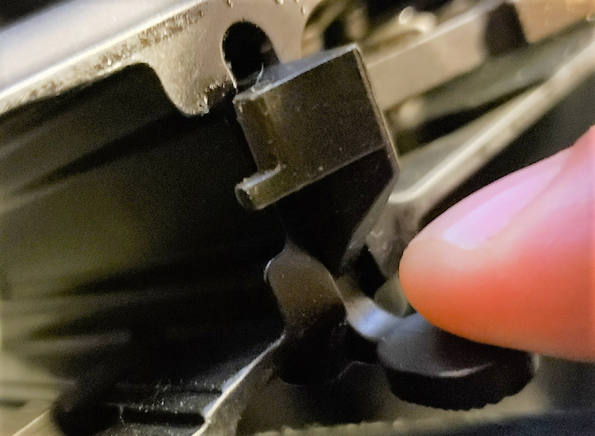

Sounds to me like the bolt catch is trying to catch the front of the bolt CARRIER, not the bolt itself.
You need to understand also that the MAGAZINE FOLLOWER IN AN EMPTY MAGAZINE is what causes the bolt catch to engage, NOT the spring in the bolt catch assembly.
Also, if the bolt catch will not engage the front surface of the bolt, then that likely means the bolt carrier group is not traveling far enough rearward due to an improper buffer/spring/tube combination.
The gun will never properly function until this problem is dealt with.

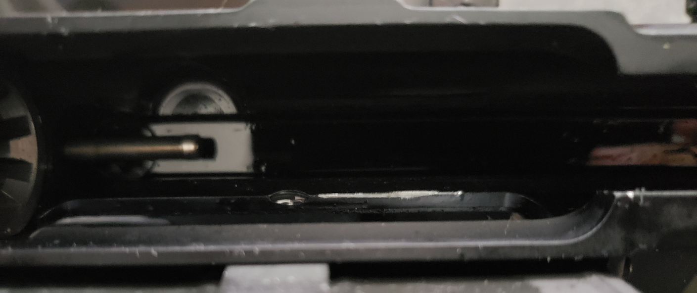

I've seen carbine buffers that wouldn't actually fit in a carbine buffer tube. Needed to shave .1" off to get the BCG back far enough to catch on the hold open.
I'm wondering if something is up with your cam pin or track that's causing the BCG to stick.

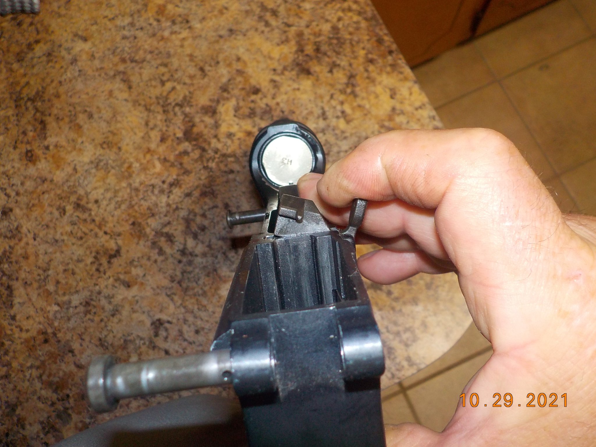

I don't know if anyone posted the world's easiest way to align the gas block yet, but here it is.
This is for barrel not in gun.
1) get a toothpick, or a thin piece of pasta.
2) with the gas block off, whittle toothpick down if needed. Make sure it easily fits into the gas port.
3) snap it off so it is entirely in the barrel
4) put on the gas block, adjust with shim from shoulder (lots of GBs need this done) and partially tighten.
5) look through muzzle end with chamber end facing a light source, barrel is gas side up.
6) find the toothpick. 180 the barrel so the toothpick drops (mostly/partially) into the GB,
7) do this several times to confirm easy motion of the toothpick/pasta.
8) its aligned. Tighten up GB, use blue loctite, etc.
9) break obstructor with cleaning rod and remove from barrel.
A compressor is not needed. Block chamber with a finger, another on end of gas tube and blow down the freaking barrel.
You can confirm function that way.
Also make sure the gas key is easily mating with the gas tube to confirm alignment.

Here are the pics I've taken. The first is of the Bolt Catch when not extended (i.e. charging handle not pulled back.
You can see that it doesn't fully cover the impression hole in the lower. I think that's what Mike was referring to when he said it's not properly oriented over the lower hole. Either that, or the spring is really weak.
Here's another view:
And another from the opposite side (sorry a bit out of focus):
If I open the lower and look at the inside, I see this:
And when I try to pull back the catch, I get this:
And, finally, from the other side:
I'll check this with my other lower and some additonal parts and then see what I may need to adjust. But if anything looks wrong, please advise.

I edited and brightened your pic, then made a pic of mine. Your bolt catch is not raising near far enough. Also not covering the hole where the spring and follower go is normal. If the spring is your problem, it would be much too strong (not "too weak") or too long for this application. Are you sure you used the right spring here? It takes very little effort to operate when it's right.
ETA: You should be able to insert an empty mag with the gun in this condition and the mag spring should push the bolt catch up. The spring installed in the gun has to be weak enough for the magazine spring to overcome it.
Yours:
Mine:
That will be the first thing I check. It's quite possible that it's the wrong spring. I recall that when I started this build, I had opened the "Lower parts Kit" (the one where everything is in their little places on the kit) I had bought (that contained the bolt catch). It was the first thing I put on the lower. But I recall jostling the kit and everything coming out of it. I thought I had put it all back correctly into their slots, but I could be wrong. I will check it.

"Either the spring is not enough to keep the bolt catch extended out when the handle is back" The bolt catch spring installed in the gun does NOT hold the latch "extended"---that is the job of the MAGAZINE spring.
Thought we went over this. ;) The bolt catch is not coming up high enough. This is probably due to the spring being TOO STRONG or TOO LONG. A 3rd problem could be some obstruction/foreign matter trapped behind the bolt catch spring or follower.
SEE ATTACHED PDF
In the PDF, you want your bolt catch to go high enough to achieve the BIG ANGLE-not the tiny angle. Something in the bolt catch SPRING ASSEMBLY is limiting the movement of the bolt catch and preventing this. Now go knock the roll pin out and remove the bolt catch, spring and follower to determine what the problem is.

Kit received today. Took less than 1hr to replace the Bolt Catch group.
These are some pics below of both the original group and the replacement group. The original is on the right. First the spring and detent.
You'll notice the spring on the right (original) is shorter and a little thicker, but it matches the fit of the detent/plunger on the right. The spring and detent/plunger on the left also match each other and the spring is softer. So, I conclude that the original spring and detent/plunger were the correct ones for the bolt catch group installed. But was the group itself correct?
Now, the view of the bolt catches, themselves. Original on the right.
You'll notice the big difference in design. I think this was the primary issue causing the catch not to lock. The spring didn't help either, but I think this was the real culprit.
I completely replaced the original parts with the replacements, all except the roll pin which fit back in properly.
The bolt catch works flawlessly, now. I tested it with some new snap caps that actually had the same weight as live rounds. They ejected properly and the last ejection resulted in the catch locking strongly. I dropped the empty mag and then gave the weapon a light bang, and it held. Only when I pressed the release did it close and go into battery. I will do a final test at JTAC this month at my next visit to confirm it will hold after firing/ejecting the last round in the mag.
