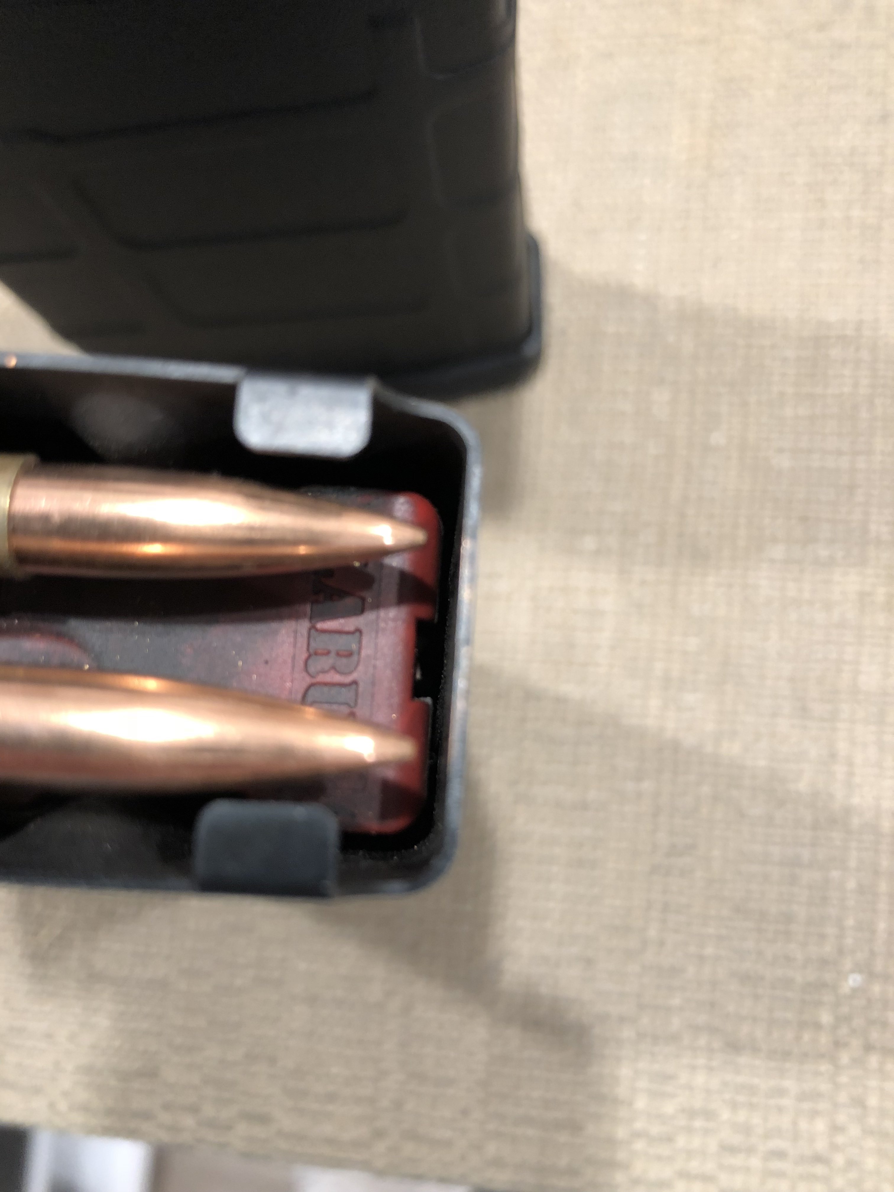

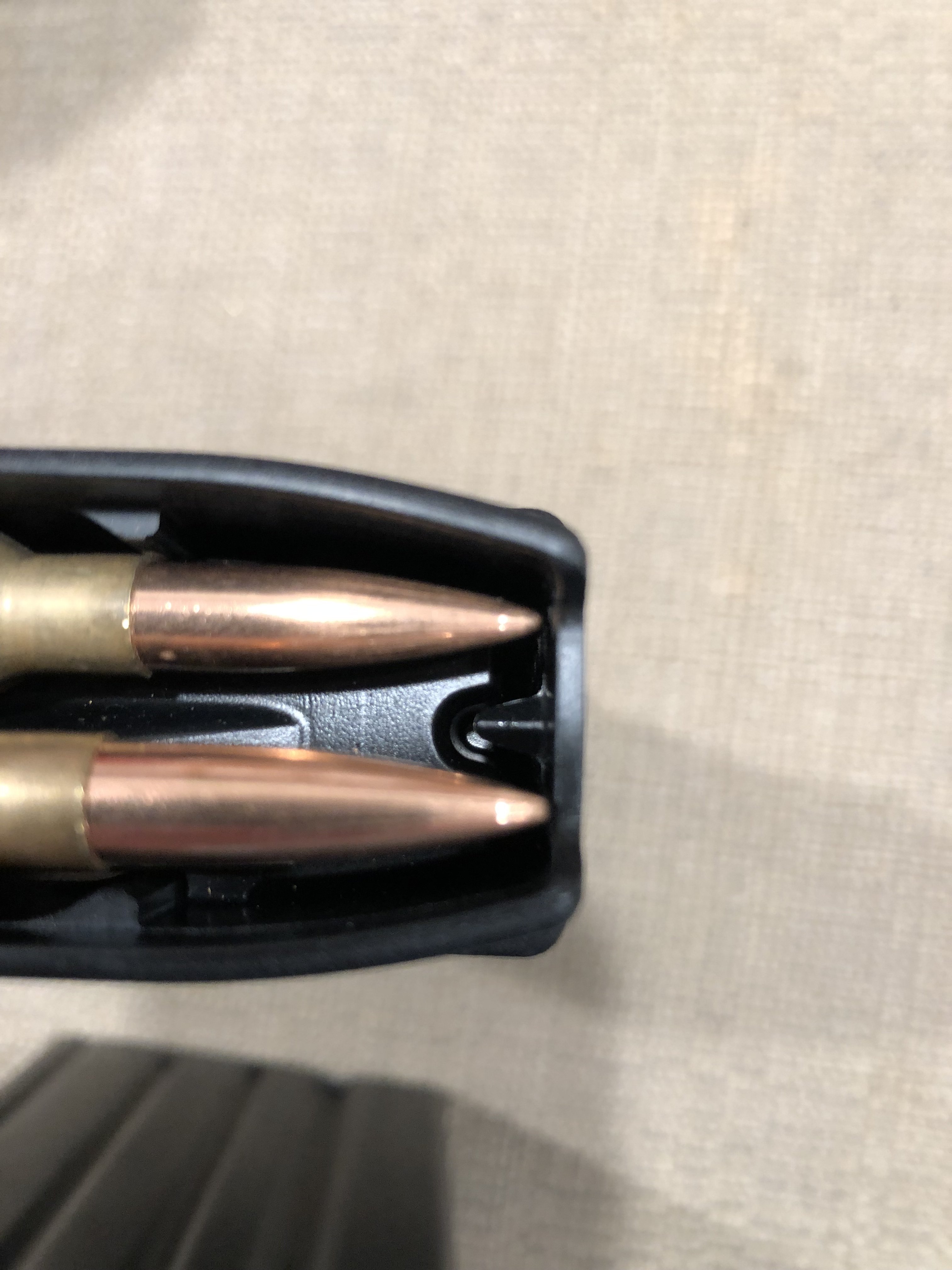

I never had an issue with .308 mags. Pmags, SR-25, larue all worked. Only issues I had with feeding were bullet related and not mag related.
Are you saying that a 6mm CM (or others) won't work in the mag? Or that some bullets because of shape or length have issues? I don't know how to separate mag from bullet issues, since either it works or it doesn't.
Some bullets would not feed. 110 SMK was the worst. It was too long and skinny and would fit between the barrel extension lugs without tipping upwards and jamming into the back of the barrel.
This was regardless of which mag i used.
I ran a JP barrel with a 107 SMK at 15 thou jump, this gave me a 2.791 overall case length. This combination worked best in Magpuls; though, Larue mags have more room. The 107 SMK feed well, but I did have issues with other bullets.
I have since switch to a different barrel and can report on my new load specifications when I get some free time to shoot it.
