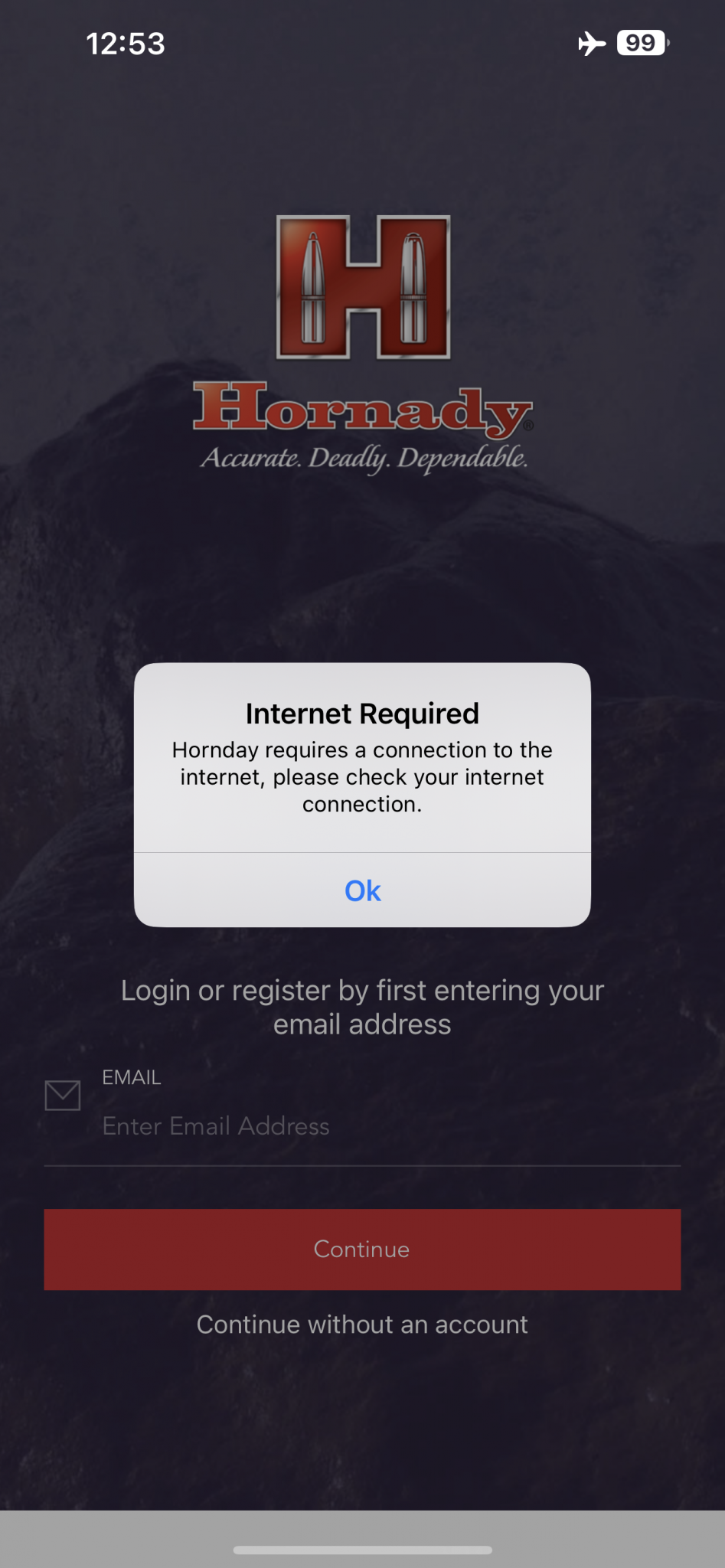

4DOF (on mobile) also requires an internet connection. So if you are in bum fucked Egypt you are just fucked

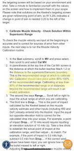

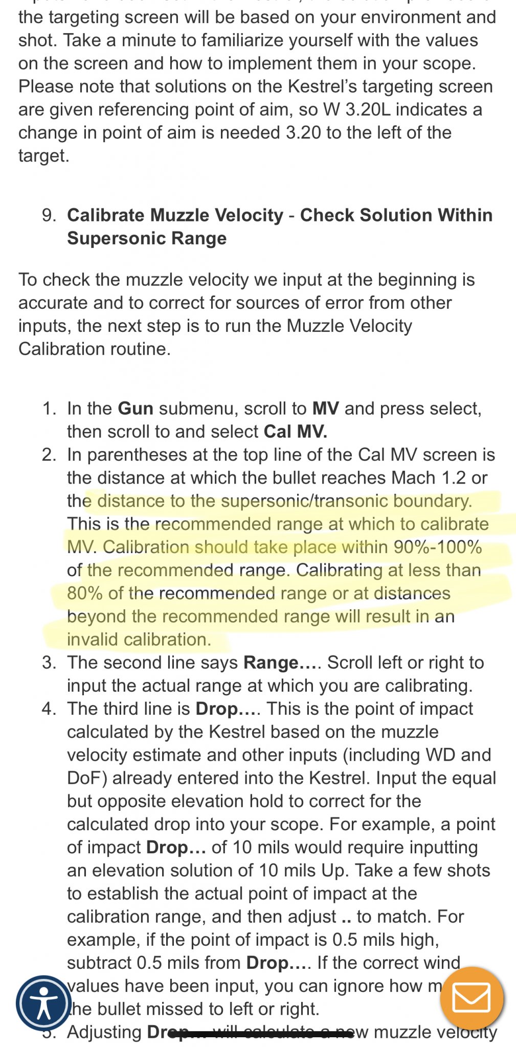

What’s your take on the kestrel directions for MV truing?
