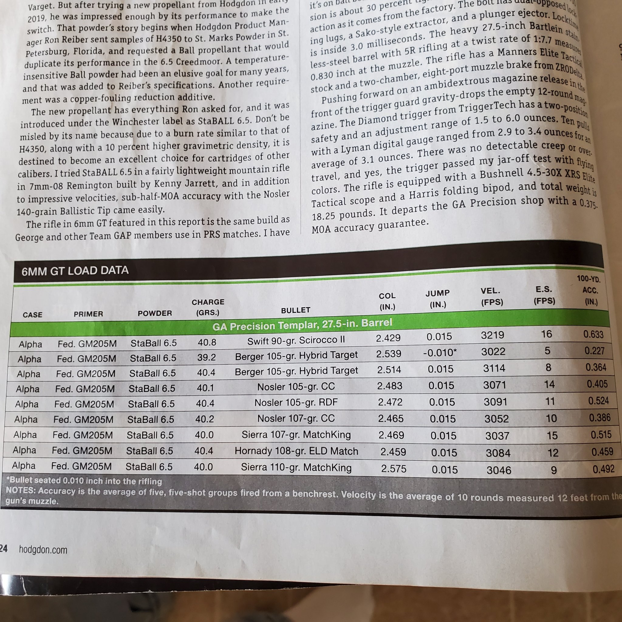

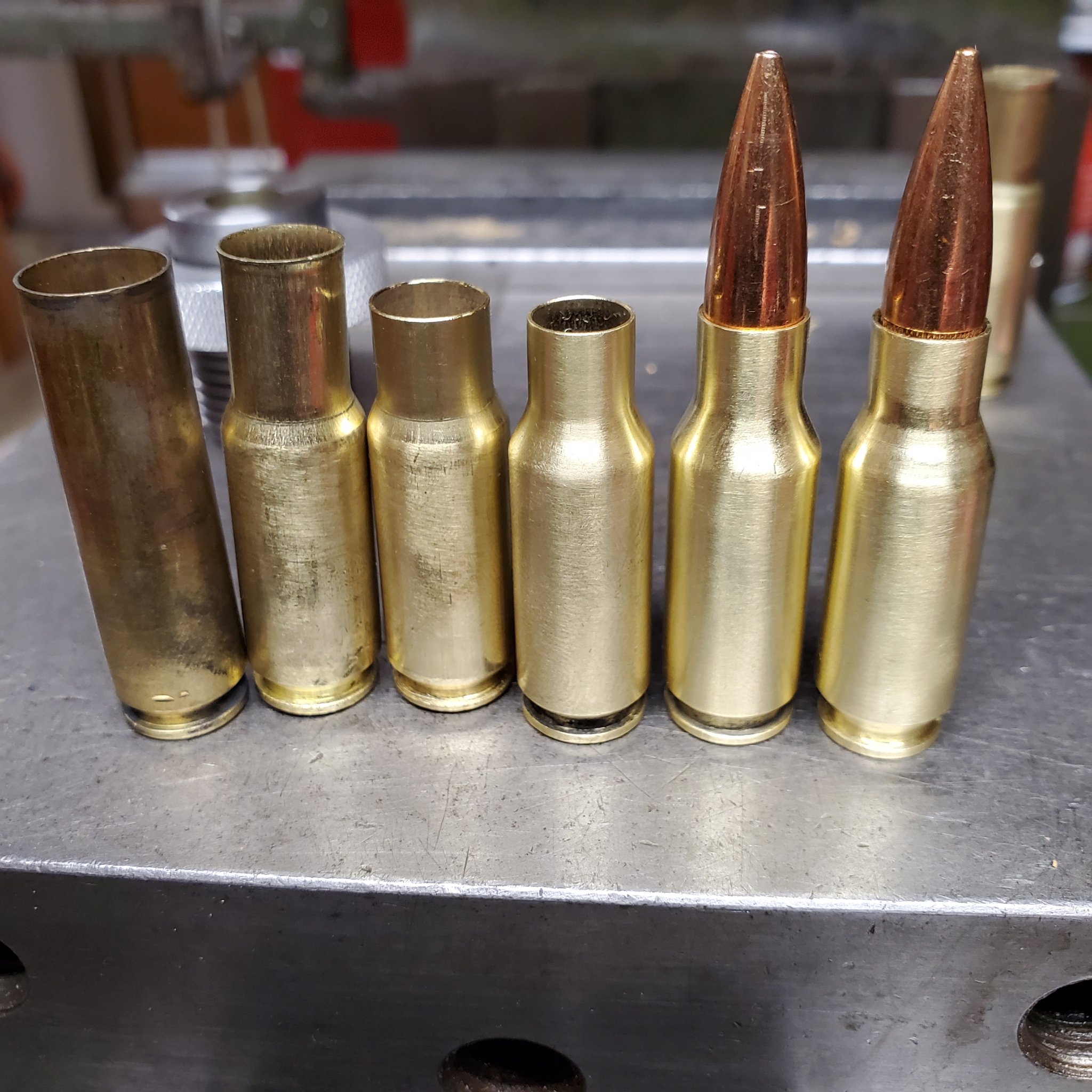

A direct comparison my 6 Dasher 28" Bartlein barrel vs GA Precision 6 GT 27.5" Bartlein barrel same powder 6.5 Staball.
In the 2000 Hodgdon Annual Manual.

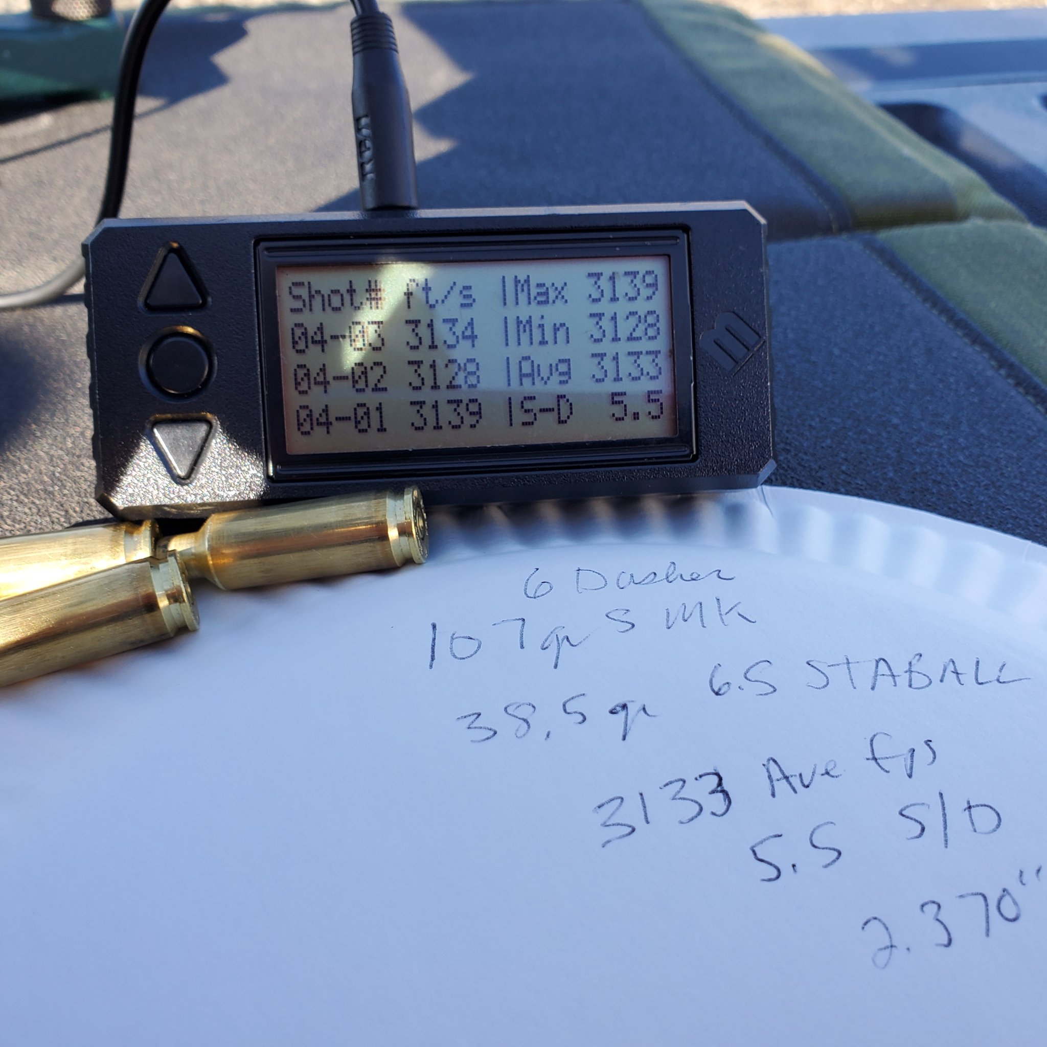

The last photo is my personal load for 107 SMK at 3133 fps ...so with the same powder, same barrel maker, same length with in a half inch...use 1.5 grains less powder to get about the same velocity.
My Accuracy results were generally better with the 6 Dasher, some alot better than the GA Precision rifle in 6GT.
Probably why 41% of the pros choose the 6 Dasher.
They are basically twins, feeding is no issue, as stated, with MDT 6BR mags.
Your choice...I already made mine.
Both are good cartridges, and both do the job, but a slight accuracy edge goes to the 6 Dasher.
But if ya choose the 6 GT its a very good choice.

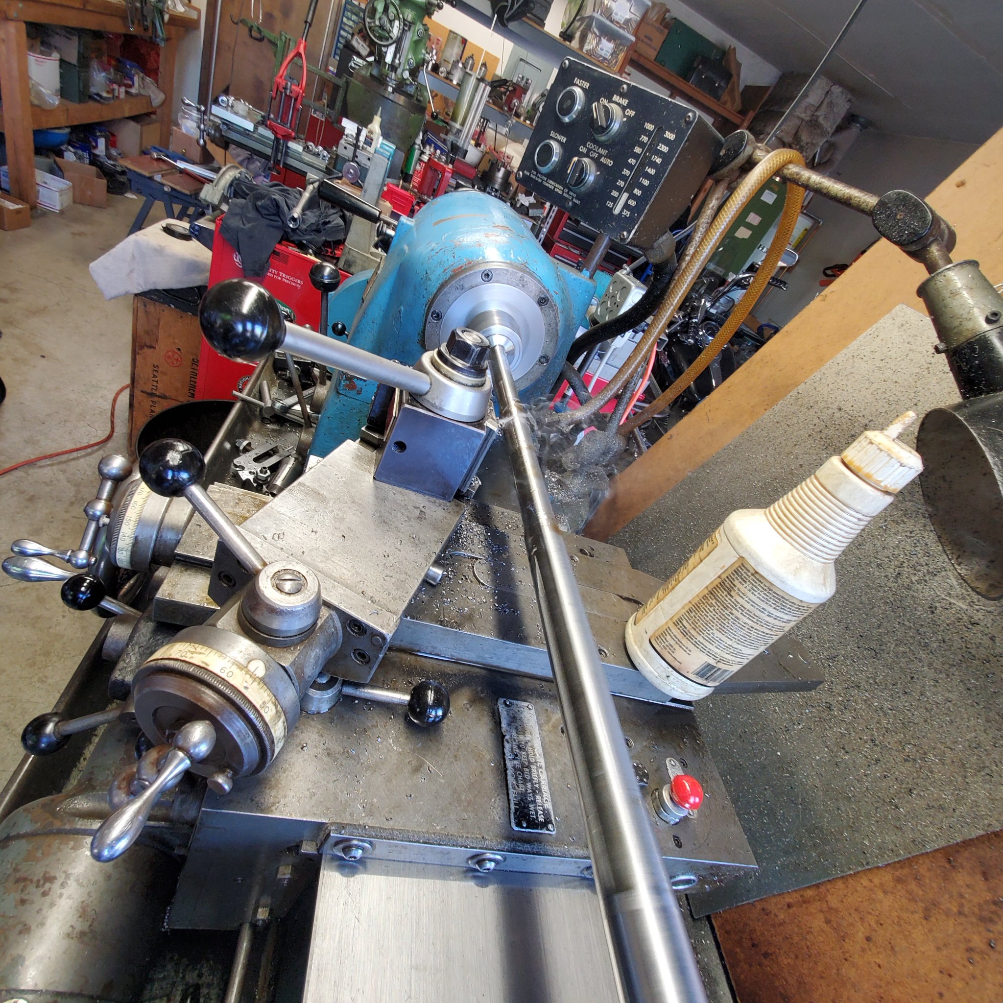

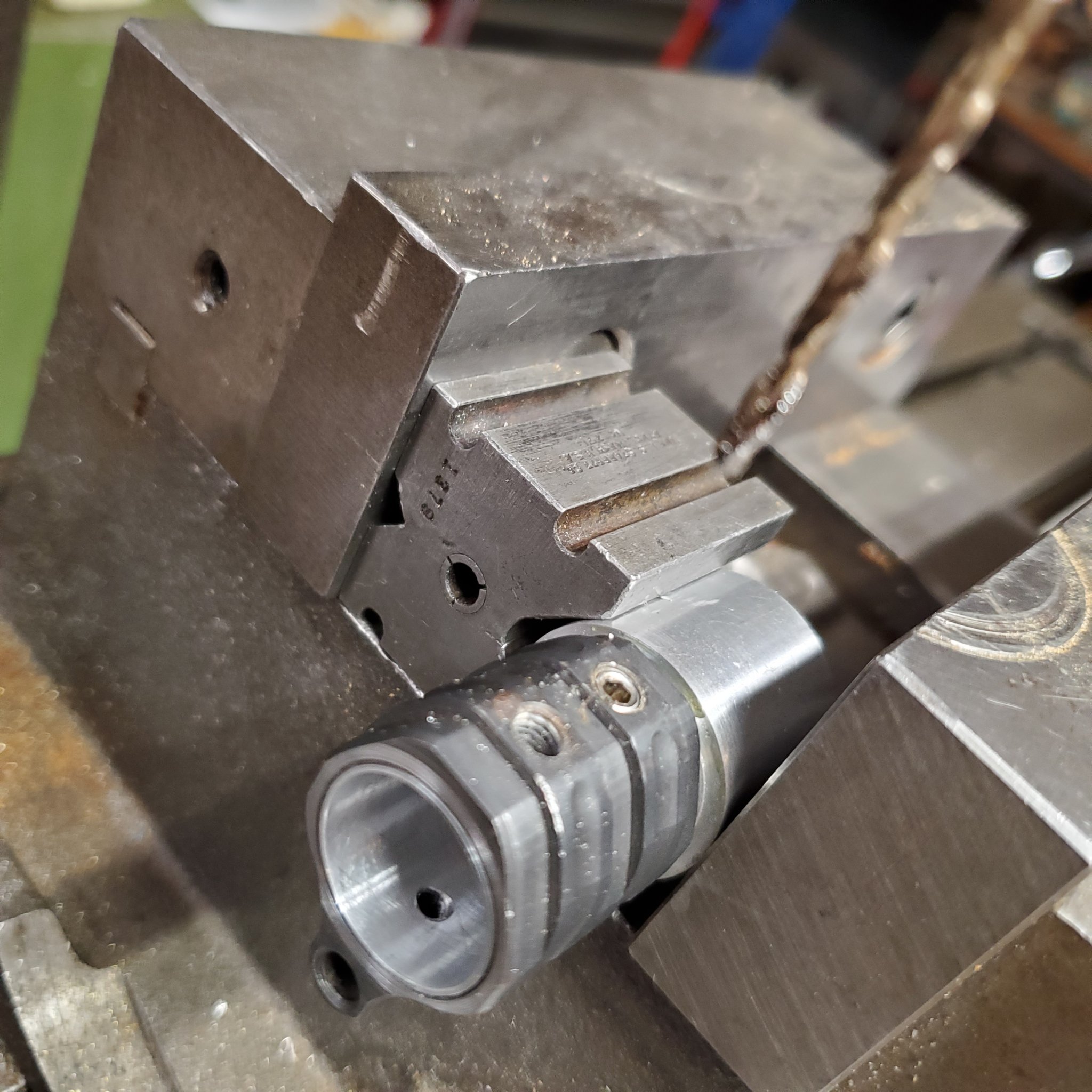

Me, I'm retired machinist, barrel life is of little concern, I can order one and have it in 7 days, or less, unless it's not something uncommon like a 6.5 twist 338 or a 10 twist .510 barrel and chamber it the next day, and be shooting again.
I purchased my 6 dasher reamer and gauges, on tbe first build, so total cost to rechamber is around $400- $420, for a Bartlein, Krieger, or other quality barrel blank.
Southern Precision Rifles, and Brunos have a good selection ready to ship, and sometimes free shipping or a small discount.
So I'm not concerned about barrel life, cause it's rather cheap to replace, for me...and I may want to change calibers, by then...or Start with a new factory rifle with no intention of using the barrel it's chambered for.
I'm more interested in performance, sometimes that's accuracy and high velocity, working together with acceptable accuracy to accomplish the task, other times its more accuracy oriented, velocity will be slightly 2nd...but barrel life, never enters the equation, into what I intend to accomplish.

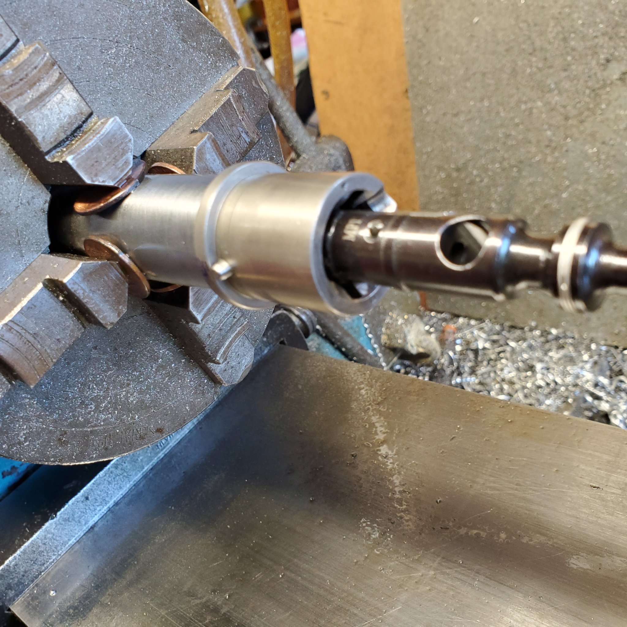

You are on the right track, IMO....Barrel life, and how to extend it. Or make it less important...I took an accurate factory 308 barrel, I had 8000 documented rounds on it...could it be utilized in a test?
Had so left over AR 15 parts from various builds.
Took the 8000rd Remington 26" 308 factory police barrel to the lathe cut off the chamber, and a bit more to remove most of the firecracking. Shortened and profiled the barrel to an AR 15 style,
threaded for barrel nut, chambered, threaded for muzzle brake, turned for .750 gas journal at rifle gas length, and drilled a gas port.
Total cost was $340 including the reamer, for the Remington 30 AR cartridge, long time out of production.
So now instead of a 308 boltgun, it's an AR 15 in 30 RAR. That shoots 1/2" 5 shot groups...the factory Remington barrel on its way to 16,000 rds.
It's Shooting very accurately with the exact same bullets it liked when it was a 308.
Wrong size gas block? No problem.
No brass, No problem.
Live and learn...barrel life.
Starting its next 8,000 rds.
Anyone can do the same if they learn to use a lathe and milling machine.
