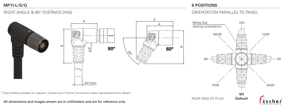

yes, I was referring earlier to using that and having it made with a receiving termination on the cable side. get a batch made, mark them up by whatever % is required to break even, resell as single packaged units
they don’t have a ‘ready to go’ off the shelf part that is a 90 degree adapter (though they really should tbh)
