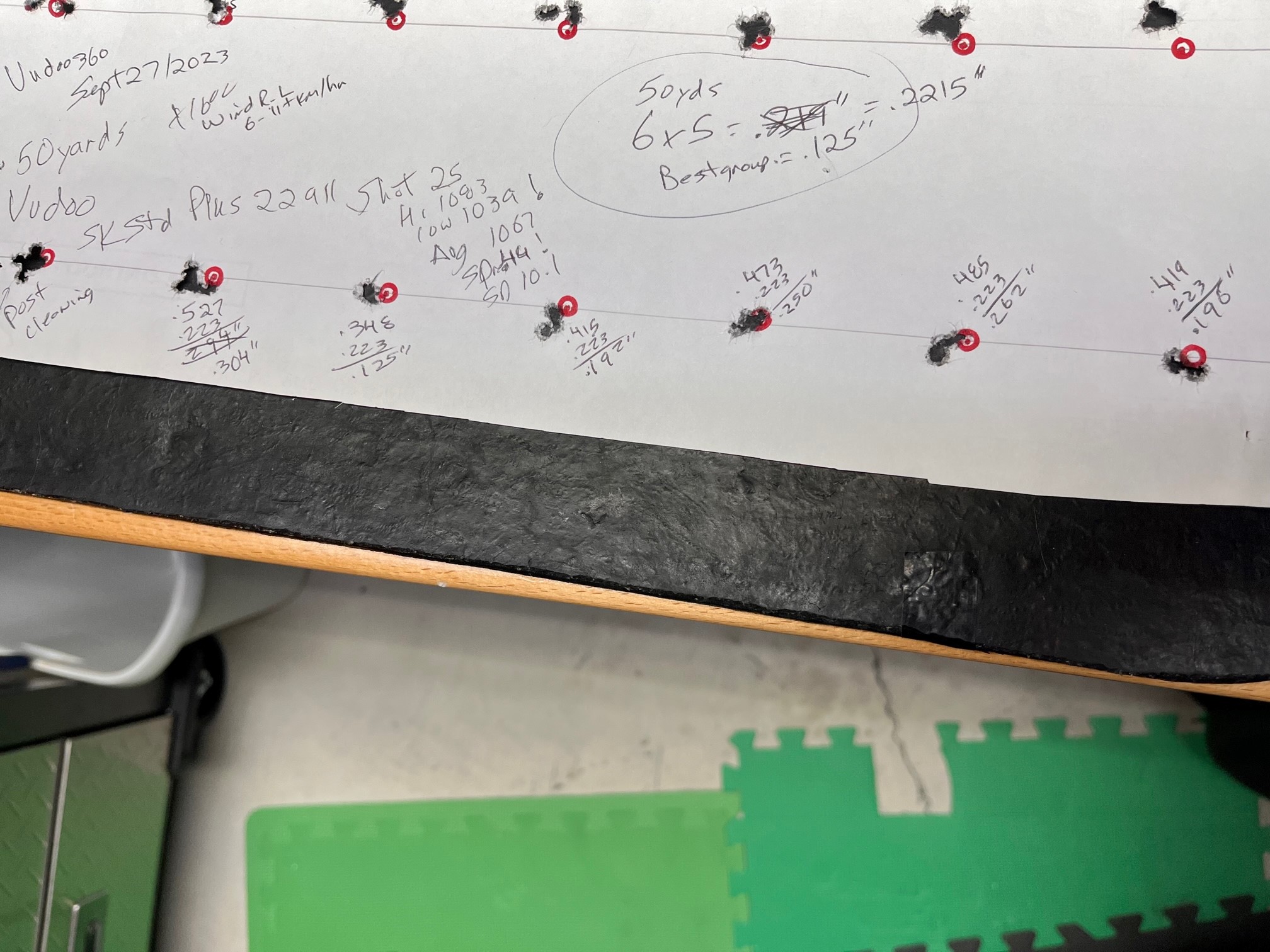

Ok finally got out today for a little bit today to practice offhand shooting for a PRS event this weekend. I also got to shoot the Vudoo a bit too, but it was a tricky wind and still struggling with big spreads in velocity in the Vudoo. Oddly, even with a 44 fps spread - I was able to snag an aggregate average of .XXX" in the Vudoo 360. The low spread ammo just doesn't group as well at 50 anyway.
Shot: Sept 27 / 2023
Gun: Vudoo 360
50 yards
Ammo: SK Std Plus
6X5 Average .221"
Best group .125"

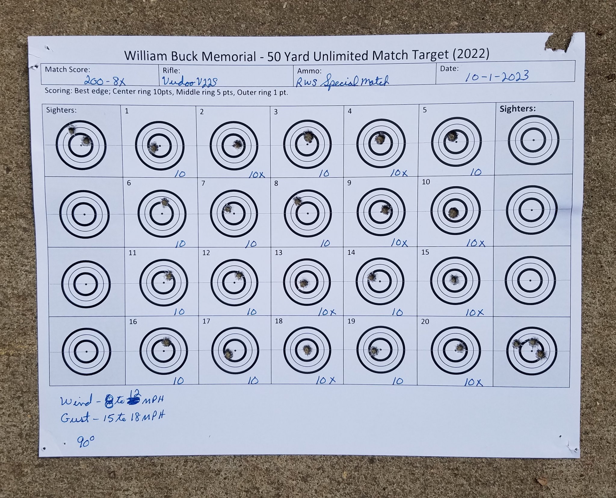

This morning was an opportunity to try out my repaired front rest (R.W. Hart cast steel/iron base with Cowan windage top) despite the wind blowing harder than I'd like. The repairs consisted of re-tapping the threads for the fine elevation adjustment, re-threading the 3/4" elevation post, and adding a section of brass key stock (thanks to eBay and Grainger) for the set screw to bottom out against temporarily bonded into place in the groove machined into the elevating post with tape and RTV. Everything worked pretty well except there is rather more slop in the elevating post than I'm happy with. In any event the set screw ties it down very solidly even though it moves about 3/4" at 50 yards when tightening the set screw.
All I'm going to say about the conditions is that if the wind blows over one of my wind flags (breaking it's little plastic propeller I might add!), it's too windy for me to shoot. Despite the wind I managed my best ever score (near as I can remember) with one of my Martini's mostly trying to shoot in between the stronger gusts.
Match-Grade Match
200/08X - Martini- BSA International Mark III/SK Flat Nose Match on 10/03/23
Match-Grade Match

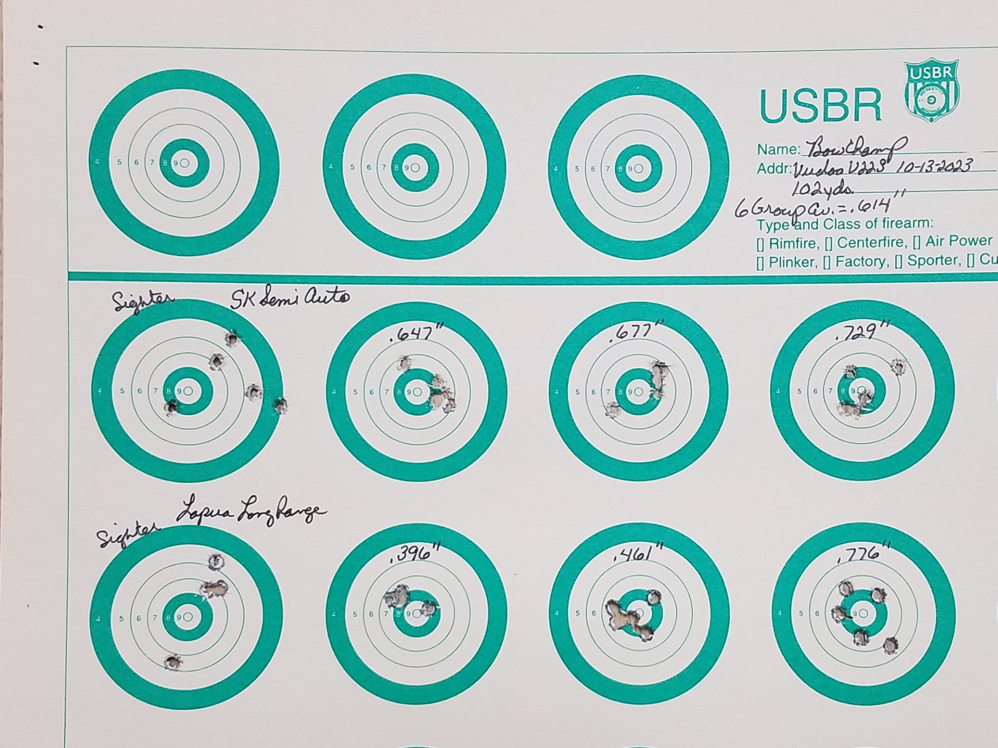

I have a little twist on this JBell 6x5 100yd entry. I shot it with two different ammos and at 102 yds. If it doesn't make for an official entry, I understand....I'll leave that up to you. Thanks!!
JBell 6x5 100yds. 10-13-2023
Vudoo V22S SK Semi-Auto 3 groups......Lapua Long Range 3 groups
6 groups Av.= .614"
Smallest group = .396" Lapua Long Range

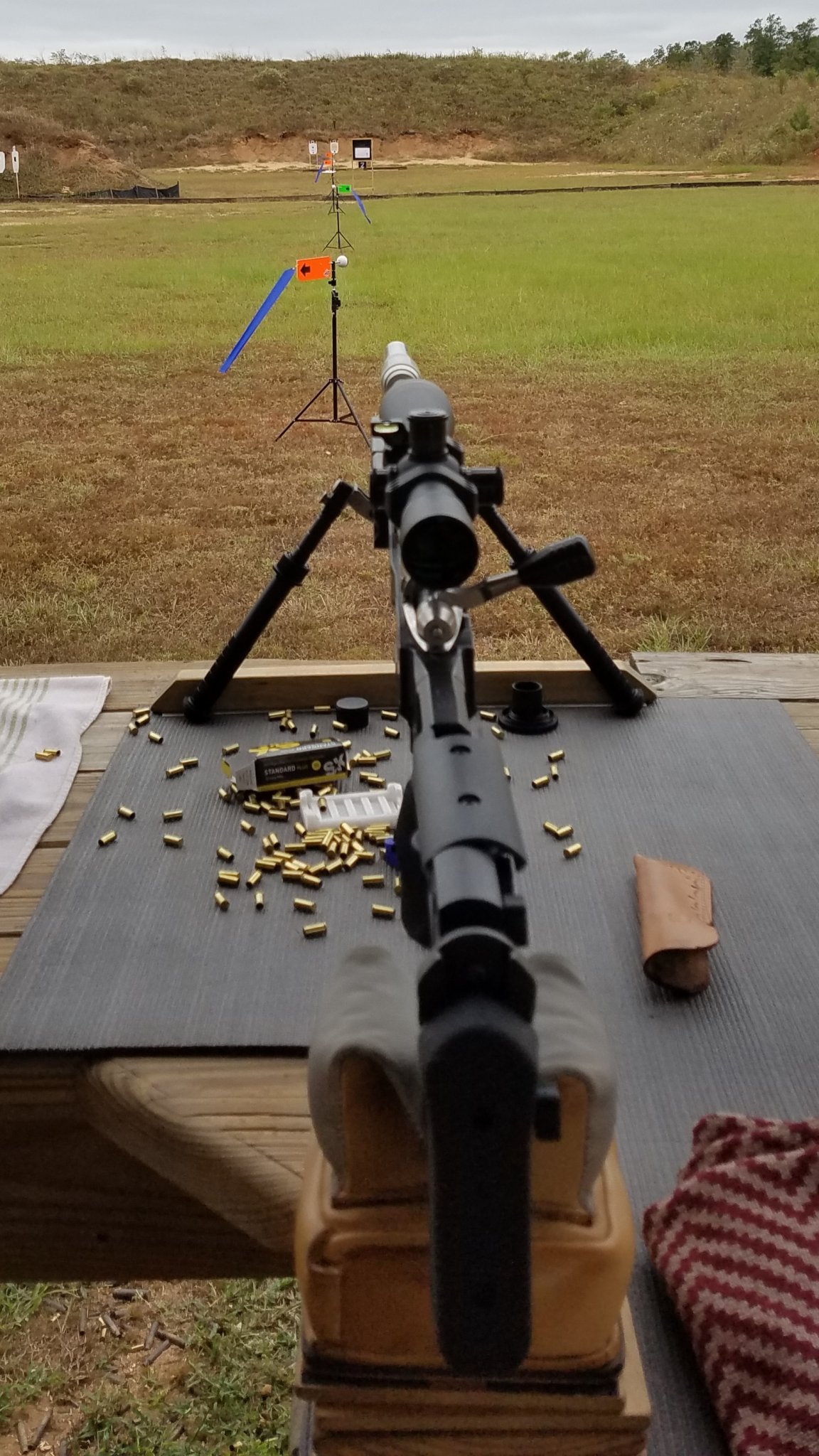

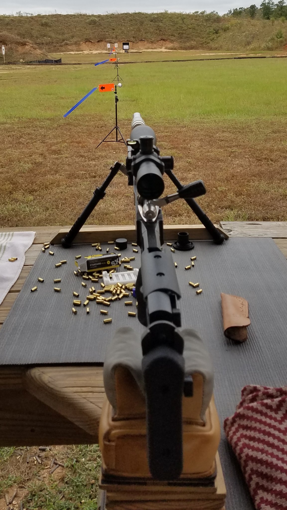

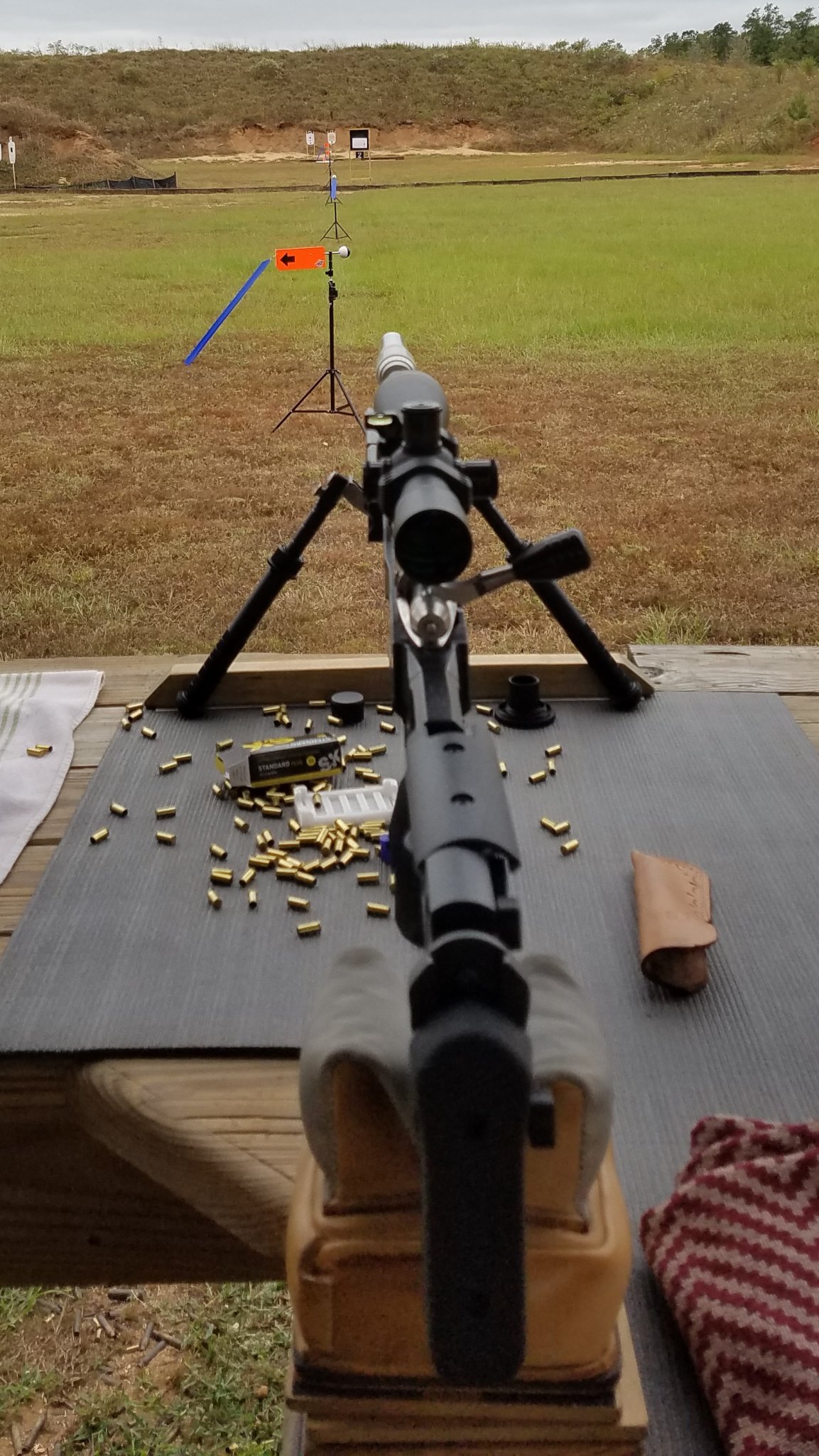

A couple pics to show some of the many wind directions of the day. Target on the right is at 50 yds. and middle target to the left is at 102 yds.
I set up this way so I could switch back and forth between the two targets without having to move. It worked out pretty good.
6 groups Av.= .614"

Bowchamp, no problem with using multiple ammo lots or brands in the same rifle. I have your scores posted. Nice range setup!

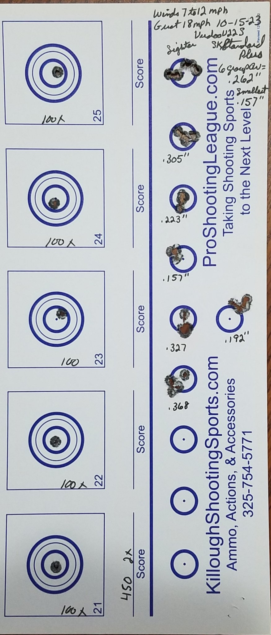

My new Bix-n-Andy Competition trigger showed up yesterday, got it put in and had to give it a try. Went to the range today and gave it a go. I really like this trigger and recommend it to anyone in need of a good one. I have been using my Jewell Benchrest trigger for about 6 months and the Bix n Andy is all around just a little better. The crisp break really sets them apart.
Anyway...enough rambling....here is my second entry for the JBell 6x5. Still shooting the cheap ammo!! LOL!!!
JBell 6x5, 10-15-23, 50yds
Vudoo V22S, SK Standard Plus
6 group Av.- .262"
6 group Av.- .262"
Smallest group- .157"
Bowchamp, I have your updated scores posted. Nice work, and I also use B&A triggers. Very nice indeed!
